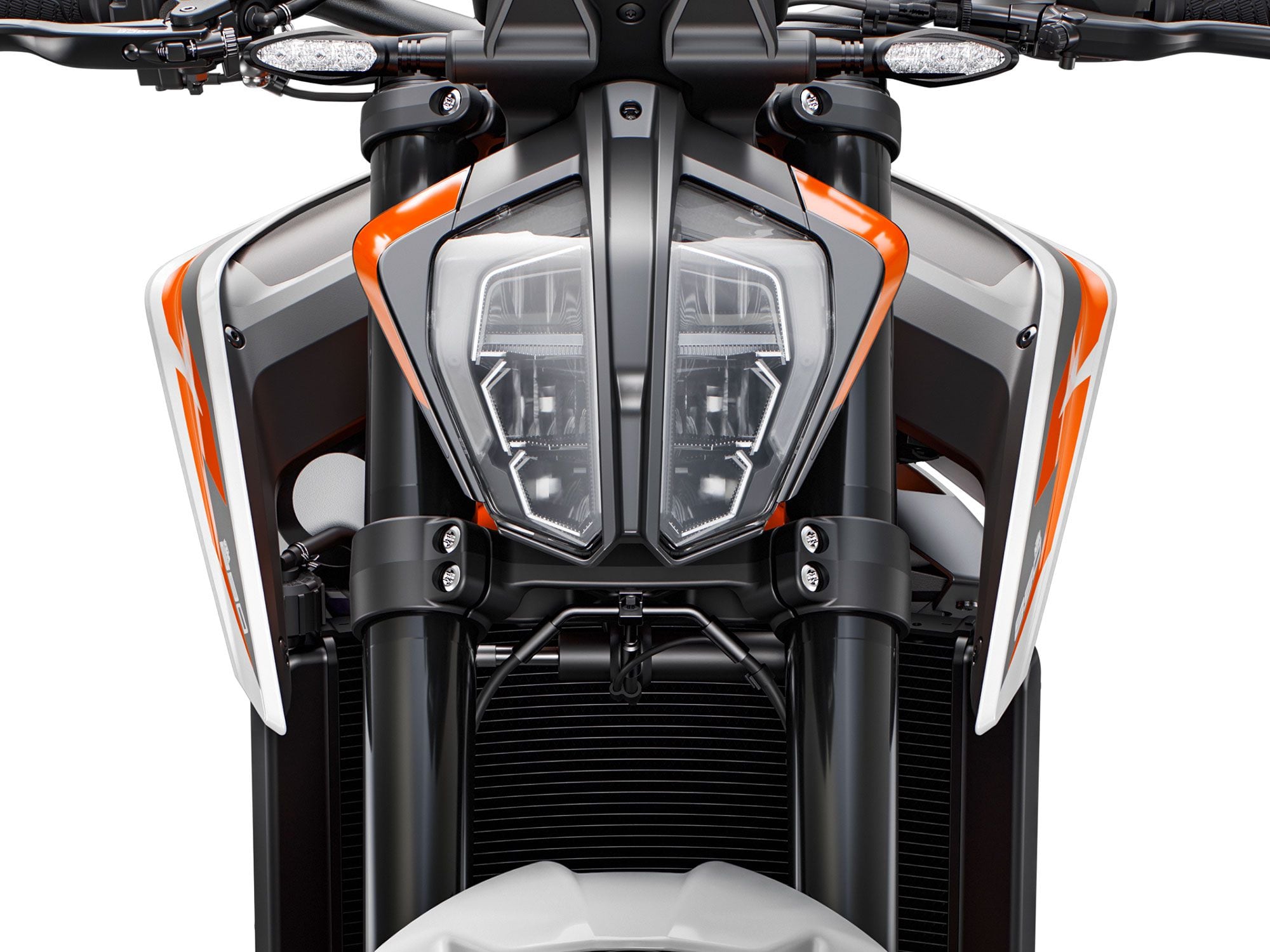

Multiple pinch-bolts and large clamping surfaces on large-diameter female fork legs resist the twisting forces input by the rider and road.
Multiple pinch-bolts and large clamping surfaces on large-diameter female fork legs resist the twisting forces input by the rider and road. (KTM/)
