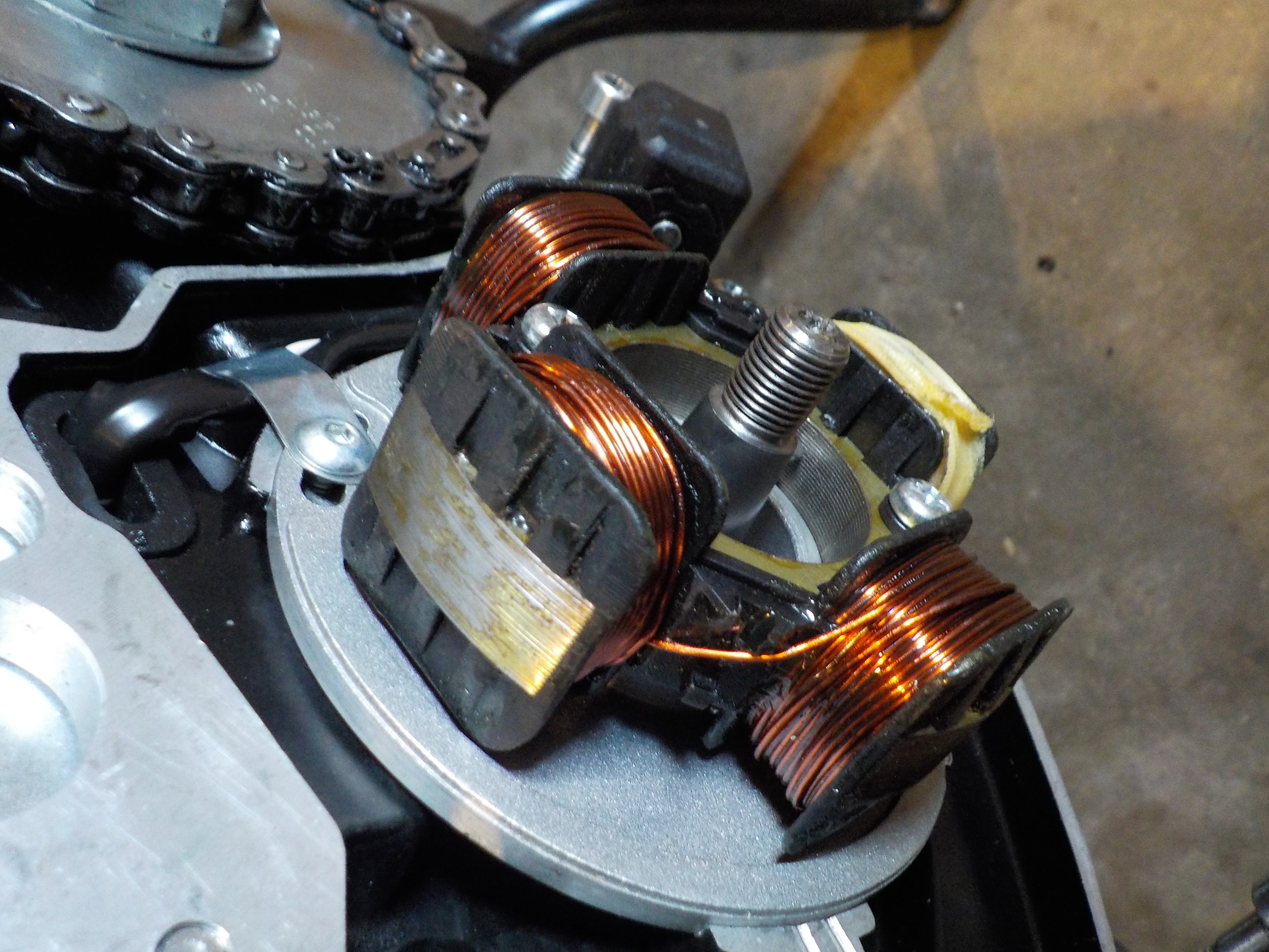

Tym Posted October 16, 2020 Share Posted October 16, 2020 So with 75 NYC Kilometers on the speedo my brother drops of his 2018 Tomos dead from being transported laying on its left side. Red ATF tranny oil flowing out of the case, i wondered to myself at the time if that would short something out. Yup...Got into the coils, even after cleaning residual oil does this to the coil pickups when they heat up. Cleaned them off now she runs, the odds makers want bets on how long before this happens again. Yes im getting new coils. 4 Link to comment Share on other sites More sharing options...
Tym Posted October 16, 2020 Author Share Posted October 16, 2020 Made it two times up the street...wouldnt start, remove flywheel, clean coils.... runs till you shut her off, then no restart without a coil cleaning, The best part is this is all my oldest brothers fault.... 1 Link to comment Share on other sites More sharing options...

Sir Fallsalot Posted October 16, 2020 Share Posted October 16, 2020 Oil on those coils shouldn't make a difference sounds like your disturbing something when you take the flywheel off i'd be looking at the pulse generator which is the black block at the back Link to comment Share on other sites More sharing options...
Tym Posted October 16, 2020 Author Share Posted October 16, 2020 That case was half full of trans oil SirFalls, so, all i can do is tell ya what im doing...the last time i took the case off it reaked of burnt tranny oil, now not so much. Butt, this is what she sounds like right now so... 2 Link to comment Share on other sites More sharing options...

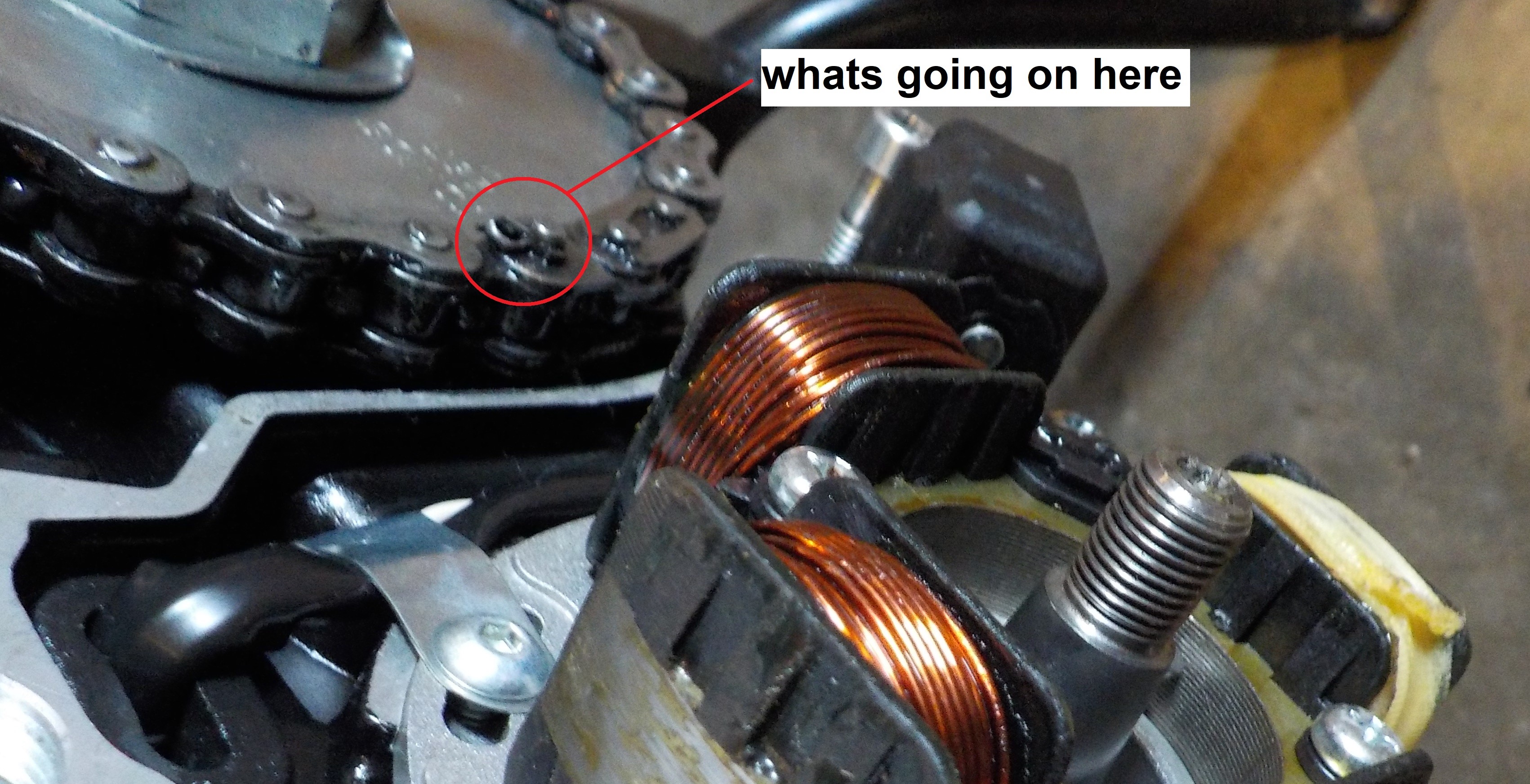

Tym Posted October 16, 2020 Author Share Posted October 16, 2020 Its a Slovenian master clip, the pin is safety wired, looks like a bodge job to put the chain on, they added a larger sproket, probably needed more chain so they jiggered some more on. It leaked oil when my brother layed it on her side to transport it up here, over there, who knows how far.. 1 Link to comment Share on other sites More sharing options...
Tym Posted October 16, 2020 Author Share Posted October 16, 2020 1 hour ago, Sir Fallsalot said: @Tym Went out an looked, its the round end of a cotter pin that is holding the chains pin in from falling out.... 1 Link to comment Share on other sites More sharing options...
