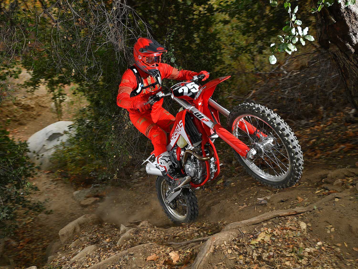

Riding the 2021 GasGas EX 250F.
Riding the 2021 GasGas EX 250F. (Mark Kariya/)
After spending a day last December testing the 2021 GasGas MC 250F and MC 450F motocross bikes at San Bernardino, California’s Glen Helen Raceway for the final bike tests of the 2020 calendar year, GasGas sent us home with its new EX 250F. As the brand’s 250cc four-stroke cross-country motorcycle, the EX 250F is the base for the bike that Coastal GasGas Factory Racing’s Johnny Girroir will contest in the upcoming 2021 Grand National Cross Country (GNCC) series. We logged plenty of time on the EX 250F over the holiday break, learned a lot about its performance characteristics, and came away impressed with the new machine, especially considering its price point compared to the KTM 250 XC-F, its Austrian counterpart of the same displacement.
