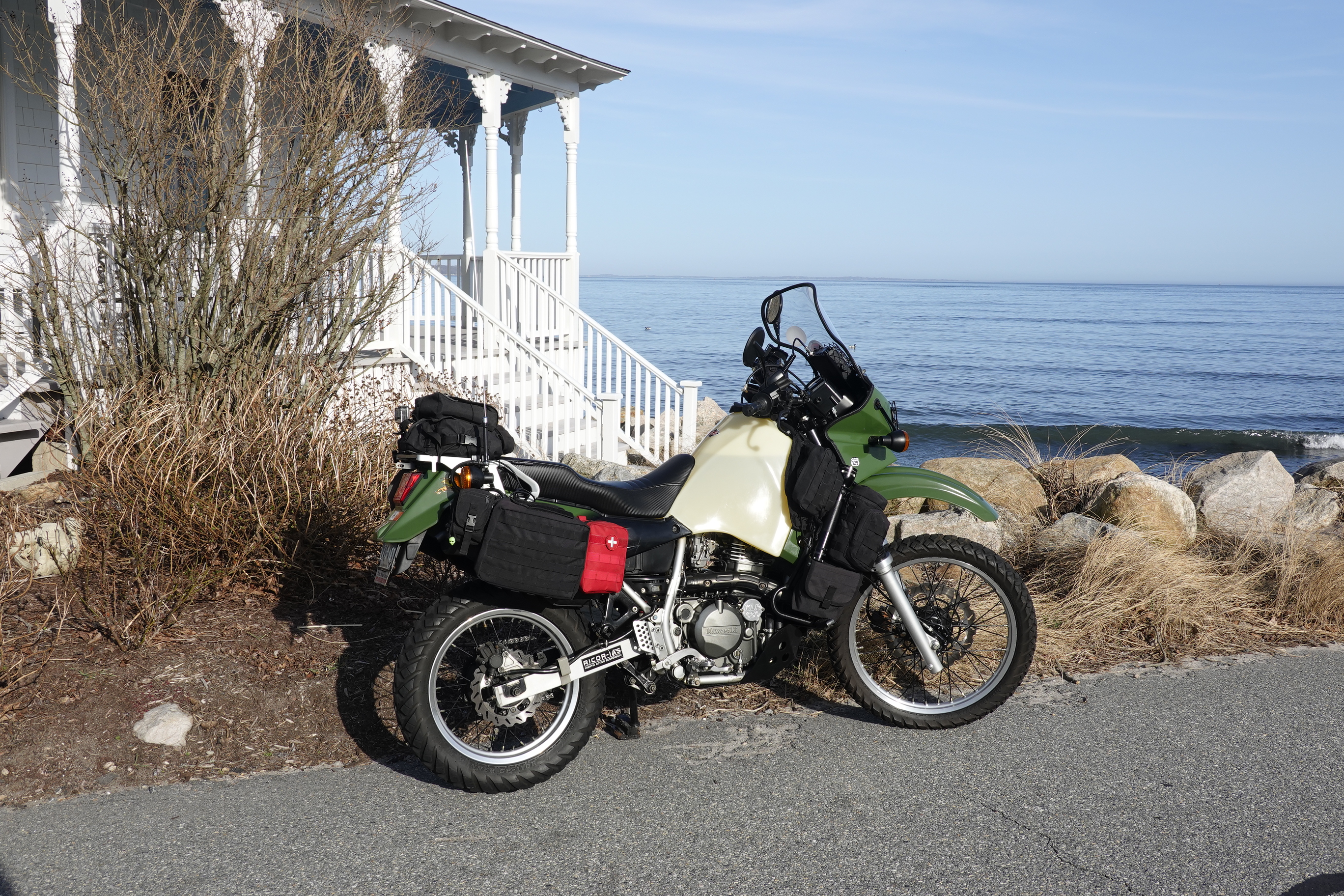

Tym Posted March 23, 2021 Author Share Posted March 23, 2021 On 23/03/2021 at 20:28, Grasshopper's Ride said: I hope everything goes well and you recover quickly. Expand Thank you! Now, can you help me with a stuck KLR float? just now barely made it home leaking more fuel than a SR-71 on takeoff. Just wanted to go for one last ride, it didnt last long I only got one pic fuckmine. . 3 1 1 Link to comment Share on other sites More sharing options...
Grasshopper Posted March 23, 2021 Share Posted March 23, 2021 On 23/03/2021 at 21:51, Tym said: Thank you! Now, can you help me with a stuck KLR float? just now barely made it home leaking more fuel than a SR-71 on takeoff. Just wanted to go for one last ride, it didnt last long Expand Bummer..."they" say......A stuck float can be caused by the premature death of the needle and seat, a fuel logged float sinking to the bottom of the bowl, or garbage in the line not letting the needle close fully. And other stuff..... Should be an easy fix. If I was closer, you could drop it off, I would enjoy working on that bike. It is nice to see the KLR out regardless. 1 Link to comment Share on other sites More sharing options...
Tym Posted March 23, 2021 Author Share Posted March 23, 2021 Its probably cheaper just to flash the @Mess "send more motors" spotlight into the internets..and wait a few minutes...it'd be at the door Shortly. 1 Link to comment Share on other sites More sharing options...
Sir Fallsalot Posted March 23, 2021 Share Posted March 23, 2021 On 23/03/2021 at 21:51, Tym said: Thank you! Now, can you help me with a stuck KLR float? just now barely made it home leaking more fuel than a SR-71 on takeoff. Expand You can try draining the carb and then turn the fuel on it may flush whats stuck in the float valve seat out or tap the side of the carb with something like a screwdriver handle which may unstick the float or dislodge whatever's in the valve seat, or you can try combo's do all of the above at the same time. Failing that its float bowl off time to have a look whats going on. Link to comment Share on other sites More sharing options...
Tym Posted March 24, 2021 Author Share Posted March 24, 2021 On 23/03/2021 at 22:20, Sir Fallsalot said: You can try draining the carb and then turn the fuel on it may flush whats stuck in the float valve seat out or tap the side of the carb with something like a screwdriver handle which may unstick the float or dislodge whatever's in the valve seat, or you can try combo's do all of the above at the same time. Failing that its float bowl off time to have a look whats going on. Expand i;ll Try that this morning Sir Falls. 1 Link to comment Share on other sites More sharing options...

Tym Posted March 24, 2021 Author Share Posted March 24, 2021 That porch in the picture is for sale, might be under offer not sure. $749,000 doesnt sound bad until the next big wave. https://www.zillow.com/homedetails/26-Attawan-Ave-Niantic-CT-06357/58045499_zpid/ Link to comment Share on other sites More sharing options...
XTreme Posted March 24, 2021 Share Posted March 24, 2021 On 24/03/2021 at 08:19, Tym said: That porch in the picture is for sale, might be under offer not sure. $749,000 doesnt sound bad until the next big wave. https://www.zillow.com/homedetails/26-Attawan-Ave-Niantic-CT-06357/58045499_zpid/ Expand Shit......risky having that there! Magnum could flog it though no sweat.....he'd tell them the ocean is their property as well. 1 Link to comment Share on other sites More sharing options...
