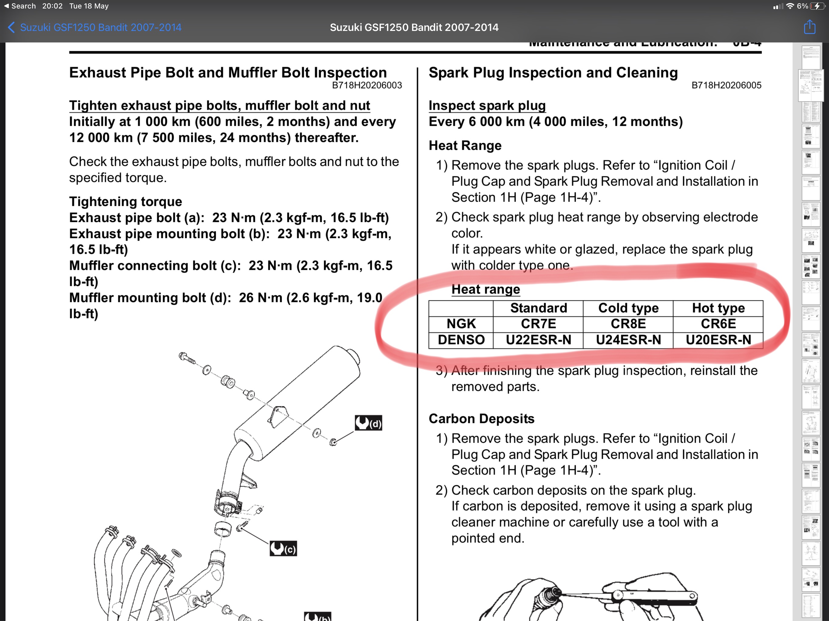

Just go to a bike shop and tell them you want spark plugs for whatever bike you got they will do the rest. If they offer you a choice just tell them whatever comes in there as standard. Or if you look in the maintenance section of a Haynes manual  it will tell you what you want and you can order on line . This is what it says for one of my bikes you will want the standard one

That's easy NGK and Denso are manufactures of spark plugs, NGK being the most common, CR7E is the plug number for the standard plug and is what you want, so search for NGK CR7E this is not specific to your bike this will be the plug number for probably hundreds of different bikes
NGK CR7E is quite a common plug, loads of them for sale on eBay.  I'd be more concerned about a mechanic who tells you to supply your own parts 😳
