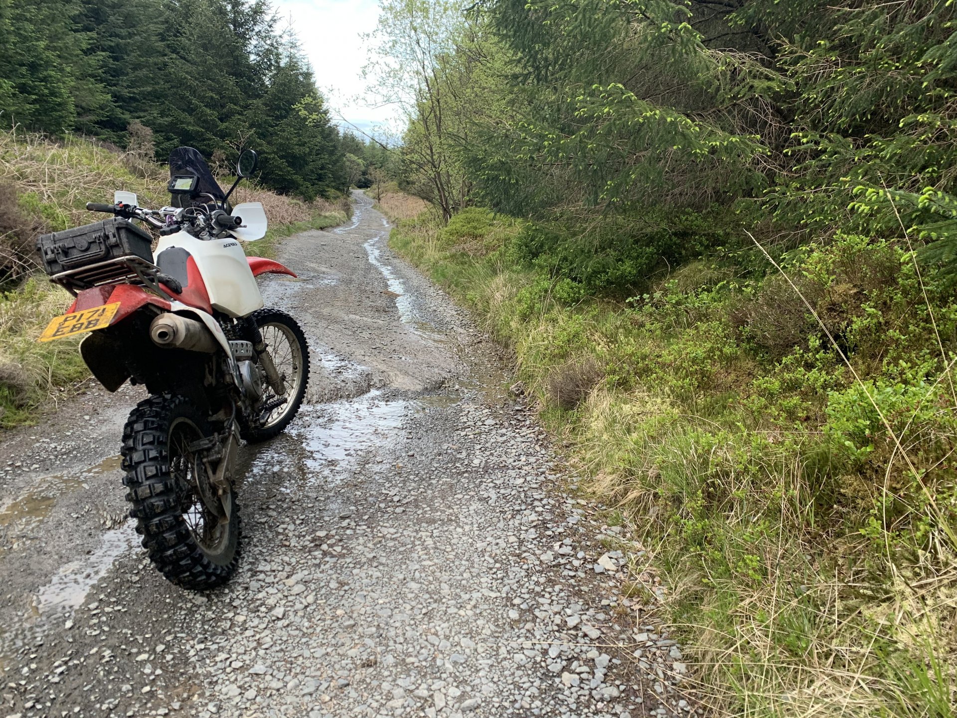

The day started with the rebuild
After a little work she lives
A few hours later and i'm on the road but thinking i better not stray too far after the rebuild so up to my local byway . It was pointed out to me the shadow looks like a reindeer lol
And then onto my mountain
After a check for oil leaks it was onto check out a lane that was illegally closed but overturned by the TRF
Then some of my favorite tarmac to sennybridge for fuel
This is the end of the roman road out of Trecastle only took the photo because it doubled up as a piss stop
Then onto the Crychan forest which has been graded and has made it easy enough to drive your car through now
Then it was the ride home trying to keep it under 55. past the Llwyn Onn reservoir it was like a mirror these are photos of it up the right way and upside down you tell me which is which
On the A470 i had to suffer the humiliation of a scooter rider burning me off because i was bedding things in the fucking wanker had the cheek to wave to me :classic_laugh: Bike ran beautifully restored my love for it again😊

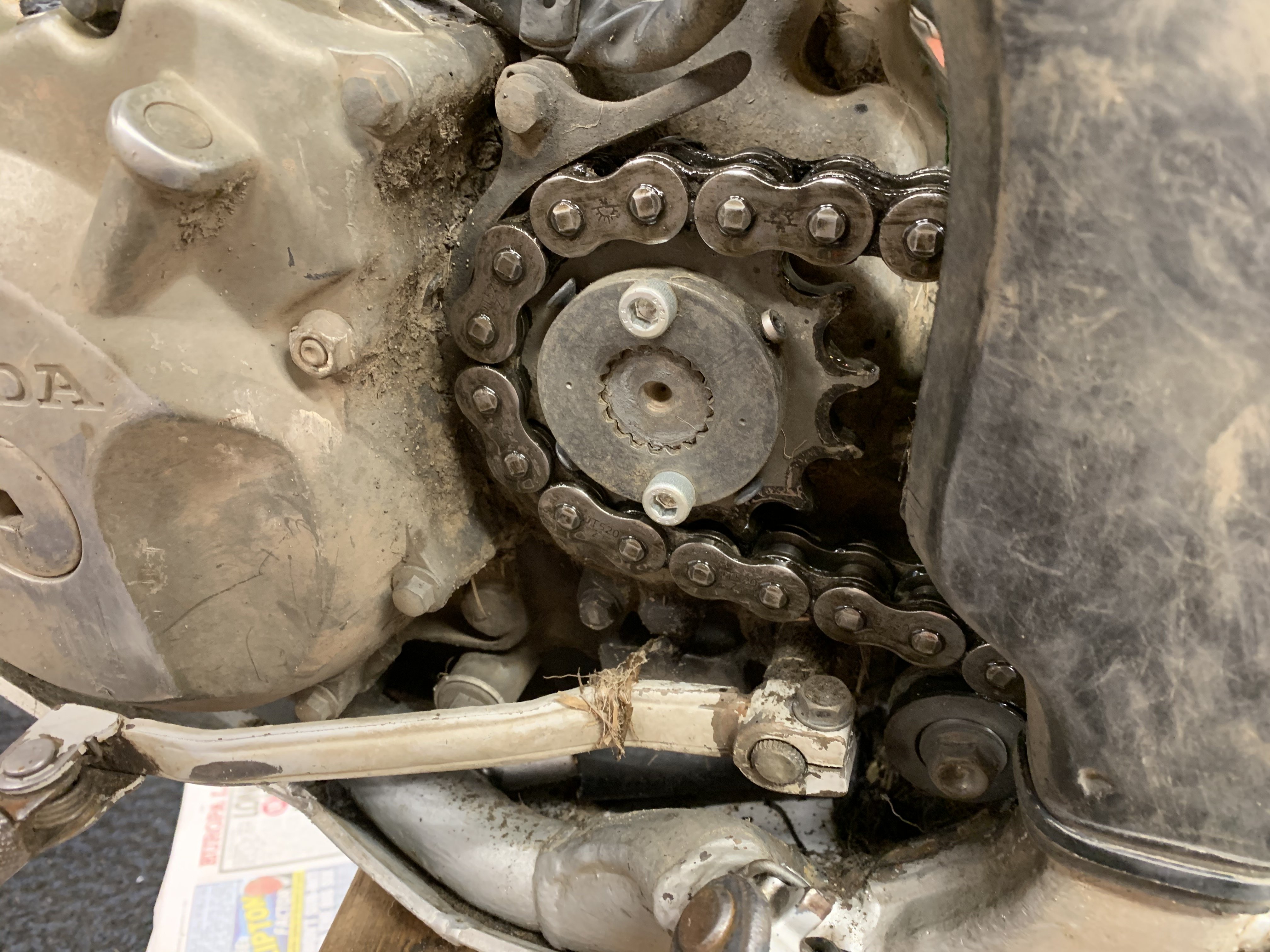

How'd you get on with front sprockets Fred? My first engine had the early out put shaft and had worn badly. I was using Africa twin sprockets as they has a shoulder.
The new shafts are no better either.
Front sprocket shaft has a small amount of wear but not a lot. when i use up the sprockets i have on the shelf i will be looking to fit one of these i got one on my old Africa twin
A bit pricey but easier than an engine rebuild. The XR has a lot more wear i'm in the process of doing some mods on that to see if i can prolong it
https://www.kkbike.it/en/sprockets/172-147-15t-superpinion-honda-xr-650-l-8053830250147.html

How much wear is on the splines or are you putting it on to prevent it
Prevention. There is some but like I said, I'd adapted a wider sprocket and it's worked well but now a few years old.
I've just nocked something up for the XR there's more wear on the shaft than i like so looked at making something to use all the shaft. I ended up annealing the old sprocket cutting the teeth off and then turning it down to the same diameter as the sprocket retainer. Then i drilled and tapped the sides so a grub screw would tighten down into the groove the sprocket retainer normally sits in. The JT sprockets got a shoulder on them that normally faces out i turned it around so it faces in so you have to push it onto the unused part of the shaft to get it to line up with the chain and with the modified sprocket re hardened and bolted to it it ends up covering all the shaft. I did use a chemical metal as i pushed the sprocket on to build up the worn part of the shaft so it's not just the new part of the shaft taking the strain. I've put about 500 miles on it now and everything seems good. the four screws around the sprocket are just there to cap off the grub screws and to keep the crap out

Had to give the shaft a scrap and still had to give the new sprocket a few taps to get it all the way home. It's def using all the spline available.
The boys on the TDM forum have stopped using JT front sprockets as they're already a bit of a loose fit on the output shaft from new.
I have to use the JT ones as the standard sprocket wouldn't work with my mod on the XR, the chemical metal stops any movement its on there solid, i have been wondering how it will come off when it needs to but ill worry about that next sprocket change
