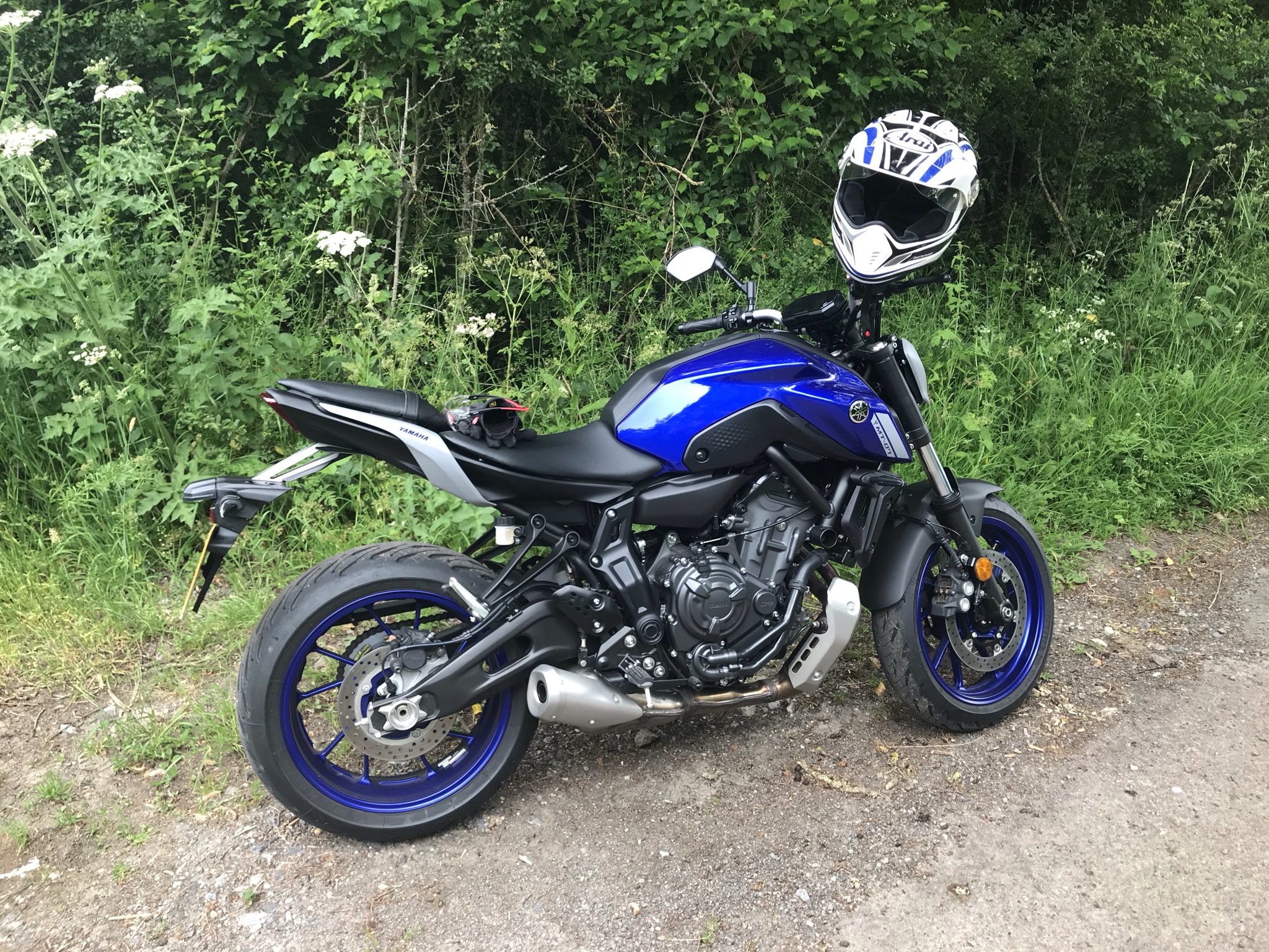

I had one for a couple of hours today, I was very impressed.  It was such an easy bike to ride but rewarding as well, quick off the mark and light compared to my Tenere which has the same engine.
