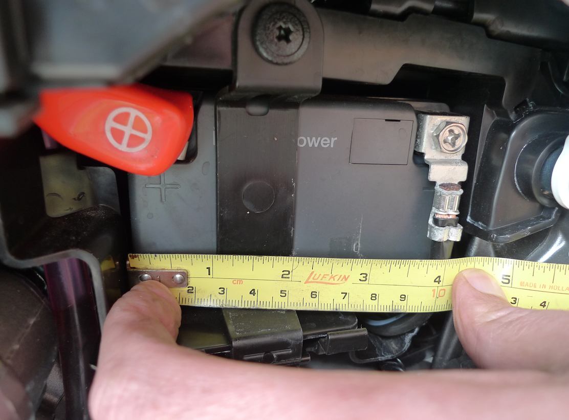

My issue with lithium batteries is when people fit them to bikes that were not designed to use them, yes they work when everything on the bike works 100% but when things are not quite right with the bike is when the problems start. I recently read about someone who had fitted a  Lithium battery to a 2017 Africa Twin which didn't come fitted with one from new. He said he was riding along and the bike just died not a single light on the dash and he had to get it recovered. When looking into the problem he found the battery had gone into safe mode and was unrecoverable so a new battery was needed, once fitted he then found his bike wasn't charging the battery because his reg/rec had failed and in his mind that was why the battery failed but in reality it was the other way around the reg/rec had failed because his battery had switched off while the engine was running. Lithium batteries are fantastic when used on what their designed for but i wont be changing the lead acid for lithium on any of my bikes. my 2016 Africa Twin is still on the original battery and when that fails which could be any day now i will be replacing it with the same one.
I have replaced my 2015/2016 GS's battery a few weeks ago with a lithium battery, same size but weights a fraction of the original. What sold me on it was the promise of better than original battery life and better starting too. I never had an issue with the original but then again my bike hasn't slept in freezing temperatures, and I was more than happy to have the same fitted, but there you go.

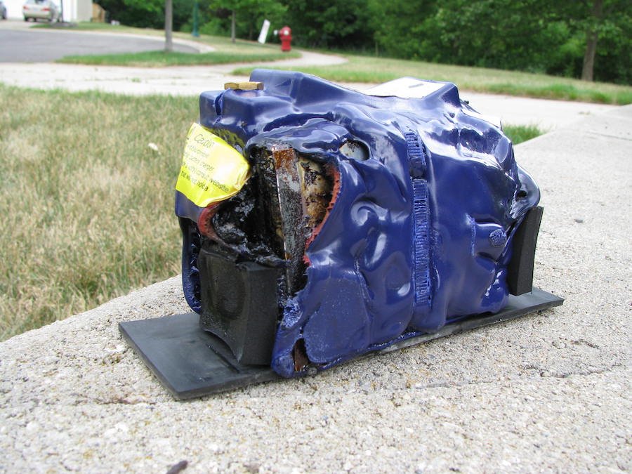

The aftermath of putting a lithium battery in an old school bike, and the old school regulator rejecting it.
http://teamyikes.com/851/EarthX.mov
This is near the end of the ordeal. Trust me, the smoke was a LOT worse earlier in the show. And the smell. Oh my god...
PS. The bike now has a mosfet regulator, and another lithium battery. What can I say, I'm stubborn.

Early on in the process you could see arcing inside the case, after the case split open of course. The good news is, these batteries are usually Lithium IRON as opposed to Lithium ION, which means they don't have the same tendancy to burst into actual flames when they fail. I didn't know the difference at the time so watching it progress was oh so wonderfully suspenseful as I waited for the flames. I was pretty sure it was going to burn down on the side of the road, but it didn't.
So here's what happened as I understand it. The regulator failed, and the voltage to the battery reached somewhere around 60 (according to the manufacturer, that's what it'd take to overpower the built in protection, which they have since increased). When the voltage gets too high in a lithium battery, it starts to plate it's internals. Eventually it shorts itself out internally and then it's China Syndrome time. There's not a damn thing you can do until all the smoke leakes out. In my case the bike stalled, then started again, then died for good. Stopped on the side of the road, removed the seat to get to the tool kit, and noticed a small wisp of smoke. What the??? Small wisp became massive amounts accompanied by a horrible stench. A seriously nasty chemical smell that stuck to everything even after the event. Peaking under the fairing (while holding my breath) I saw arcing inside the case.
After replacing the regulator and battery, I ended up having to replace the ECU, a bulb or two, and a relay. There is some sort of device in the ECU that is supposed to protect against over voltage. The component unsoldered itself and was rattling around in the ECU's case.
Old school Ducati regulators suck. Don't run a lithium battery without a MOSFET regulator. Just don't do it.
