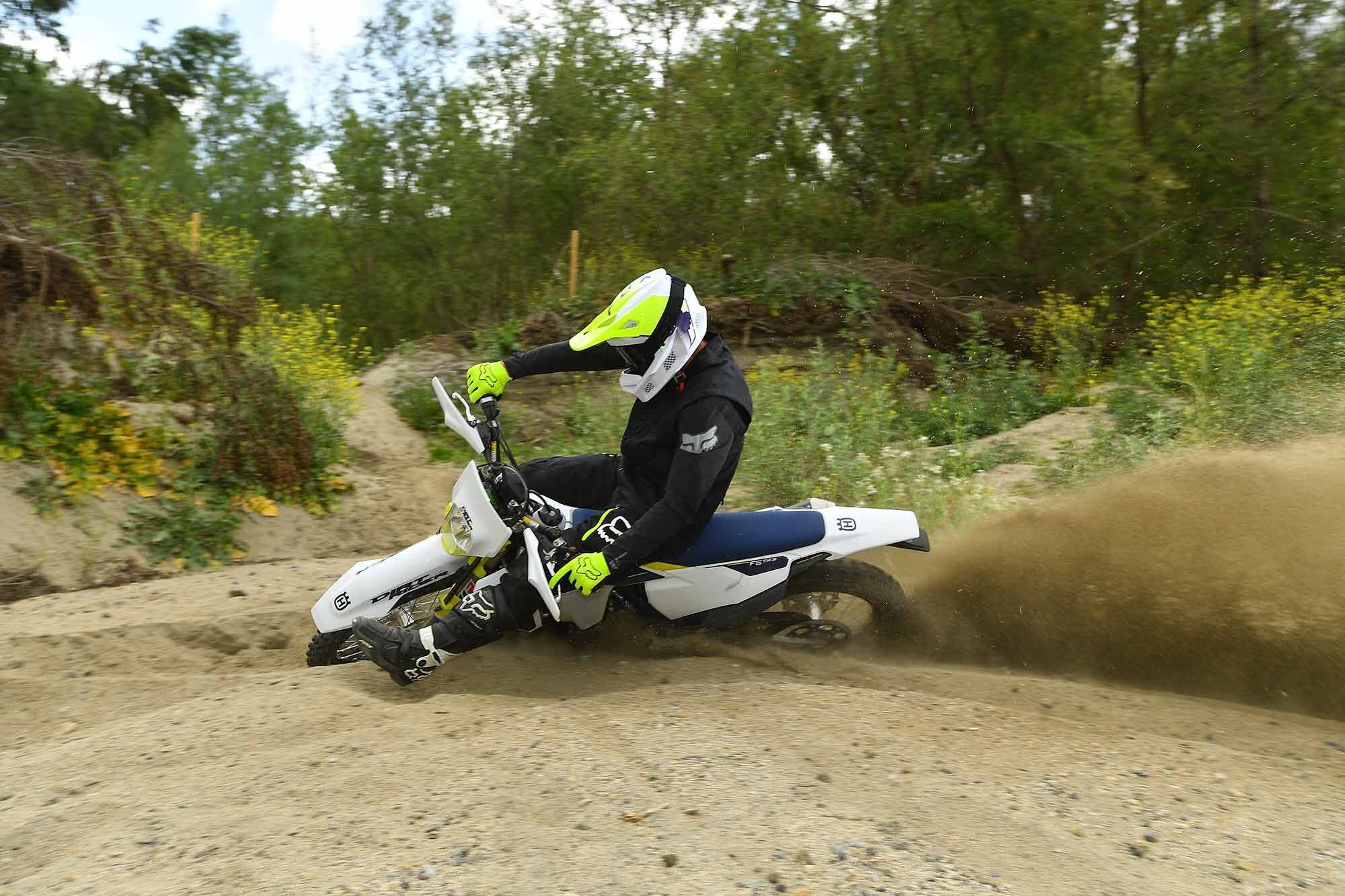

As Husqvarna’s flagship enduro model, the FE 501 shares lots of components with the FE 501s dual sport motorcycle but is aimed at high-level enduro riding.
As Husqvarna’s flagship enduro model, the FE 501 shares lots of components with the FE 501s dual sport motorcycle but is aimed at high-level enduro riding. (Mark Kariya/)
