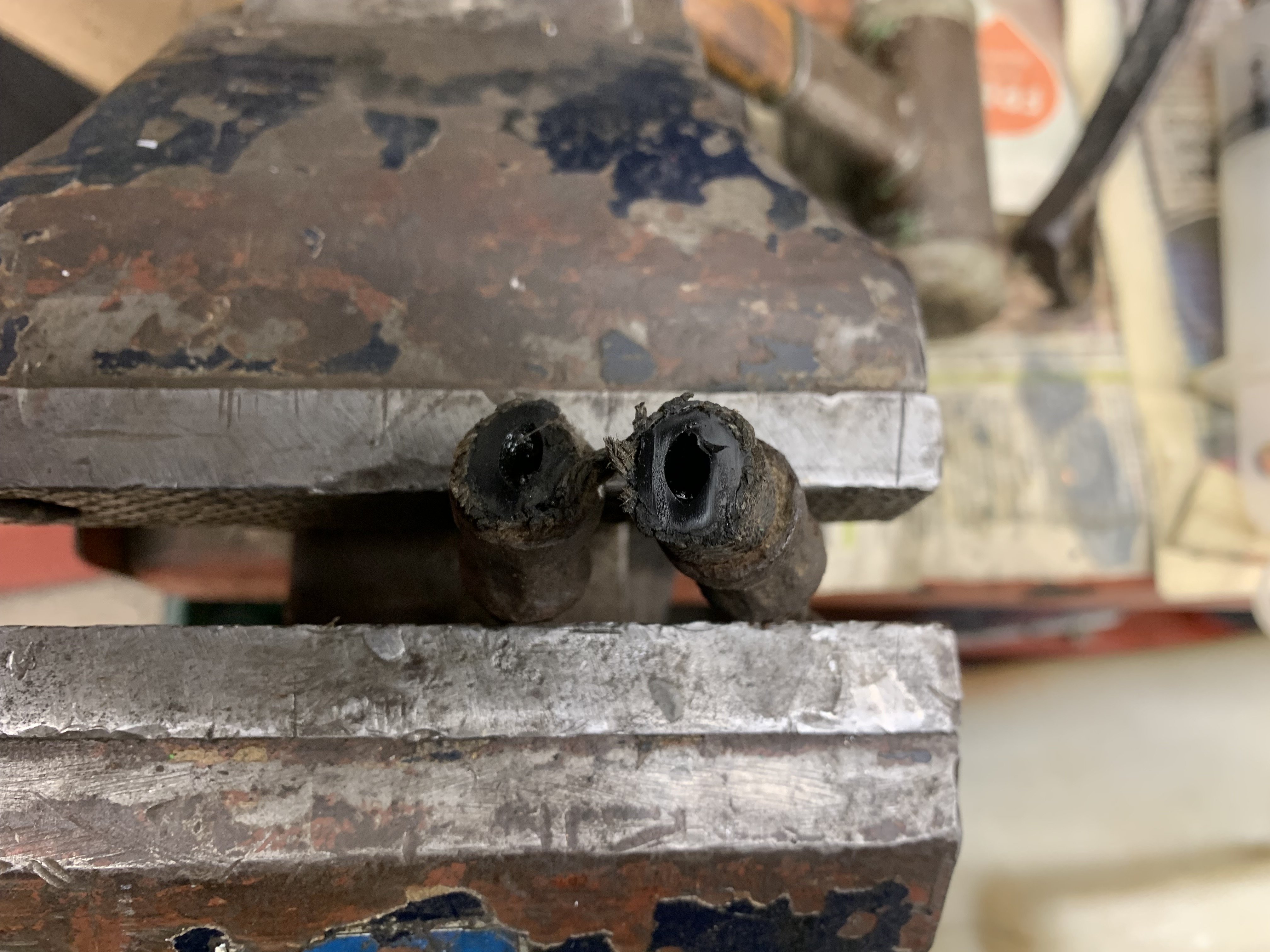

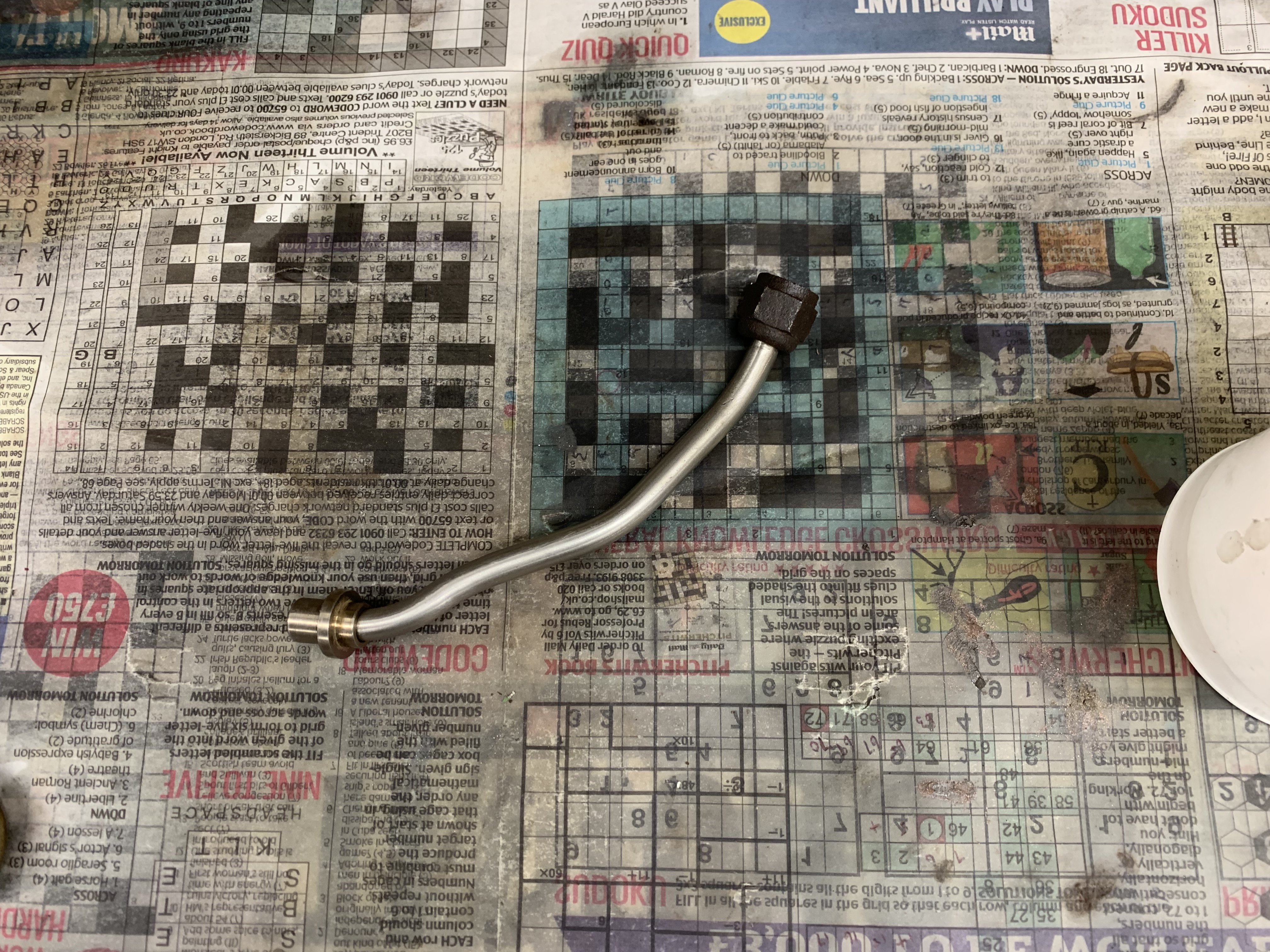

Sir Fallsalot Posted August 6, 2021 Share Posted August 6, 2021 I think if i was Frankenstein the dog would be my monster. So as said earlier in the week the dogs oil pump was starved of oil due to a suspected collapsed oil pipe this is it cut open its squashed when straight and when fitted its bent so definitely the problem Making a solid pipe artery to the heart of the dog has failed for the moment as my flaring tool wont work on the stainless pipe, What i made fits but wont seal at the frame. I haven't given up on it though just put it aside until i find out how the dog runs if and when i resurrect it In the meantime I got the new second hand oil pipe and after fitting the blood was running from the frame to the dogs heart freely.Turning the engine over with the CDI disconnected had the dogs life bloody up in it's head after messing about a bit getting rid of air locks which i was quite pleased about After this it was time to bring the dog to life i reconnected its brain and switched on the power and guess what Really chuffed It don't sound bad at all, i shall recheck the tappets tomorrow and then release it into the wild to see if it survives 8 Link to comment Share on other sites More sharing options...

Sir Fallsalot Posted August 7, 2021 Author Share Posted August 7, 2021 Put it all back together today and went for a ride and as a result i had a few observations First thing was my waterproofs are no longer waterproof got bloody soaked need some new ones for the winter The bike had a clutch judder pulling off when the bike was cold it started happening just before i did the cam chain this has now gone now, i did put it down to cooking the clutch going over Barmouth hills many years ago the metal plates in there are blue and thought its on its way out, but i'm more inclined to think it was dry clutch plates from lack of oil now After the cam chain replacement i noticed the bike was running a lot cooler than it used to on the dipstick temperature gauge i did think this was down to me giving the carb a good clean and thought there might have been a blocked jet before which made the bike run lean it is now back to the temperature it used to run at. i think it was because there was very little oil being circulated around the engine so the oil never got that hot in the tank on the way home the ticky noises returned so i will be checking the valve clearances again tomorrow just to check that is still the noise i am hearing and nothing else has developed on the ride. I'm beginning to think my worn out cam chain and guides was down to this oil problem and not old age as first thought Apart from that the bike ran flawlessly and seems the bottom end has survived. Now i don't know what to do if there was a new 650 single out there like the DR650 or XR650L i think i would be purchasing it right now because i'm fed up working on them, all i want to do is ride what i do know is there's going to be some desperados going down the hatch tonight 4 Link to comment Share on other sites More sharing options...
