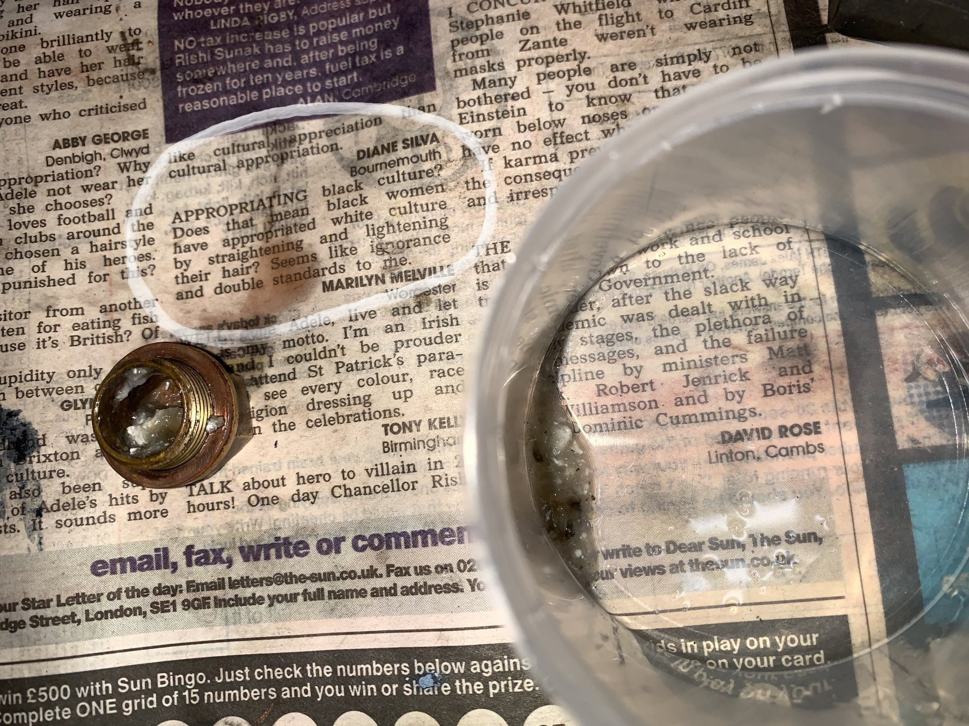

Sir Fallsalot Posted December 3, 2021 Author Share Posted December 3, 2021 4 minutes ago, XTreme said: Somebody's cum in your carb? That's the sort of deviant behaviour that DA used to get up to! What you say @Tym? I dipped my fingers in and it did have that sort of consistency except there was something gritty as well 2 Link to comment Share on other sites More sharing options...

Sir Fallsalot Posted December 4, 2021 Author Share Posted December 4, 2021 2 hours ago, boboneleg said: Got any idea what it is then Fred ? Not a clue spent the last 3 hours doing keyhole surgery taking the float bowl off the carb without removing it. Had a blocked idle jet which is now clear so the bike picks up a lot better off idle now. I've checked the tank again all looks clean and there's filters in there which wouldn't let that slime through, I did think it was my temp tank i use when the fuel tank is removed but that's clean and also has a filter so i'm at a loss. Another thing that did cross my mind is this new E10 fuel so i checked the carb on the XR and that is fine as well, going for a spin now and will keep an eye on it see if it happens again 3 Link to comment Share on other sites More sharing options...

boboneleg Posted December 4, 2021 Share Posted December 4, 2021 2 hours ago, Sir Fallsalot said: Not a clue spent the last 3 hours doing keyhole surgery taking the float bowl off the carb without removing it. Had a blocked idle jet which is now clear so the bike picks up a lot better off idle now. I've checked the tank again all looks clean and there's filters in there which wouldn't let that slime through, I did think it was my temp tank i use when the fuel tank is removed but that's clean and also has a filter so i'm at a loss. Another thing that did cross my mind is this new E10 fuel so i checked the carb on the XR and that is fine as well, going for a spin now and will keep an eye on it see if it happens again Are any of the lumps solid or is it mushy ? Link to comment Share on other sites More sharing options...
Sir Fallsalot Posted December 4, 2021 Author Share Posted December 4, 2021 6 minutes ago, boboneleg said: Are any of the lumps solid or is it mushy ? It was like creamy between my fingers with some bits of grit Link to comment Share on other sites More sharing options...

boboneleg Posted December 4, 2021 Share Posted December 4, 2021 47 minutes ago, Sir Fallsalot said: It was like creamy between my fingers with some bits of grit I have no idea what the hell that could be ? Link to comment Share on other sites More sharing options...

Sir Fallsalot Posted December 4, 2021 Author Share Posted December 4, 2021 3 minutes ago, Pedro said: Might be ridiculous, but might it have been some sort of slug or whatever that somehow got into the tank? There's filters in the tank that would stop that from getting through plus i hoovered the fuel tank out before refitting it so it was spotless in there Link to comment Share on other sites More sharing options...
yen_powell Posted December 4, 2021 Share Posted December 4, 2021 1 minute ago, Sir Fallsalot said: There's filters in the tank that would stop that from getting through plus i hoovered the fuel tank out before refitting it so it was spotless in there It looks like the stuff you get when oil emulsifies (apart from the grit) 1 Link to comment Share on other sites More sharing options...
Sir Fallsalot Posted December 4, 2021 Author Share Posted December 4, 2021 4 minutes ago, yen_powell said: It looks like the stuff you get when oil emulsifies (apart from the grit) I am wondering if it is the rubber grease i used when refitting the carb but i cant see how it would get in there and it was red Link to comment Share on other sites More sharing options...
