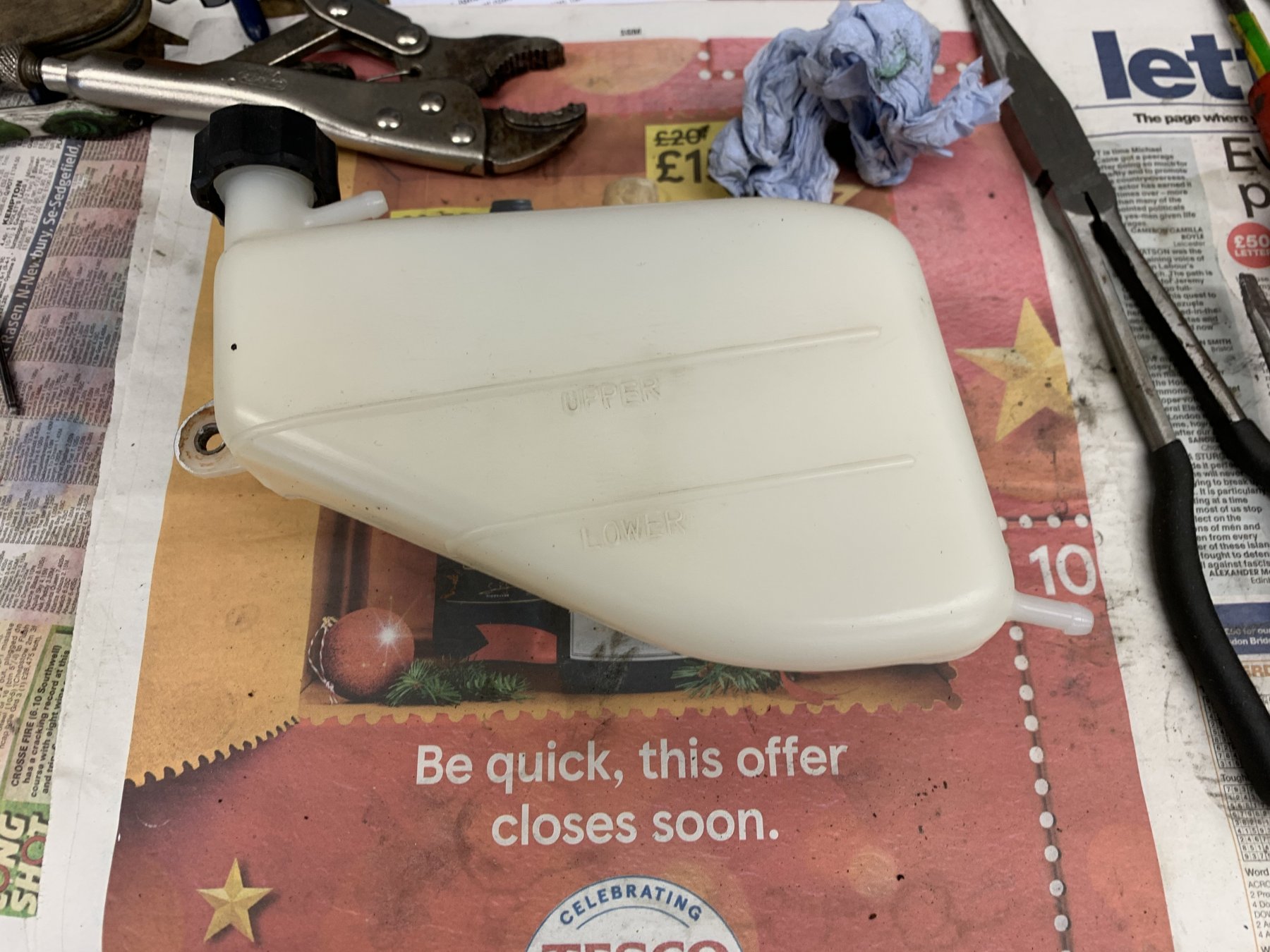

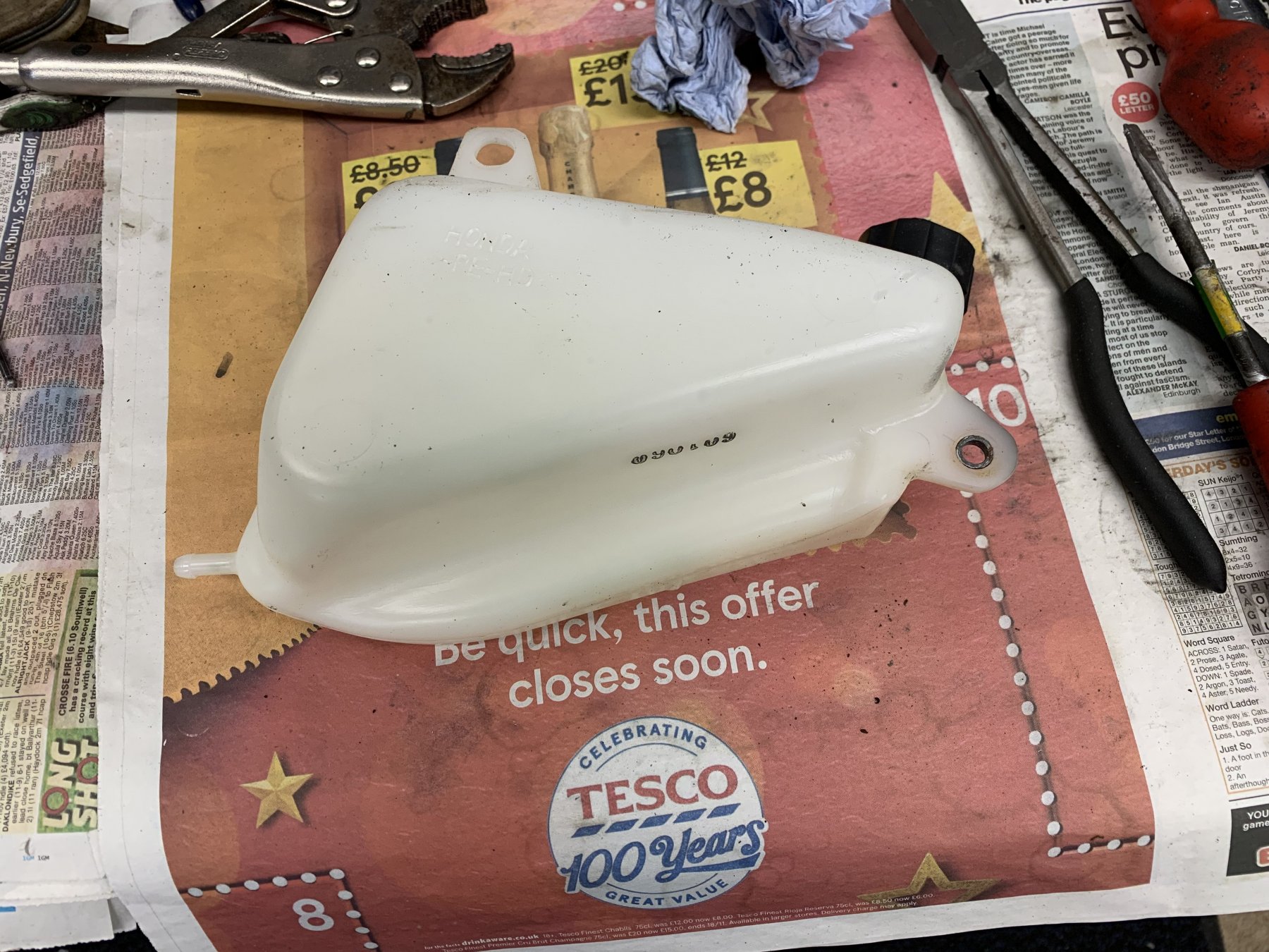

Sir Fallsalot Posted May 13, 2020 Share Posted May 13, 2020 I flushed the cooling system on my old Africa Twin this week, when i drained the expansion tank it stayed blue up to the high level line so wouldn't have known if it was low just by looking at it. I started thinking of ways i could clean it, went through the wife's cleaning cupboard and after trying a few different detergents unsuccessfully i found this stuff Its quite a coarse power so got an idea of how it might work, poured some into the expansion tank added some hot water and spent the next few minutes shaking it vigorously and to my surprise the stain started to disappear flushed it out with hot water and repeated the process. I think i got a good result with it, i just wish i had a before photo to show how bad it was. 1 Link to comment Share on other sites More sharing options...

Sir Fallsalot Posted May 14, 2020 Author Share Posted May 14, 2020 On 13/05/2020 at 19:52, XTreme said: Doesn't leave any residue behind though does it Fred? Expand No it just dissolves in the water that's why i think i had to repeat it and i washed it out shaking vigorously each time about 20 times with clean water 1 Link to comment Share on other sites More sharing options...
