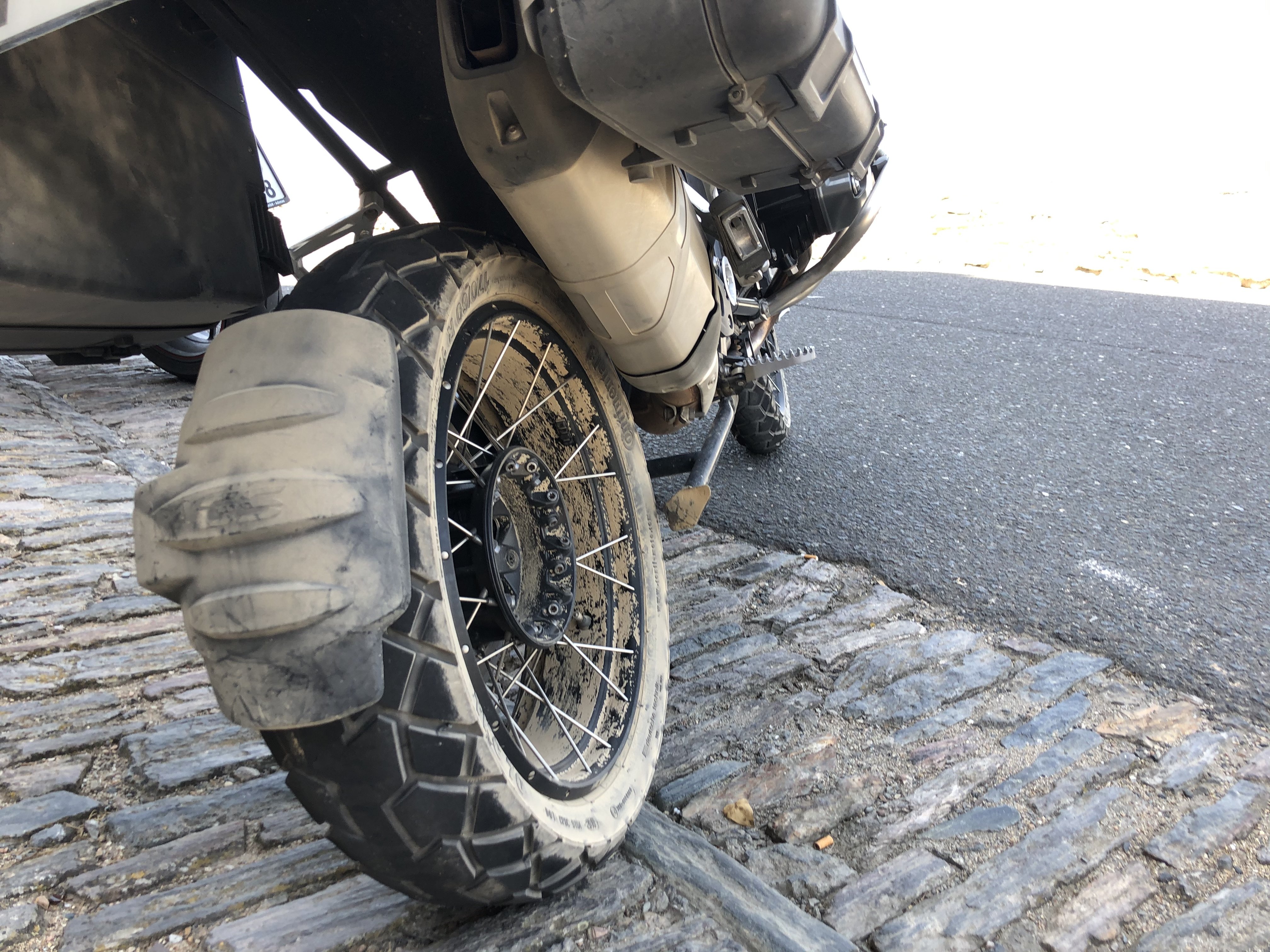

Pedro Posted July 24, 2022 Author Share Posted July 24, 2022 This is a TKC70, with some use, after a short bit of rocky roads, don’t know if you can see it but being a soft tire for good road use it gets easily damaged by jagged rocks in hot weather I’m happy with that in Portugal but not in Morocco Link to comment Share on other sites More sharing options...
