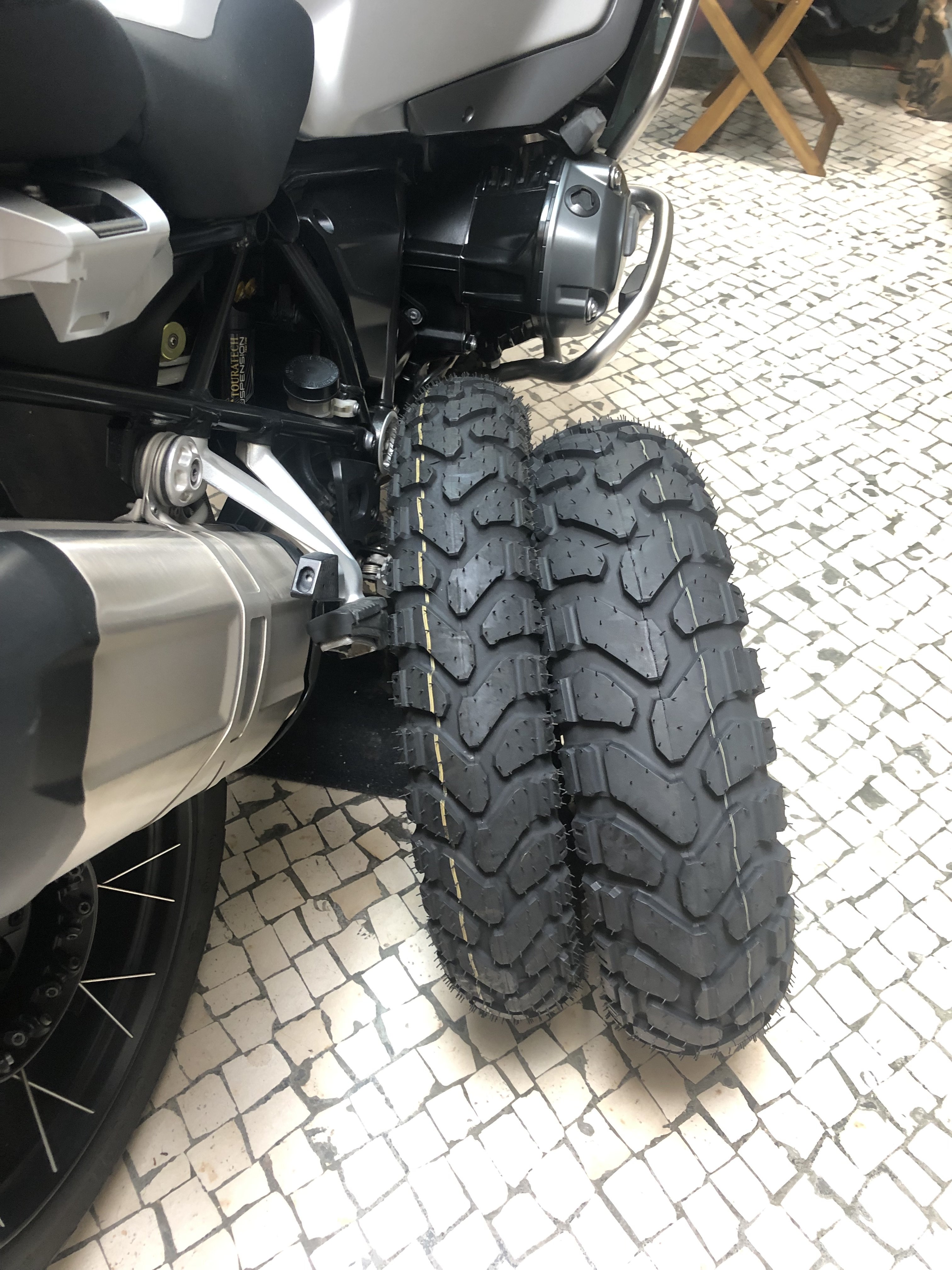

Pedro Posted August 4, 2022 Author Share Posted August 4, 2022 Tyres, bought, will only fit them mid september so maybe I planned too far ahead. Better have them in my garage now than struggling to get them at the last minute though. 5 Link to comment Share on other sites More sharing options...

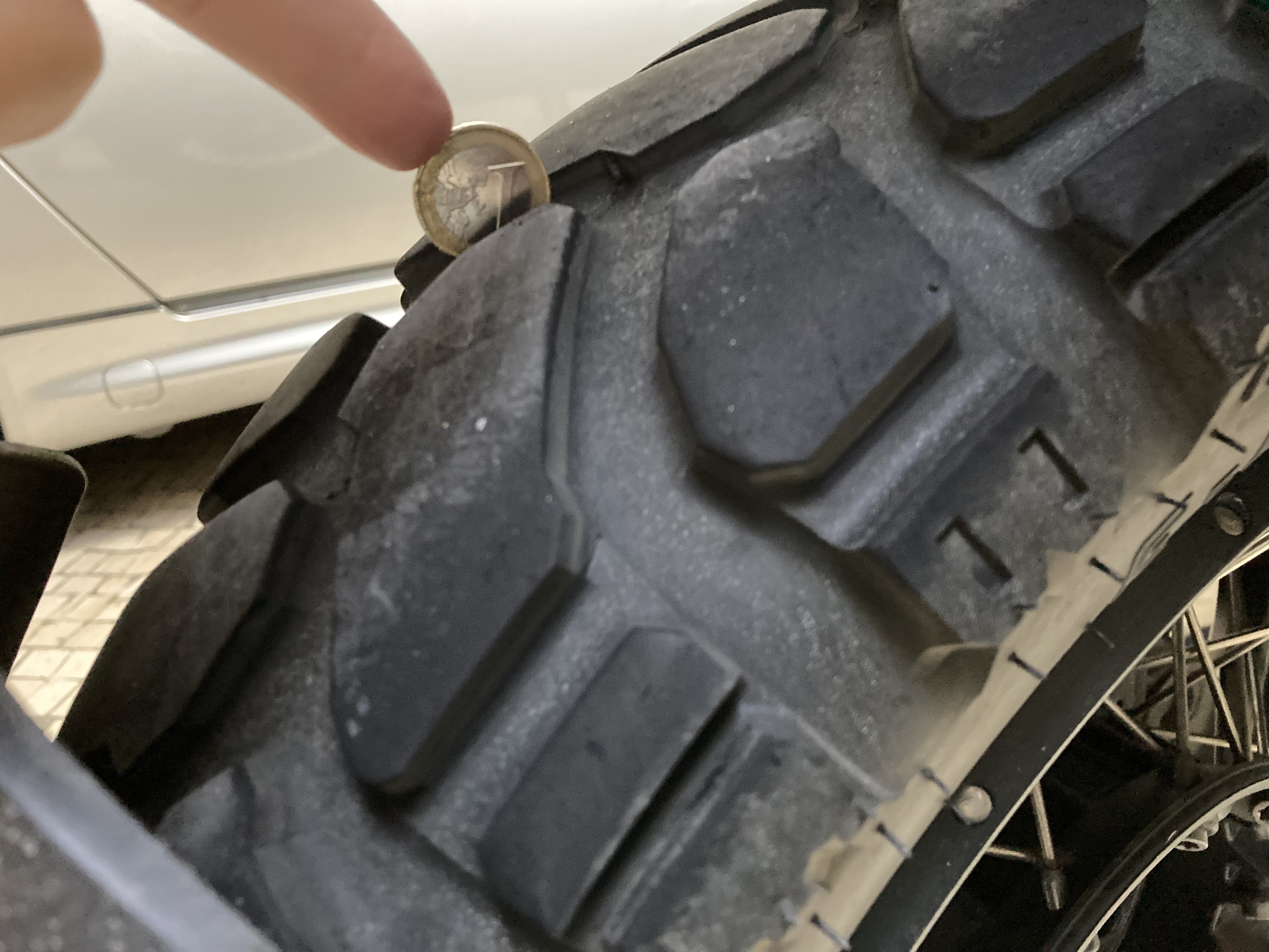

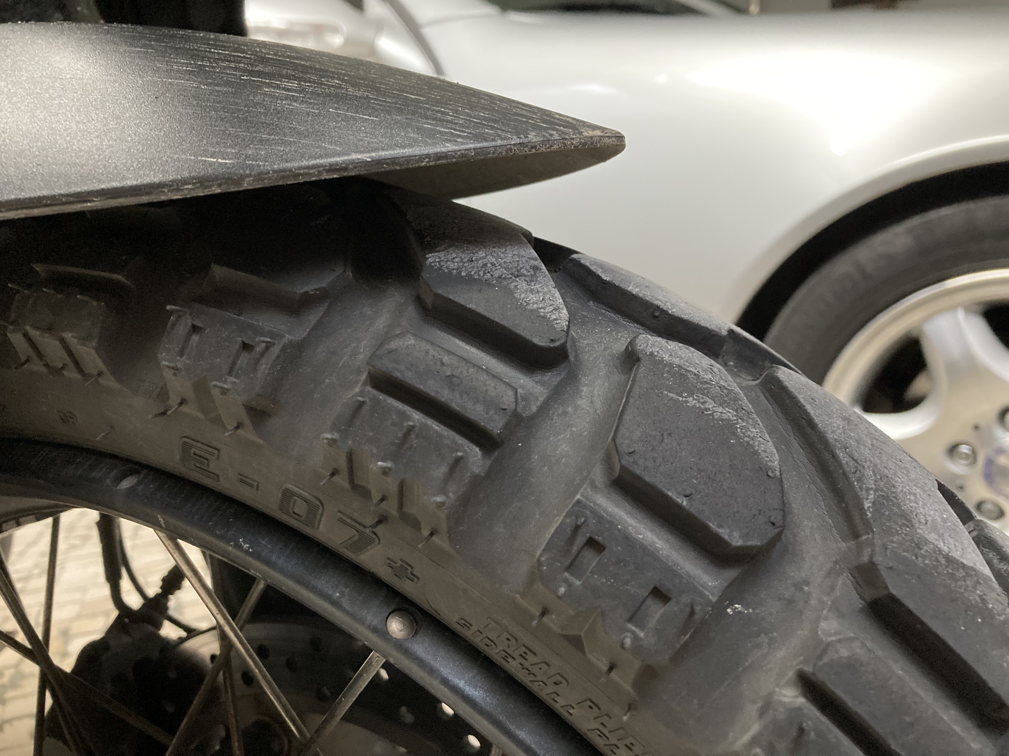

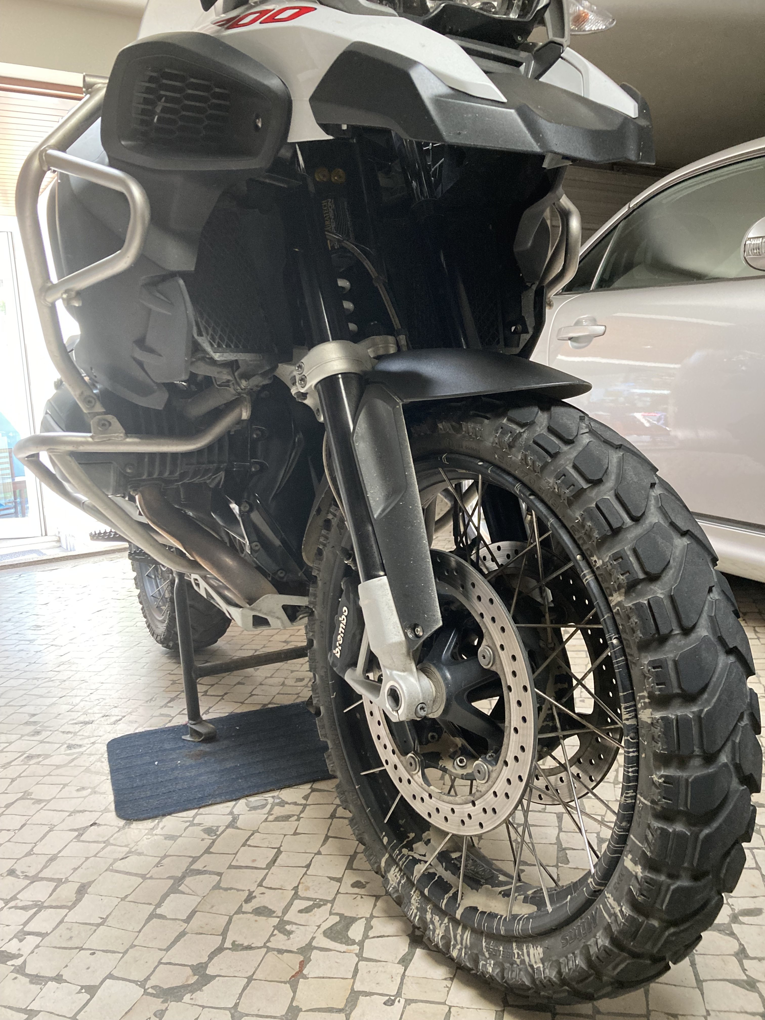

Pedro Posted January 5, 2023 Author Share Posted January 5, 2023 Now having put 6.300km on these tires, this is how they look. Notice the thread edges are still square and "bitey": They are far better than the Heidenau K60 I used previously for Morocco. The rear digs in and gets you moving a lot better on soft sand and softer terrains probably because they have no continuous center strip, but even though they dig well offroad and provide some positive traction they are still smoother than the K60 and WAY more quiet. In fact, almost as quiet as a proper road tire, couldn't be happier regarding that. They feel bulletproof compared to a road tire on rough roads, which is the main reason I got them. The front might not be as nice as the K60 on road handling when turning into corners going fastish, but it is a lot better offroad. On the road, they obviously don't handle like a road tire and feel vague at higher speeds, cornering fast while leaning over also isn't their strong suit, I end up not feeling like riding aggressively and fast, which ends up being safer. On the wet they're not brilliant but they let you know what's happening so you can adapt and ride conservatively, I did 1000km on one day mostly in rain and never felt unsafe. I am not a confident rider on the wet, so I take care regardless of tire. In short, I rate them highly as a touring tire for a heavy bike if you want to compromise and ride long distance on roads while maintaining some soft terrain ability. Their quietness compared to other tires of the genre makes them extra comfortable on a long trip. 3 1 Link to comment Share on other sites More sharing options...

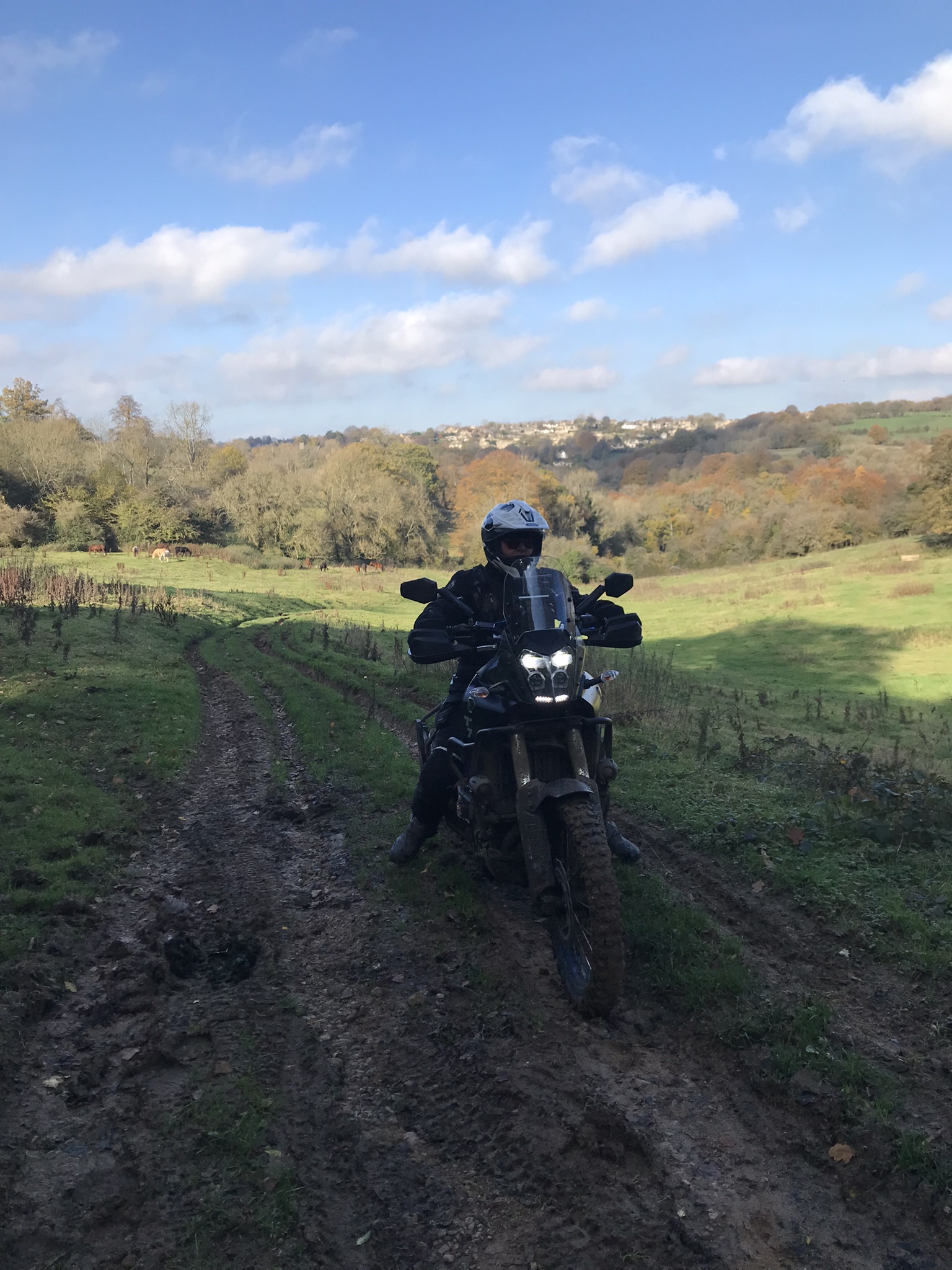

boboneleg Posted January 5, 2023 Share Posted January 5, 2023 My mate has a rear on his T700 and he does well on it even in some pretty snotty going ......... 2 Link to comment Share on other sites More sharing options...
Pedro Posted January 5, 2023 Author Share Posted January 5, 2023 6 minutes ago, boboneleg said: My mate has a rear on his T700 and he does well on it even in some pretty snotty going ......... I would say it's not knobby enough for clearing mud off the tire, and anyway mud and the GS aren't really an appealing idea to me, too much weight on the front. On a Tenere riding in that it must last forever. 2 Link to comment Share on other sites More sharing options...

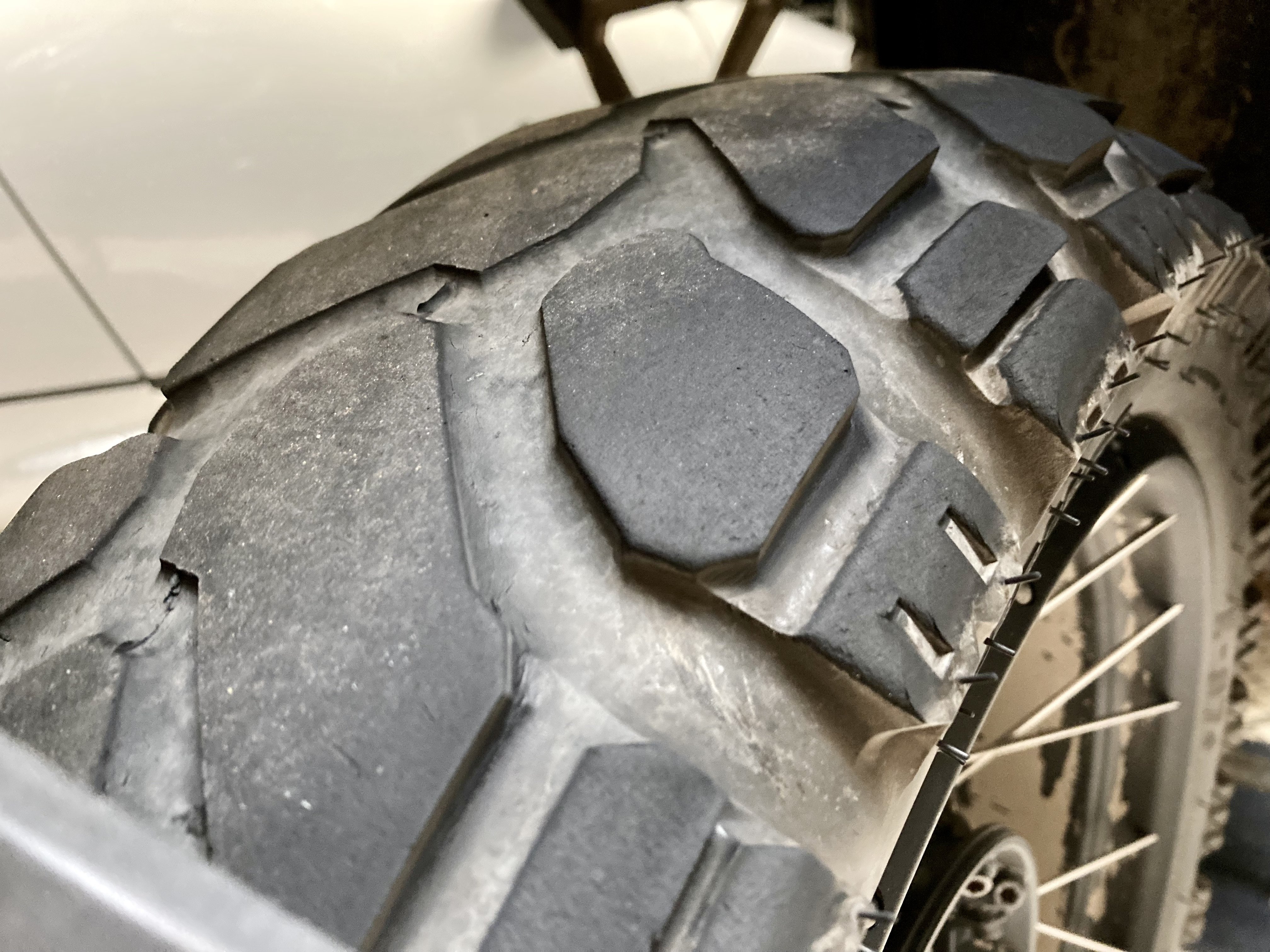

Pedro Posted January 26, 2023 Author Share Posted January 26, 2023 still looking fine after a few twisties in southern Portugal, and surprisingly comfortable on corners. 5 Link to comment Share on other sites More sharing options...

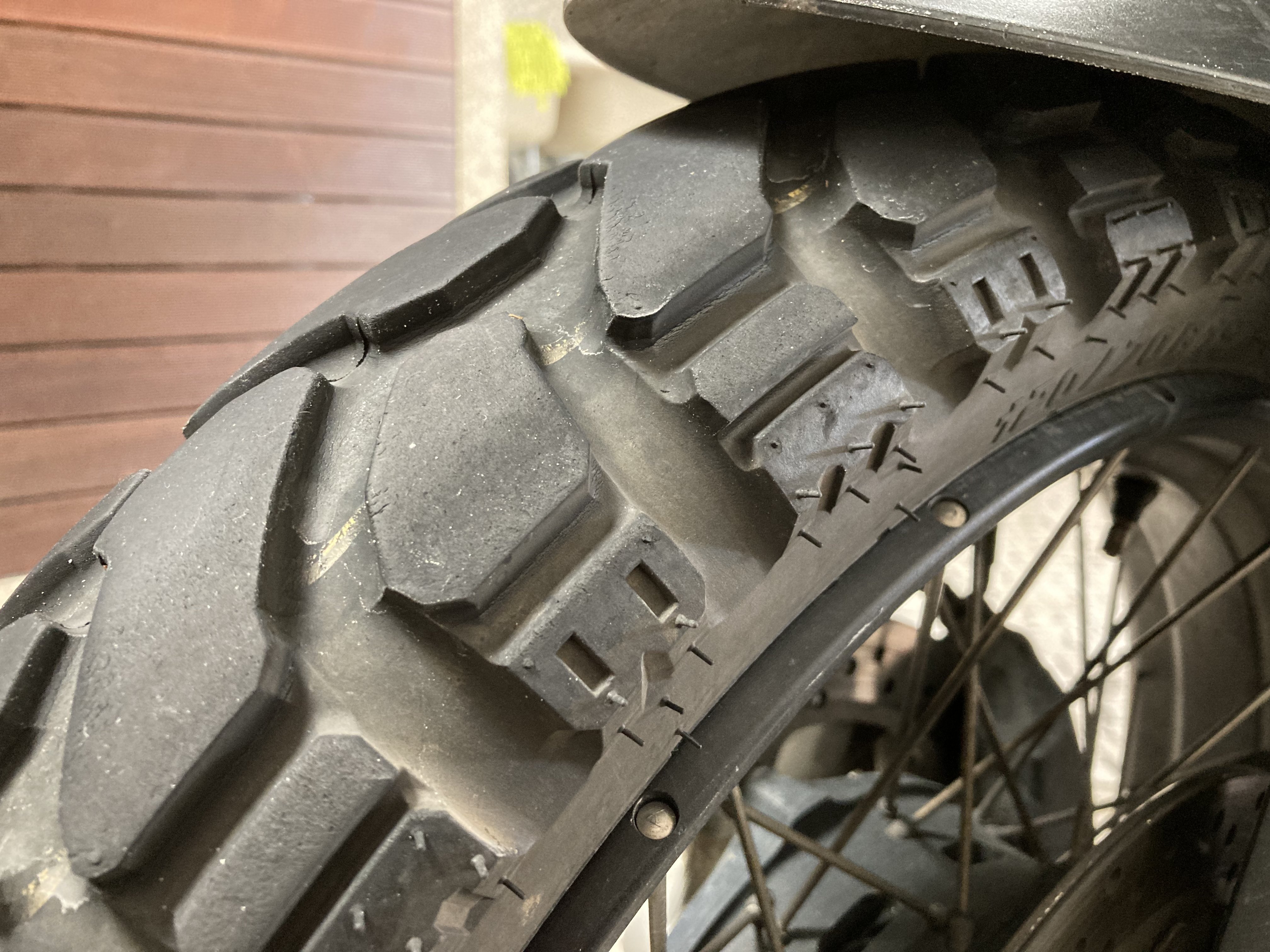

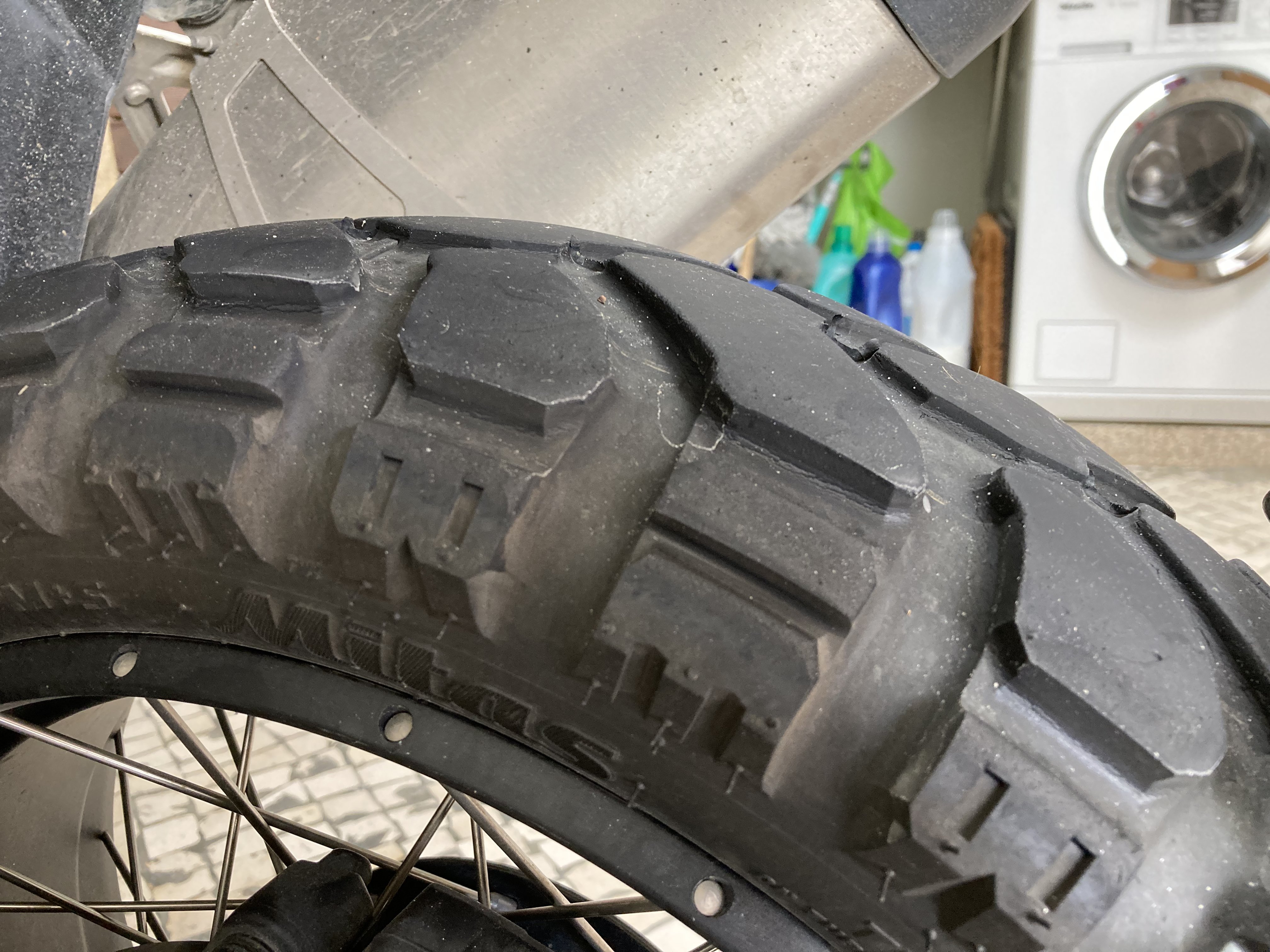

Pedro Posted March 12, 2023 Author Share Posted March 12, 2023 Now at 8900km, they’re looking like this: plenty of life left but a couple of days ago they were not the ideal tire to navigate through 10km of gridlock traffic in Porto’s wet motorway after dark. They’re proving to be a sound tire if you want a proper mixed use tire for a big bike. 3 Link to comment Share on other sites More sharing options...

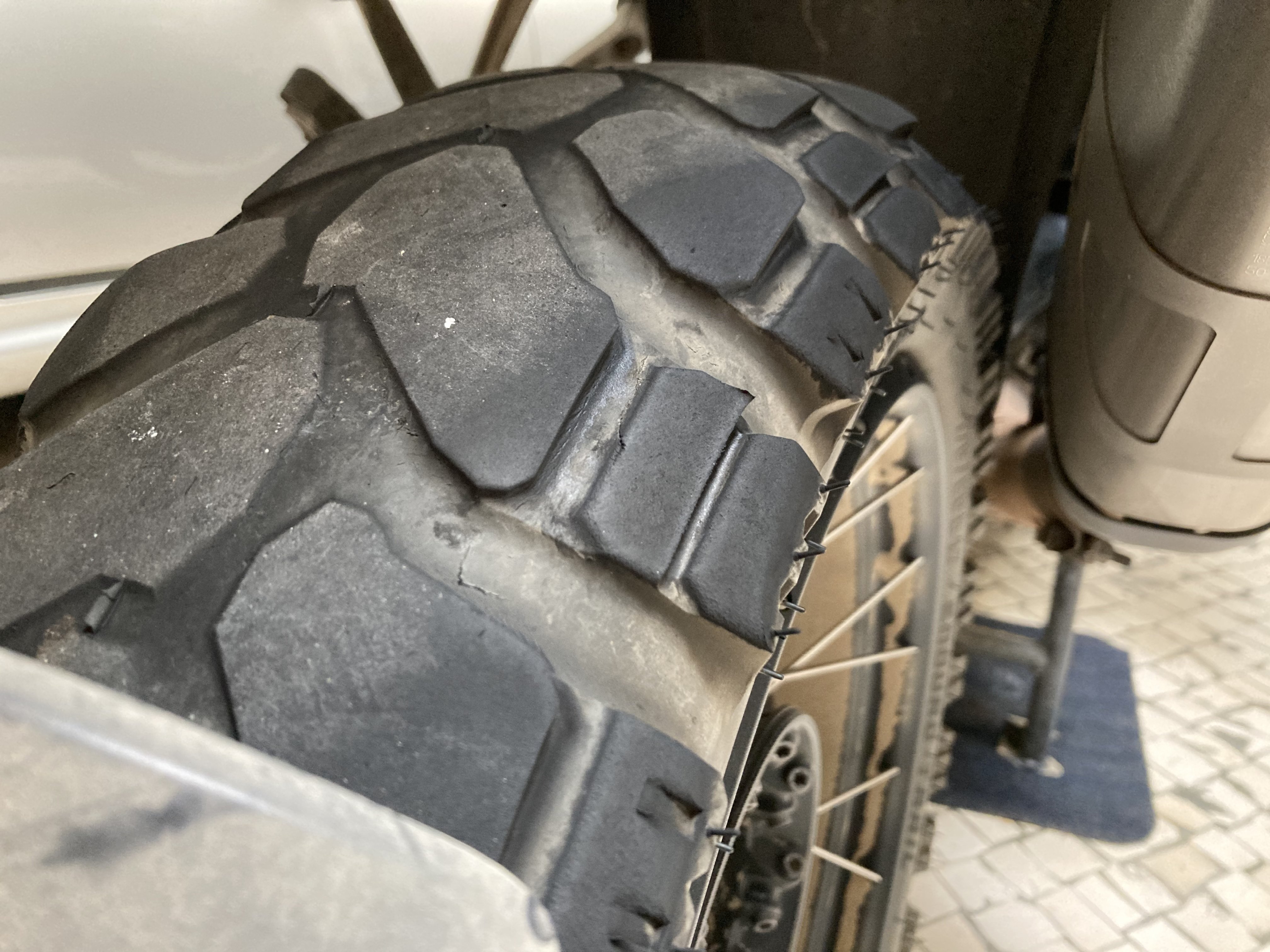

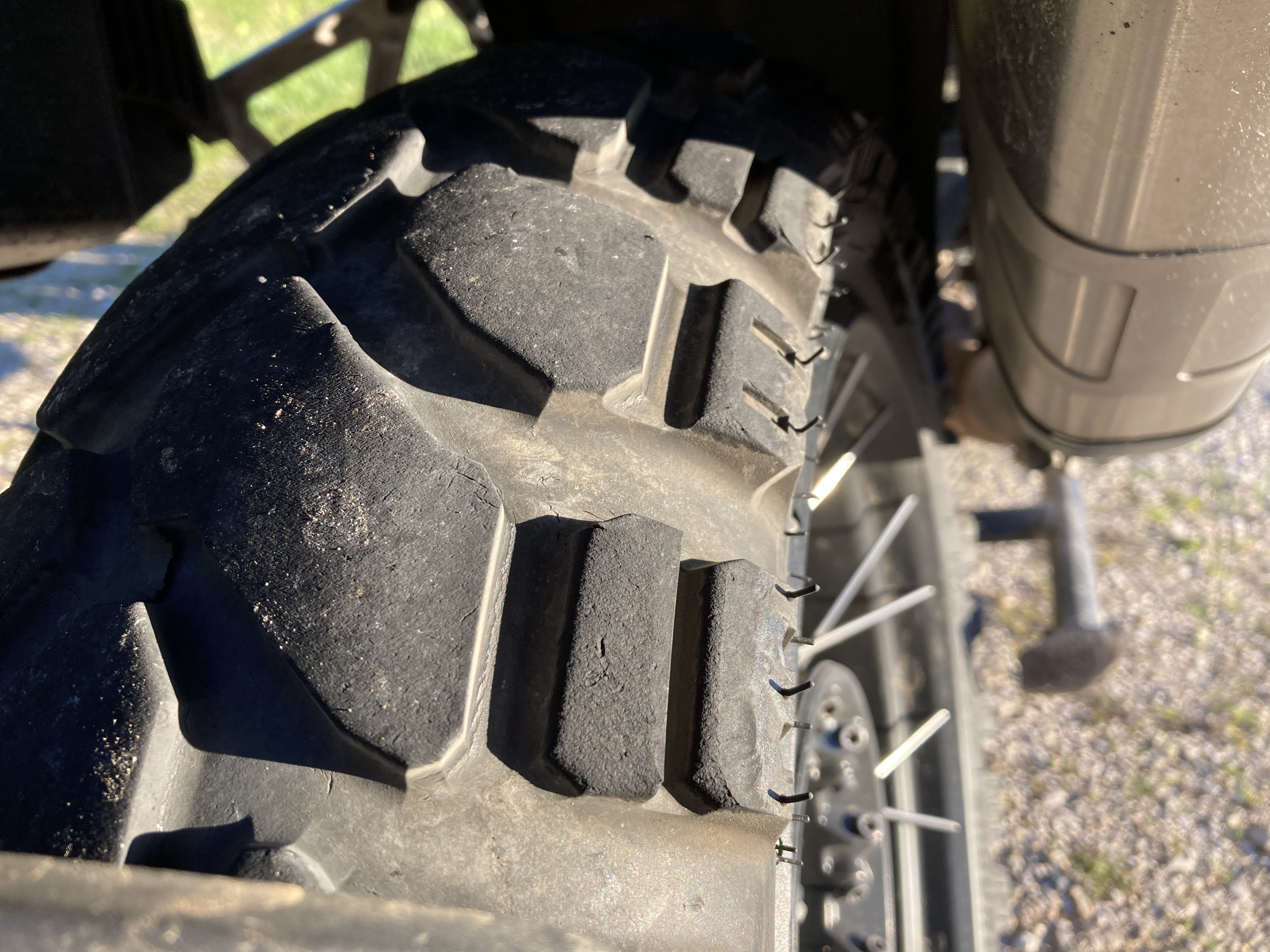

Pedro Posted July 9, 2023 Author Share Posted July 9, 2023 Now at 13000km, maybe 14, the rear looked like this earlier today after being a little punished on hot tarmac. This is approaching it's end, but they still inspire confidence in the dry. You can feel the edges flex when leaning a little, but still a lot of feeling for a mixed tire. The new ones are at home waiting, I was hoping these would last till Morocco 2023, but maybe they won't. 3 Link to comment Share on other sites More sharing options...

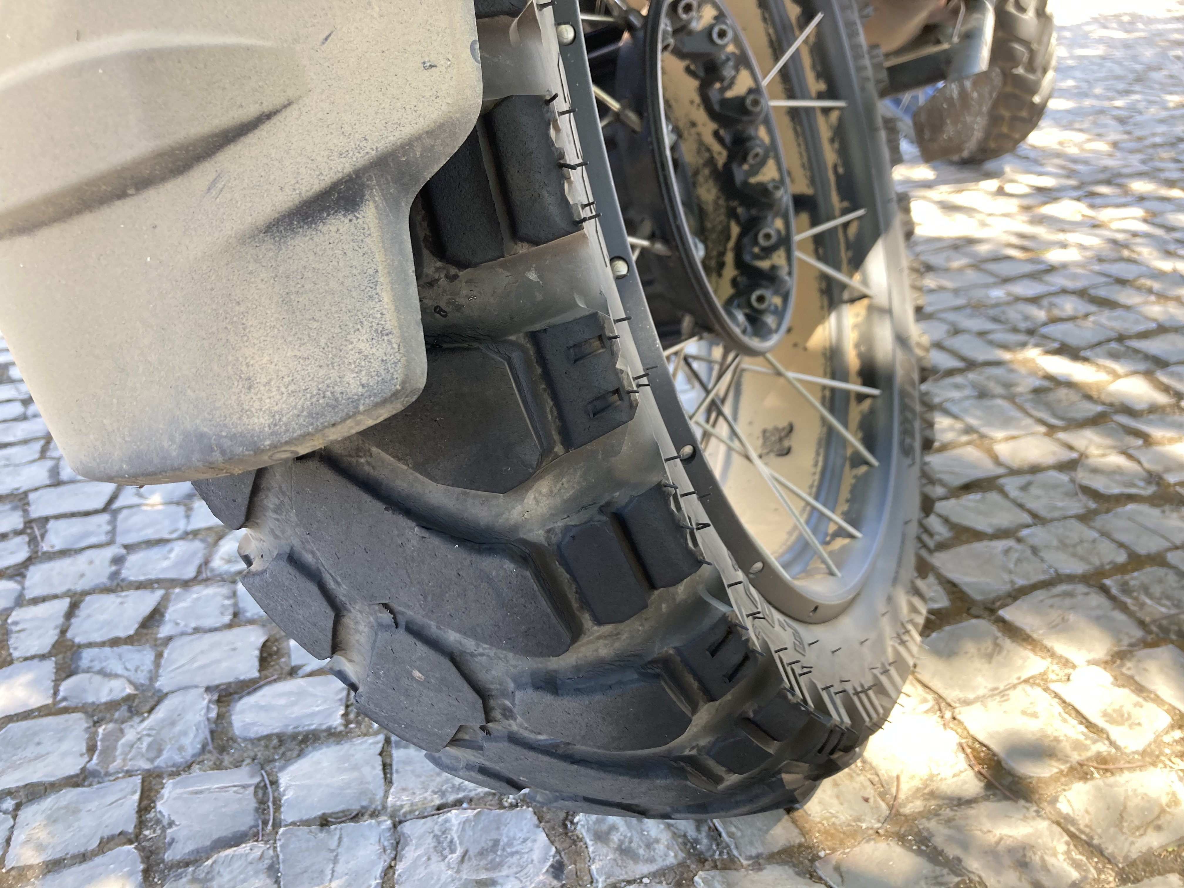

Pedro Posted August 15, 2023 Author Share Posted August 15, 2023 At 16000km these are running out of thread, but amazingly very smooth and a delight to do corners as long as you remind yourself they’re not a sporty tire. I decided to see how far the would go because I’ve never had a worn tire that handles as nicely as this (no rain, though). I think there is no better tire for a big trip on a big trail bike. In a couple of days they’ll be replaced with some Continentals. The next pair of Mitas is already in the garage, but only to be fitted a few days before the next Morocco trip, which so far is very uncertain regarding dates. 5 Link to comment Share on other sites More sharing options...
boboneleg Posted August 15, 2023 Share Posted August 15, 2023 You've definitely got your moneys worth out of those 1 Link to comment Share on other sites More sharing options...
Pedro Posted August 15, 2023 Author Share Posted August 15, 2023 6 minutes ago, boboneleg said: You've definitely got your moneys worth out of those I did I change tires when they feel bad to ride on, and amazingly these never did so far. 2 Link to comment Share on other sites More sharing options...

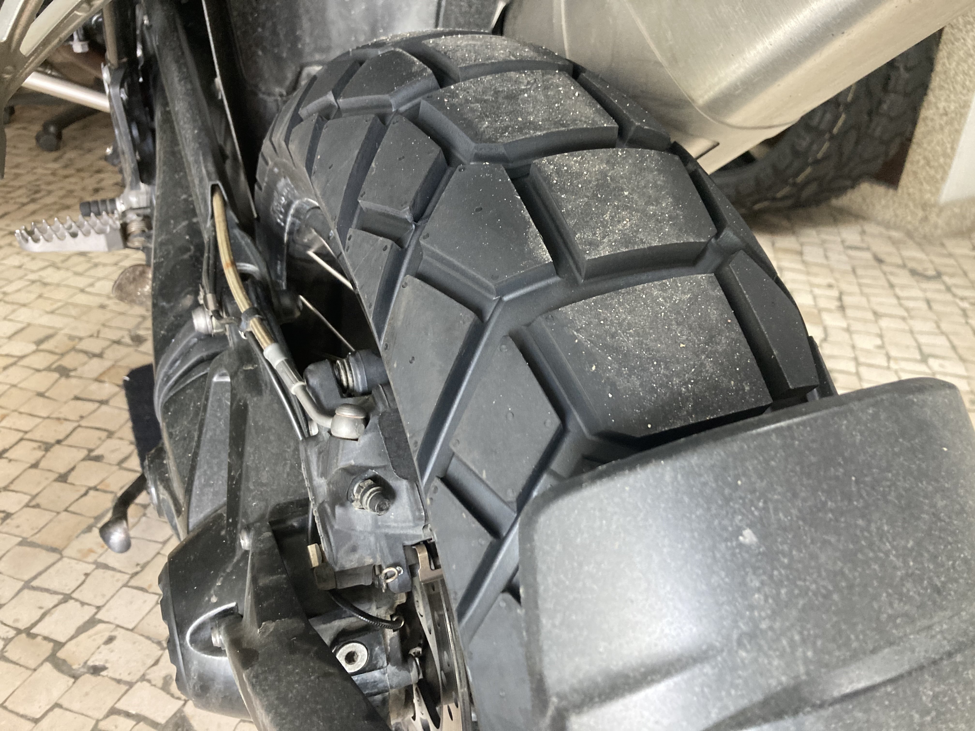

Pedro Posted August 20, 2023 Author Share Posted August 20, 2023 The mitas are gone, replaced with these which are never going to last as long but will be better for light touring on possibly wet tarmac 4 Link to comment Share on other sites More sharing options...
boboneleg Posted August 20, 2023 Share Posted August 20, 2023 Are they Continental TKC’s @Pedro ? Link to comment Share on other sites More sharing options...
