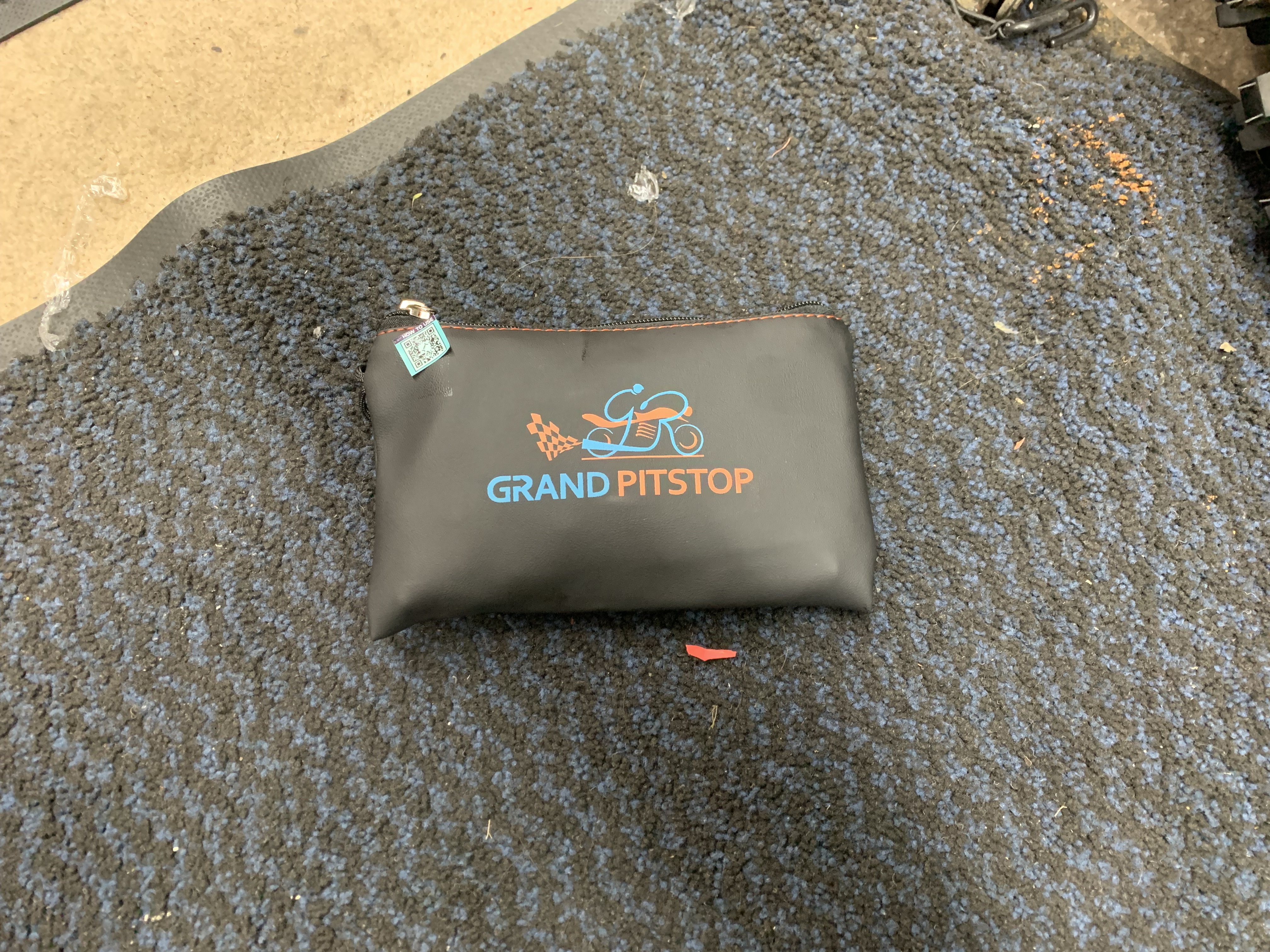

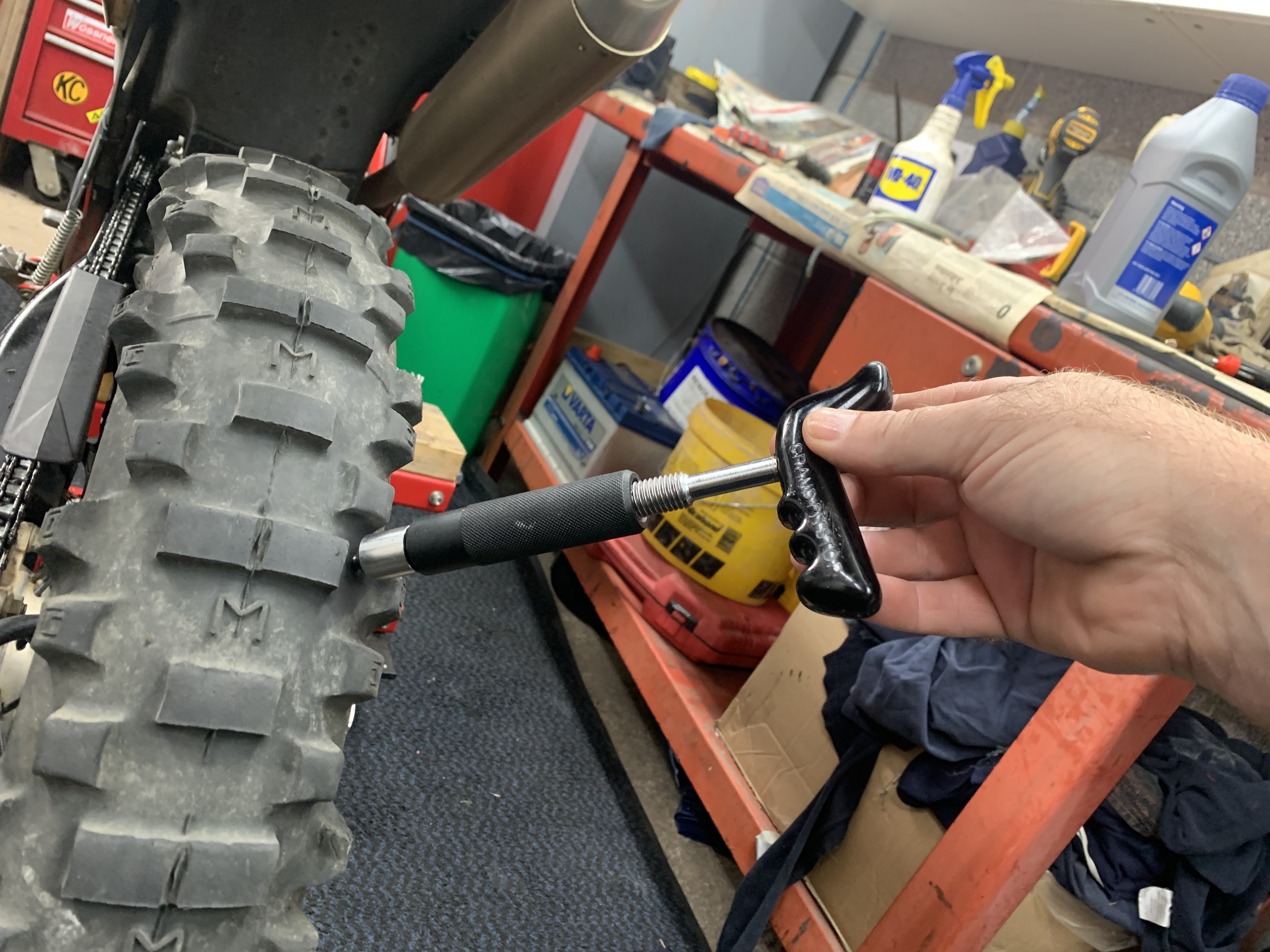

 Had a delivery half hour ago it was this tubeless repair kit

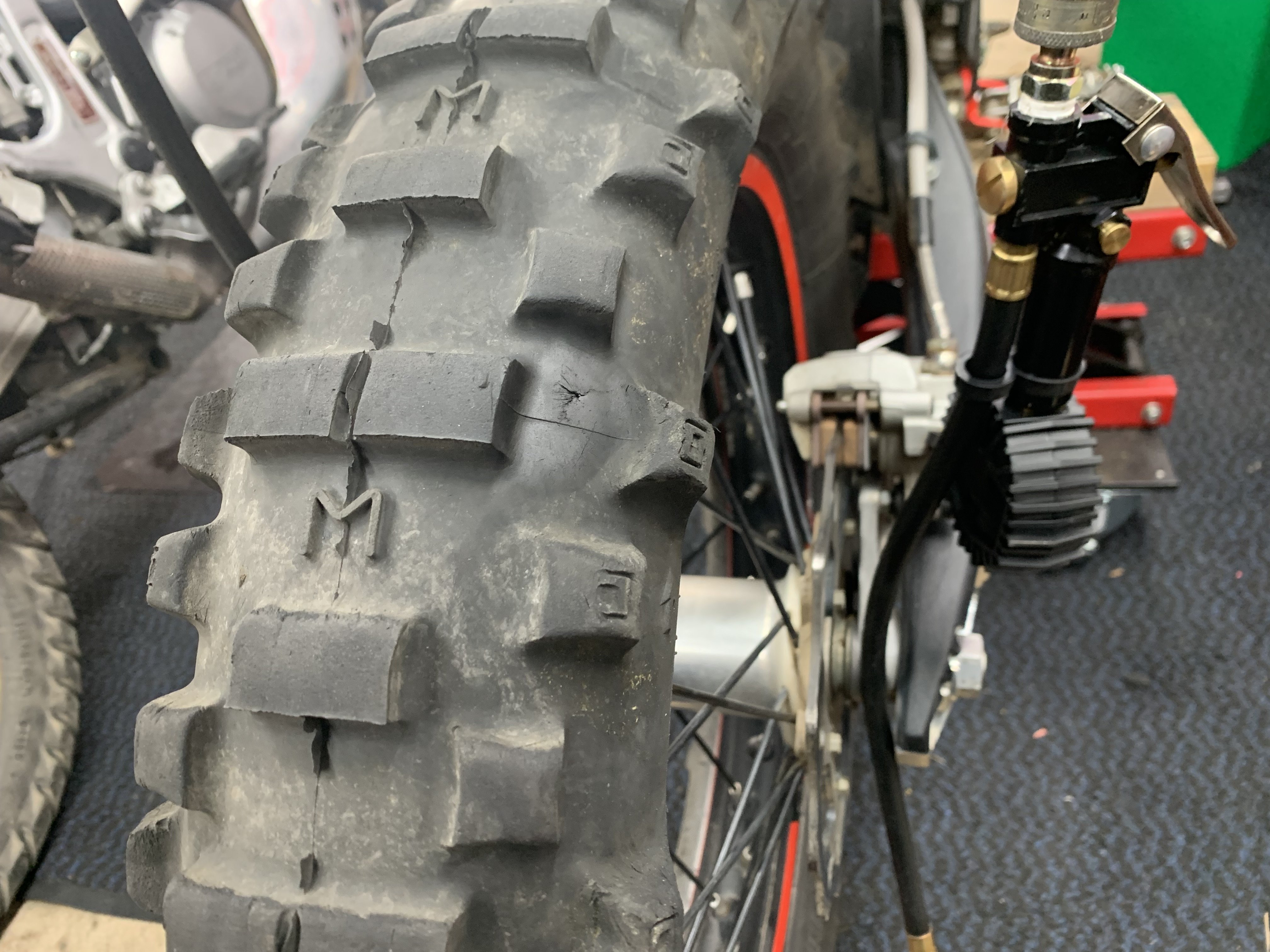

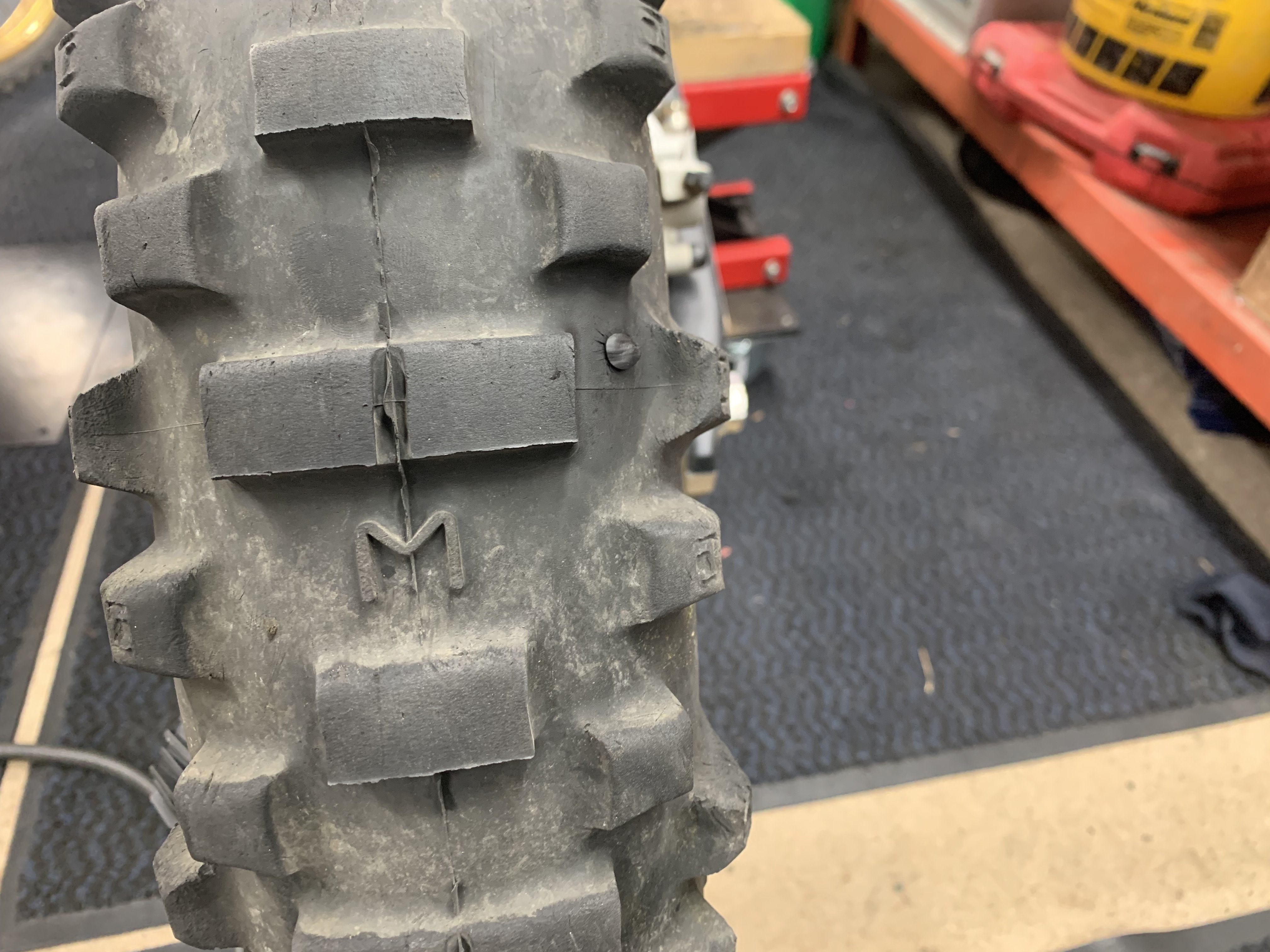

Find the hole and file it out with the supplied tool

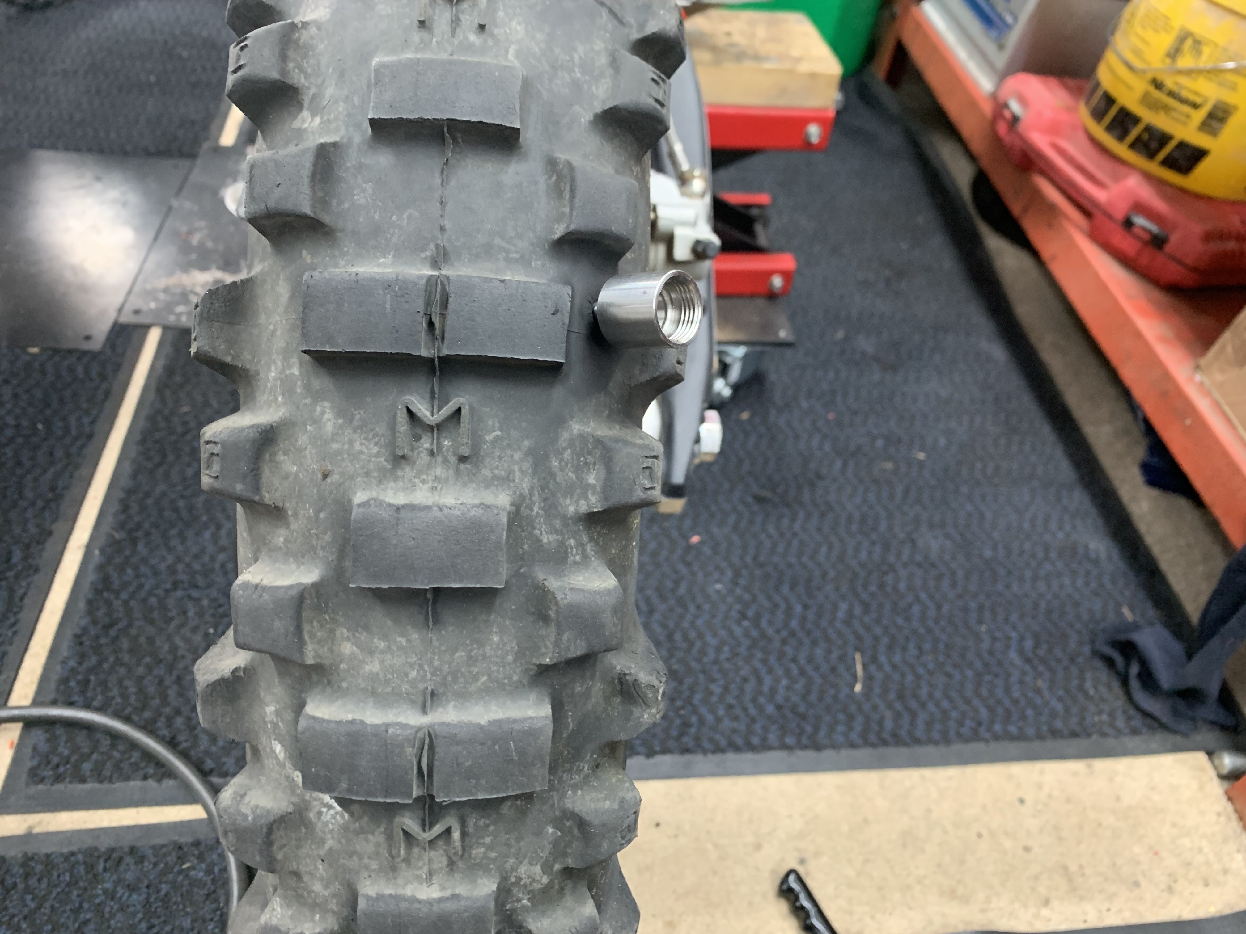

Then insert this thingy

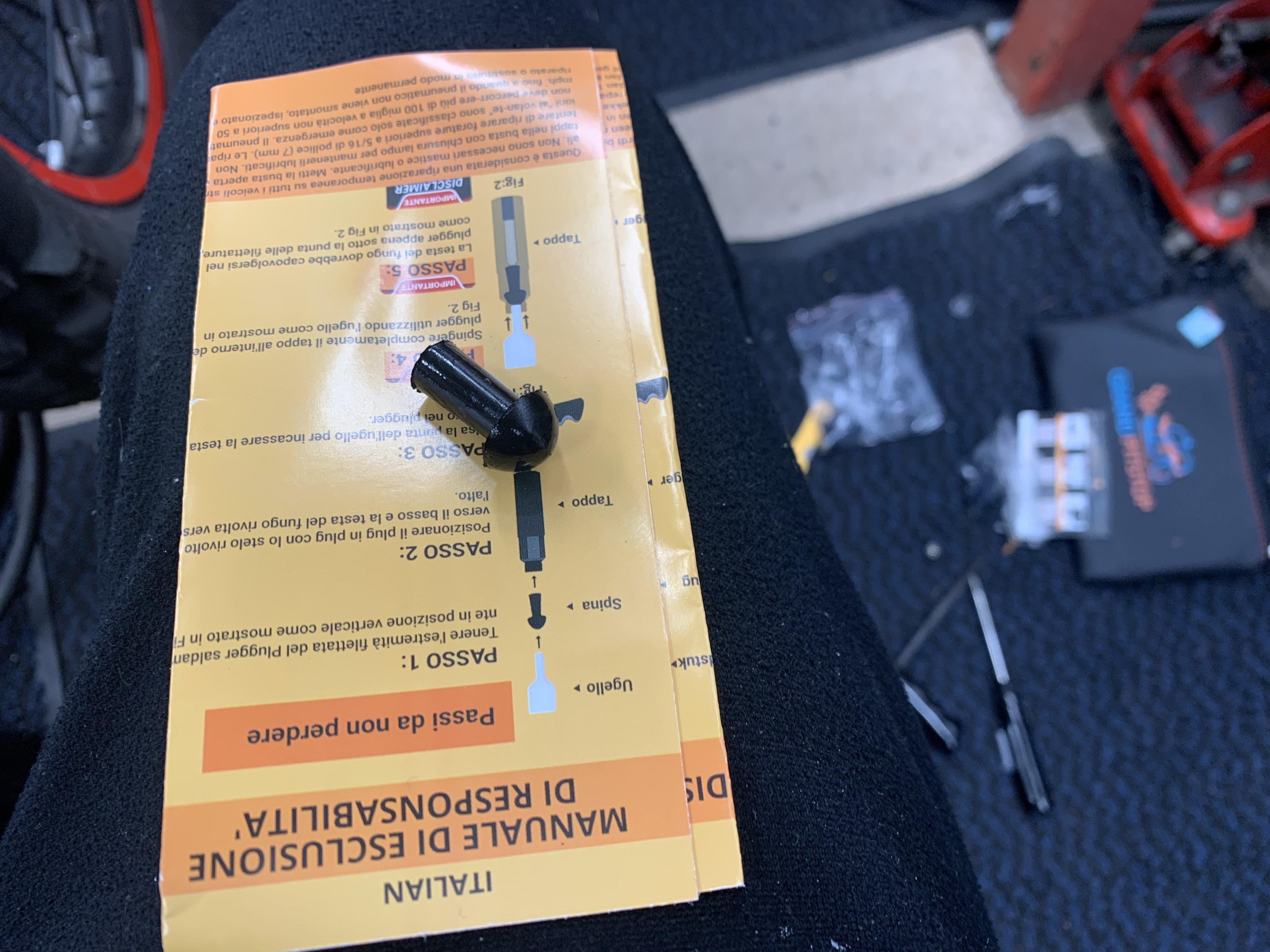

Insert this pre lubed rubber mushroom into the applicator tool
Screw applicator tool to thingy in the tyre and screw handle all the way in

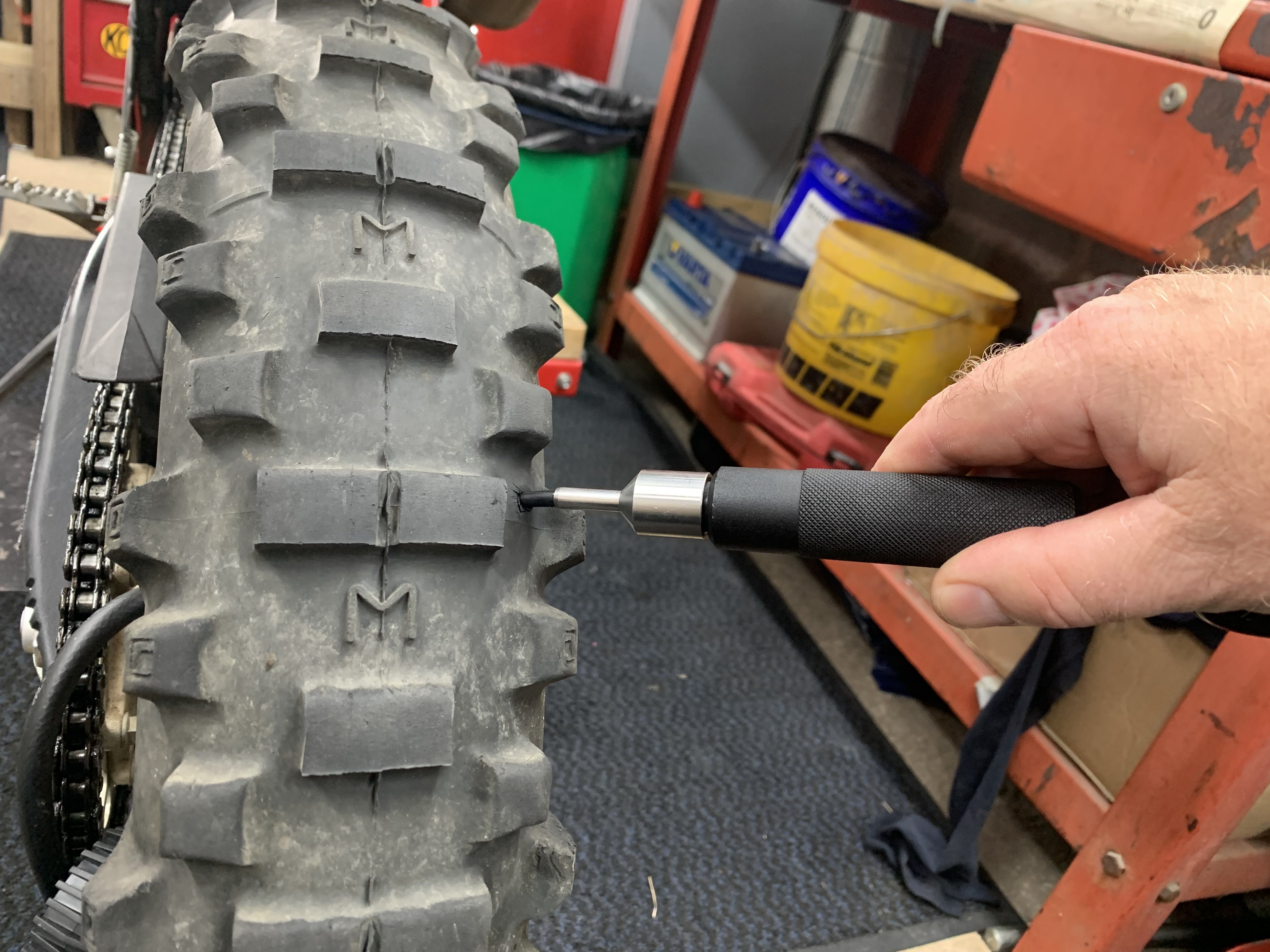

Once screwed in pull thingy out of tyre leaving mushroom behind
Pull mushroom to make sure the head is tight to the inside of the tyre
Cut off excess with supplied knife
just fixed a puncture in the rear of the Beta in less than 10 minutes and that included unpacking the kit its so easy no glue or mess. Pete when you get your top box fitted get one of these kits and an electric pump you may have to leave some of your DMB torture kit behind though.
