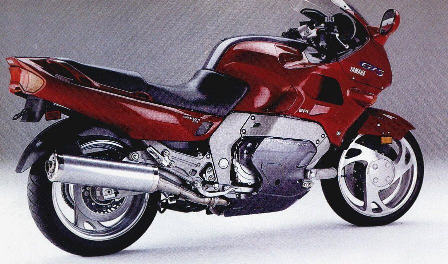

Yamaha put its alternative-front-suspension GTS1000 into production in 1993. The bike was only in the lineup for two years in the US, but survived a while longer in other markets.

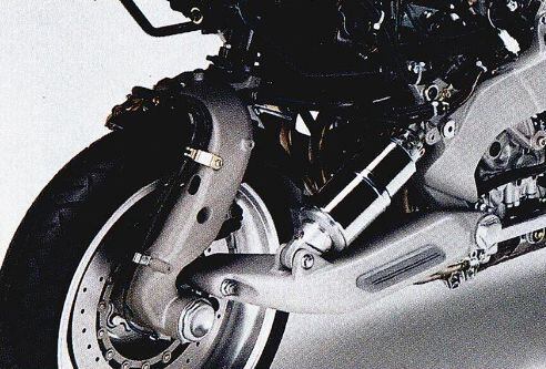

The telescopic fork has been the standard in motorcycle suspension seemingly forever. But that doesn’t mean that engineers haven’t also been seeking alternatives for equally as long. The early ‘90s were a boom time for modern alternative front-suspension concepts and design for a select few manufacturers. Prior to that, the seed had been planted by, of all people, French Petroleum company Elf, which funded the pioneering development of the Elf e-type hub-center steering and revised suspension system throughout the 1980s. By 1986, Elf racing boss Serge Rosset and rider Ron Haslam found success in Grand Prix racing on the ELF3, which was powered by Honda NS500 V-3 two-strokes. Then boutique-brand Bimota jumped on the bandwagon and brought the Tesi, a (very limited) production bike, to market. In 1993, Yamaha decided to take a crack at the alternative-suspension game with the GTS1000, the first production hub-steer motorcycle from a Japanese manufacturer.

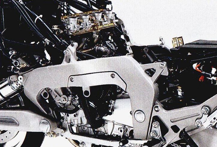

“Much like the Bimota Tesi chassis, the GTS’—called Omega because the main frame and swingarm resemble the Greek letter—utilizes two aluminum plates to sandwich the engine,” said Cycle World. “Unlike those of the Tesi, these plates are cast, not machined, and are connected with welded crossmembers. A pair of steel subframes—one holds the front fairing, handlebars, lighting assembly, and instrumentation, the other supports the tailsection—are bolted to the frame.”
Powered by a modified version of the FZR1000′s DOHC five-valve per cylinder inline-four, the GTS’ mill received different cams, revised ignition timing, and lower compression in an effort to enhance midrange torque. Claimed output was 100 hp compared to the FZR’s 126. The exhaust system also had a catalytic converter, which was rare at the time.
The GTS’ Omega-shaped frame wraps around the five-valve-per-cylinder engine donated from the FZR1000.

As suspected, the suspension design received a lot of hype. But the GTS1000 had a long list of unusual attributes for its time. Among those was the fuel-injection system, which was considered “very automotive in design,” according to Cycle World. It used an independently controlled injector for each cylinder and had nine sensors to monitor all the parameters to optimize intake efficiency. Another system, directly tied to the front end, was a braking system that used a single giant 12.9-inch three-piece disc, radially and cross-drilled and vented, clamped by a massive six-piston caliper. The US models included standard ABS.
Although Yamaha wasn’t the first to market with a hub-steer front end, it was the first mass-produced model to be built behind Bimota and its original Tesi.

“The other thing we found unsettling about the GTS was that once cranked into a turn, we weren’t at all sure what was going on beneath us. When you’ve spent your life riding motorcycles with a telescopic front fork, you pick up data from the bike and react accordingly. With the GTS, the signals are different, unfamiliar. …the handlebars seem very remote from that contact patch between the front tire and the road. There’s an awful lot of metalwork and ball-joints between the two, and with the suspension working independent of the steering, the whole feeling is one of isolation.
“Despite the slight vagueness of the front end, the suspension worked very well, and it is something of a revelation to be able to trail the brakes right to the apex of a turn without upsetting the suspension and steering.

If you didn’t know what you were ogling, the GTS1000 looked like any other sport-tourer of the era. But for those raised riding telescopic-fork-equipped bikes, it was radical.
