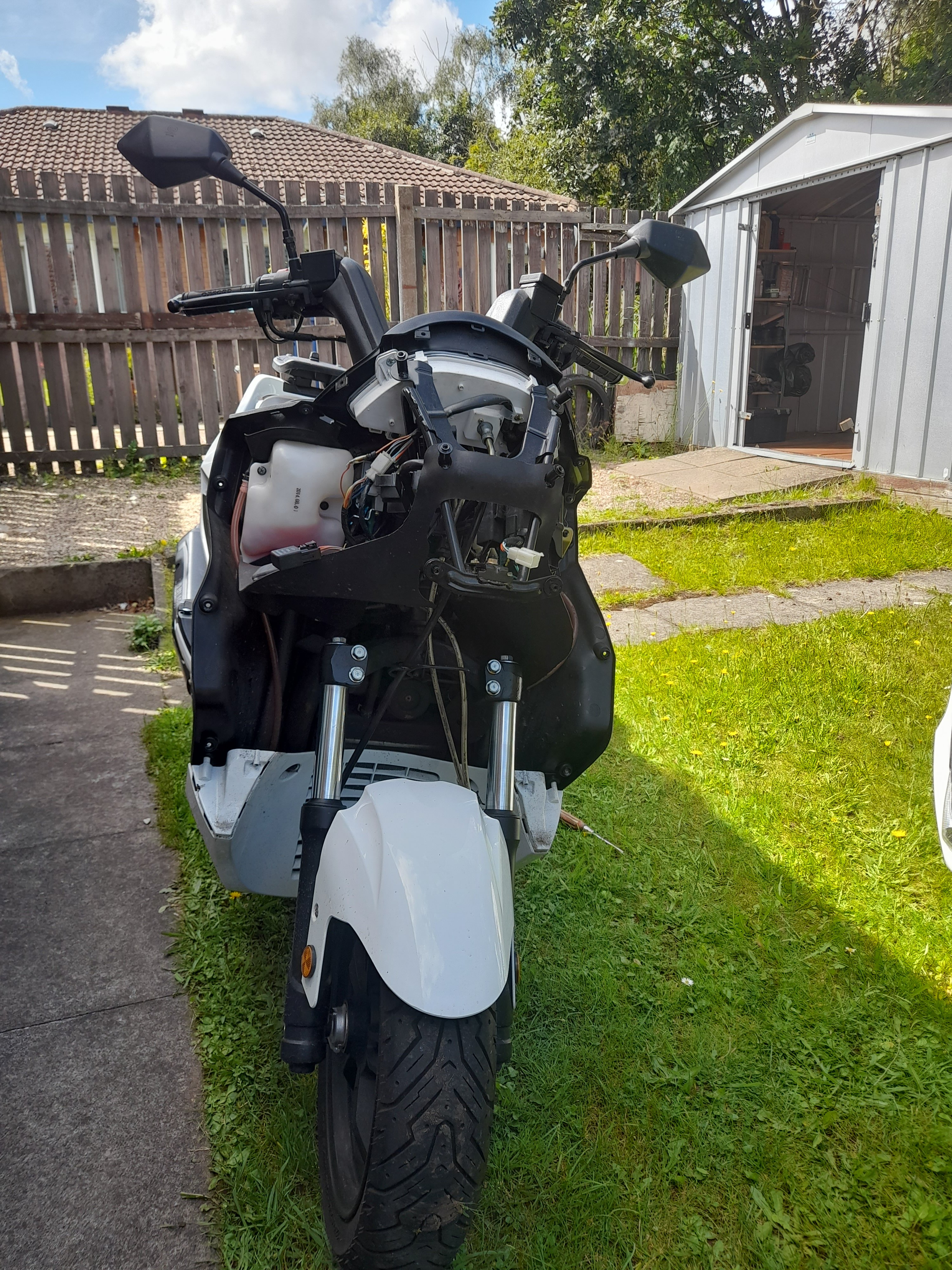

Clive Posted August 11, 2023 Share Posted August 11, 2023 No joy with the lights, they will not come on at all now Checked the fuses...all ok. Checked the relays...only has one relay for headlight dip/main beam. Checked all the block connectors that I can see...all clean and free from corrosion. I am stumped as to what it is. 3 Link to comment Share on other sites More sharing options...

Clive Posted August 11, 2023 Share Posted August 11, 2023 1 hour ago, Sir Fallsalot said: I'm no expert but could it be there is no light fitted on the bike Headlight, 2 LED running lights, LED Rear light.....its like Blackpool illuminations when they are all on. Just been into the shed and the bastids came on ☺,,,turned it off, then back on................Nothing. 1 1 Link to comment Share on other sites More sharing options...

boboneleg Posted August 11, 2023 Share Posted August 11, 2023 3 hours ago, Clive said: Headlight, 2 LED running lights, LED Rear light.....its like Blackpool illuminations when they are all on. Just been into the shed and the bastids came on ☺,,,turned it off, then back on................Nothing. Check the earth from the battery, could be loose. 1 Link to comment Share on other sites More sharing options...
Slowlycatchymonkey Posted August 11, 2023 Share Posted August 11, 2023 2 hours ago, Six30 said: to or too ... bath, sink , same difference , i have a picture of you in my head now of my old English teacher , she wore a massive cord skirt and sandals , a mans suit jacket with leather patches on the elbows, glasses with lenses that looked like the bottom of two pint glasses...and a wart on her nose the size of a golf ball. Yep that was me, you’re still a disappointment. 4 Link to comment Share on other sites More sharing options...
Clive Posted August 11, 2023 Share Posted August 11, 2023 2 hours ago, boboneleg said: Check the earth from the battery, could be loose. I am going to start at the battery, check the connection, check the earth connections to the frame and engine, also put a new fuse in. I have put the battery on charge so it will be fully charged, just to eliminate the possibility that a low battery is causing the problem, and take the tupperware off so I can gain access to the ignition switch, which it is keyless, and check the wiring and connectors around that area. 1 Link to comment Share on other sites More sharing options...
