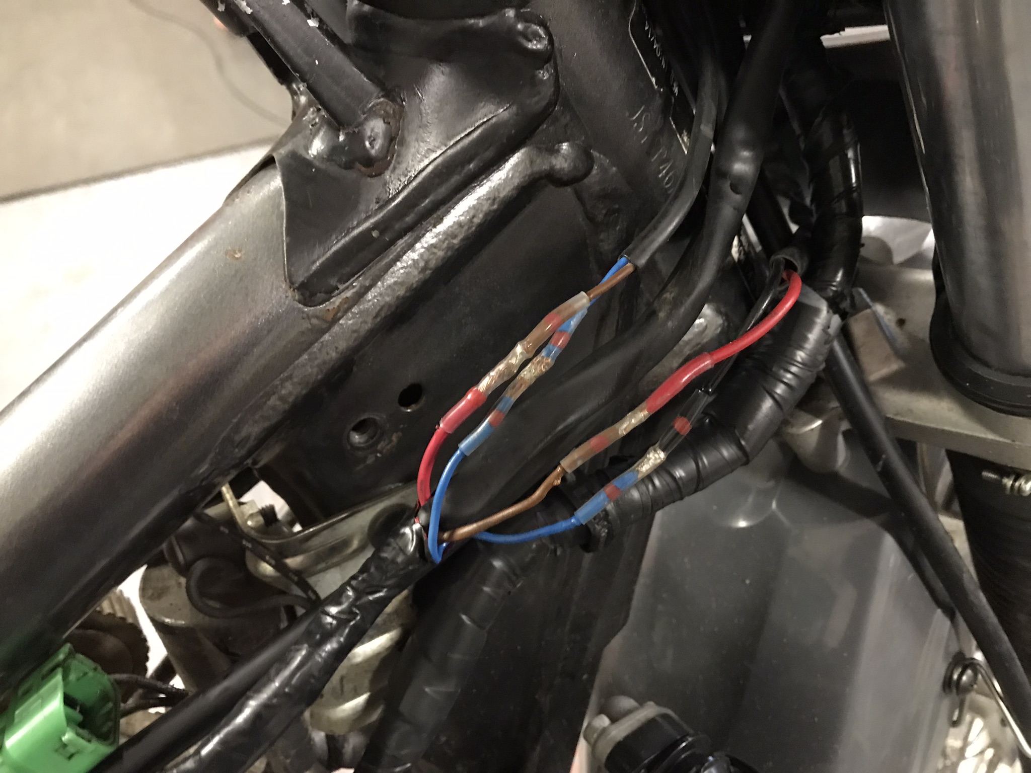

Sir Fallsalot Posted December 7, 2022 Share Posted December 7, 2022 3 minutes ago, boboneleg said: I had a 'catastrophic ignition failure' (my boss's words ) at work today on the donkey as I attempted to go home. No lights, no ignition , nothing. I bought this bike off a mate of mine, when he went to buy it a year earlier the original owner had lost the keys so he had to hot wire it My mate then built in an ignition with a toggle switch built in, I have never been completely happy with it and today it failed. He used block connectors to join the wiring and the constant movement of the wiring around the headstock had caused the terminals to break free from the connectors and hence the failure. We cut the connectors out and re-joined the wiring with solder seal connectors, these make a much neater job and are far less bulky. I just sent my mate a message and he has got a bit bolshy saying that the connectors we've used are rubbish . My boss and me are more than happy with the job, we've both used the solder seal connectors for various wiring jobs in the past and neither of us has had a failure . Does anyone else use these , what are your experience's ? Not used them myself Bob but that would definitely be better than block connectors 5 Link to comment Share on other sites More sharing options...

XTreme Posted December 7, 2022 Author Share Posted December 7, 2022 9 minutes ago, Sir Fallsalot said: Not used them myself Bob but that would definitely be better than block connectors Yeh....I thought that! 3 Link to comment Share on other sites More sharing options...

Tango Posted December 7, 2022 Share Posted December 7, 2022 53 minutes ago, boboneleg said: I had a 'catastrophic ignition failure' (my boss's words ) at work today on the donkey as I attempted to go home. No lights, no ignition , nothing. I bought this bike off a mate of mine, when he went to buy it a year earlier the original owner had lost the keys so he had to hot wire it My mate then built in an ignition with a toggle switch built in, I have never been completely happy with it and today it failed. He used block connectors to join the wiring and the constant movement of the wiring around the headstock had caused the terminals to break free from the connectors and hence the failure. We cut the connectors out and re-joined the wiring with solder seal connectors, these make a much neater job and are far less bulky. I just sent my mate a message and he has got a bit bolshy saying that the connectors we've used are rubbish . My boss and me are more than happy with the job, we've both used the solder seal connectors for various wiring jobs in the past and neither of us has had a failure . Does anyone else use these , what are your experience's ? I've only ever soldered the wires together and put some heatshrink over the joints, which is pretty much what you've got there, Bob. Red to brown and brown to red? I guess it works. 2 1 Link to comment Share on other sites More sharing options...

boboneleg Posted December 7, 2022 Share Posted December 7, 2022 1 hour ago, Tango said: I've only ever soldered the wires together and put some heatshrink over the joints, which is pretty much what you've got there, Bob. Red to brown and brown to red? I guess it works. Well it definitely works cos I rode it home The principle of the solder seal connectors is the same as you do it (and how I used to do it) but without all the faff. All you need are some wire strippers and a good heat gun . 2 1 Link to comment Share on other sites More sharing options...
Catteeclan Posted December 8, 2022 Share Posted December 8, 2022 10 hours ago, boboneleg said: Well it definitely works cos I rode it home The principle of the solder seal connectors is the same as you do it (and how I used to do it) but without all the faff. All you need are some wire strippers and a good heat gun . I've used them and found them good. Only thing I'd do is extend the wires having them right away from the headstock movement. 3 Link to comment Share on other sites More sharing options...

Buckster Posted December 8, 2022 Share Posted December 8, 2022 14 hours ago, boboneleg said: I had a 'catastrophic ignition failure' (my boss's words ) at work today on the donkey as I attempted to go home. No lights, no ignition , nothing. I bought this bike off a mate of mine, when he went to buy it a year earlier the original owner had lost the keys so he had to hot wire it My mate then built in an ignition with a toggle switch built in, I have never been completely happy with it and today it failed. He used block connectors to join the wiring and the constant movement of the wiring around the headstock had caused the terminals to break free from the connectors and hence the failure. We cut the connectors out and re-joined the wiring with solder seal connectors, these make a much neater job and are far less bulky. I just sent my mate a message and he has got a bit bolshy saying that the connectors we've used are rubbish . My boss and me are more than happy with the job, we've both used the solder seal connectors for various wiring jobs in the past and neither of us has had a failure . Does anyone else use these , what are your experience's ? I use them and I am a qualified electronics engineer so go figure. 2 Link to comment Share on other sites More sharing options...
