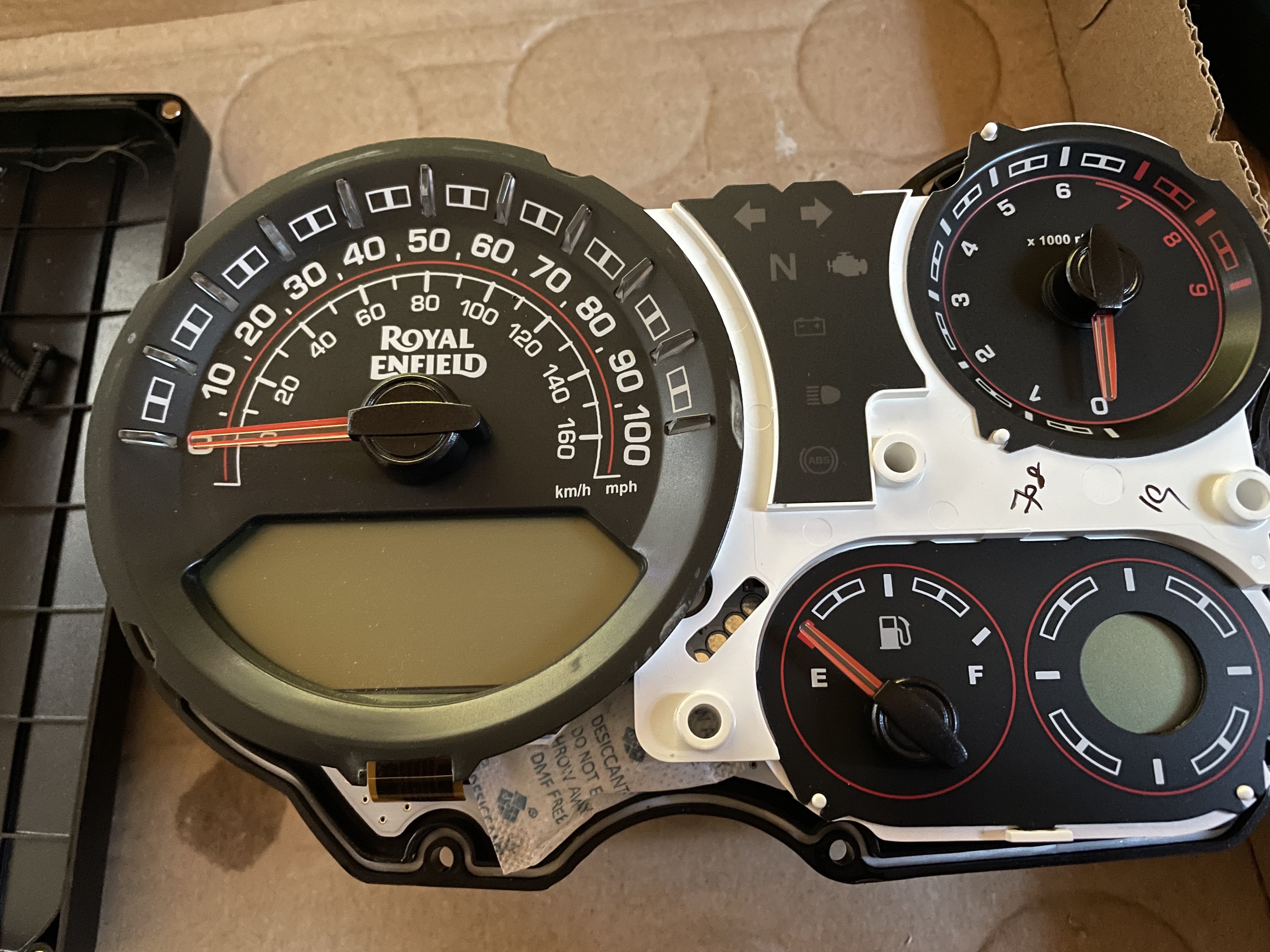

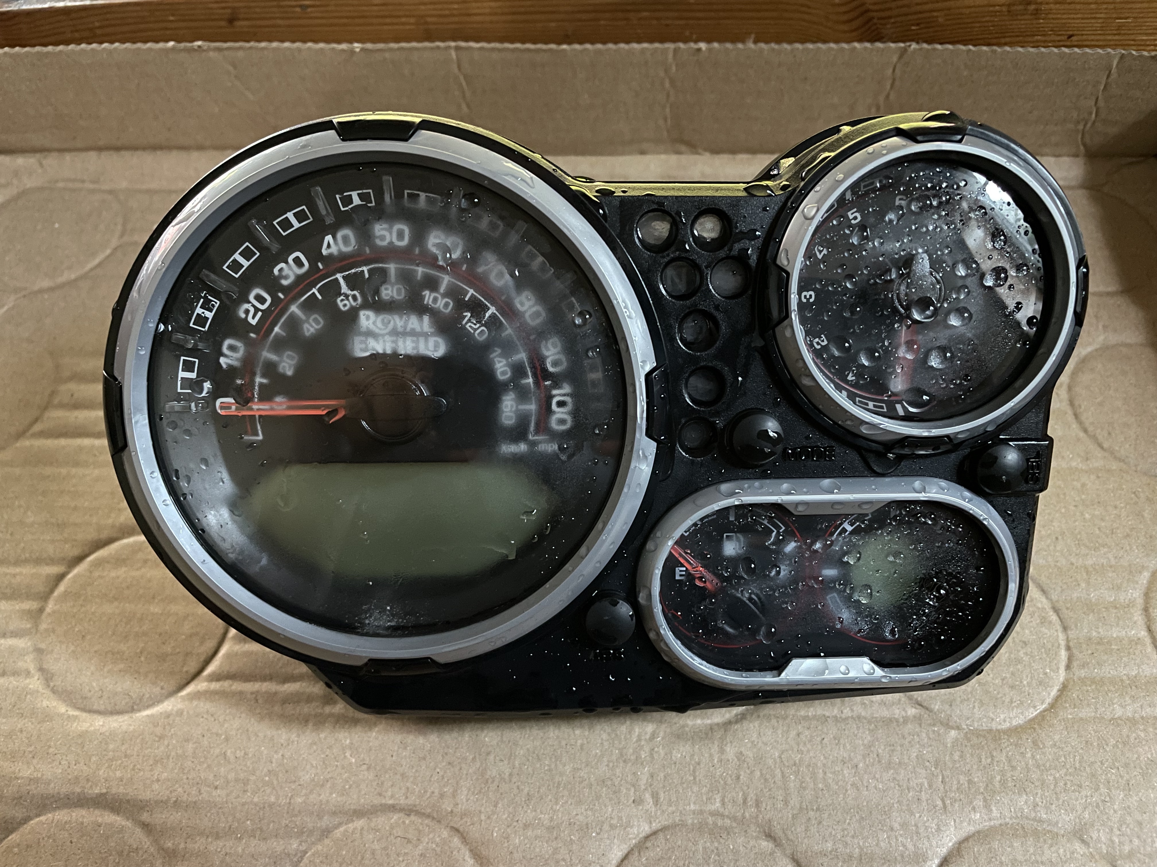

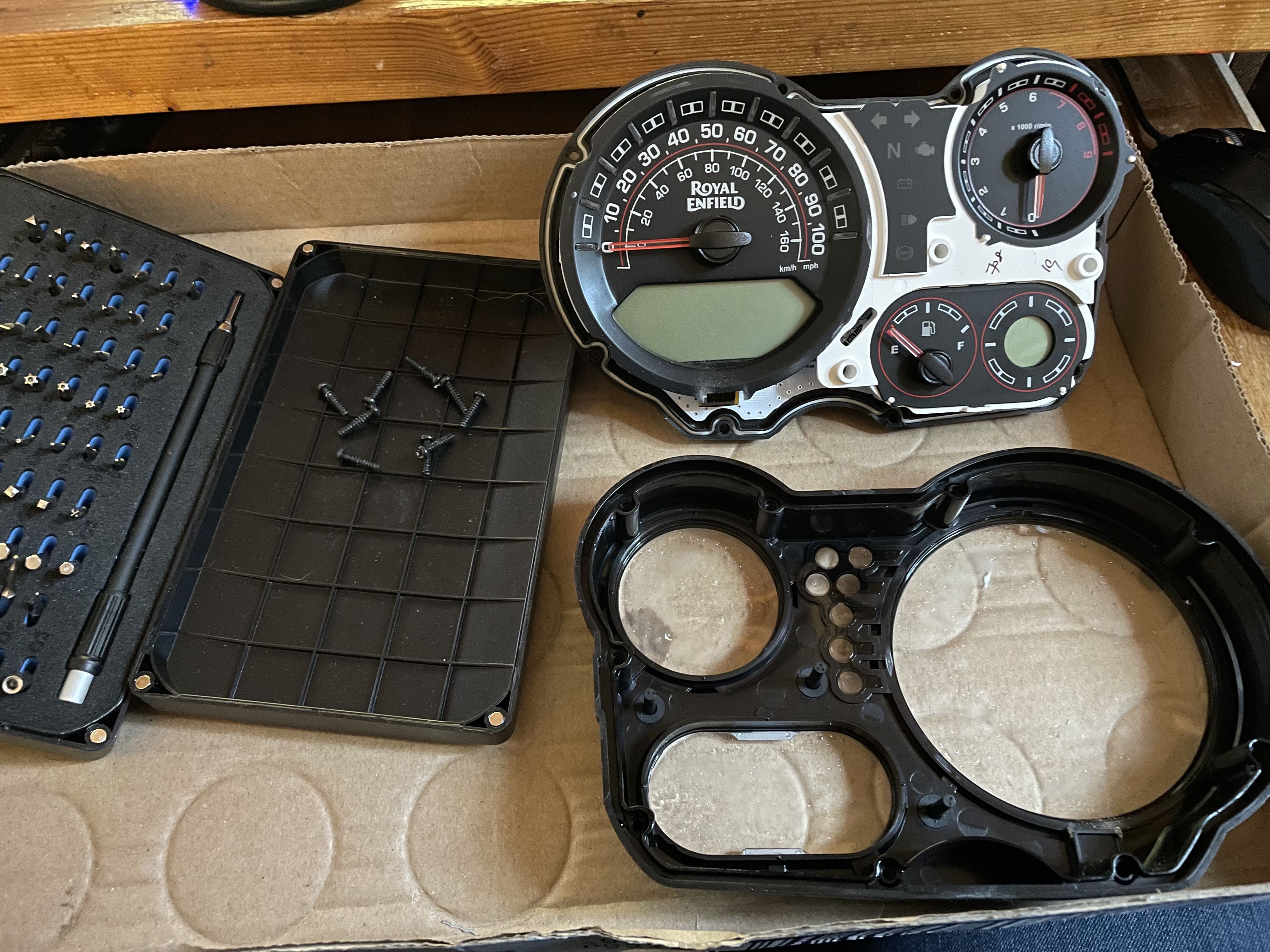

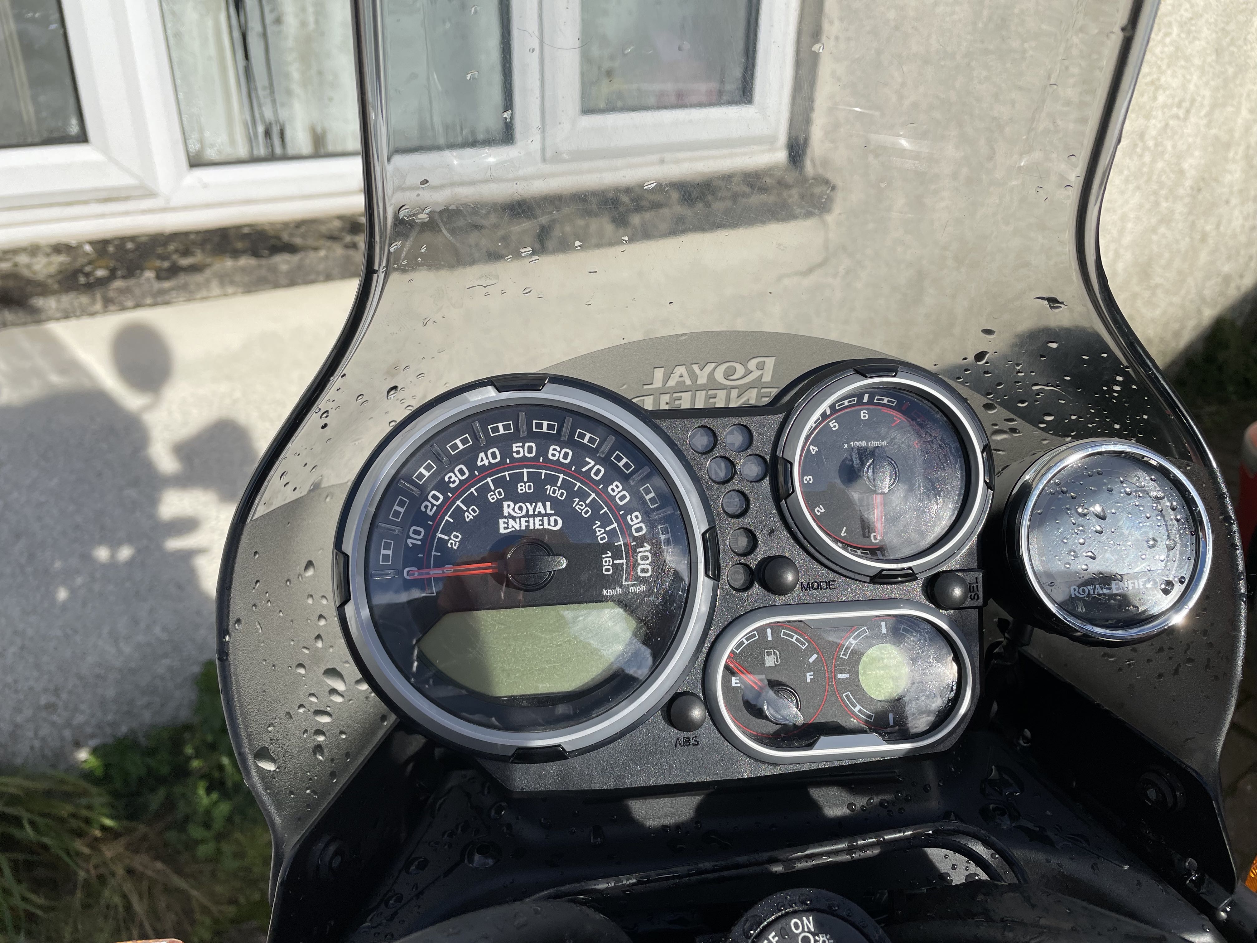

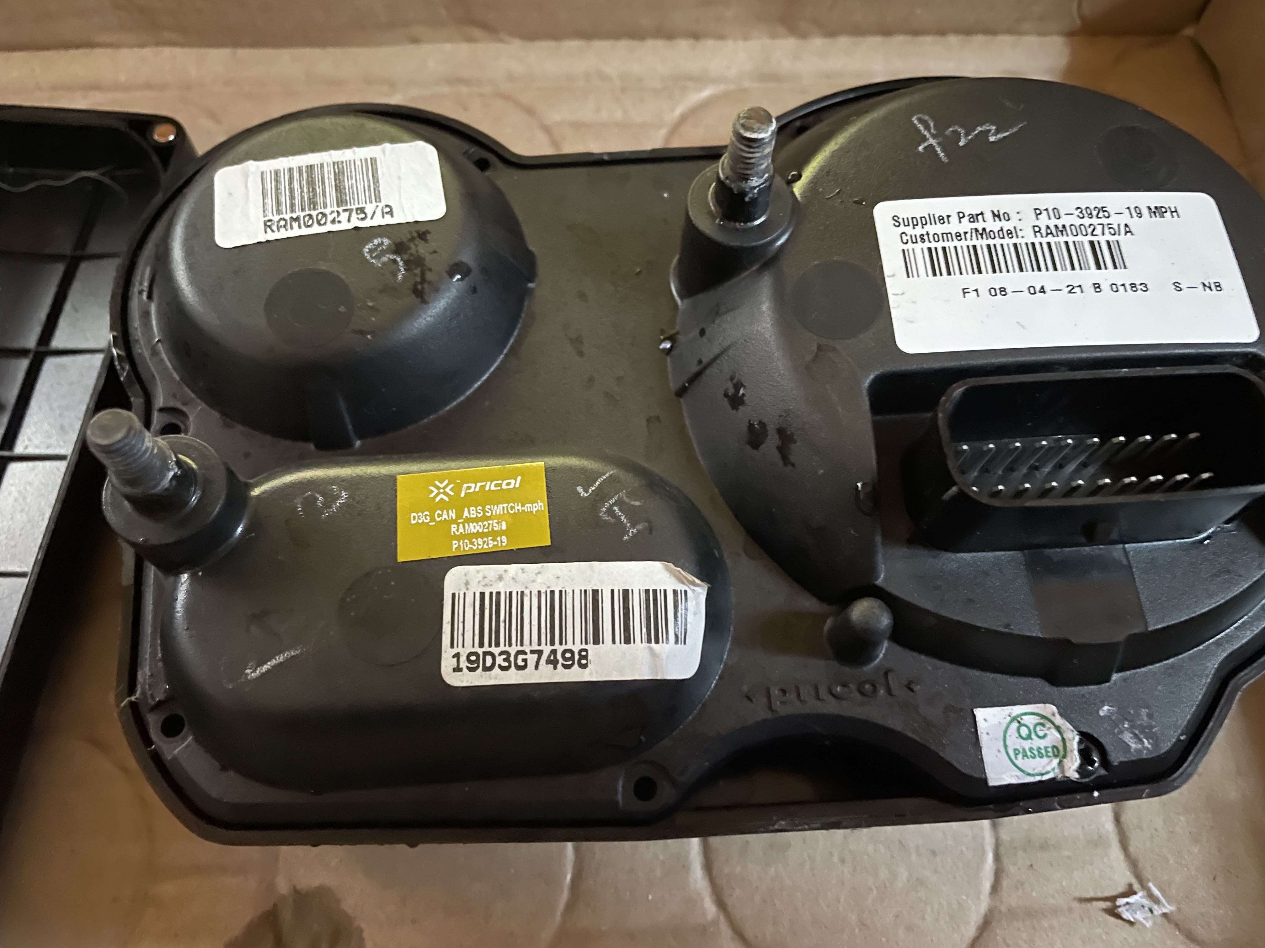

Saul Posted November 17, 2022 Share Posted November 17, 2022 My Himalayan has been suffering with condensated clocks. Do any sort of reading or web browsing and you get the answer; they all do that sir answer. I saw a video on Youtube by a chap called Wee Jaunt who fixed the problem. He was a diver so knew a bit about preventing condensation. Anyway today I hopefully sorted my clocks but stripping them down, wiping the inside of the lenses with a weak dish soapy mixture and squeezing a small pack of silica gel in the bottom of the clocks. Time will tell how effective my efforts have been. 5 Link to comment Share on other sites More sharing options...

Saul Posted November 17, 2022 Author Share Posted November 17, 2022 Just now, XTreme said: Job well done there Saul......but should you need to be doing that on a new bike? I agree it is sub optimal, but is not something limited to Royal Enfield from what I have read. More related to the use of LED's in the instrument housing rather than any big change in the manufacturing process, so no heat from incandescent bulbs to dry things out. That's the straw I am grasping at 1 1 Link to comment Share on other sites More sharing options...
Slowlycatchymonkey Posted November 17, 2022 Share Posted November 17, 2022 1 hour ago, Saul said: My Himalayan has been suffering with condensated clocks. Do any sort of reading or web browsing and you get the answer; they all do that sir answer. I saw a video on Youtube by a chap called Wee Jaunt who fixed the problem. He was a diver so knew a bit about preventing condensation. Anyway today I hopefully sorted my clocks but stripping them down, wiping the inside of the lenses with a weak dish soapy mixture and squeezing a small pack of silica gel in the bottom of the clocks. Time will tell how effective my efforts have been. So is this the solution 'Wee Jaunt' used? 3 Link to comment Share on other sites More sharing options...
Saul Posted November 17, 2022 Author Share Posted November 17, 2022 29 minutes ago, Slowlycatchymonkey said: So is this the solution 'Wee Jaunt' used? <iframe width="560" height="315" src="https://www.youtube.com/embed/5c0Hb2uhPrM" title="YouTube video player" frameborder="0" allow="accelerometer; autoplay; clipboard-write; encrypted-media; gyroscope; picture-in-picture" allowfullscreen></iframe> I followed what he did but I didn't put in any extra gasket. 1 Link to comment Share on other sites More sharing options...

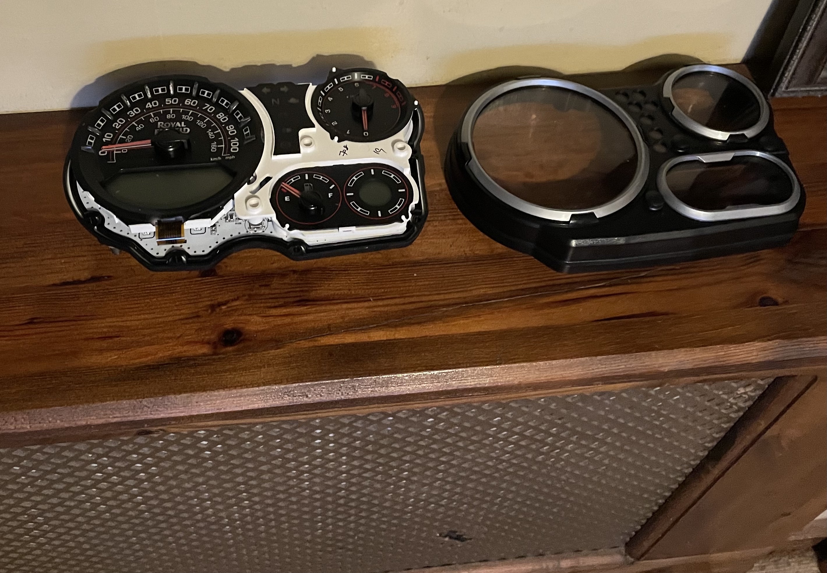

Saul Posted November 24, 2022 Author Share Posted November 24, 2022 If a job is worth doing it is worth doing twice To be fair the first time I didn't dry the clocks on the radiator overnight as Wee jaunt did. Also I didn't fit extra gasket material like he did either. Guess what my first efforts didn't work. This time though I am going to do exactly what Wee jaunt did, I have even bought the exact material he did to make the new sealing gasket. 3 Link to comment Share on other sites More sharing options...

Catteeclan Posted November 24, 2022 Share Posted November 24, 2022 18 minutes ago, Saul said: If a job is worth doing it is worth doing twice To be fair the first time I didn't dry the clocks on the radiator overnight as Wee jaunt did. Also I didn't fit extra gasket material like he did either. Guess what my first efforts didn't work. This time though I am going to do exactly what Wee jaunt did, I have even bought the exact material he did to make the new sealing gasket. Turn the top upside down just to be sure the moisture's out. 2 Link to comment Share on other sites More sharing options...

Saul Posted November 24, 2022 Author Share Posted November 24, 2022 14 minutes ago, Catteeclan said: Turn the top upside down just to be sure the moisture's out. Done so 1 Link to comment Share on other sites More sharing options...
