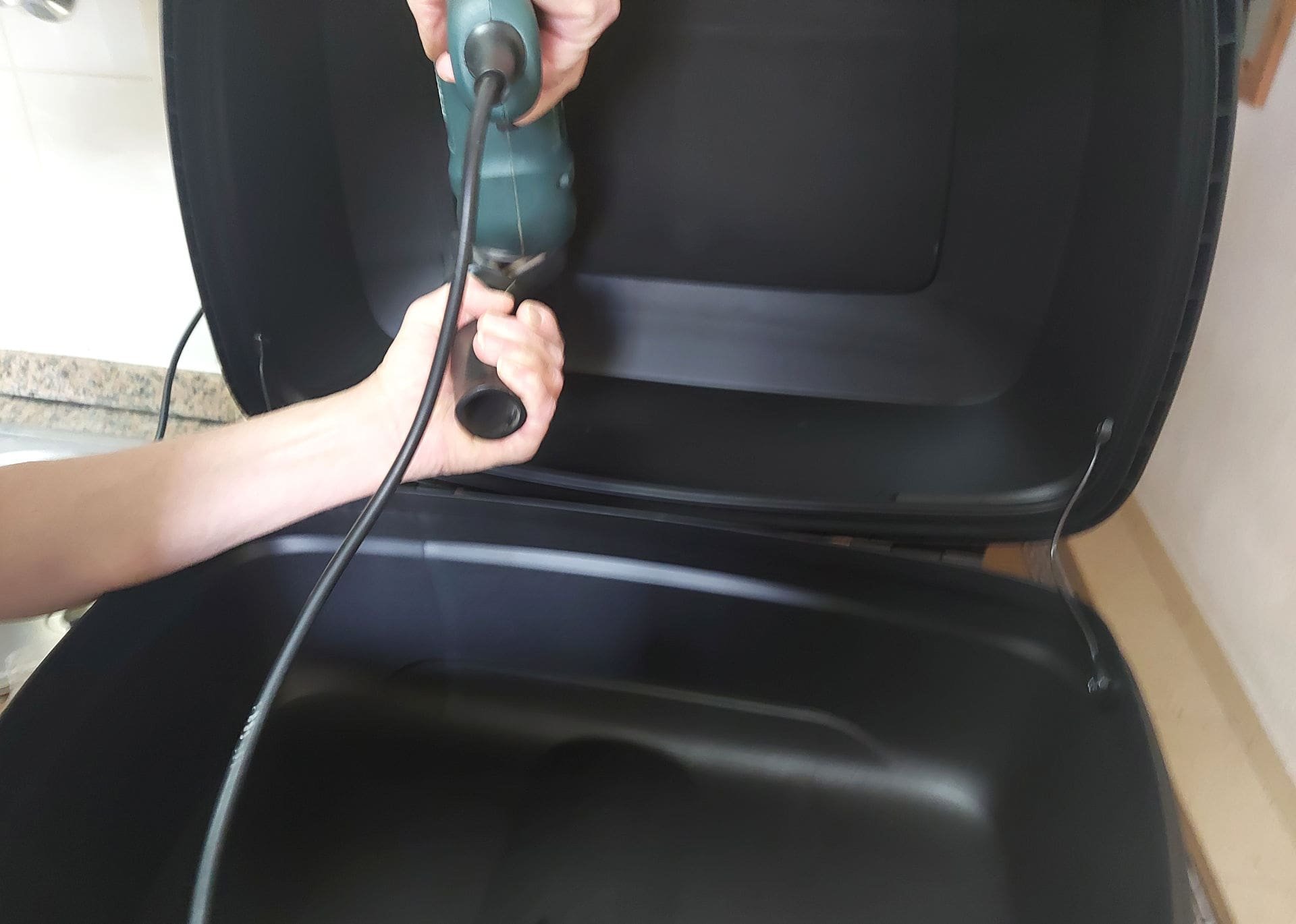

XTreme Posted March 30, 2023 Share Posted March 30, 2023 The wife wanted me to order a backrest for the box so I got a Shad one from Amazon delivered today. But WTF is going on with these things? You used to stick it to the box with adhesive pads.......now you've got to drill holes in the fucking box. But where exactly? I daren't try that or it'll be carnage......so it's a job for Jonathan in Juan Cortes when I take it in for an oil and filter change in a month or so. 1 3 Link to comment Share on other sites More sharing options...
XTreme Posted March 30, 2023 Author Share Posted March 30, 2023 As a follow on to the backrest dilemma.....I did what I always do! I searched for a YouTube Tutorial! And it appears there's two marks inside the lid for the exact spots that you need to drill. So we can sort that out here no sweat! However, the wife won't let me use her drill so I've got to wait till tomorrow for her back to ease off and she's going to do it. It won't be the first time she's had to do shit on my bikes as you know! 5 Link to comment Share on other sites More sharing options...

Slowlycatchymonkey Posted March 30, 2023 Share Posted March 30, 2023 TLDR Check what they’ve marked by making a template before drilling. The last thing I had to adjust was a Givi tank lock ring listed by them as fitting my bike, but no it didn’t and neither did the surprise supplied ‘drill here’ template. Problem is they’re usually only slightly out so if you fuck it up you’ve removed too much material right next to where you really want the holes and then your in total PITA territory. I always check with a paper template first. 2 Link to comment Share on other sites More sharing options...

XTreme Posted March 30, 2023 Author Share Posted March 30, 2023 21 minutes ago, Slowlycatchymonkey said: TLDR Check what they’ve marked by making a template before drilling. The last thing I had to adjust was a Givi tank lock ring listed by them as fitting my bike, but no it didn’t and neither did the surprise supplied ‘drill here’ template. Problem is they’re usually only slightly out so if you fuck it up you’ve removed too much material right next to where you really want the holes and then your in total PITA territory. I always check with a paper template first. Great advice......I'll get the wife to do that! 4 Link to comment Share on other sites More sharing options...

Earache Posted March 30, 2023 Share Posted March 30, 2023 Basic math will also help; Measure the distance of the outside edge of the bolts / studs on the backrest Subtract the diameter of one of the bolts / studs The result is the distance between centers of the two bolts. Mark that on the topbox and drill away. 2 Link to comment Share on other sites More sharing options...

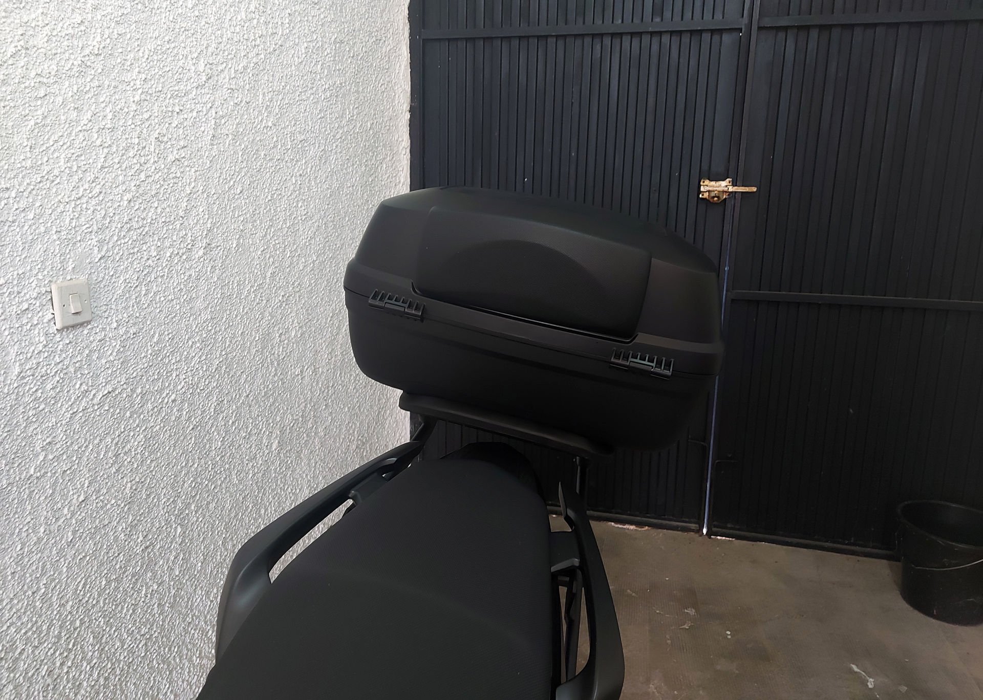

XTreme Posted March 31, 2023 Author Share Posted March 31, 2023 I have an update! We followed @Slowlycatchymonkey's advice to make a stencil to ensure the indentations in the box were in the right place. And they were! So the wife got drilling! I supervised! Then it was attach the pad and tighten the screws! I passed the screwdriver! And job done! The bike's coming together now......box, handguards, and decent tyres (Pirelli Scorpion Trail II). @Tango knows how shit the OEM's are, the bike just doesn't steer right with those Dunlop Trailmax shit! If I didn't have my Hernia I'd probably be doing some RTW trip! 4 3 Link to comment Share on other sites More sharing options...
