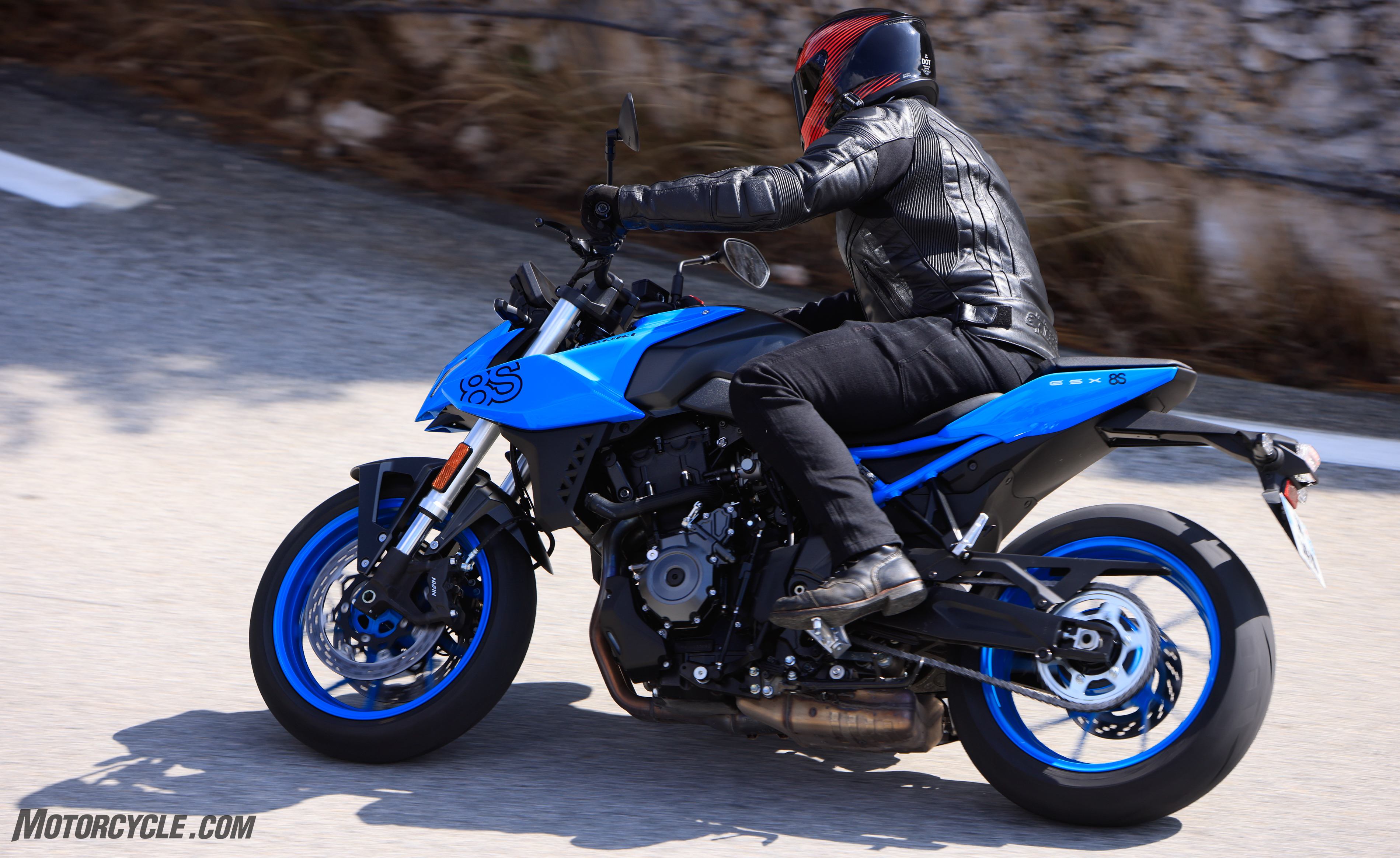

As previously alluded to, the GSX-8S follows on the heels of the 2023 V-Strom 800 DE as the second model to use the all-new 800 platform. The two models share the engine and the steel main frame that the Twin bolts into as a stressed member. The 776cc DOHC Parallel Twin gets its capacity from a couple of 84mm bores with 70mm strokes, while the compression ratio comes in at 12.8:1. The 2023 Suzuki GSX-8S is said to produce 82 horsepower at 8,500 rpm, with 57.5 pound-feet of torque topping out at 6,800 rpm. Redline cuts in at 9,250 rpm.

776cc of brand spankin’ new Parallel Twin.
Speaking of lungs, as it was on the ‘Strom 800, the 8S uses a horizontal six liter air box that is situated under the seat and breathes out of what Suzuki says is its first “short muffler” which keeps weight central and low. The cooling system uses a thermostat control valve which we’re told aids in quicker warm up times and more stable combustion temperatures, leading to reduced exhaust emissions. A dual-counter balancer is also used to quell unwanted vibration and does a good job up until the point where you probably don’t mind under liberal throttle twistage.
