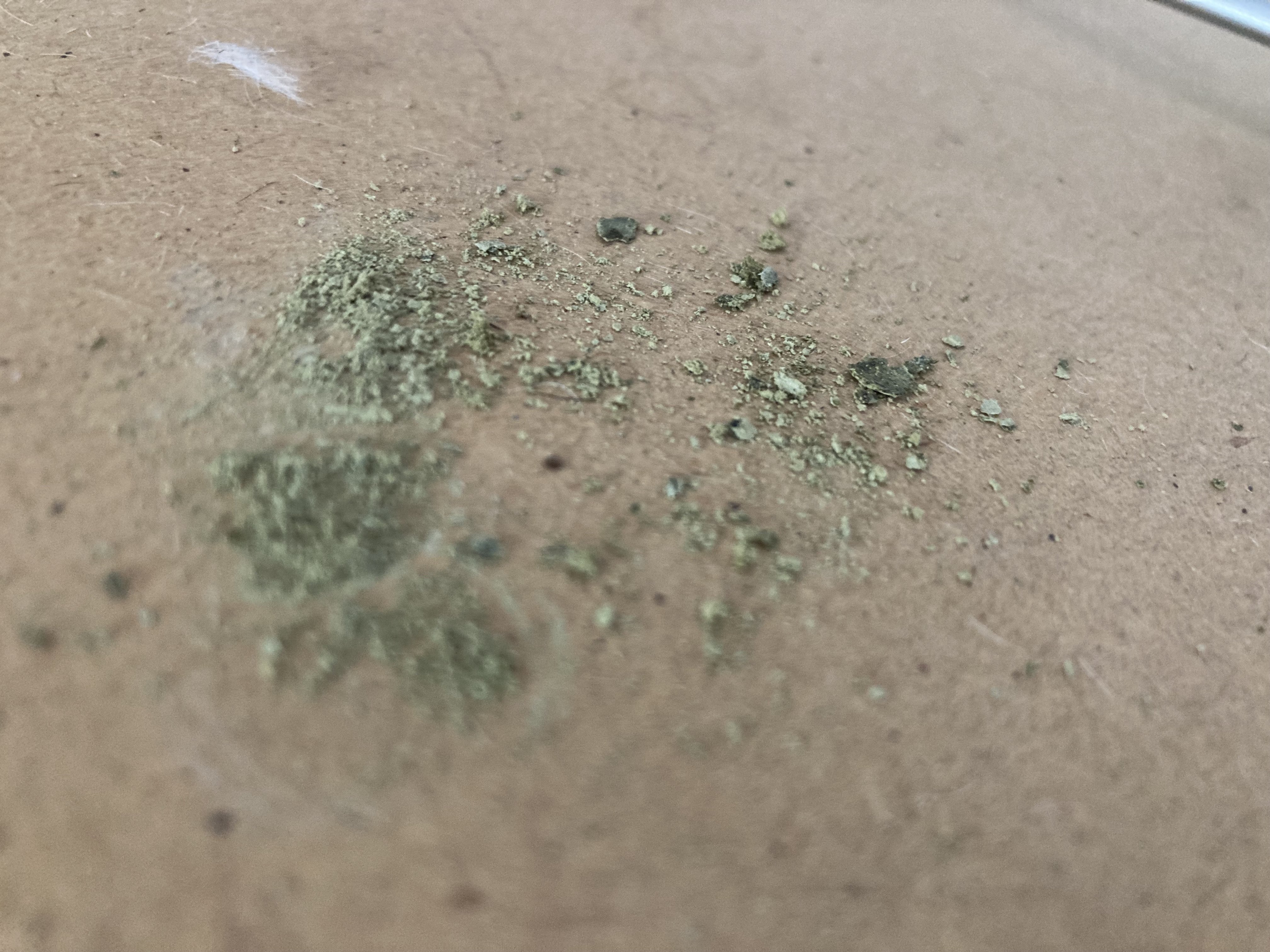

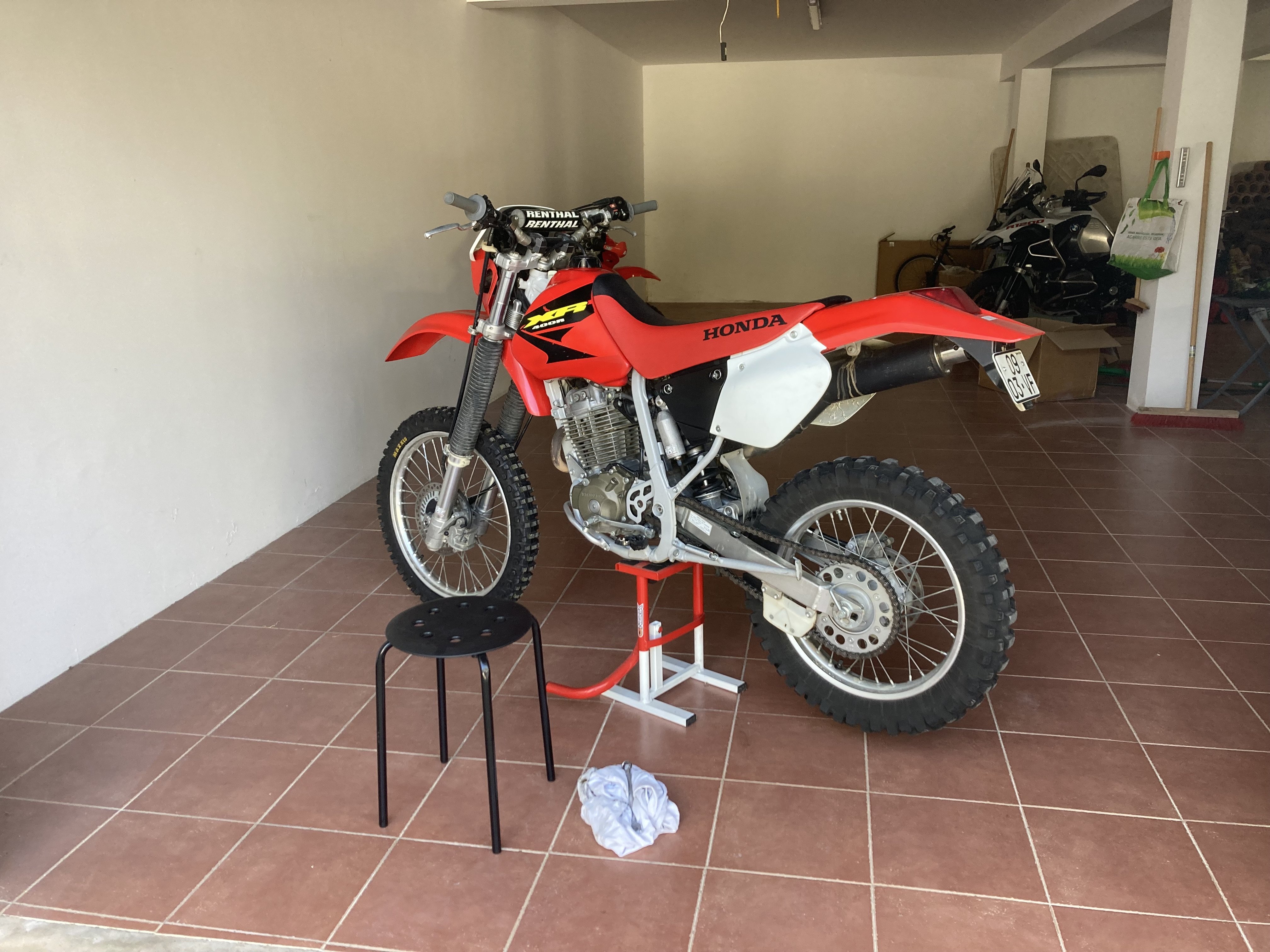

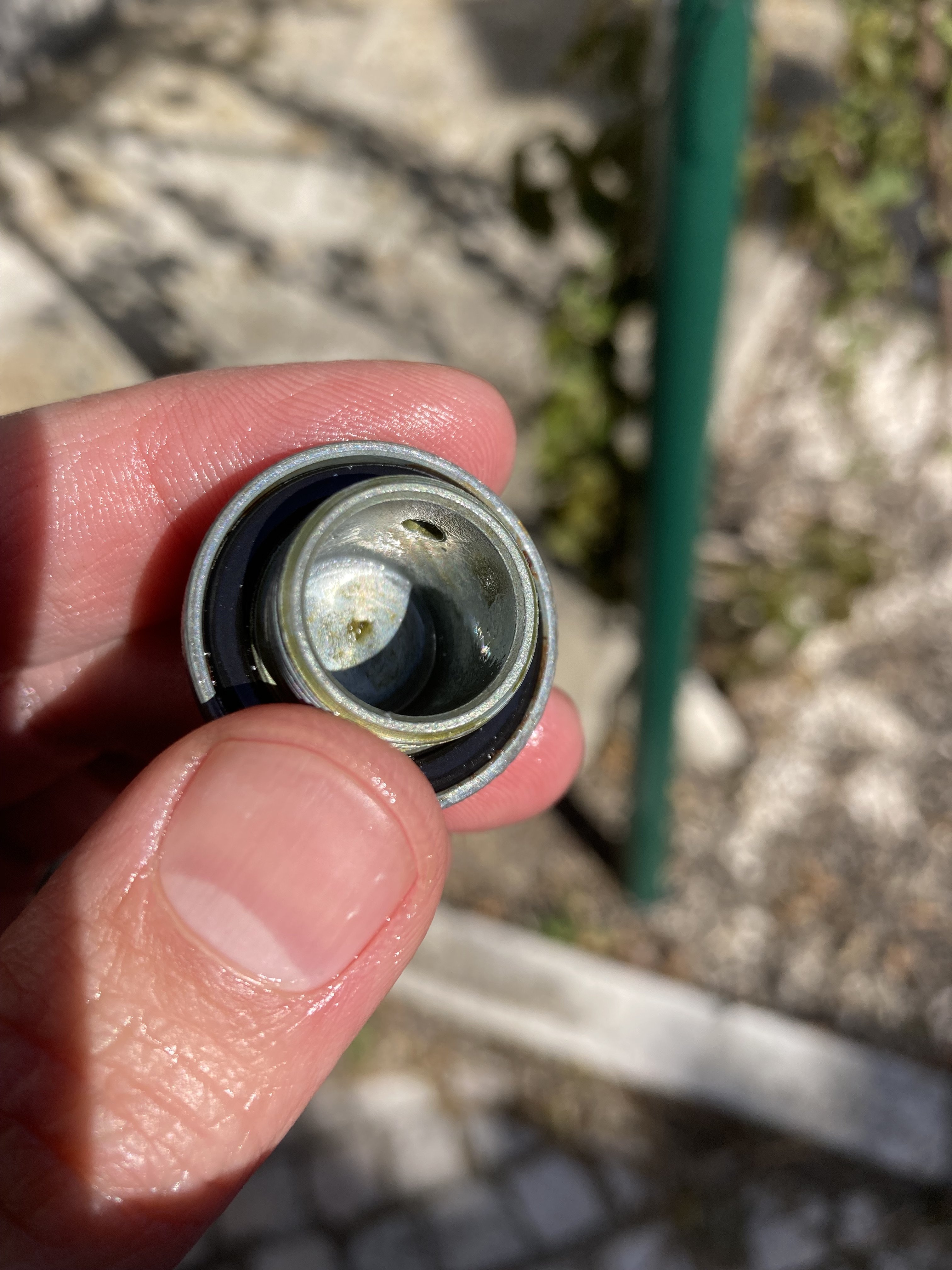

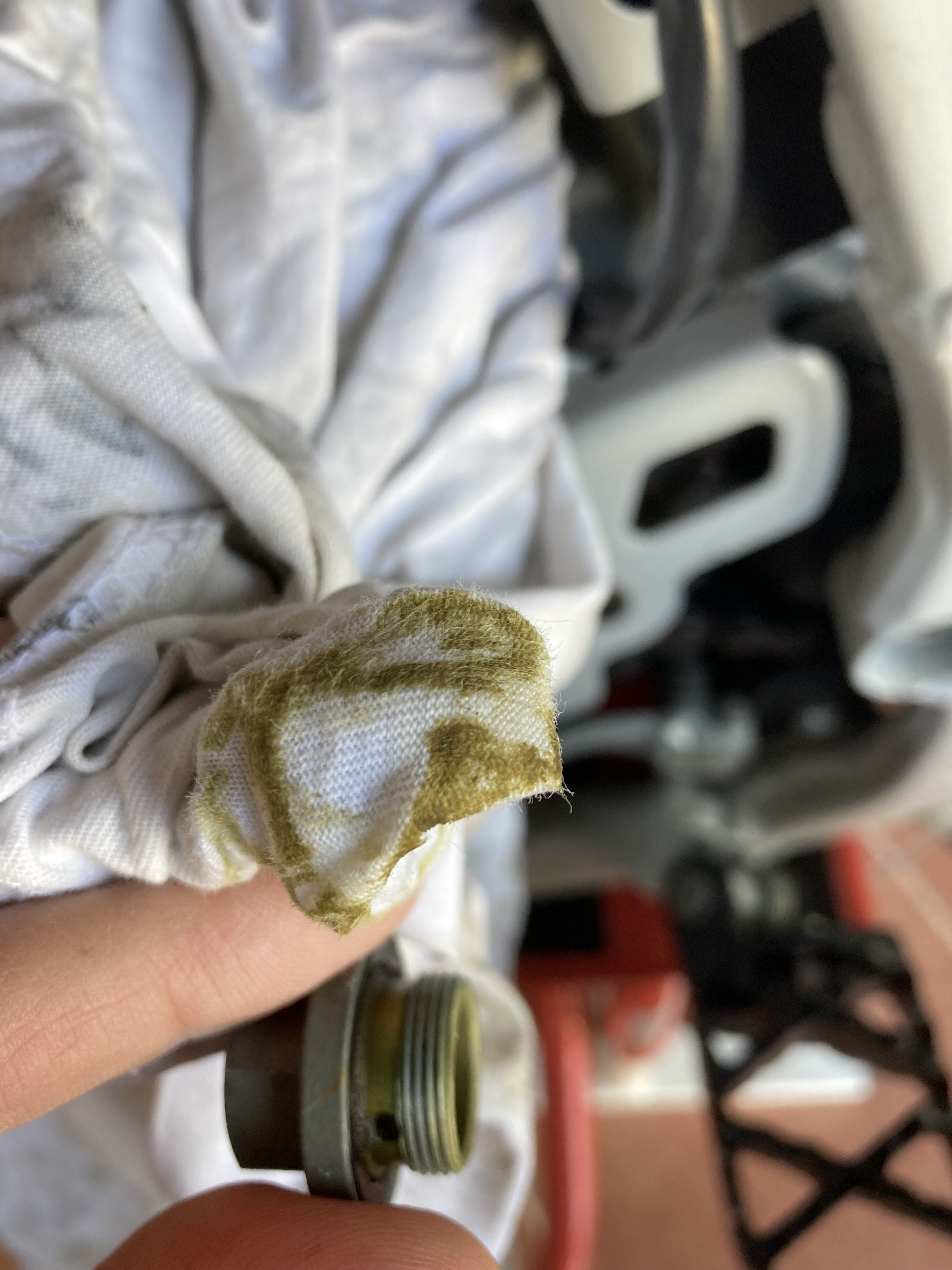

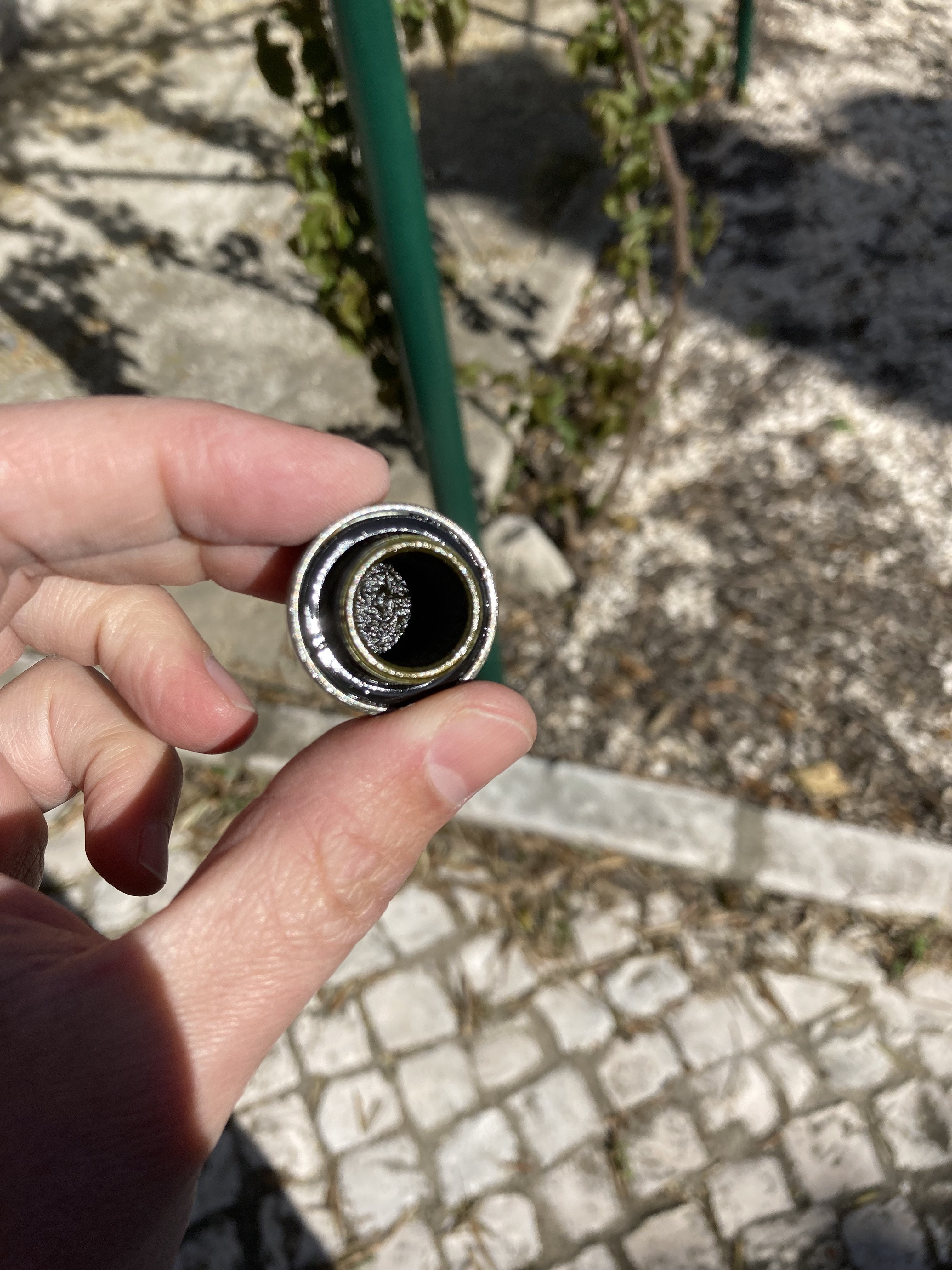

Pedro Posted April 13, 2023 Share Posted April 13, 2023 So, had a while to spare in the afternoon, and between calls went and took the drain plug from my XR400R's carb, to see the state of things inside. Nothing looks as dirt bike cool as a 80 or 90's Honda, I think. Looked like moss inside, the bottom was sort of crusty but the walls of it looked like the greenish yellow was a part of it. This is was was encrusted in the bottom. Looking more normal, but I ended up getting rid of the smaller bits of it still in this picture. Washed it using the petrol that I used to flush the carb and a toothbrush. The fuel coming out had a few particles but looked ok to me. Nothing that my phone might be able to pic up on pictures. I gave up kicking and kicking since it wasn't making any of the "about to start" sounds it usually makes. Then resorted to pushing it up my driveway, which is the same height as a full flight of stairs, and bump starting it down. The first time it started, in third gear with the tick over quite high and helped by the slippery ground and new front tire I almost ended up on the wall It manages to run for a while on choke, but can't get it off choke without stalling. I feel it's not running well either, sounds harsh and spluttery. A few more tries and I did get her to start on the kick a few times, but not for long. Pushed it up that drive more times than I feel comfortable counting I did think of getting it out on the street, there's a loooong way down from my door, ideal for bump starting it a few times and put some heat into the engine, but if it ends up not running I can never push it back up that far and steep. So, after a while I though that the little black adjuster that helps adjust tickover might have been too high, ended up on no adjust, so just put in 1 or 2 turns on that. Then foolishly tried to start her a few times with fuel on reserve, and fuel closed. Eventually it ran for maybe 30 seconds to a minute, on choke, but just dies like it runs out of fuel, accelerator does nothing to help it keep going. The phone started ringing and I came inside. Will try again tomorrow. 3 Link to comment Share on other sites More sharing options...

Buckster Posted April 13, 2023 Share Posted April 13, 2023 That looks like corrosion from the brass parts of the carb. 1 Link to comment Share on other sites More sharing options...
