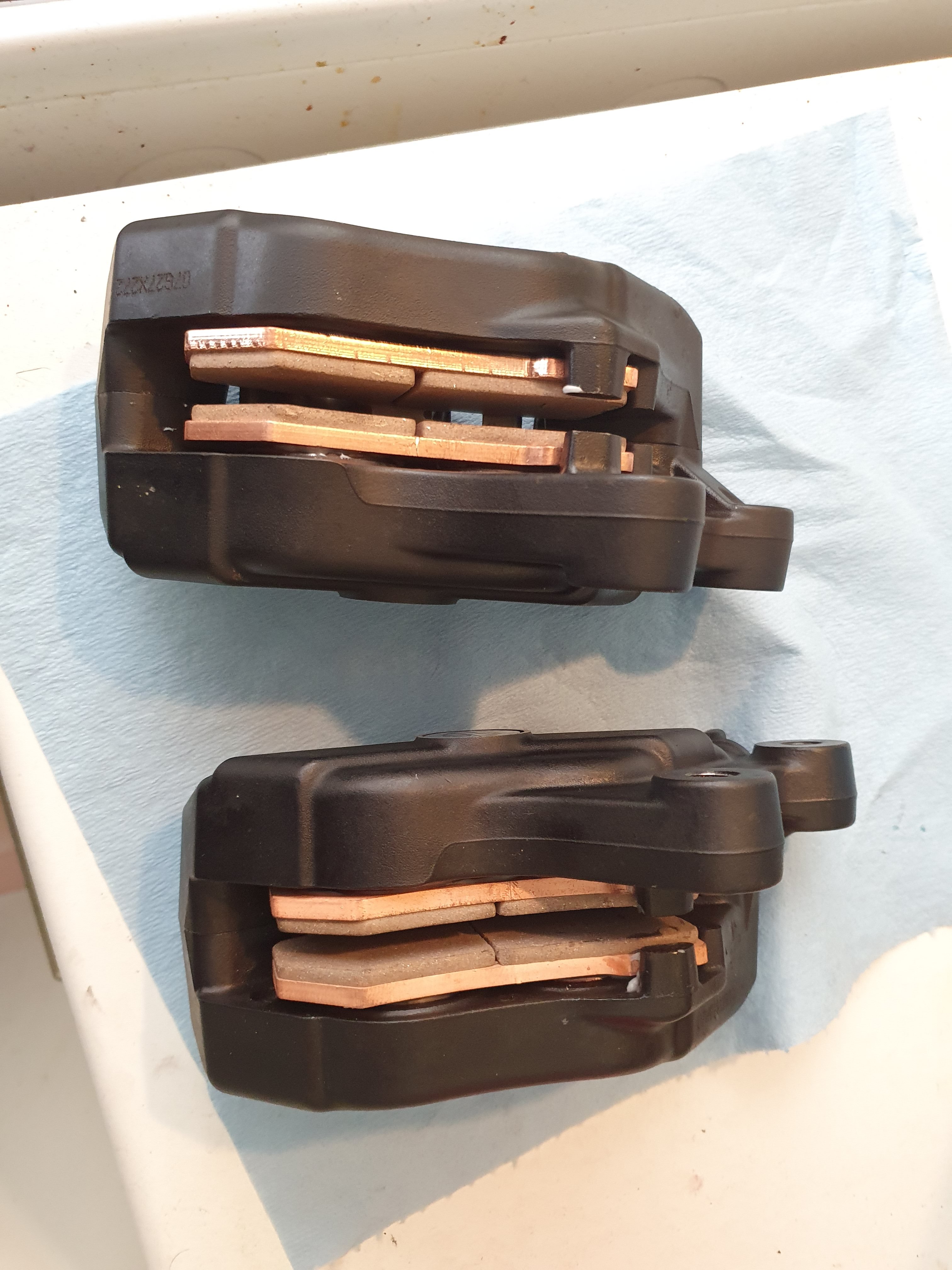

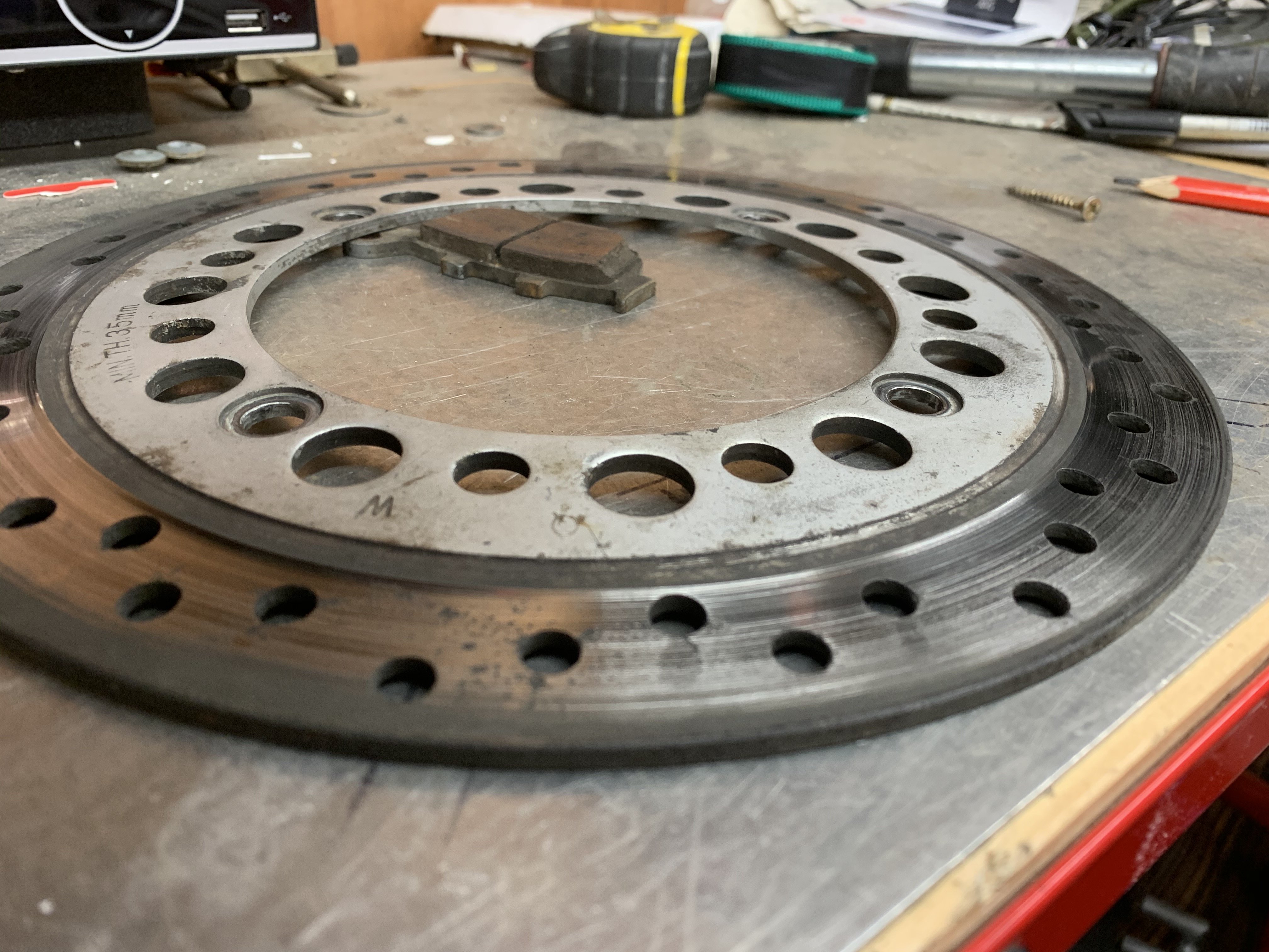

Dug my runout gauge out and the right hand disc is well warped but the left is within tolerance. Will strip the calipers now.
It seems most of the pistons are pretty sticky, only one was moving the way it should and that was in the right hand side calliper and the pads on that side have a white edge wear pattern hence the warped disc. I am out of seal grease so will have to rebuild them tomorrow, it looks like I have found the problem, the dealers would have just replaced the discs and passed the mot and then the issue would have been back next year, in fact that is what they did last time as I let them swap the discs that time. Always better to do it yourself.

When mine were warped they weren't throwing left to right they were dished, the pads always dragged a little ever since i had the bike it was only when i took the discs off the wheel i noticed how bad they were i could slide the metal part of the pad under the disc where i should have been struggling to fit a fag paper

I think the calliper on the right side has been pulsing as one piston was more free running that the other three.
