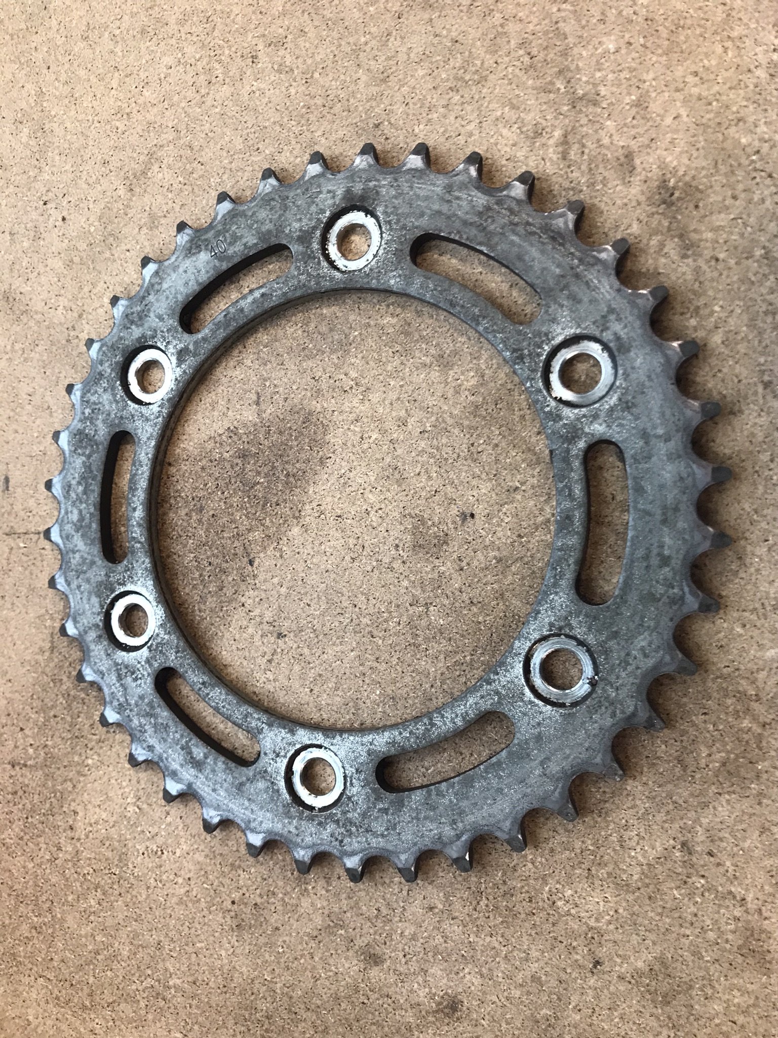

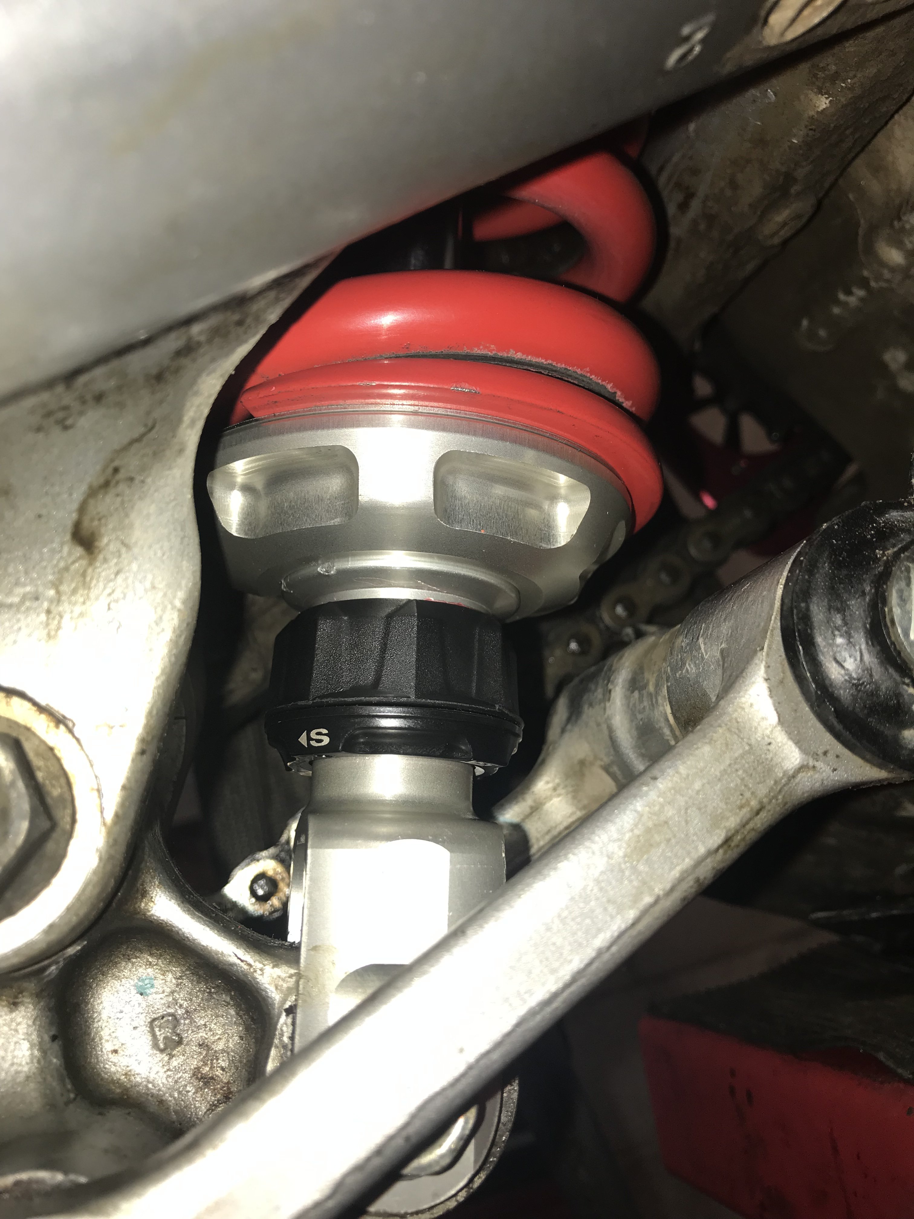

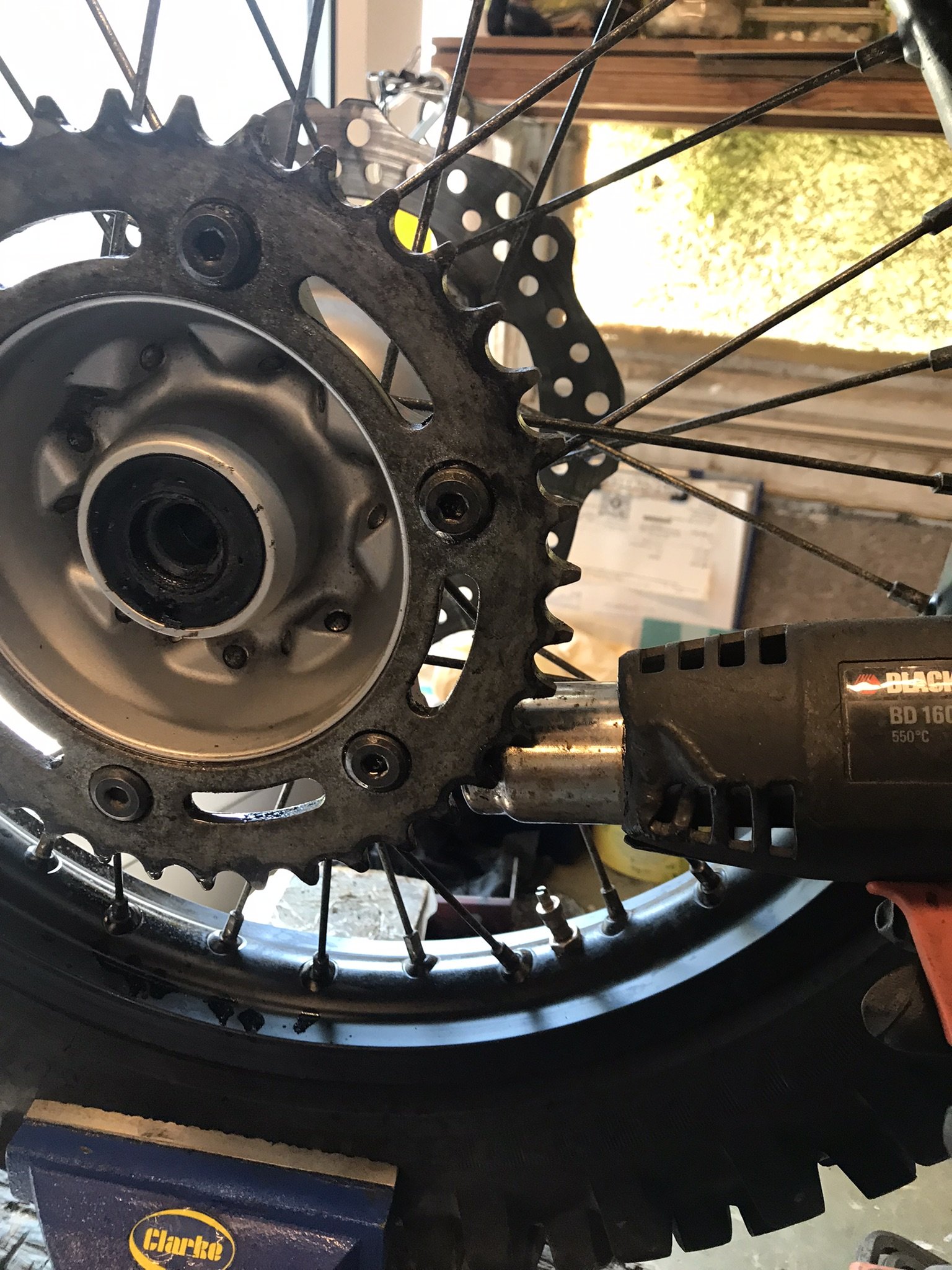

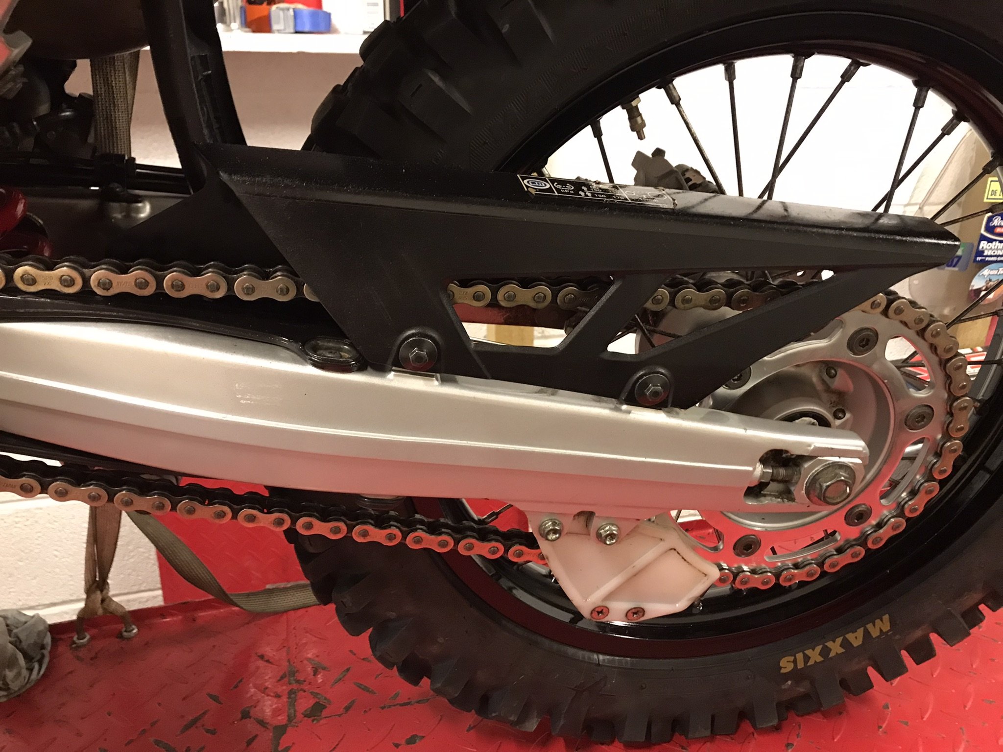

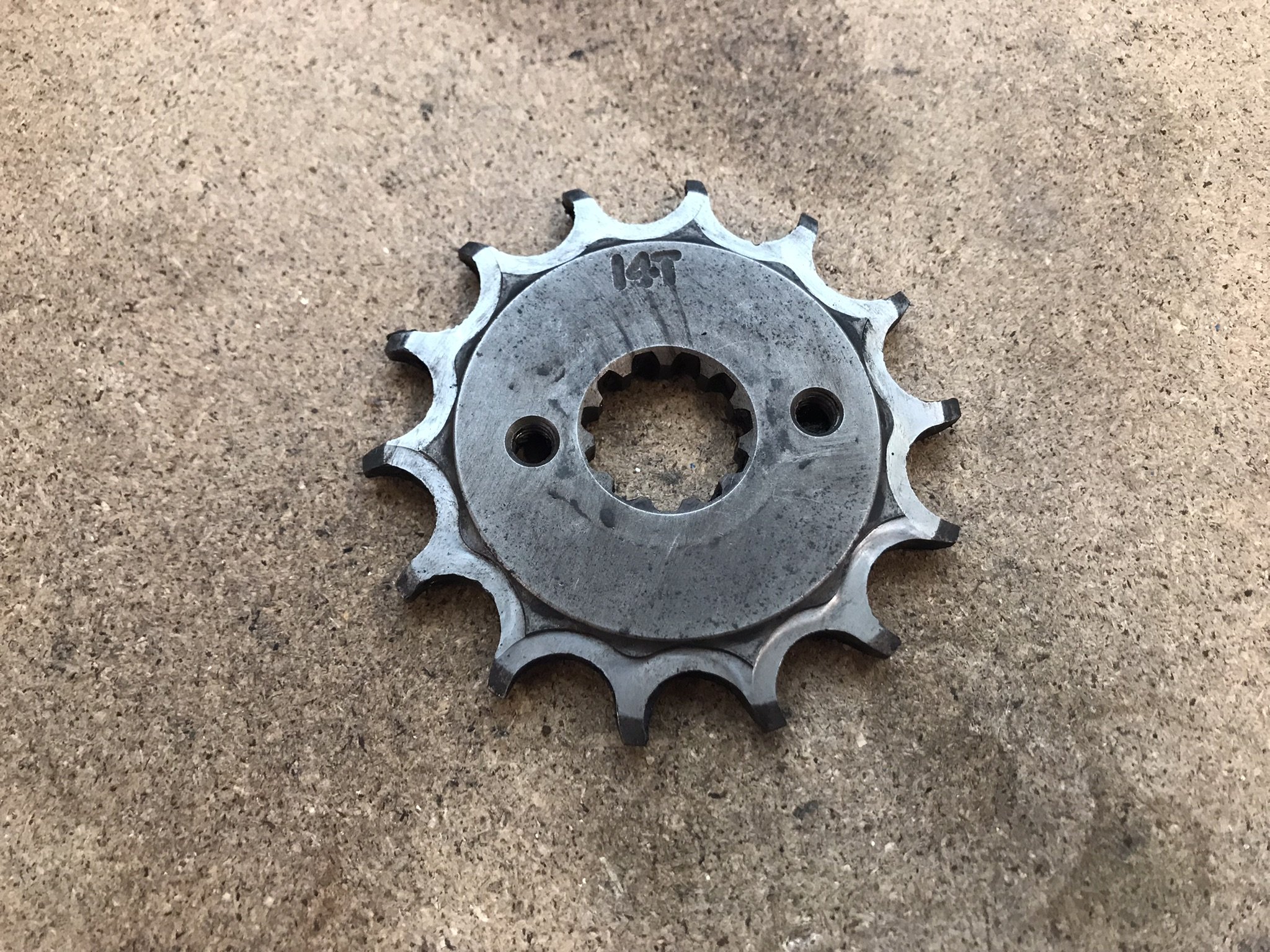

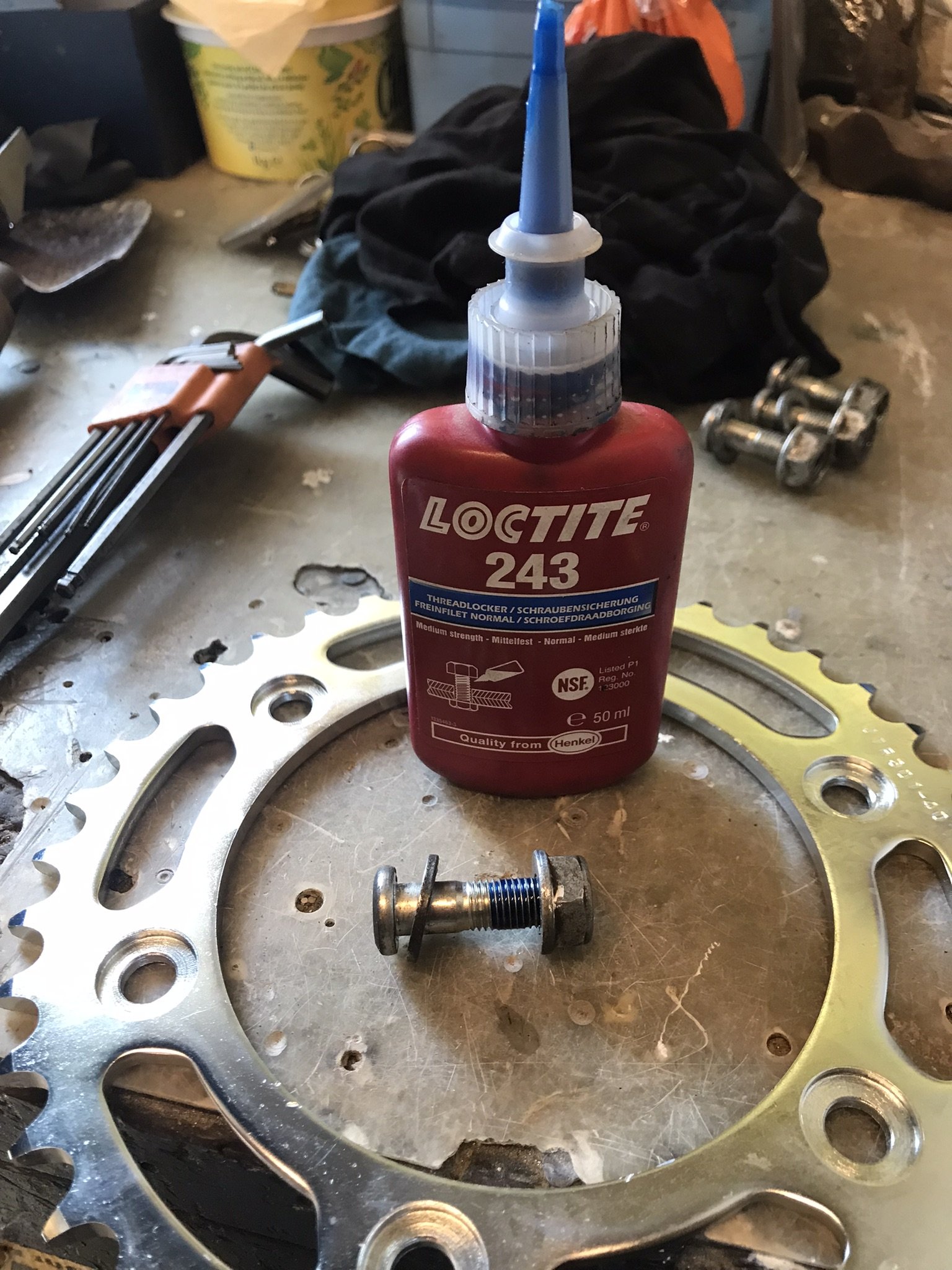

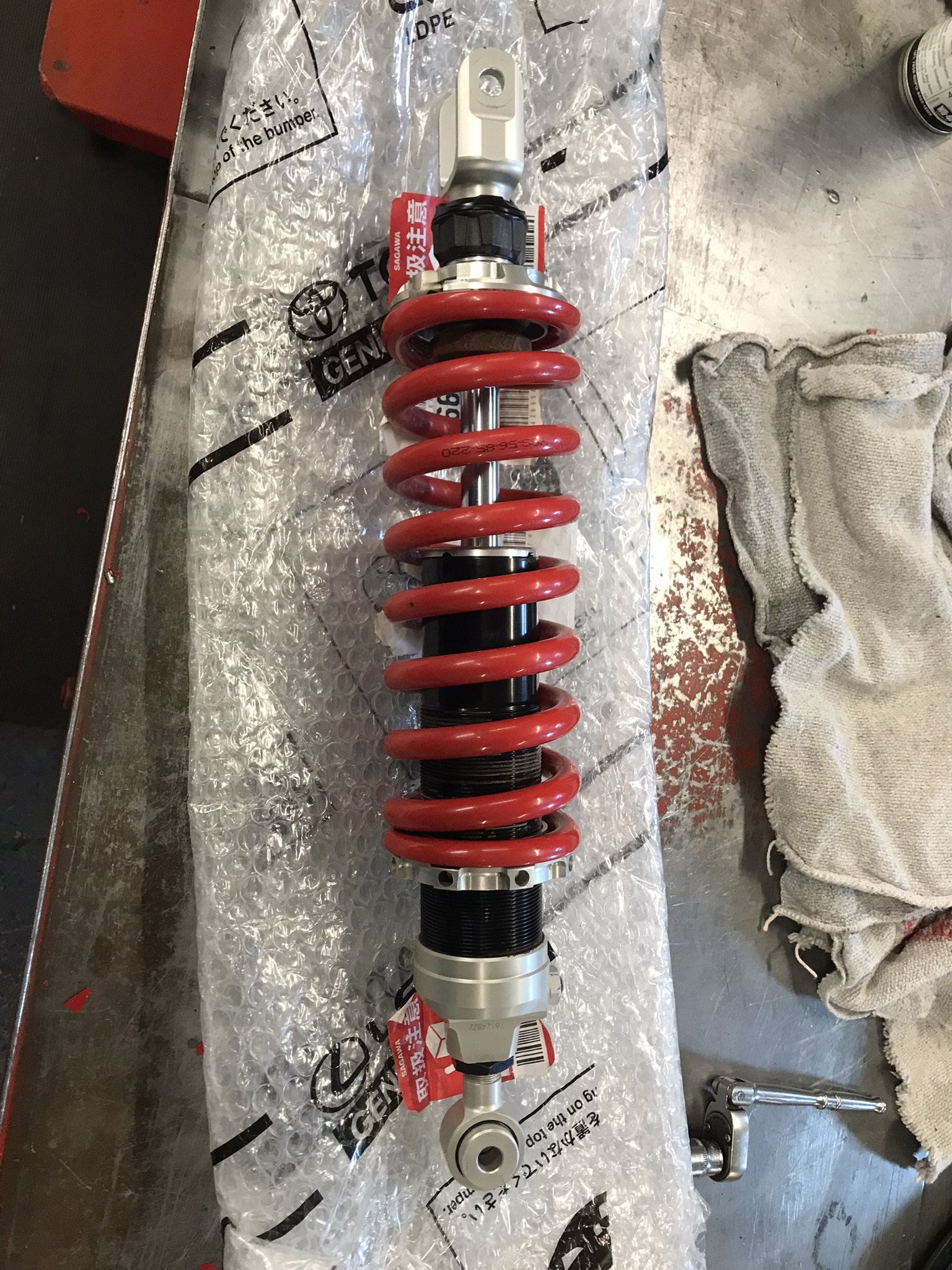

Skippy Posted June 8, 2023 Share Posted June 8, 2023 On 07/06/2023 at 21:51, boboneleg said: So back to the fettling while @XTreme decides whether he's actually going to get a CRF or not . The shock was taken to James Packwwod racing to sort out the non-working rebound adjuster. I then fitted new sprockets front and rear as the bike still had the originals on there, the front was well hooked .......... But the rear wasn't too bad so I'll keep that one as a spare ................ Heat up the rear sprocket bolts BEFORE trying to undo them .......... and then fit them using blue loctite ............ and it's done.................. I then used the original shock to put the bike back on two wheels, re-fitted all the bodywork, gave it all a polish and she's done. Just got to wait for the shock to be repaired and then I can re-fit that Expand Youโve totally confused @XTreme with all that techno talk mate 1 3 Link to comment Share on other sites More sharing options...
XTreme Posted June 8, 2023 Share Posted June 8, 2023 On 07/06/2023 at 21:51, boboneleg said: So back to the fettling while @XTreme decides whether he's actually going to get a CRF or not . The shock was taken to James Packwwod racing to sort out the non-working rebound adjuster. I then fitted new sprockets front and rear as the bike still had the originals on there, the front was well hooked .......... But the rear wasn't too bad so I'll keep that one as a spare ................ Heat up the rear sprocket bolts BEFORE trying to undo them .......... and then fit them using blue loctite ............ and it's done.................. I then used the original shock to put the bike back on two wheels, re-fitted all the bodywork, gave it all a polish and she's done. Just got to wait for the shock to be repaired and then I can re-fit that Expand How many miles on those sprockets? Link to comment Share on other sites More sharing options...
boboneleg Posted June 8, 2023 Author Share Posted June 8, 2023 On 08/06/2023 at 06:44, XTreme said: How many miles on those sprockets? Expand 11,629 miles, pretty good considering the way this bike gets used. You'd get 25,000 out of them if you were on road only. 2 Link to comment Share on other sites More sharing options...

boboneleg Posted June 16, 2023 Author Share Posted June 16, 2023 Collected my refurbished shock yesterday and itโs on . Iโve put 45 clicks on the rebound so Iโll see how that goes 4 Link to comment Share on other sites More sharing options...
XTreme Posted June 16, 2023 Share Posted June 16, 2023 On 16/06/2023 at 15:42, boboneleg said: Collected my refurbished shock yesterday and itโs on . Iโve put 45 clicks on the rebound so Iโll see how that goes Expand Yeh.....45 sounds about right! 3 Link to comment Share on other sites More sharing options...

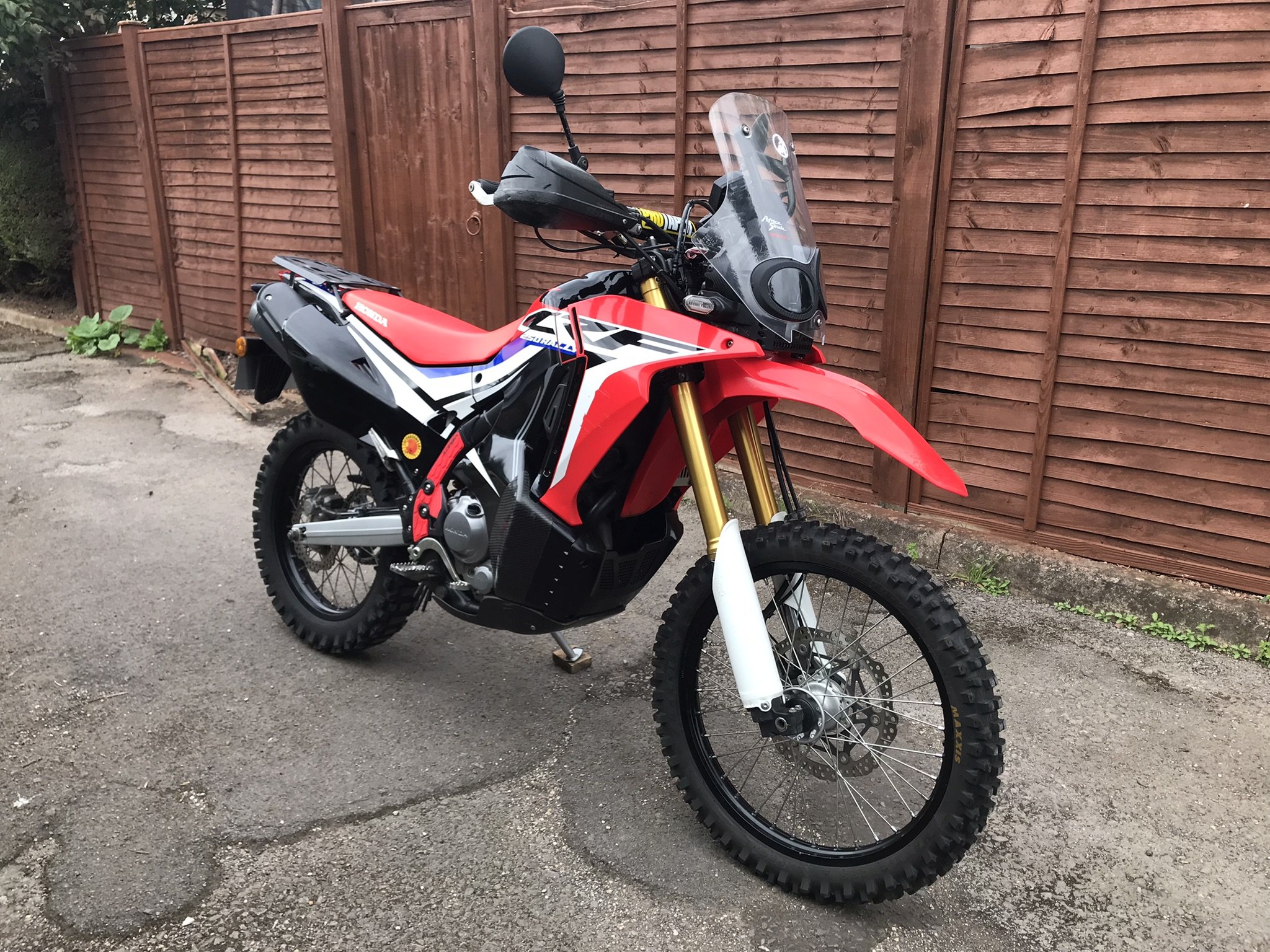

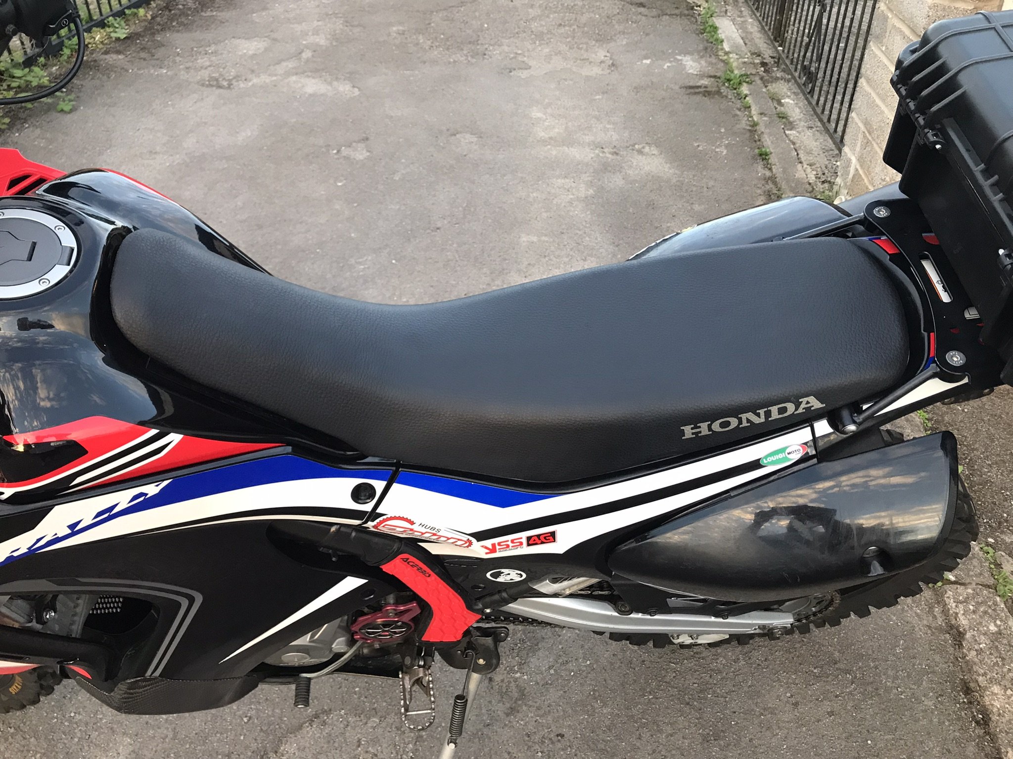

boboneleg Posted August 11, 2023 Author Share Posted August 11, 2023 I freshened up my Rally yesterday with a new seat as the original has sagged after six years of use. I went for a black seat from a 250M, I much prefer it to the red item, the strap was removed straight away 2 Link to comment Share on other sites More sharing options...
Pedro Posted August 11, 2023 Share Posted August 11, 2023 On 11/08/2023 at 08:30, boboneleg said: I freshened up my Rally yesterday with a new seat as the original has sagged after six years of use. I went for a black seat from a 250M, I much prefer it to the red item, the strap was removed straight away Expand Looks nice in black. I have been pondering the same. 2 Link to comment Share on other sites More sharing options...
boboneleg Posted September 1, 2023 Author Share Posted September 1, 2023 So the Rally is now back with the original red seat, the 'hop-up' ECU has been removed and the original put back, she is now ready to go for p/x 3 Link to comment Share on other sites More sharing options...
