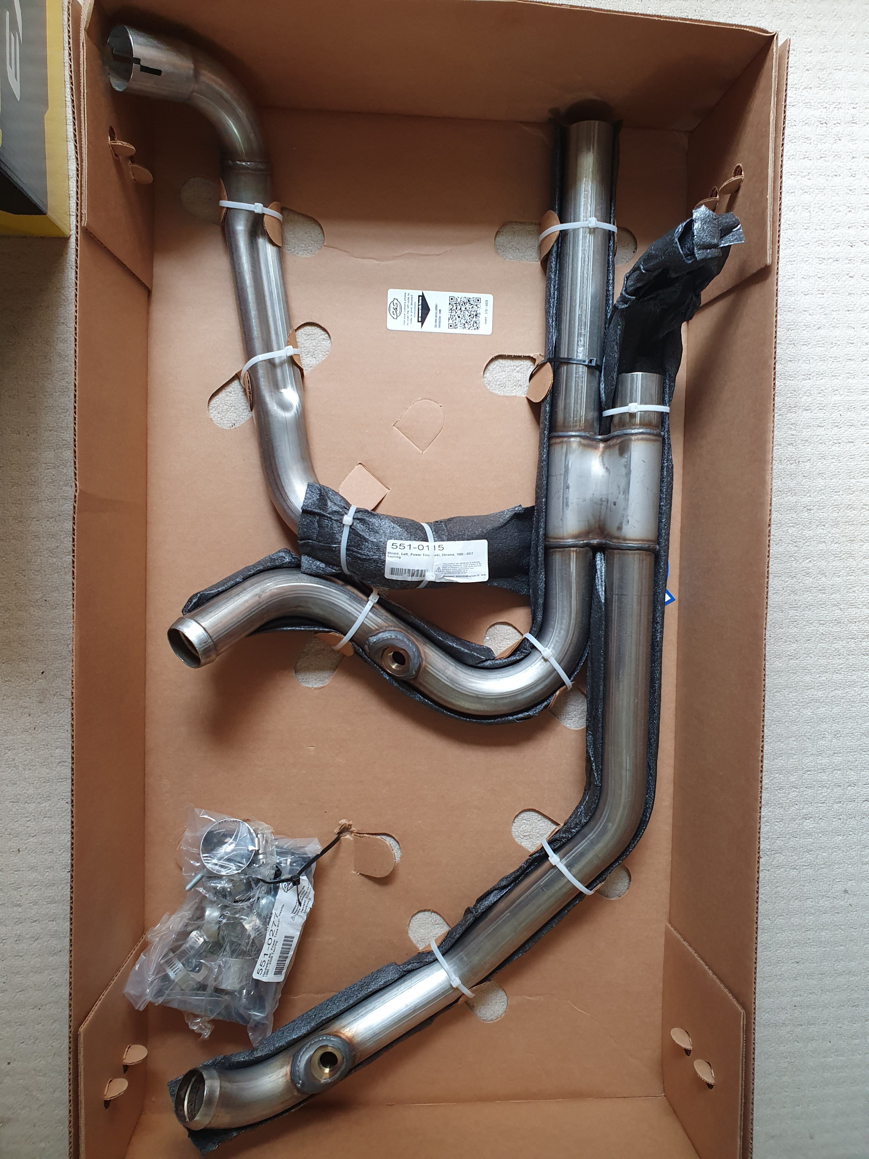

Buckster Posted June 14, 2023 Share Posted June 14, 2023 As much as I like the sound of my exhaust, it is a bit of a pain for touring, especially with the trailer as sound is reflected back at me. I certainly cannot risk going abroad with the bike with the current set up. I also know I am sacrificing torque for horsepower. Unfortunately I cannot just switch silencers as the headers are two inch on the Rinehart system currently on the bike as opposed to one and three quarter inch as per standard. So I am ordering a set of S&S Power Tune dual headers and for now will use some standard silencers I have in my storage unit, it’s going to be very quiet, which the neighbours will no doubt like, I will gain a little bit of torque and lose a little bit of horsepower. Later on I will fit some after market silencers when I find ones I like. The added bonus is that the left hand header will be away from the passenger foot peg which is currently a challenge for the occasional lady pillion passenger. 3 Link to comment Share on other sites More sharing options...

Buckster Posted June 20, 2023 Author Share Posted June 20, 2023 It’s here! 1 Link to comment Share on other sites More sharing options...
Buckster Posted June 20, 2023 Author Share Posted June 20, 2023 4 Link to comment Share on other sites More sharing options...
