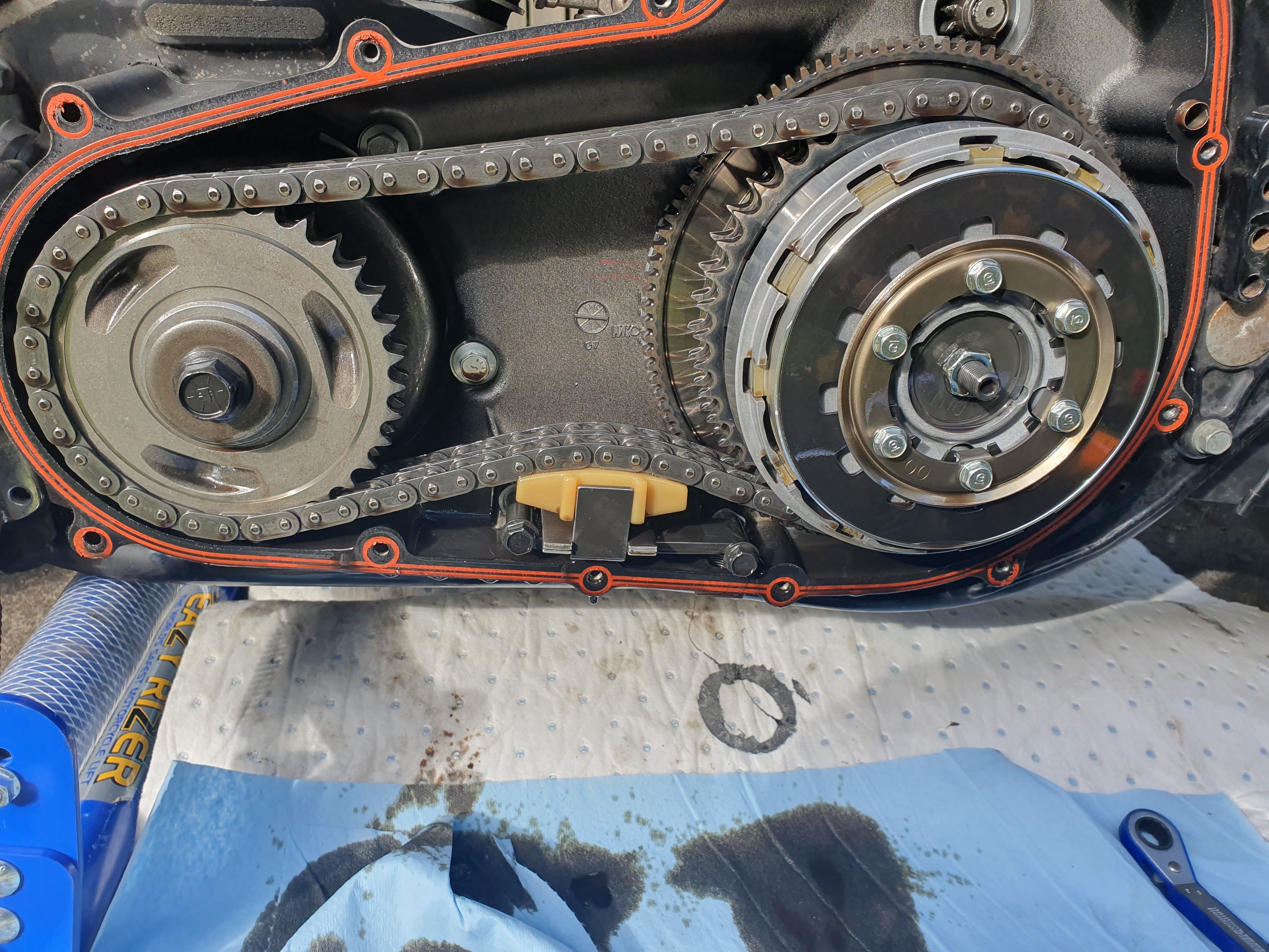

Buckster Posted July 2, 2023 Author Share Posted July 2, 2023 Everything looks good in the primary but I had to get hold of some suitable steel bar to make a locking bar with which I am working on right now. 6 Link to comment Share on other sites More sharing options...

Buckster Posted July 3, 2023 Author Share Posted July 3, 2023 12 minutes ago, Marcel said: You mean to lock up the engine to get the big bolt out? Yes it goes between the clutch and the compensator. Link to comment Share on other sites More sharing options...
boboneleg Posted July 3, 2023 Share Posted July 3, 2023 1 hour ago, Marcel said: I just use a roll up rag...works well..between the Chain and sprocket.. doesn't hurt anything....and old trick I picked up from the old harley guy. known as a shop rag in the States I do believe ? Link to comment Share on other sites More sharing options...
Buckster Posted July 3, 2023 Author Share Posted July 3, 2023 2 hours ago, Marcel said: I just use a roll up rag...works well..between the Chain and sprocket.. doesn't hurt anything....and old trick I picked up from the old harley guy. Perfect for wrecking your output shaft bearing. Link to comment Share on other sites More sharing options...
Sir Fallsalot Posted July 3, 2023 Share Posted July 3, 2023 3 hours ago, Buckster said: Perfect for wrecking your output shaft bearing. Not if you use a rattle gun Link to comment Share on other sites More sharing options...
Sir Fallsalot Posted July 3, 2023 Share Posted July 3, 2023 30 minutes ago, Marcel said: Don't believe Buckster has and impact gun... and you need a heavy-duty air compressor with a large tank...to run those. You can get them electric as well we used to have a 3/4 drive one in work that thing would undo any bolt or snap it LOL Link to comment Share on other sites More sharing options...
Buckster Posted July 3, 2023 Author Share Posted July 3, 2023 36 minutes ago, Marcel said: Have you ever seen a Harley do a burn out and smash through the gears ? Believe there alot more force applied to the output shaft than simply removing that bolt. You can jam the primary with a block or rag with the old five speed transmission but not with the six speed, you risk cracking the case by jamming the primary chain against it or putting too much lateral pressure on the output shaft bearing. I appreciate you think you know something but you all know fuck all, I have had the primary and transmission out in the past to replace the output shaft bearing as it was a casualty of driveline shock when the bike was in an accident before I bought it. I know what I am doing and I will do it properly. Link to comment Share on other sites More sharing options...

Buckster Posted July 3, 2023 Author Share Posted July 3, 2023 8 minutes ago, Marcel said: Think I'm gonna start calling you buckapussy.....so did you find the proper tool ? I made one. 2 Link to comment Share on other sites More sharing options...
