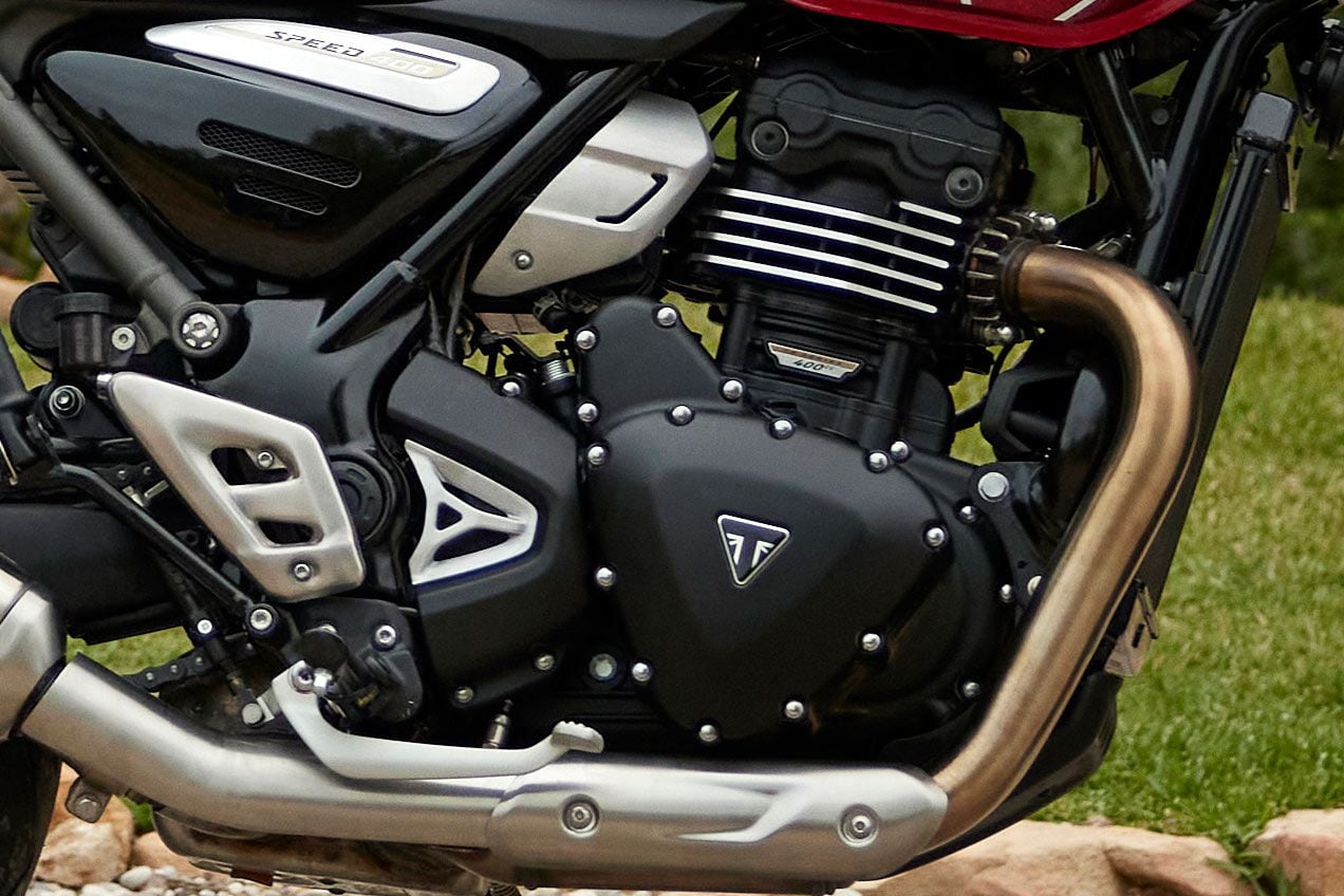

The heart of the Speed 400, and the models that will spin off from it, is the new TR-series engine: a 398cc DOHC four-valve single. Despite its retro, finned exterior, the engine is thoroughly modern, with a lightweight finger-follower valve train and a counterrotating balancer shaft to help it achieve more revs and power than you might expect, putting it in a class above rivals like Royal Enfield’s 350cc singles.
Triumphs 398cc TR single-cylinder engine that powers the Speed 400.
Triumphs 398cc TR single-cylinder engine that powers the Speed 400. (Triumph Motorcycles/)
Peak power is a claimed 39.5 hp at 8,000 rpm allied to 27.7 lb.-ft. of torque at 6,500 rpm and delivered through an assist-and-slipper clutch to a six-speed transmission. Like the Bonneville and its sister models, it exhausts via a cleverly hidden catalytic converter and front muffler, with metal covers that give the impression that the pipe sweeps directly from the cylinder head to the end can. On the intake side are a ride-by-wire throttle and Bosch fuel injection.
Inside, there’s an 89mm bore and 64mm stroke for a 398.2cc capacity. Bajaj also makes the KTM 390 single, with the same 89mm bore but a shorter, 60mm stroke and 373.2cc, but a visual comparison shows no link to the Triumph motor outside the general single-cylinder DOHC layout. Compression is a modest 12:1, somewhat less than the KTM engine, but in terms of power the Triumph isn’t far from the 390 Duke’s 43 hp and easily surpasses the 34 hp of BMW’s G 310 R. There’s a traction control system as standard, though it can be switched off.

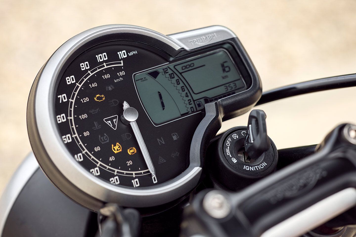

A digital and analog dash has a sweeping dial for the speedo but a digital tach.
A digital and analog dash has a sweeping dial for the speedo but a digital tach. (Triumph Motorcycles/)
Triumph isn’t announcing prices yet: They’ll come toward the end of the year, with dealers due to get stock by the start of 2024, though Indian-market deliveries are due to start as soon as July 2023. The only clue is that the Speed 400 will be competitive against European rivals like the BMW G 310 R, so somewhere around the $5,000 mark seems likely. To further reduce ownership costs, major service intervals are set at 10,000 miles.
Tech includes LED lighting all around, though US-market models will have slightly larger turn signals than Euro versions, as well as a part-digital, part-analog instrument panel that combines a traditional speedometer with a digital rev counter, fuel gauge, and gear indicator. While there’s a USB-C charging port for smartphones or GPS, there’s no built-in connectivity when it comes to calls, music, or navigation
