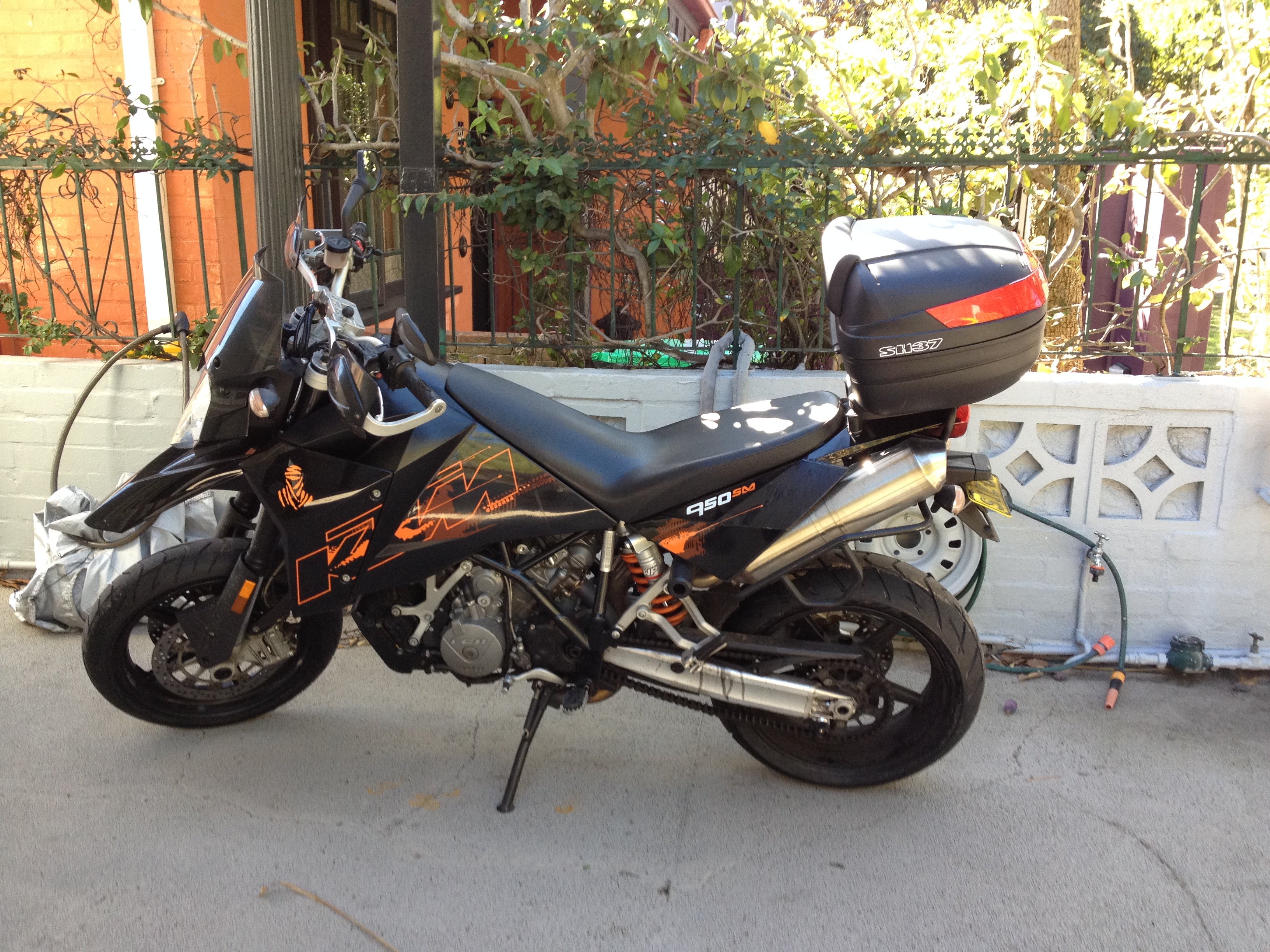

zzzak Posted October 8, 2023 Share Posted October 8, 2023 I got the tank of my sm today, what a c*nt of a job, however its only taken me 4 years so things are progressing apace. 2 2 Link to comment Share on other sites More sharing options...

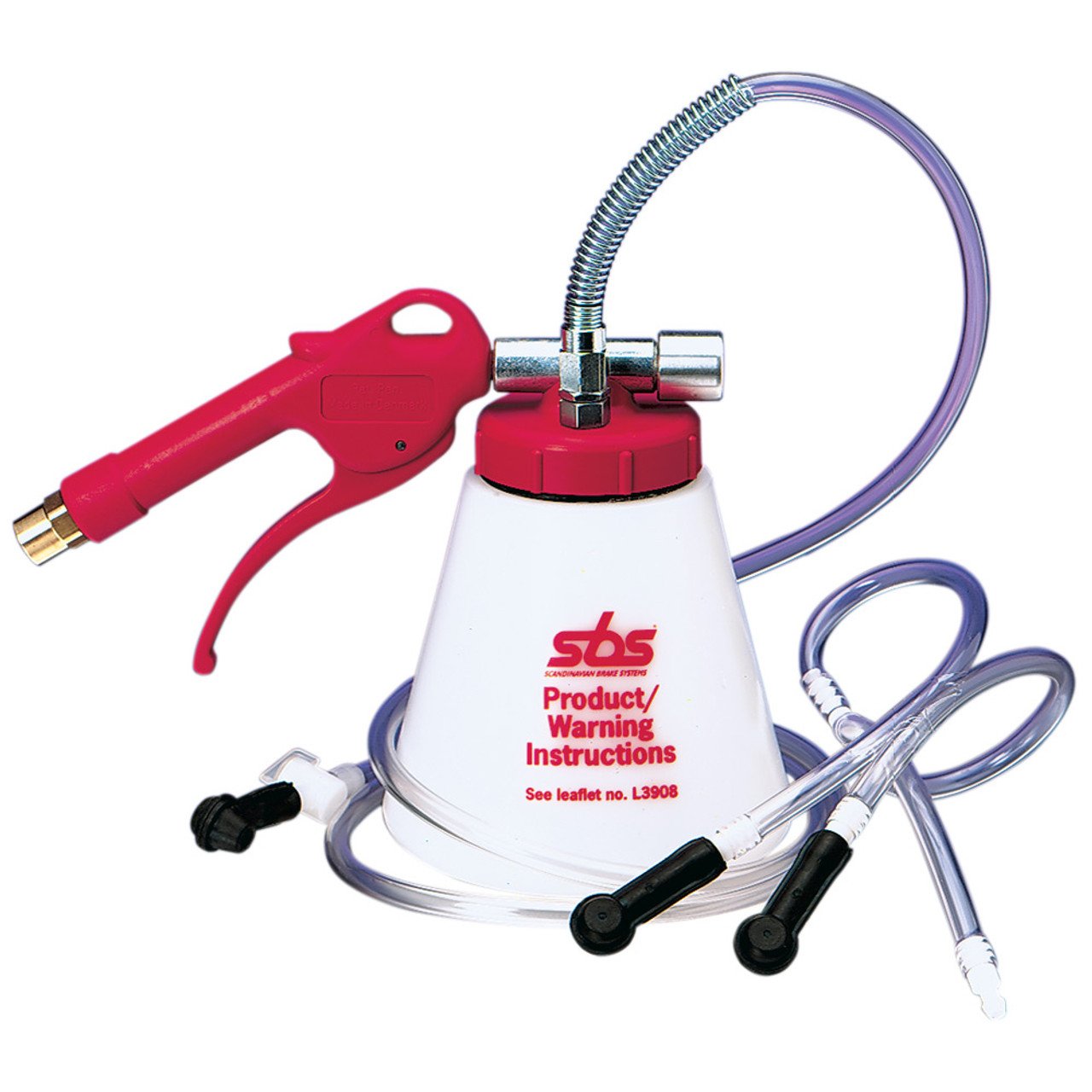

Earache Posted September 2, 2024 Share Posted September 2, 2024 I bought one of these a few years ago - huge time saver. Am amazed at how many times I've used it. 2 Link to comment Share on other sites More sharing options...
Catteeclan Posted September 2, 2024 Share Posted September 2, 2024 2 hours ago, Earache said: I bought one of these a few years ago - huge time saver. Am amazed at how many times I've used it. Had one of those at work. Made changing fluid a lot quicker. 1 Link to comment Share on other sites More sharing options...
