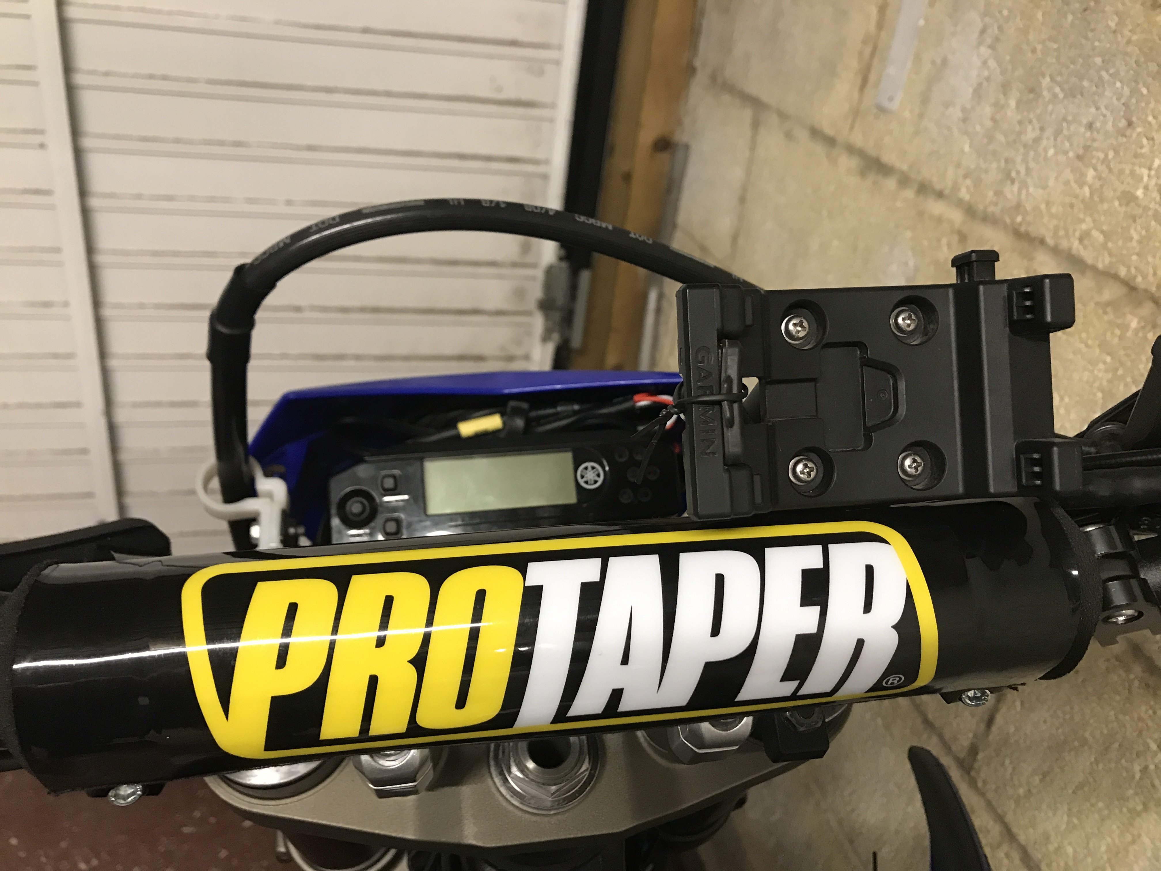

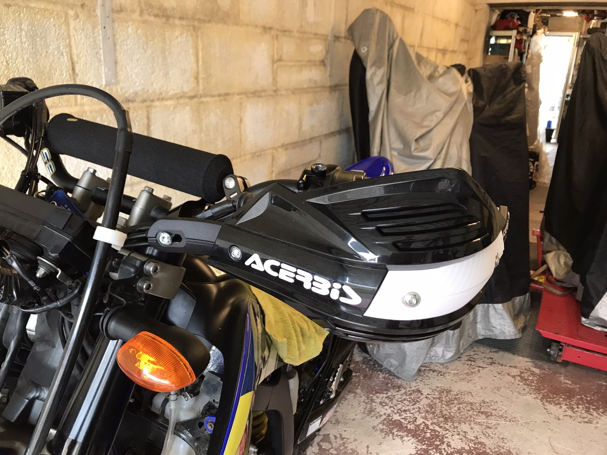

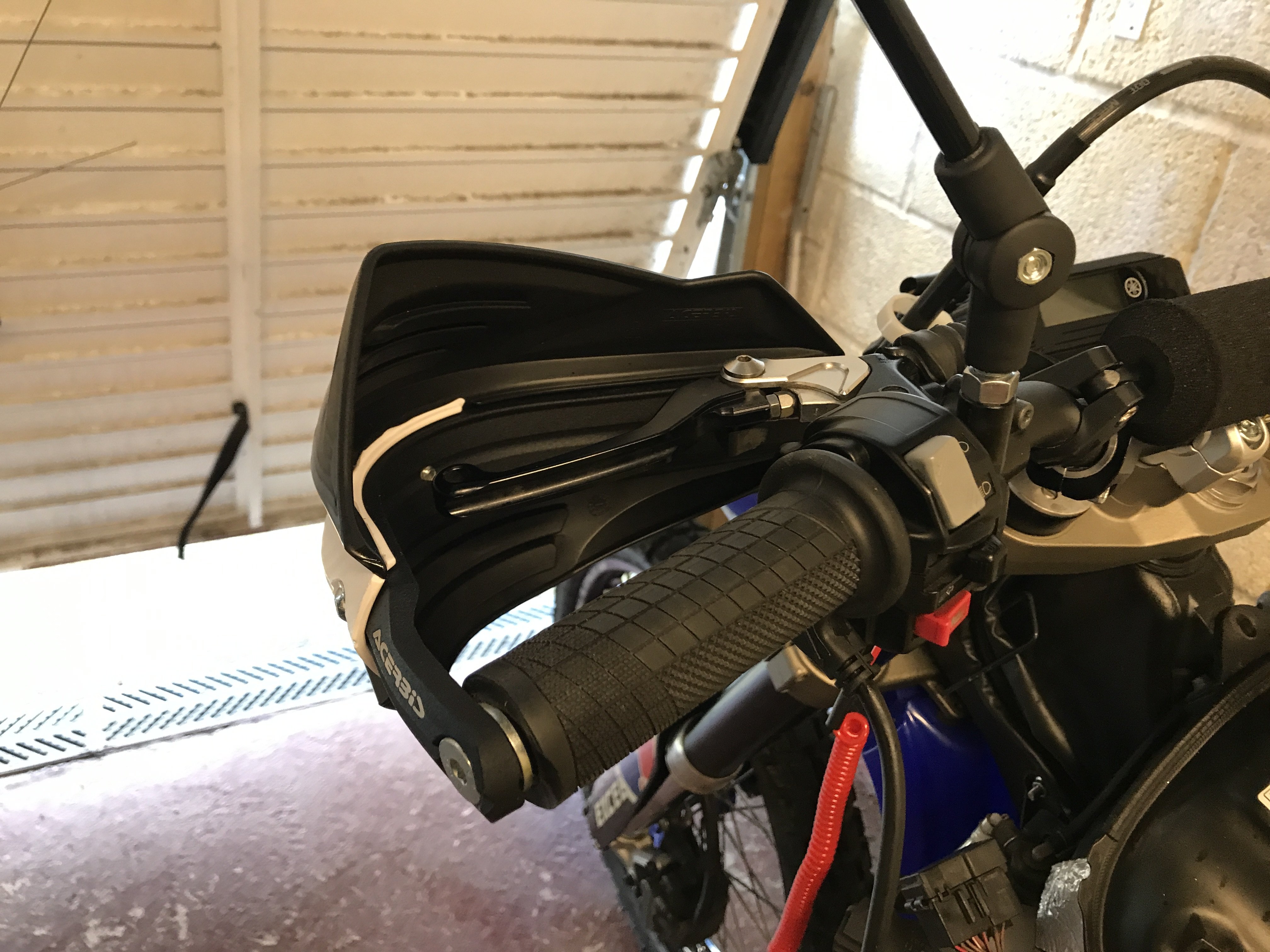

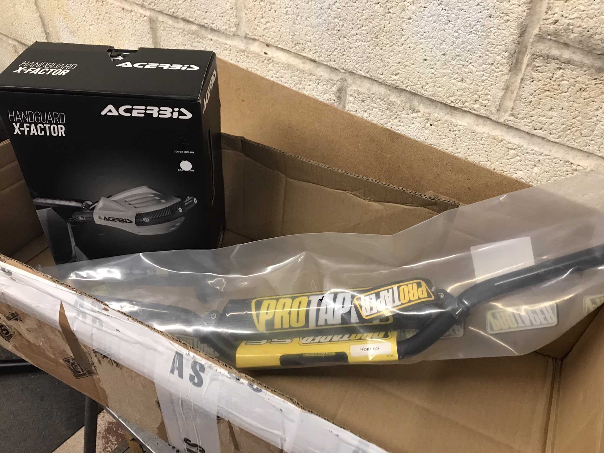

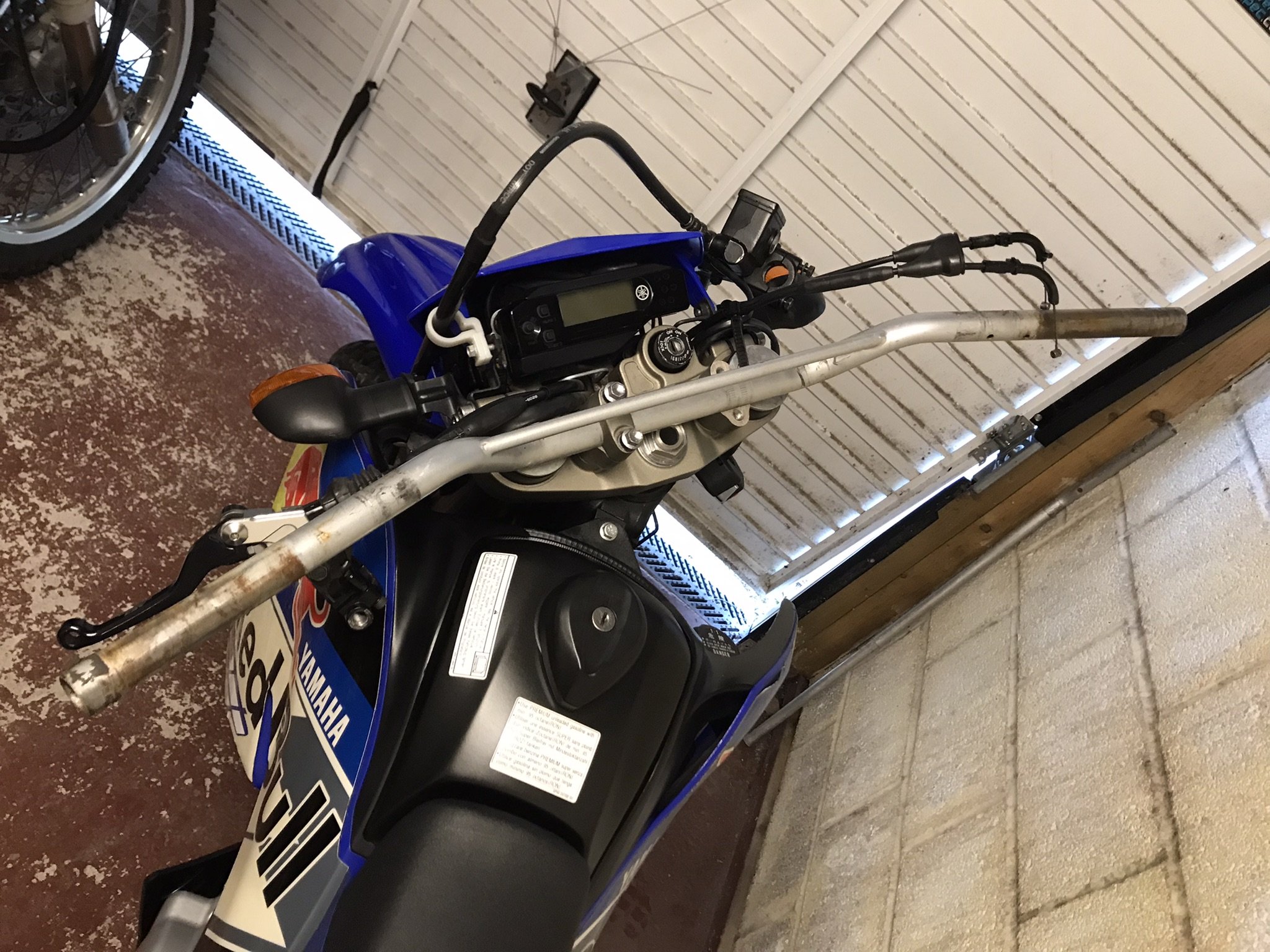

First and foremost was a change of handlebars as the O/E bars were too narrow and not high enough so a Pro-Taper CR High was ordered along with some SW Motech 20mm risers and Acerbis X-Factor hand guards......
The O/E bars were stripped of their belongings ...................
and the new items fitted.  It all went together without too much fuss......................

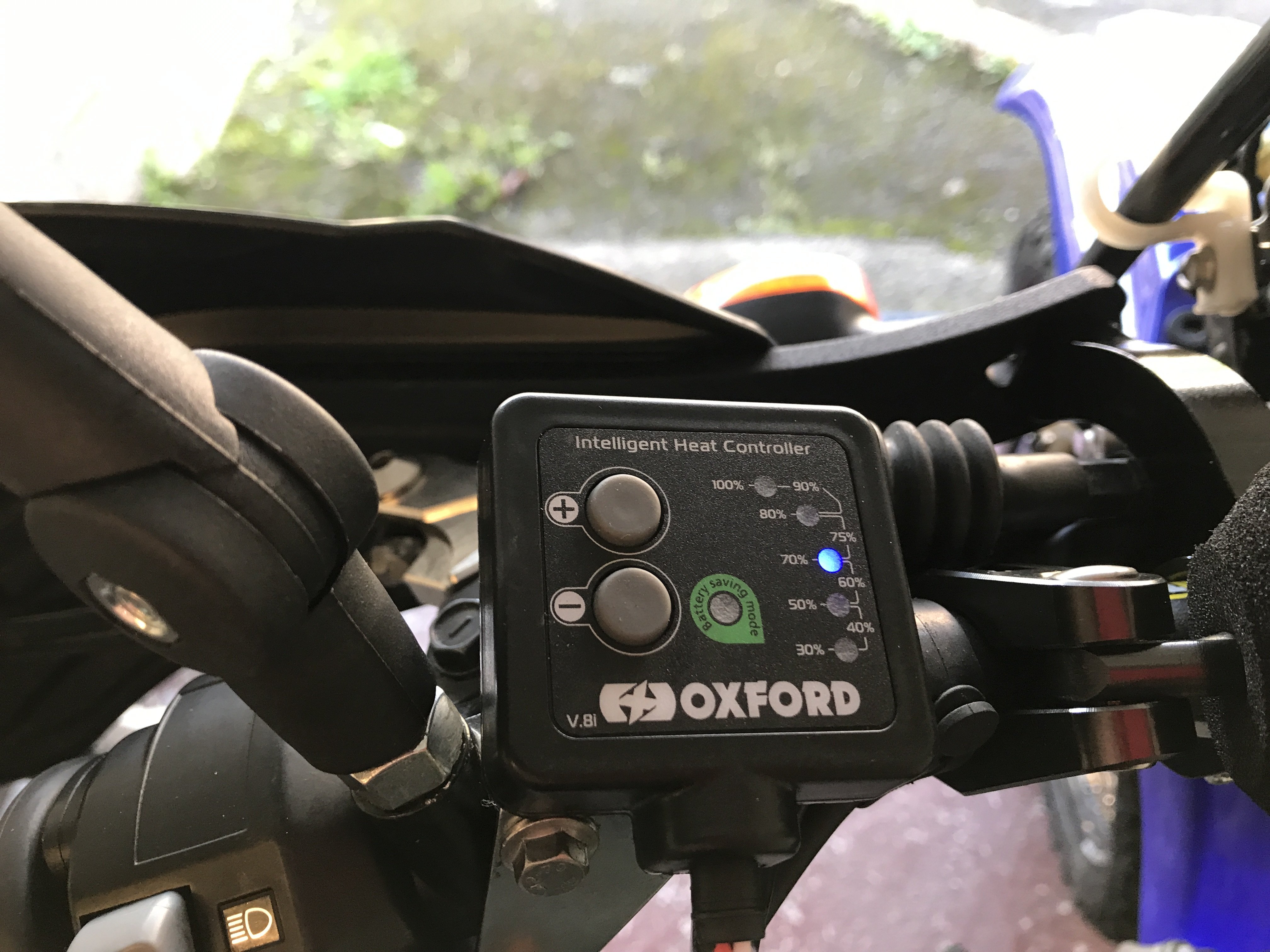

and then some Oxford Advanced heated grips were fitted...............

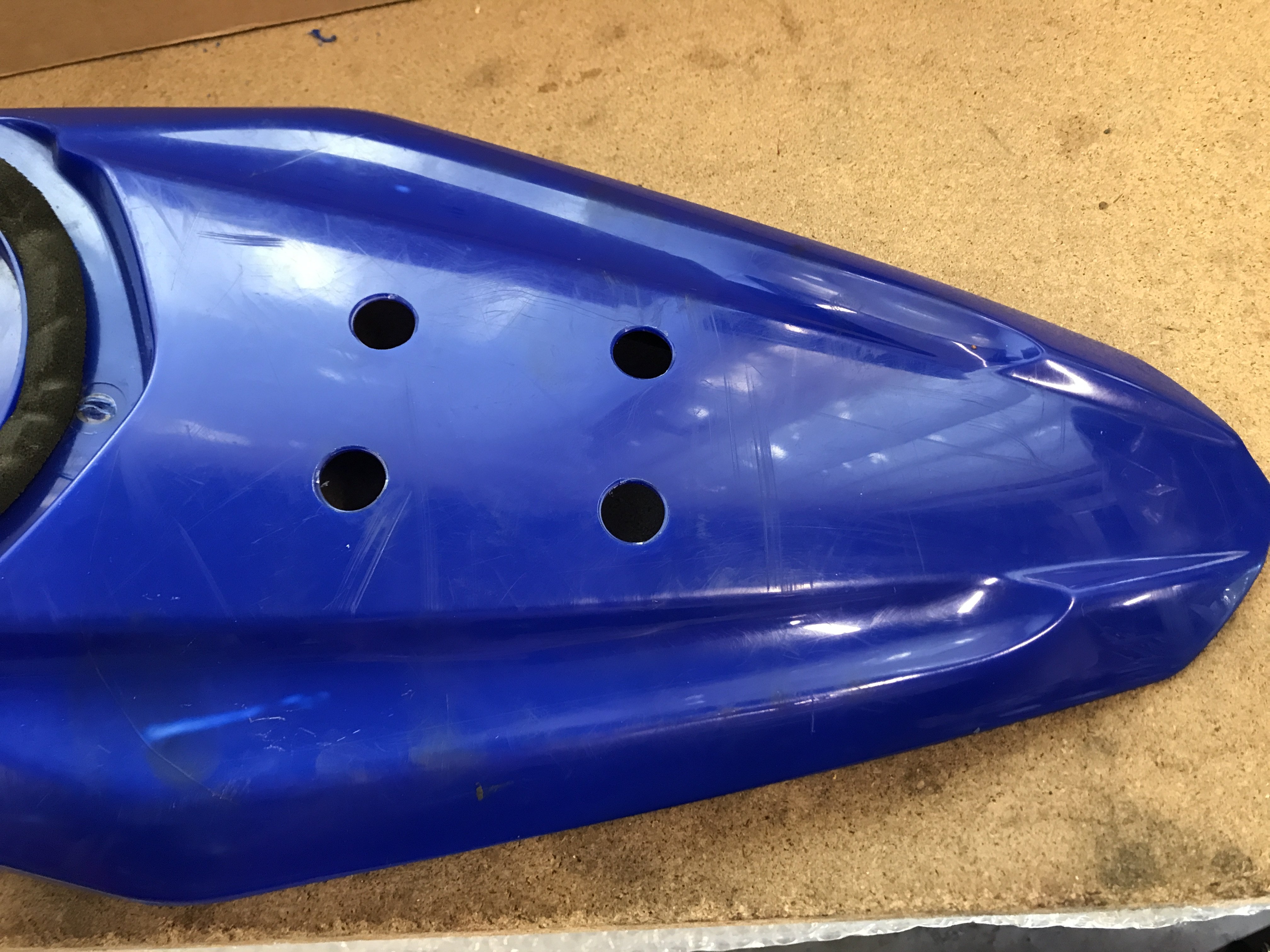

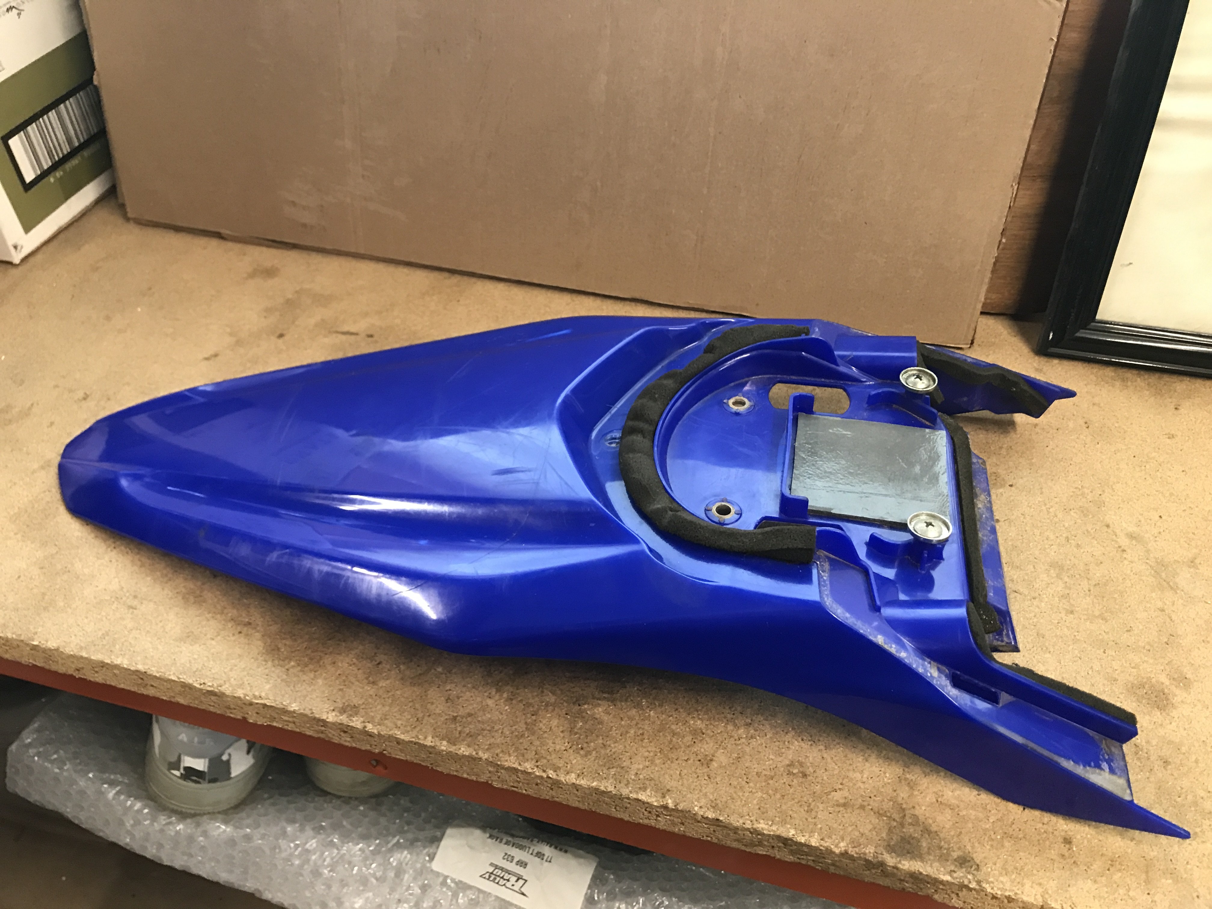

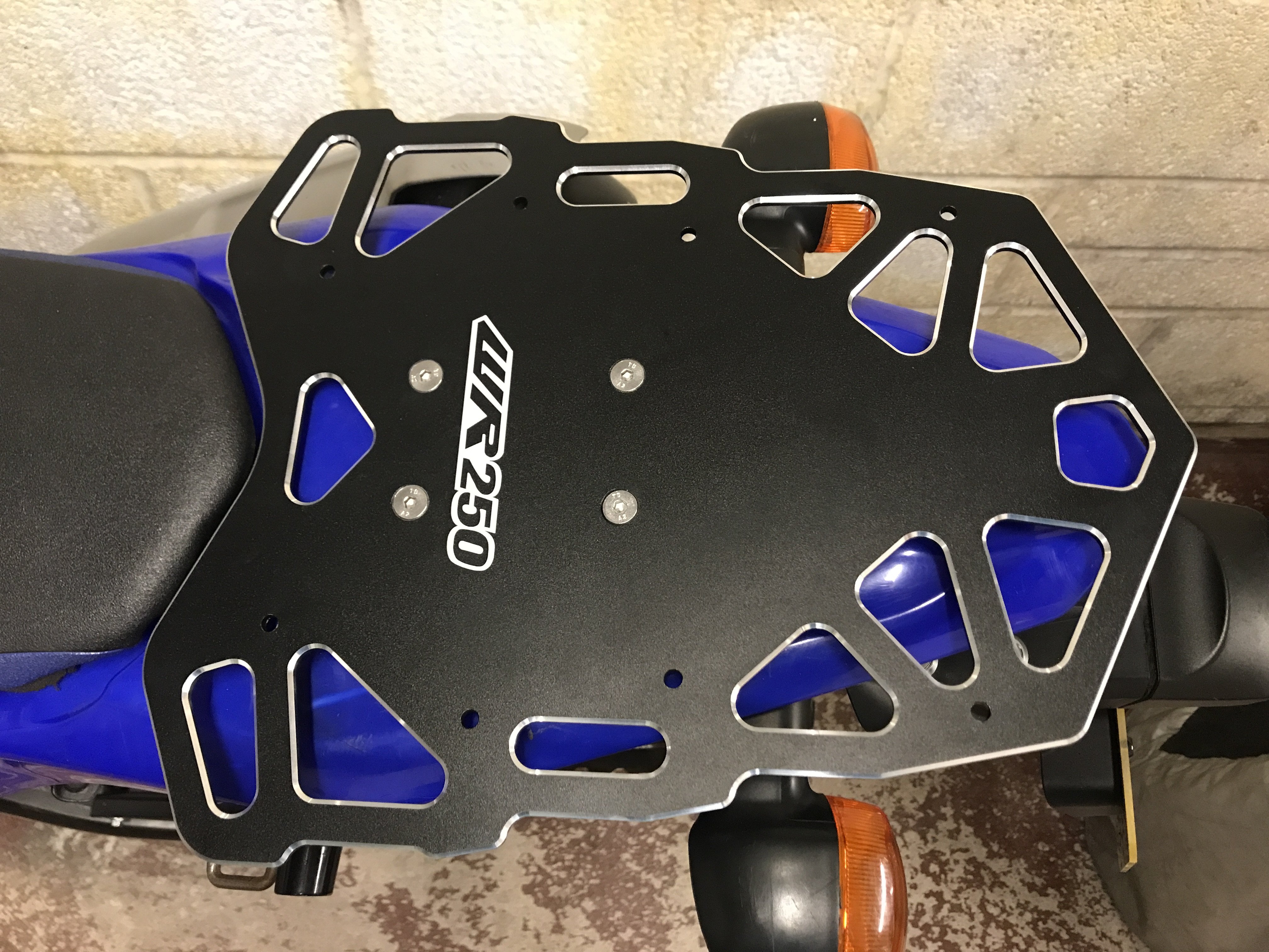

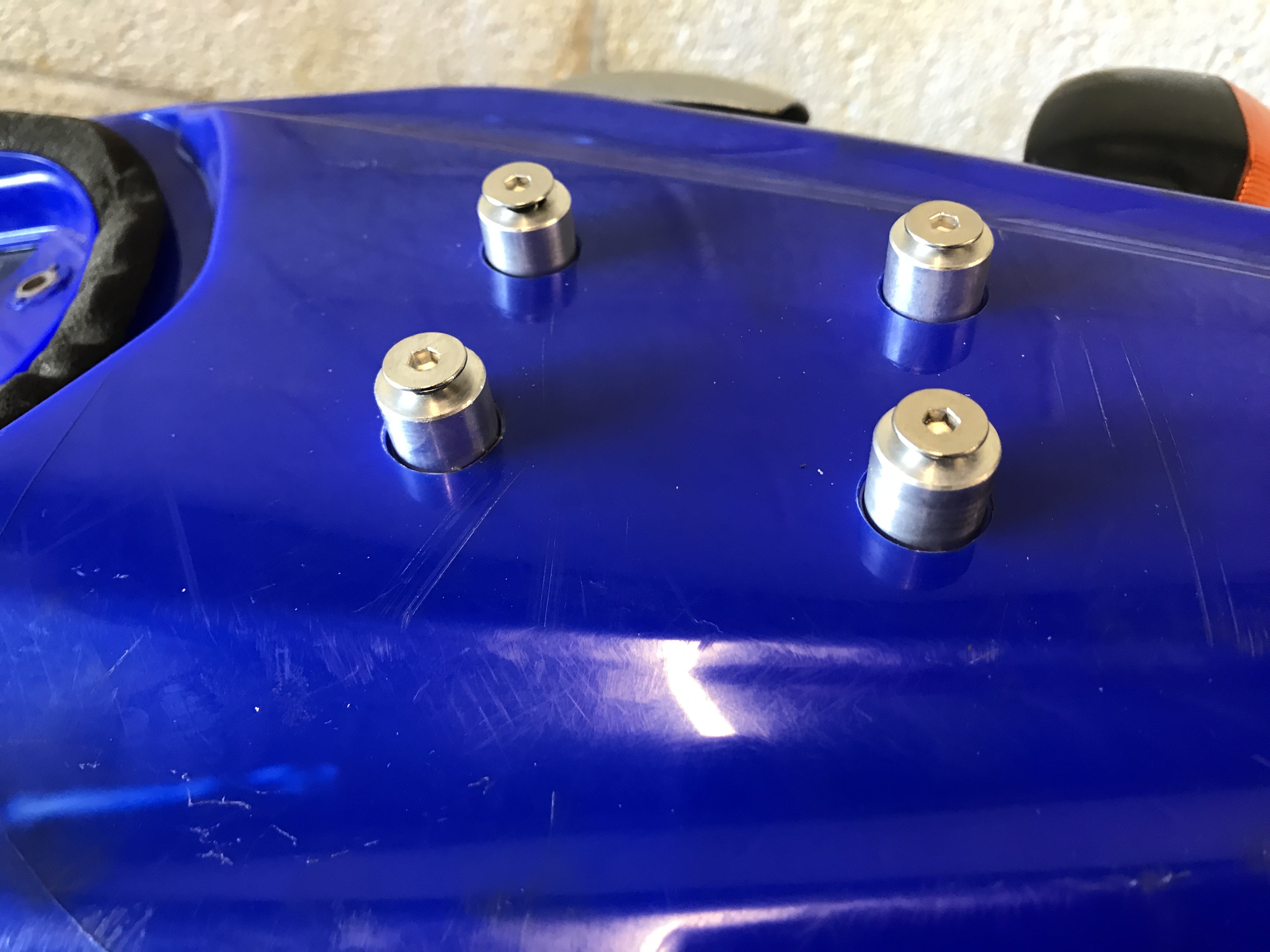

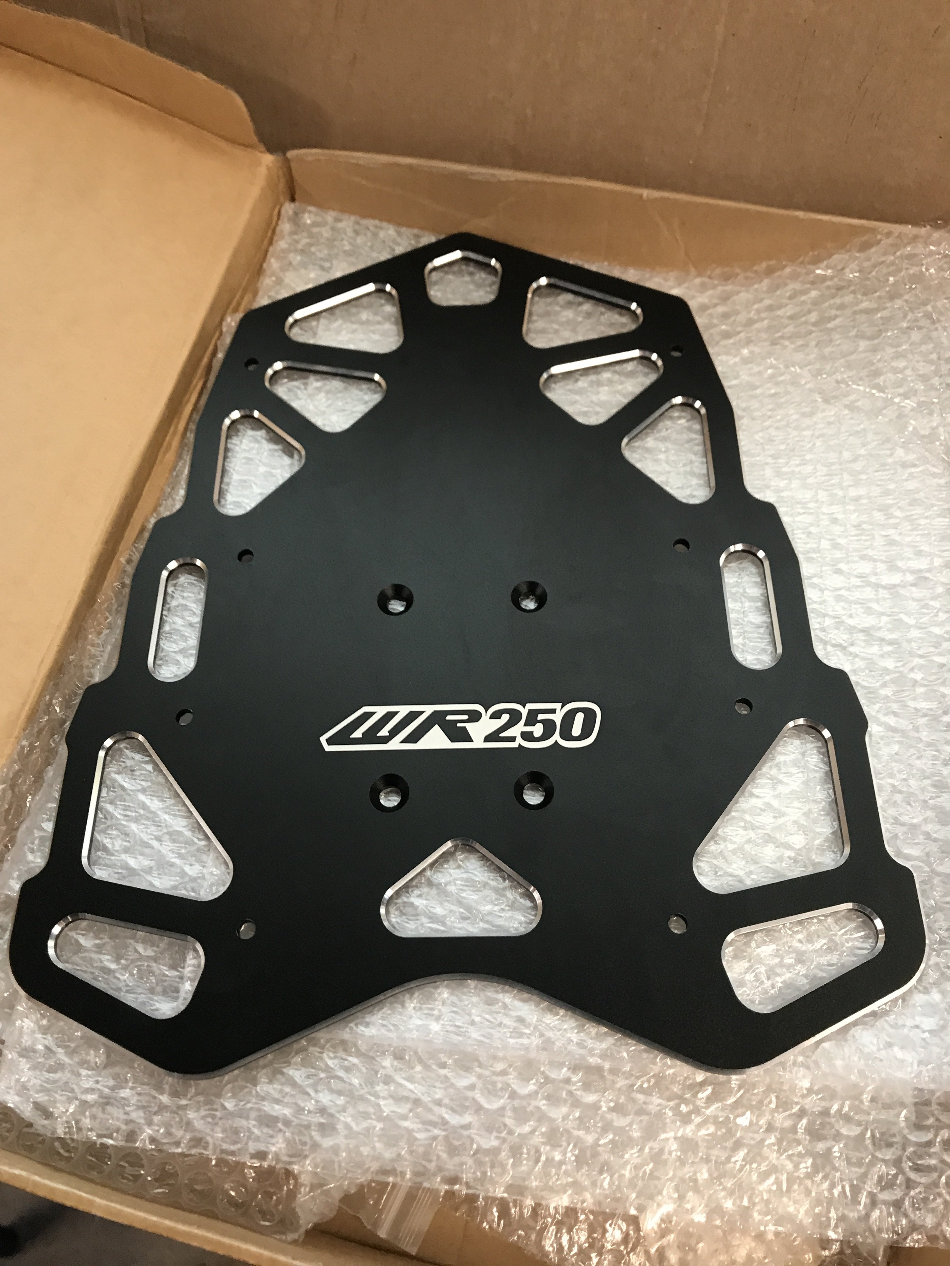

Next up I needed a rack so I had somewhere to carry tools, tubes, tyre levers etc.  There wasn't a great deal of choice so in the end I opted for some Chinesium from Ali Express..............

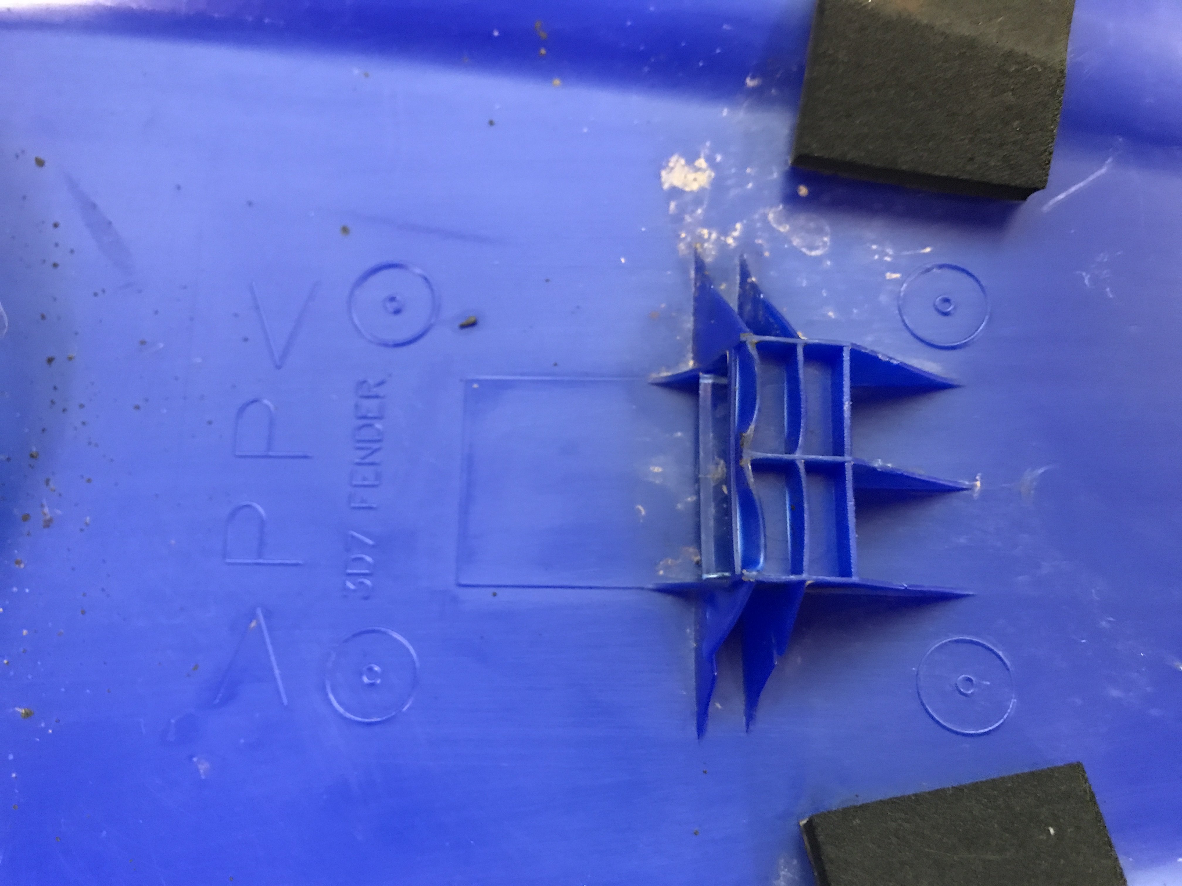

Fitting this required the removal and drilling of the rear mudguard.  Very kindly Yamaha saw fit to mark where you had to drill on the underside of the guard ....................
Then the spacers (supplied) were added to line up with the subframe..............
Two of the supplied bolts were not quite long enough to facilitate a locking nut underneath so I ordered some 10mm longer stainless bolts and then it was done ................

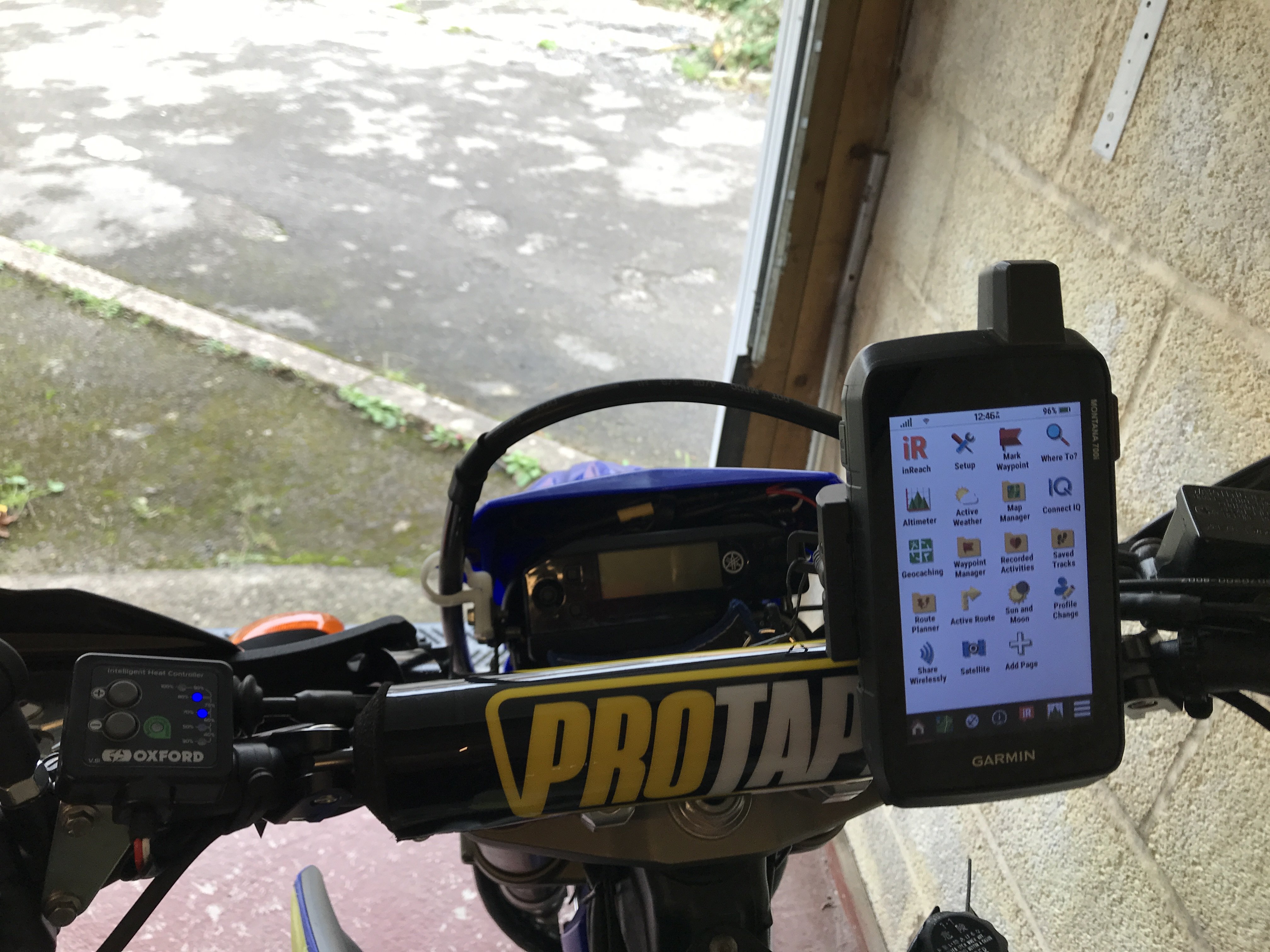

The last thing on the list was to fit my GPS mount.  I tried to find a spare connector with a switched live for a power feed but the loom is quite spartan for a road legal bike.  In the end I decided to tap into the side light wiring with some posi-taps and then managed to find room on the bars to position the mount ..............

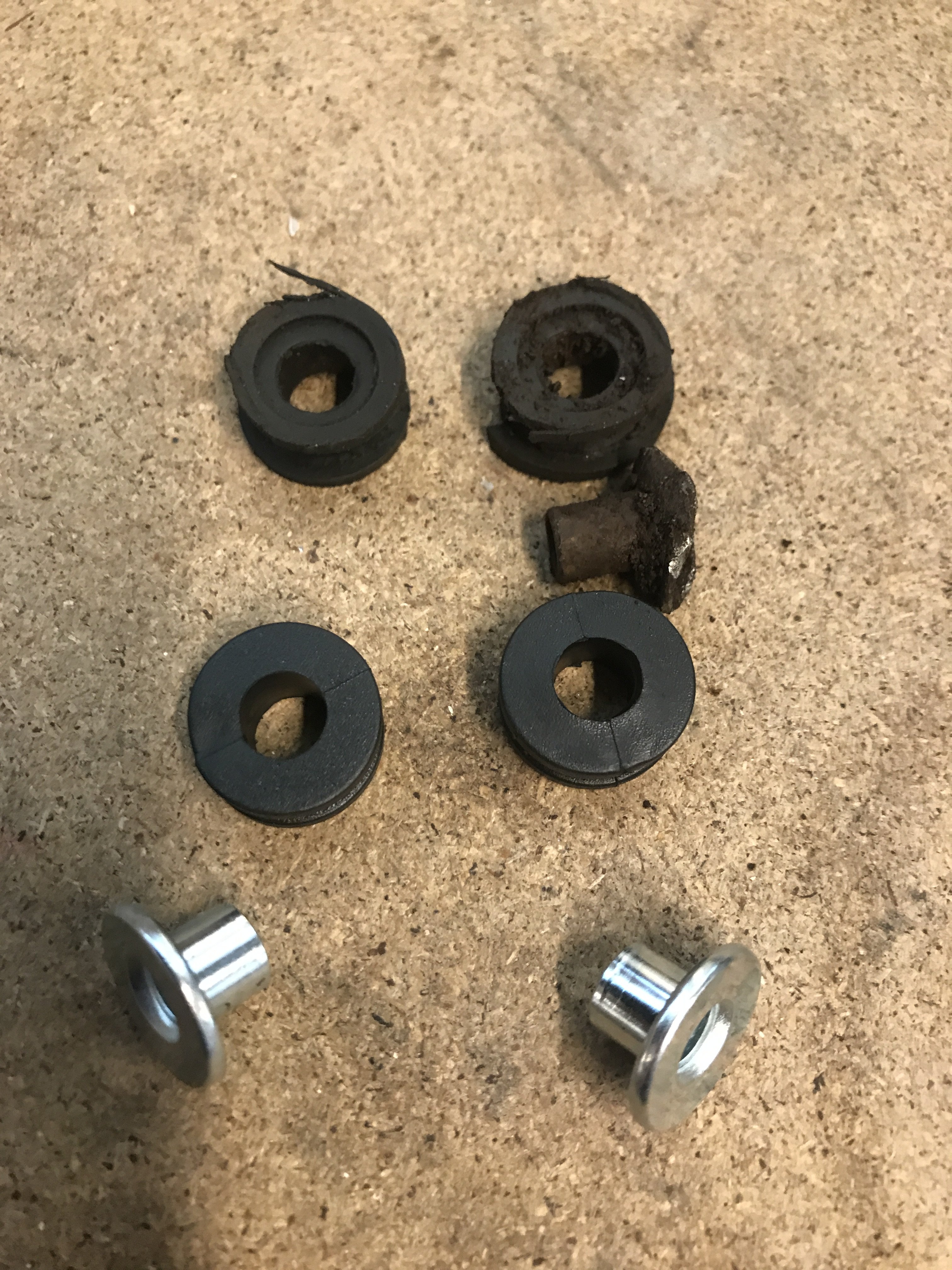

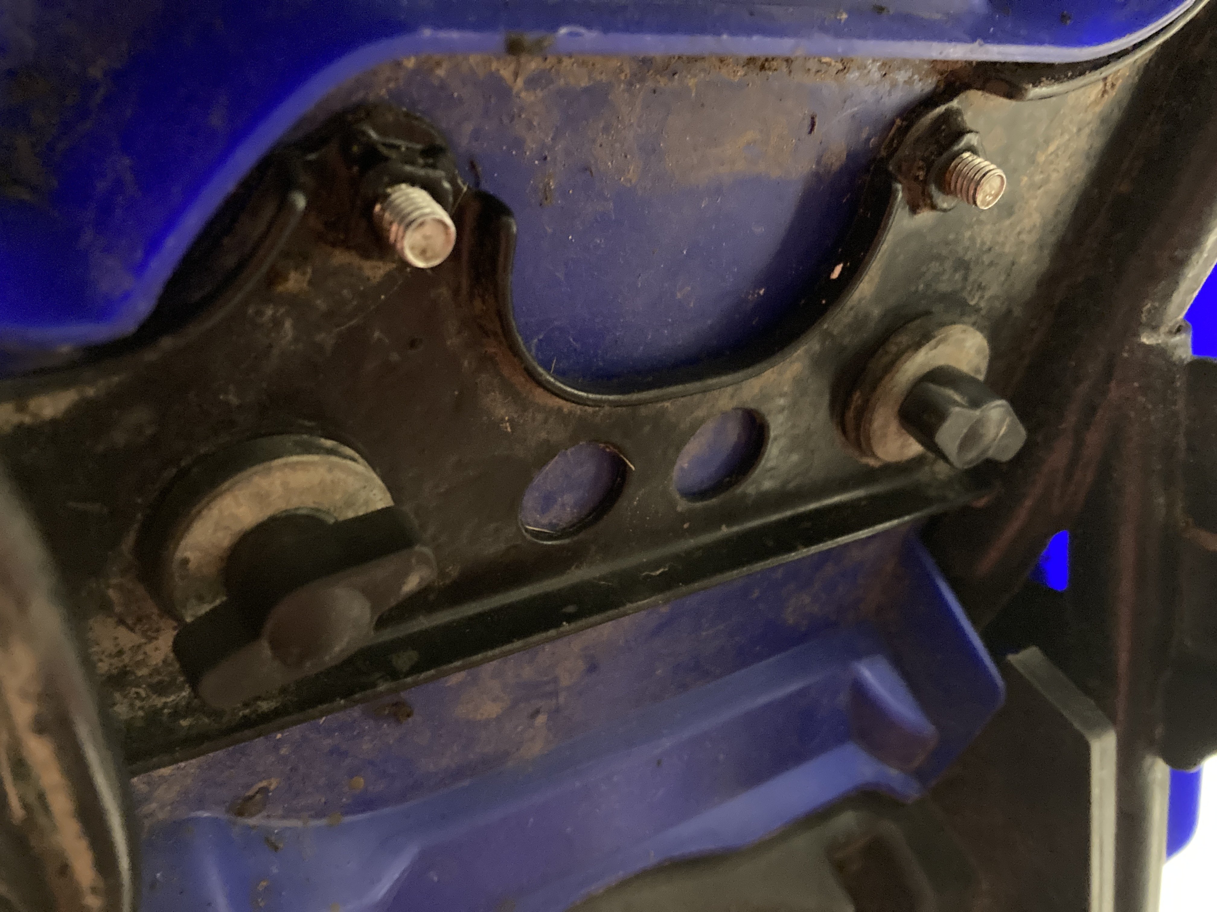

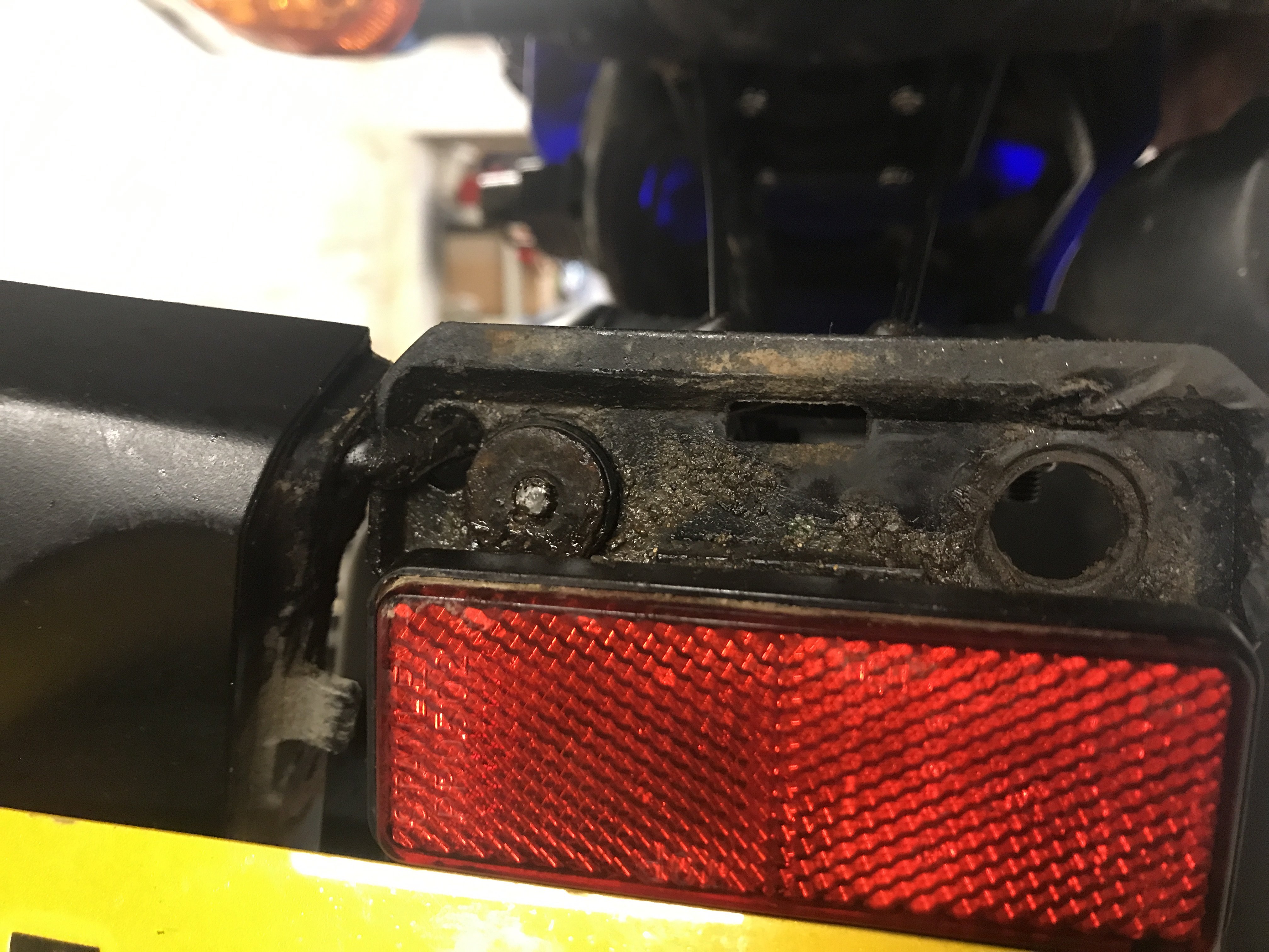

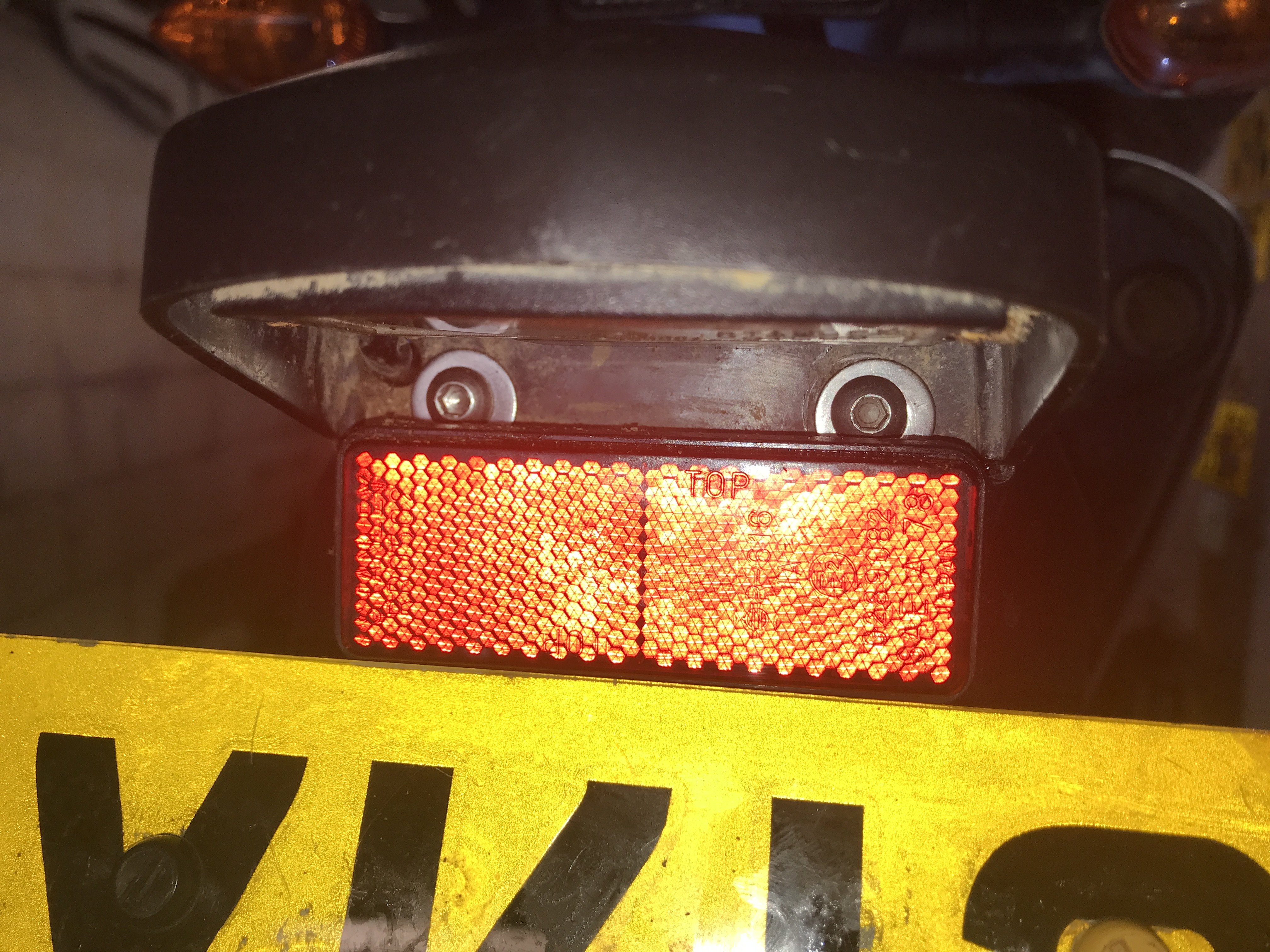

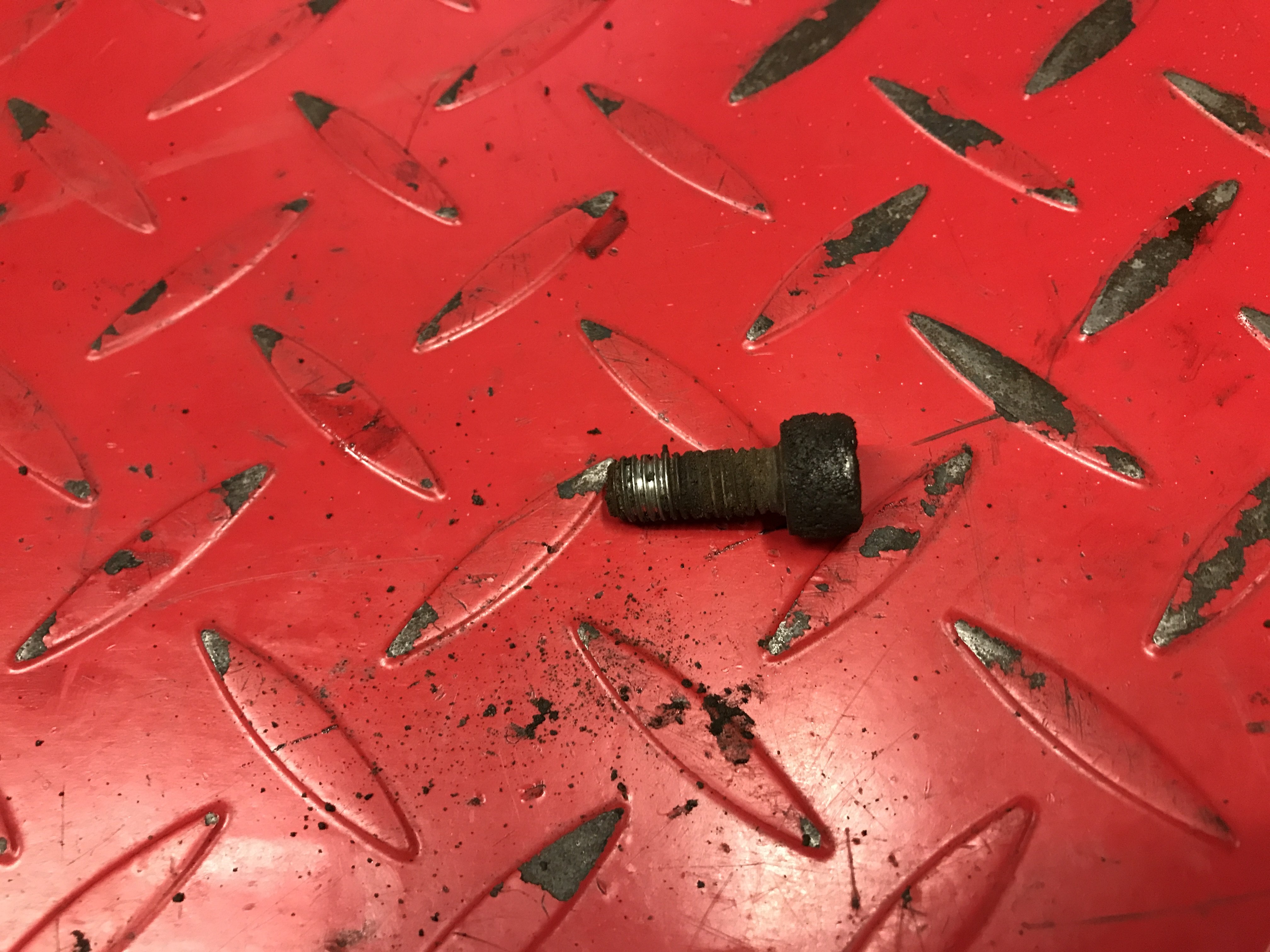

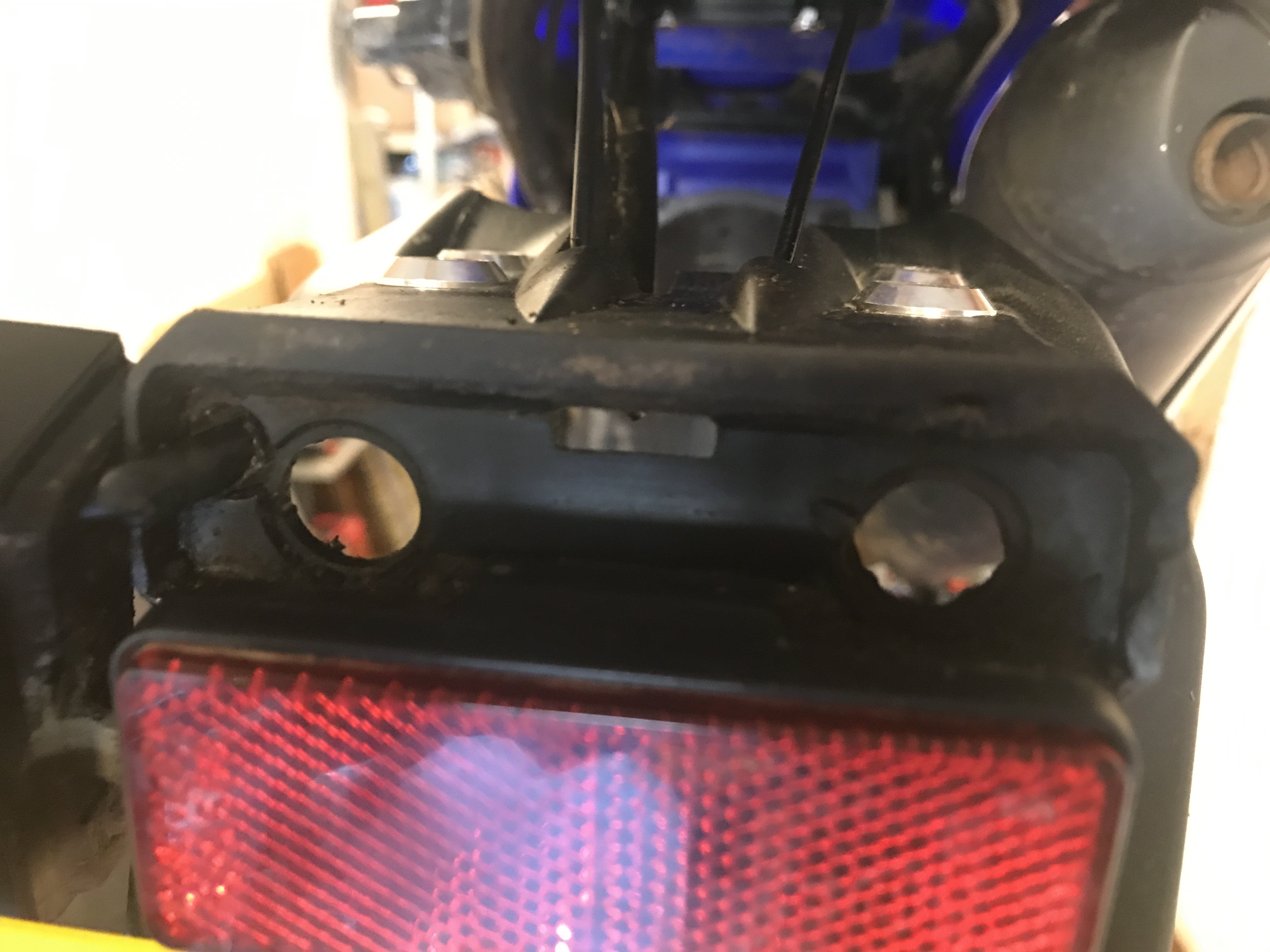

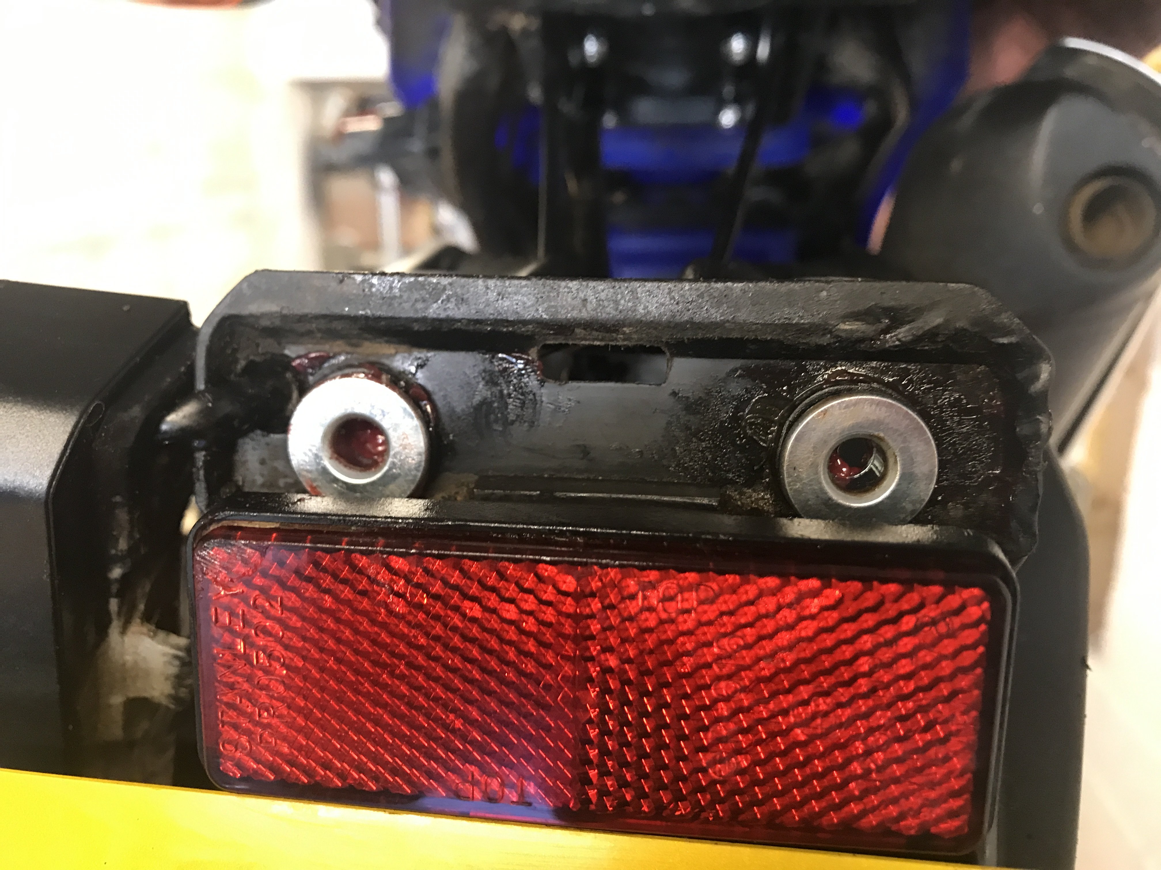

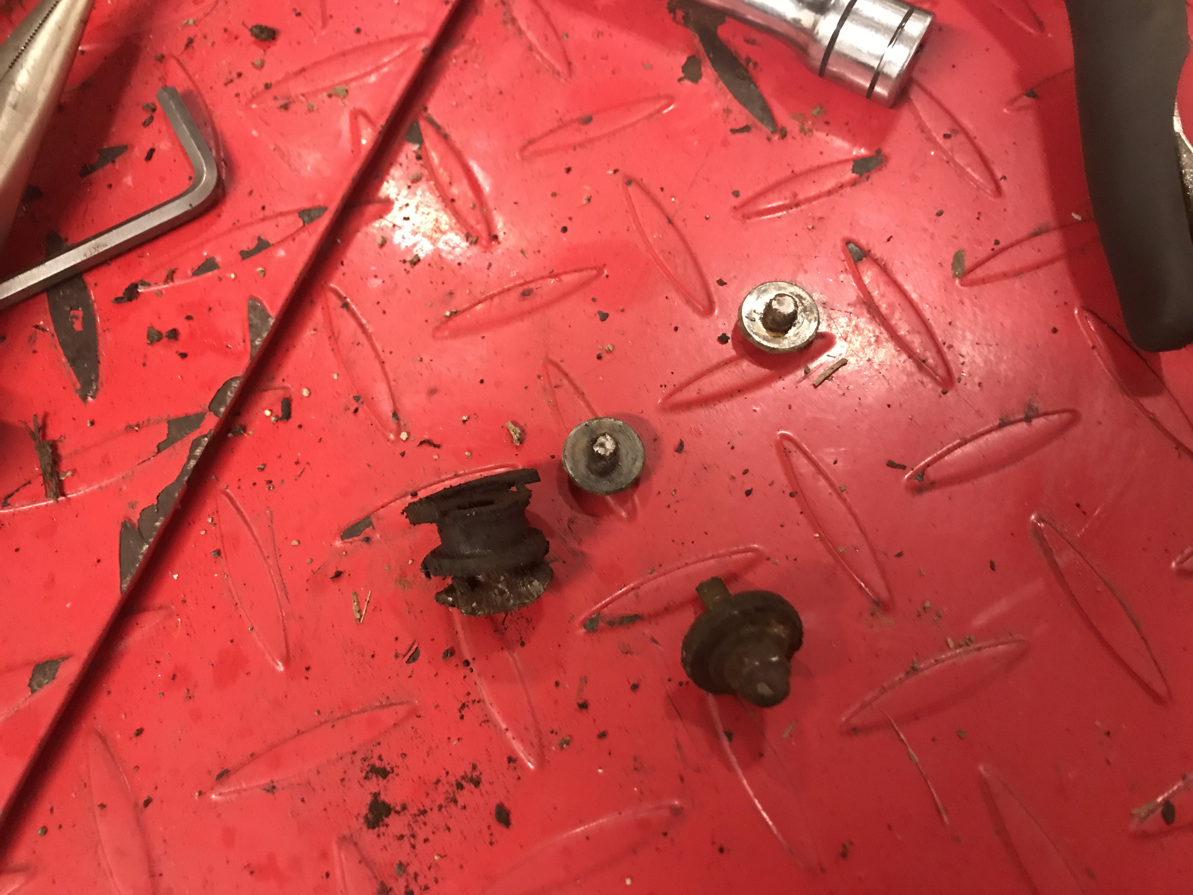

The first thing I noticed was the number plate light was loose so I set about that first.  I looked behind the rear mudguard to find the fasteners and they were real cruddy and sure enough they both snapped off.  That was no biggy but the fact that they were seized in the ferrules that they sit was a pain but I managed to punch them out ...............
I cleaned the area up a bit and then tried to find something to replace the shitty stuff ,,,,,,,,,,,,,,,,,,
You know when you find something and it's just perfect, well this was the day.  I must have bought these over 15 years ago as I bought them to replace some items I had on my last Africa Twin............
a bit of red rubber grease around the grommets and then they were in ..............
and that was that job done ......................

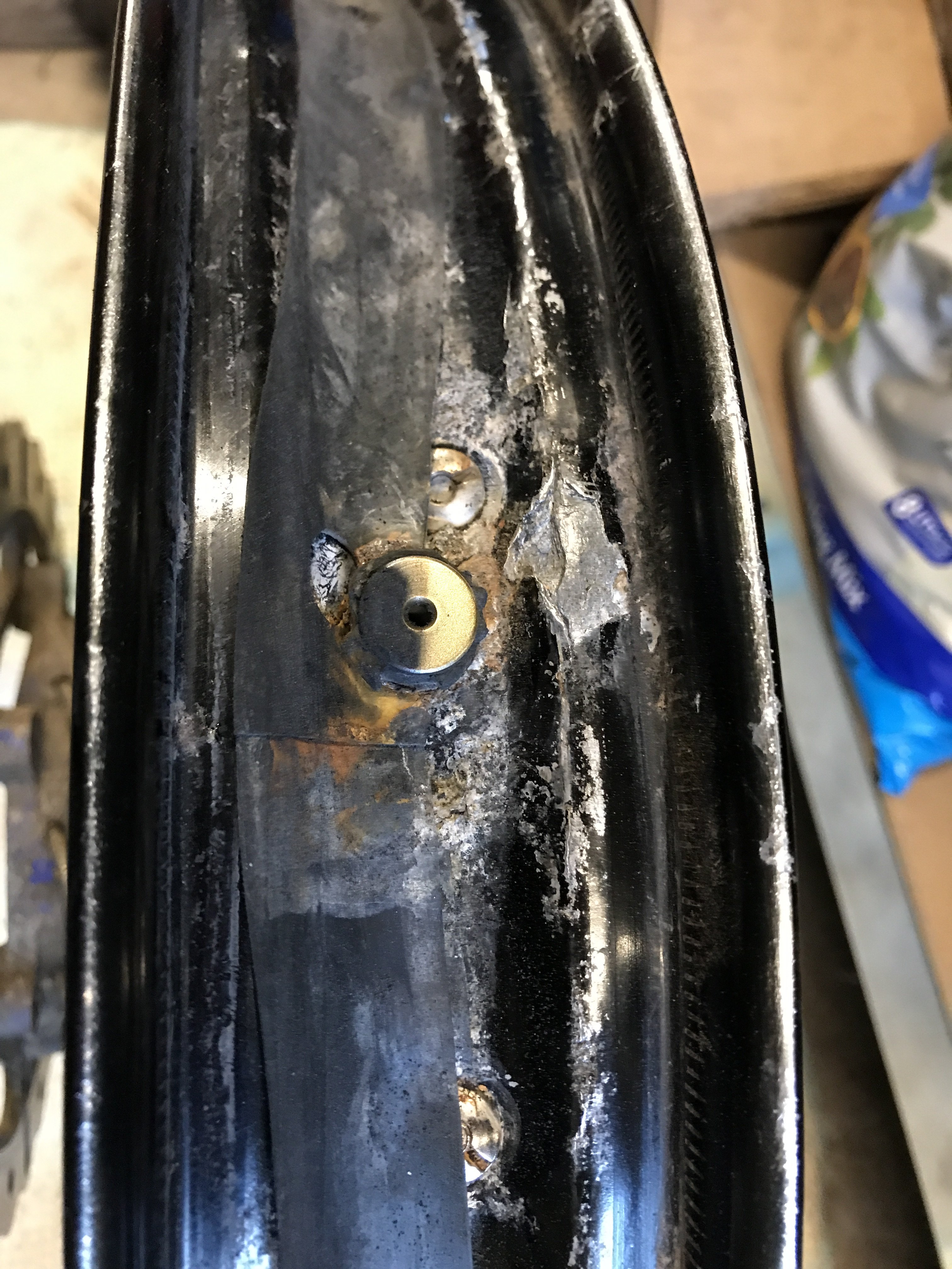

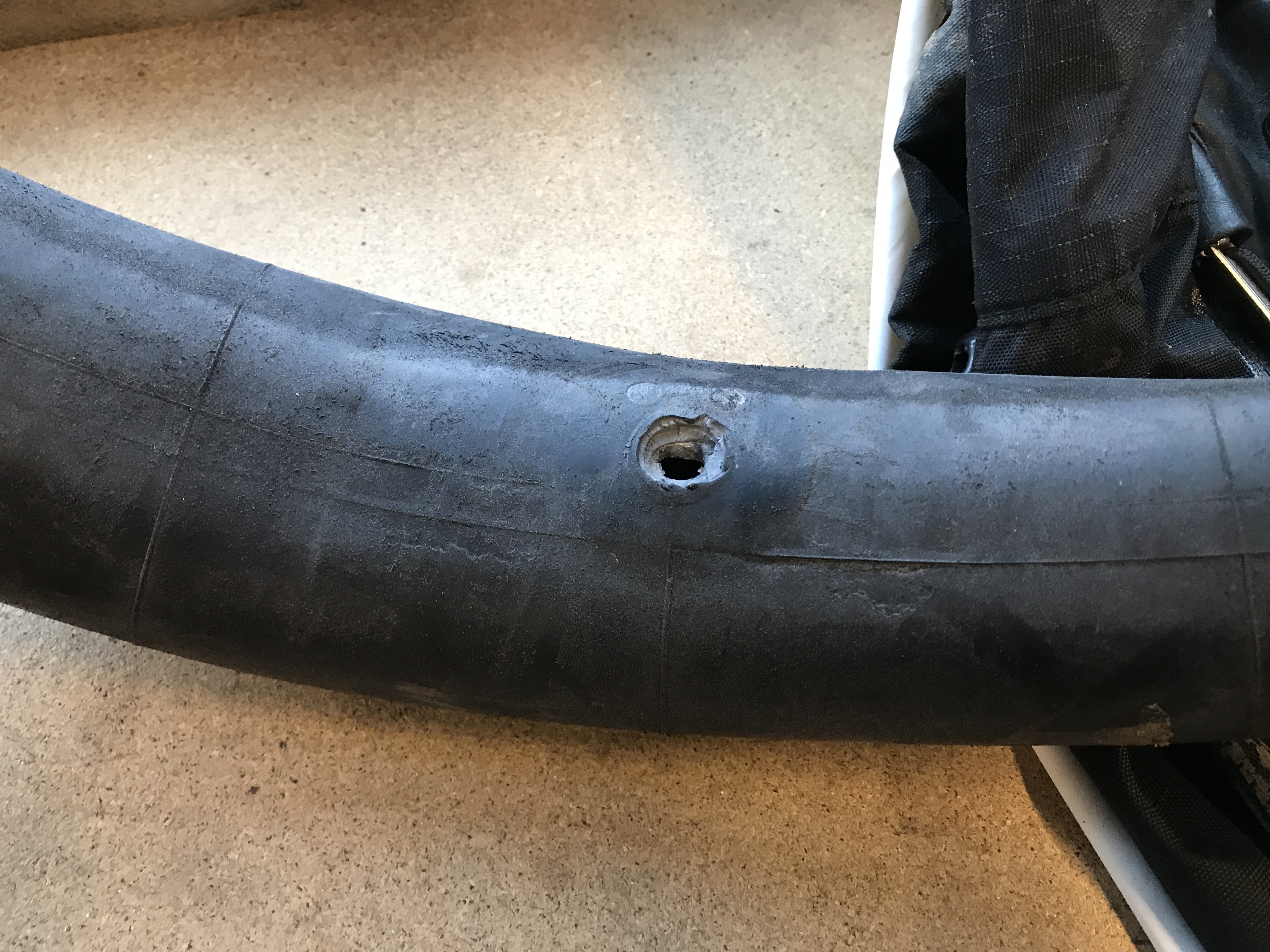

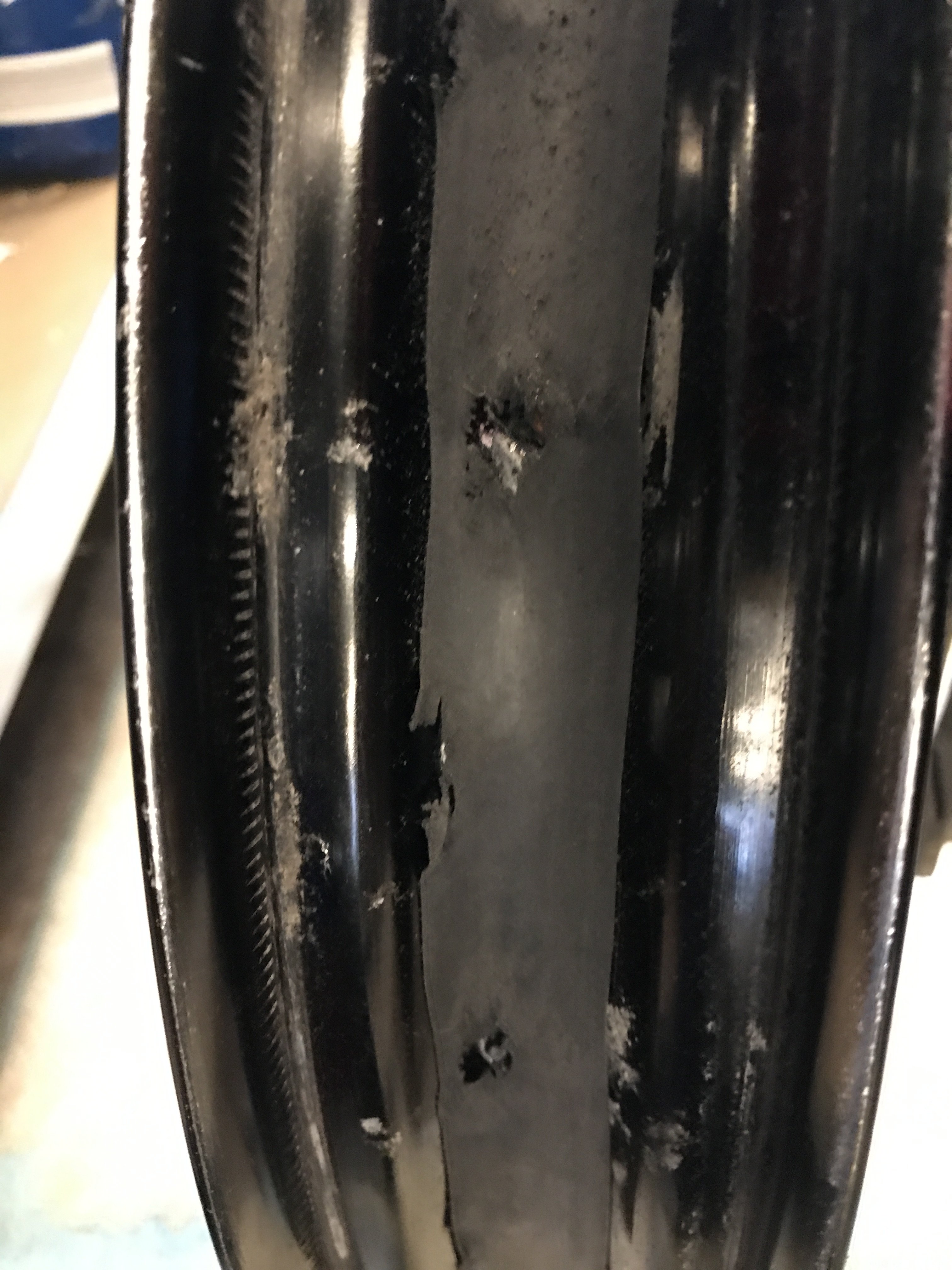

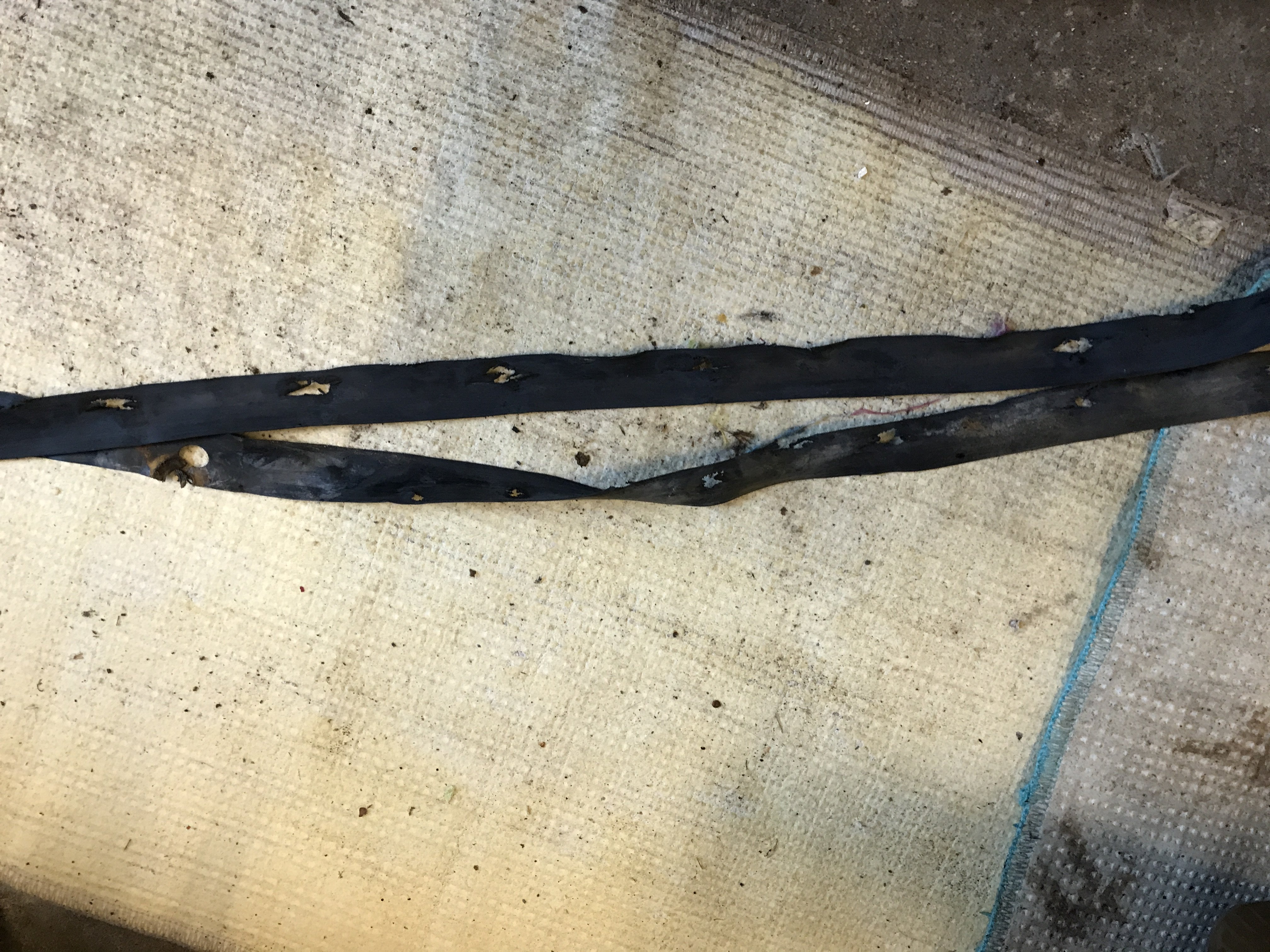

So after the puncture/breakdown debacle I was chomping at the bit to see what the cause was today.  Out came the rear wheel, the tyre was removed and the culprit was revealed ............
The valve had come free of the tube, that explains the instant deflation.  On inspection the area around the valve hole was showing signs of corrosion.  Not great on a set of wheels that are only 15 months old   :classic_wacko:
The rim tape was also destroyed from riding 7 miles on a flat tyre...............
I've cleaned up the rim , mounted a new rim tape, tube and new tyre.  I'll carry on with the rest of it on Tuesday .

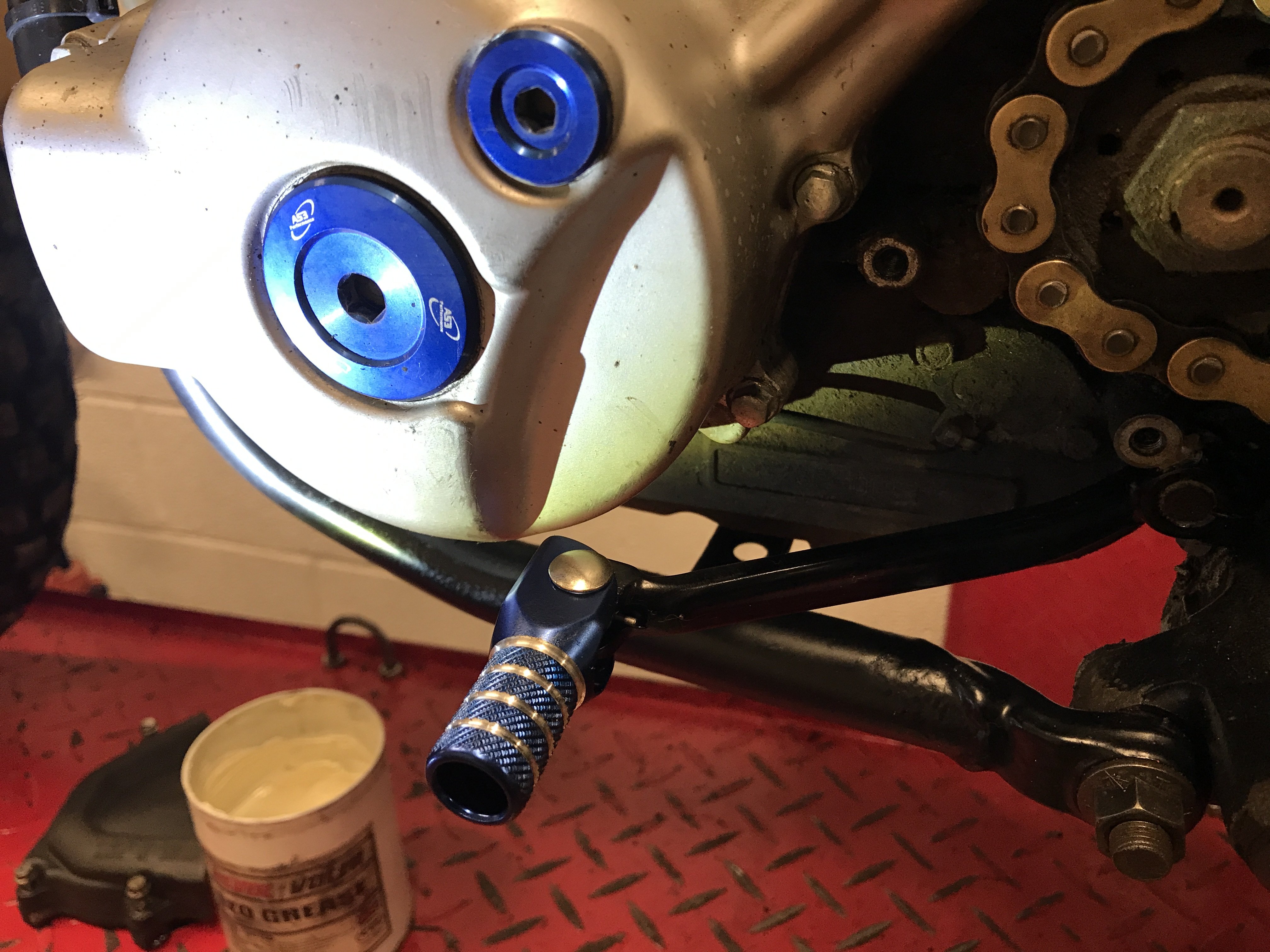

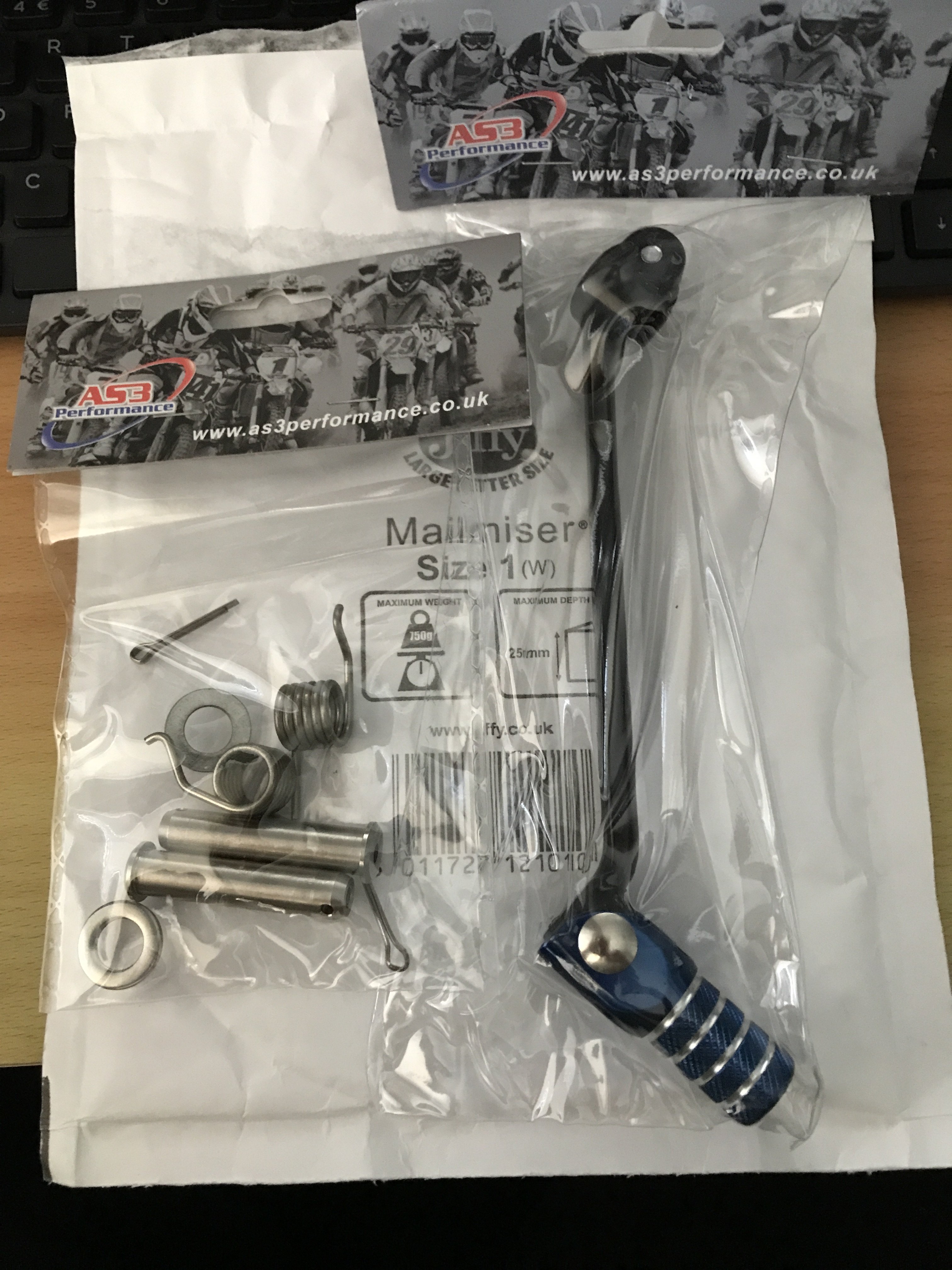

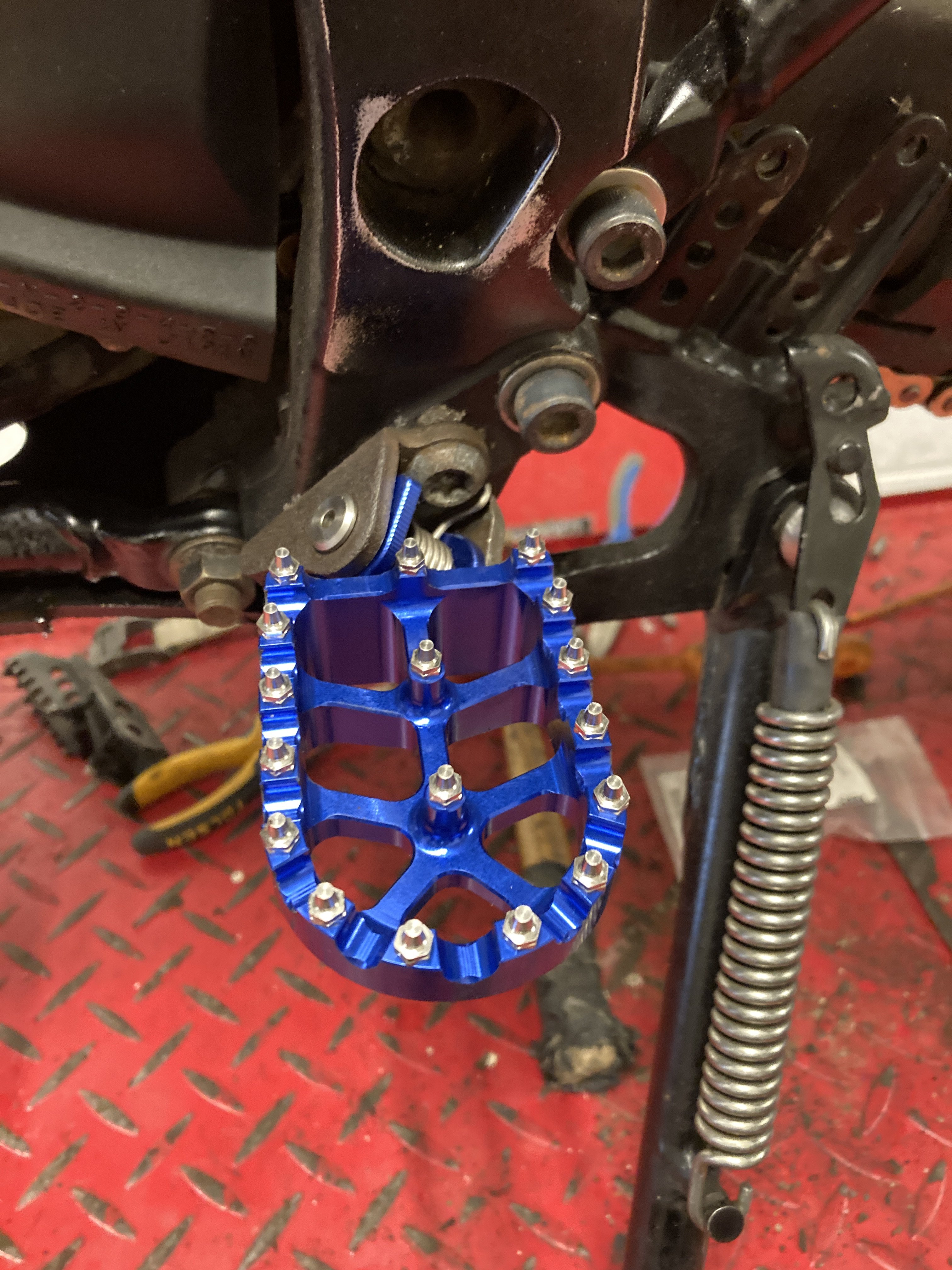

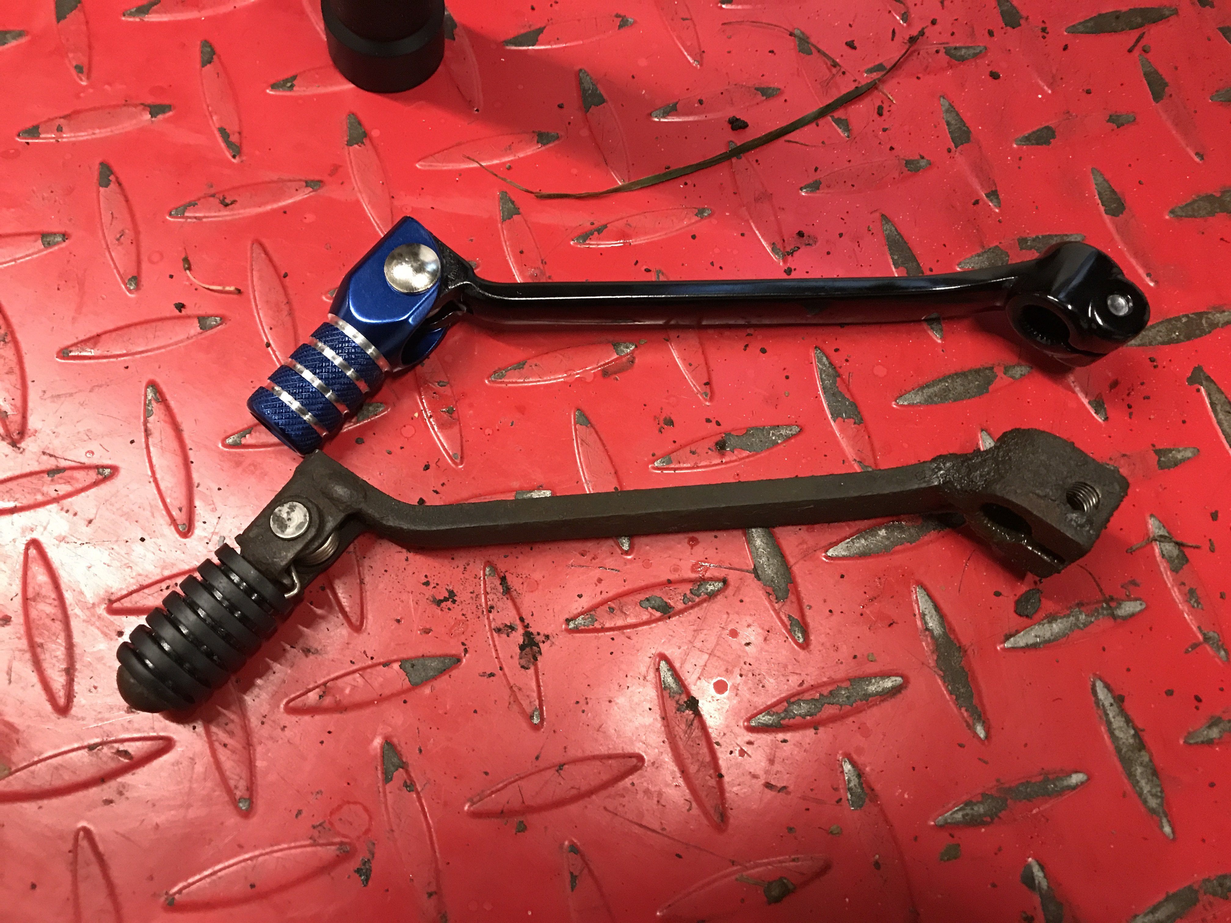

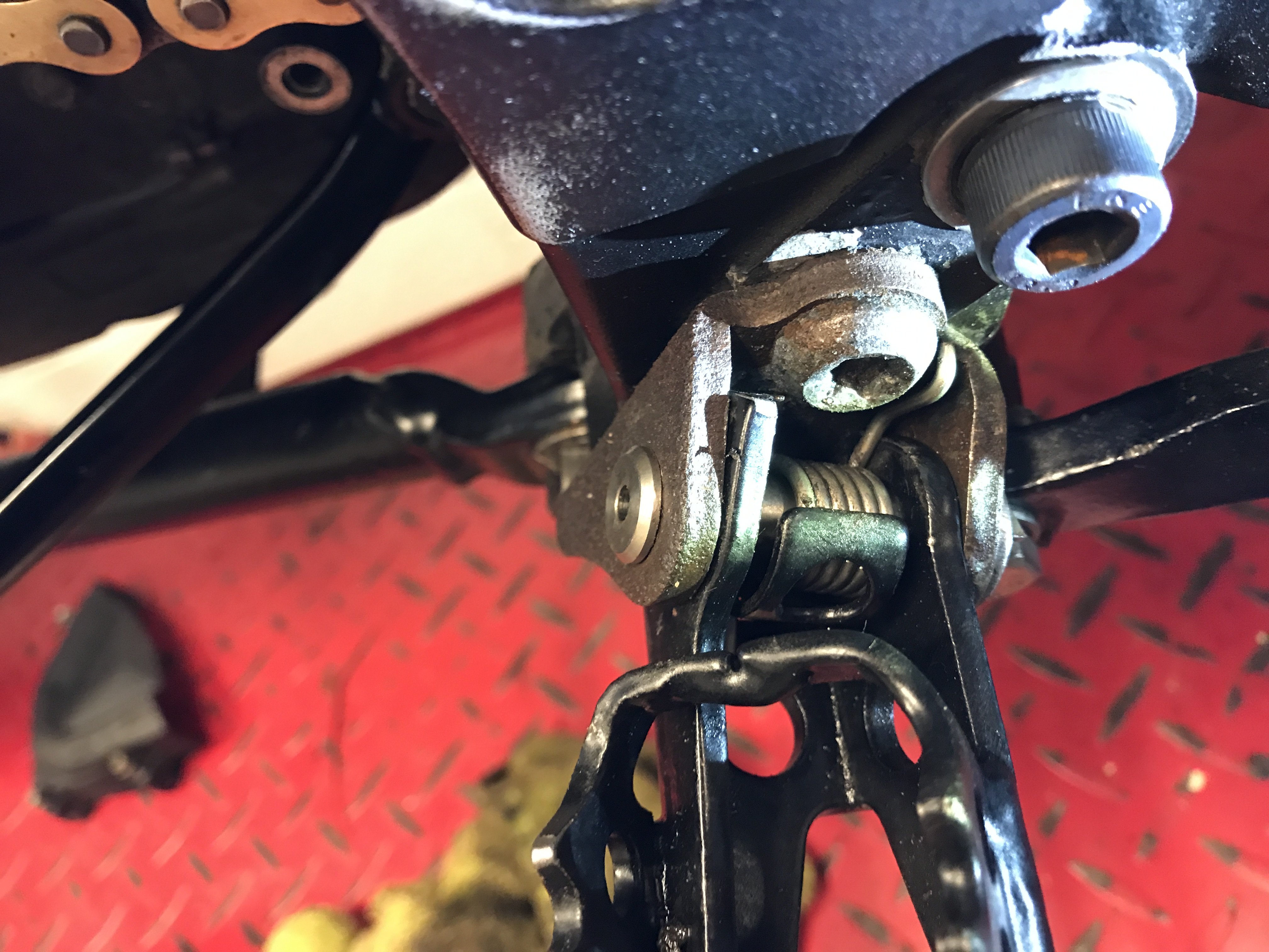

So last week after washing the bike I got it up on the ramp to check things over.  I found that one of the footrest springs was missing and I really didn't like the gear lever as it was very cruddy.  New stuff arrived this week.............
The bolt on the gear lever didn't give up without a fight , it needed heat, WD-40 and a long breaker bar to free it...............
Old and new together ............
and fitted, along with new footpeg posts and springs ............

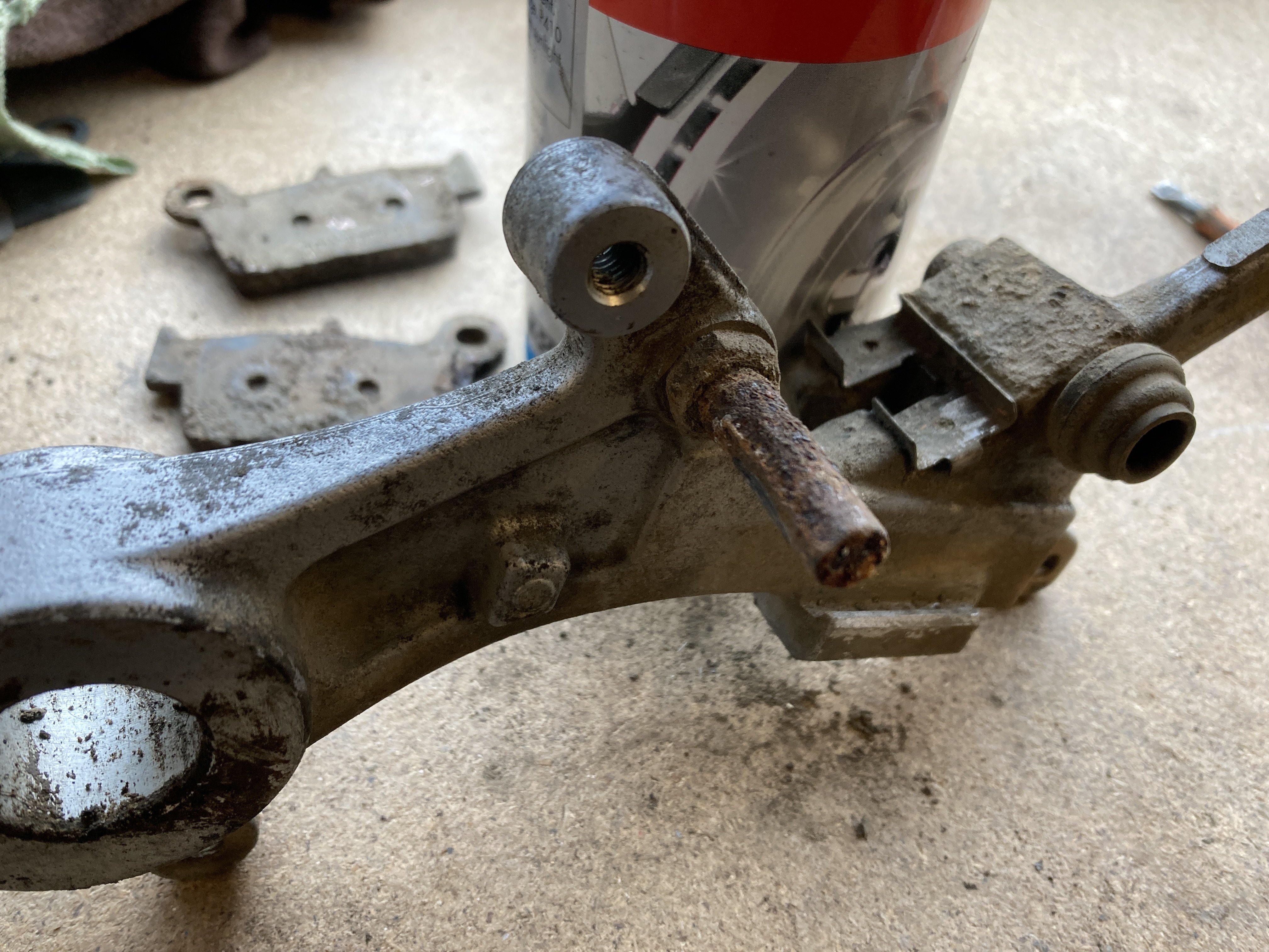

I don’t think the previous owner knew anything about preventative maintenance.
Look at the state of this slider pin on the rear brake caliper 😳

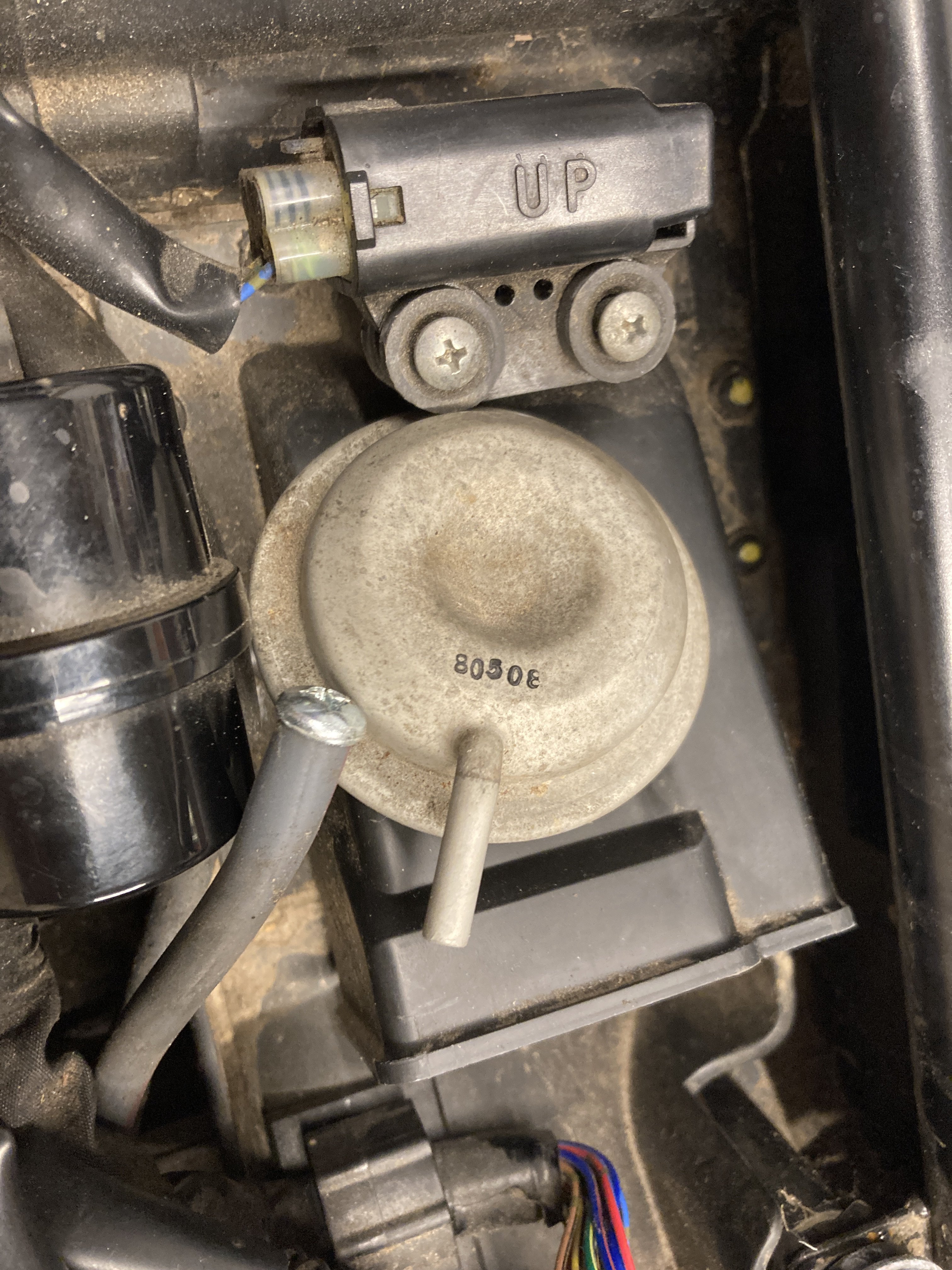

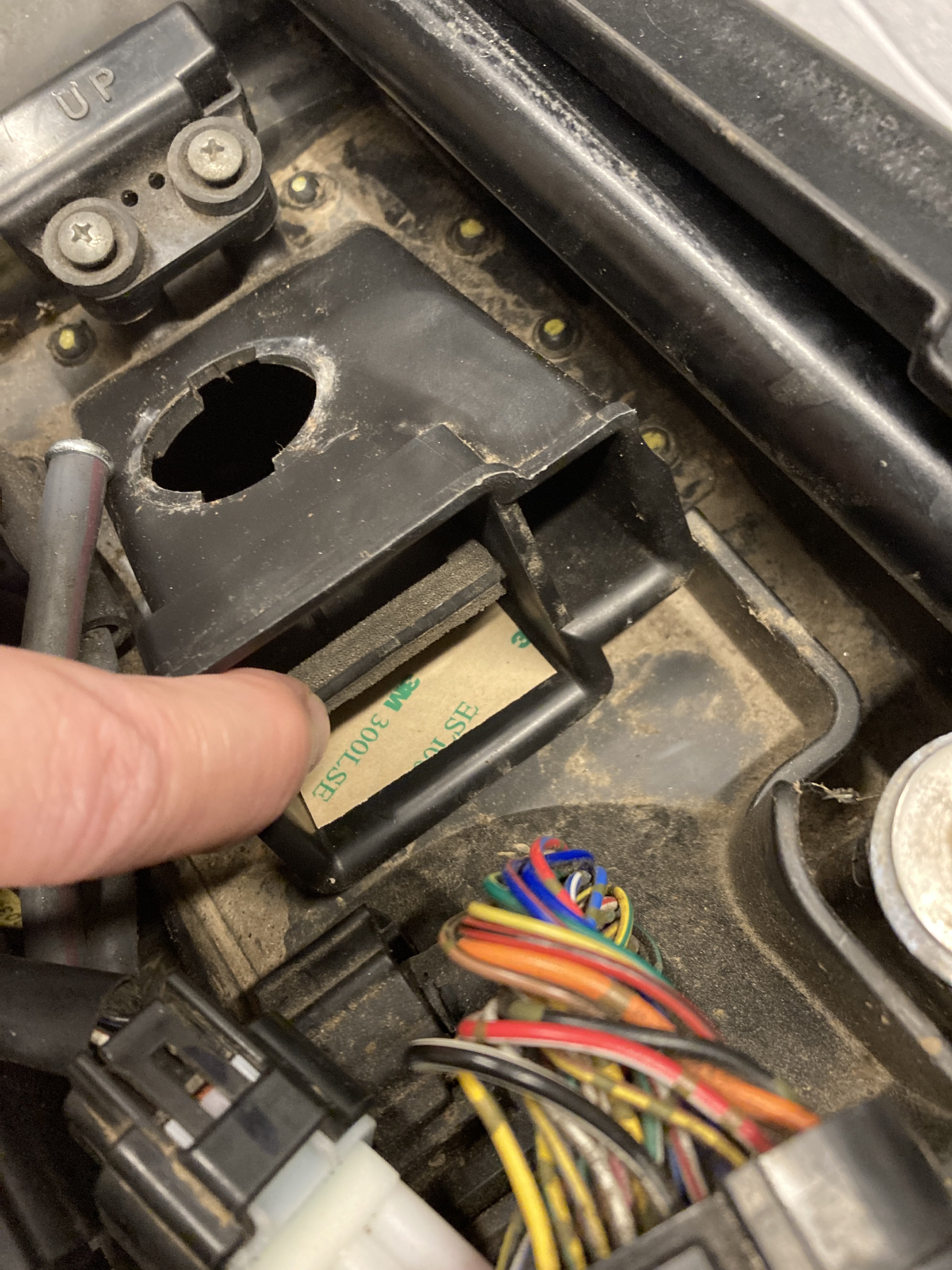

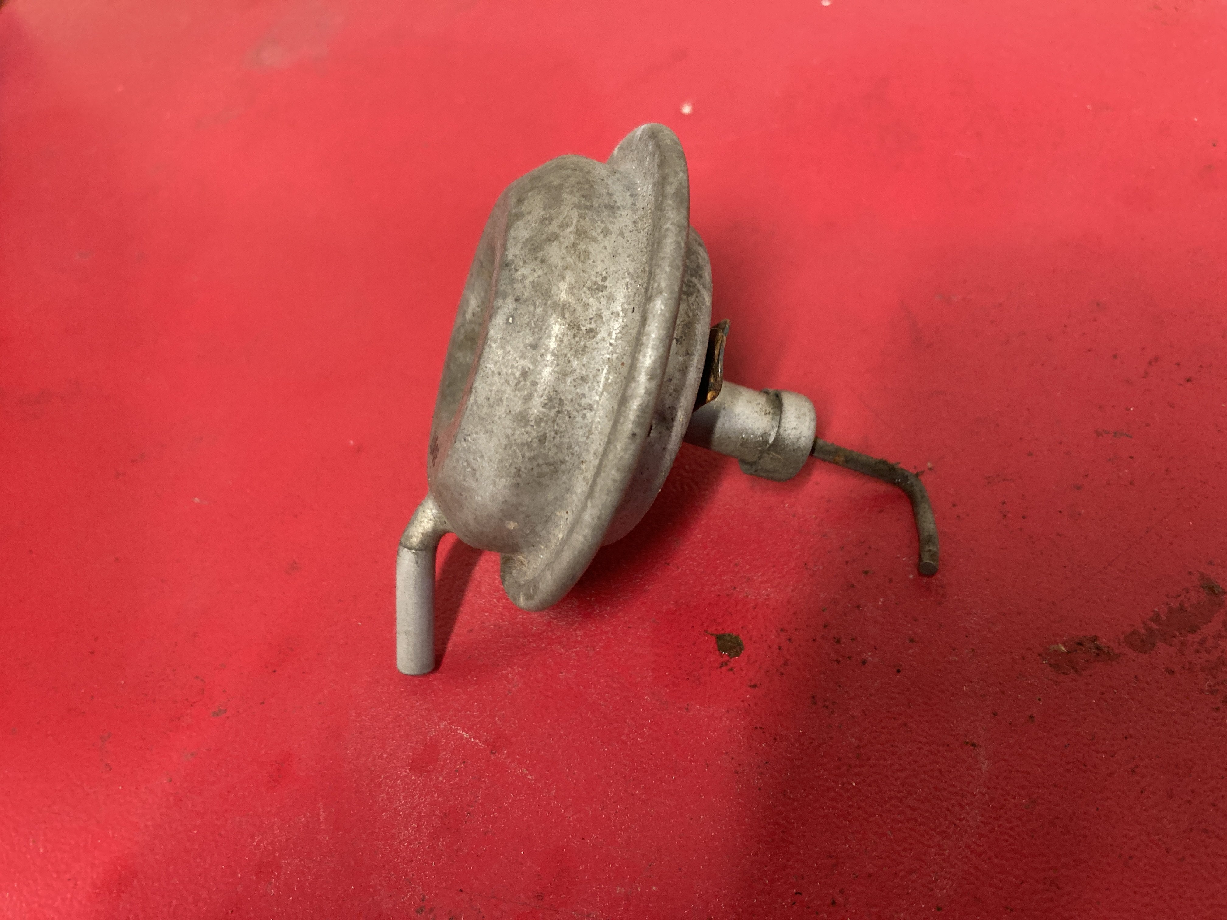

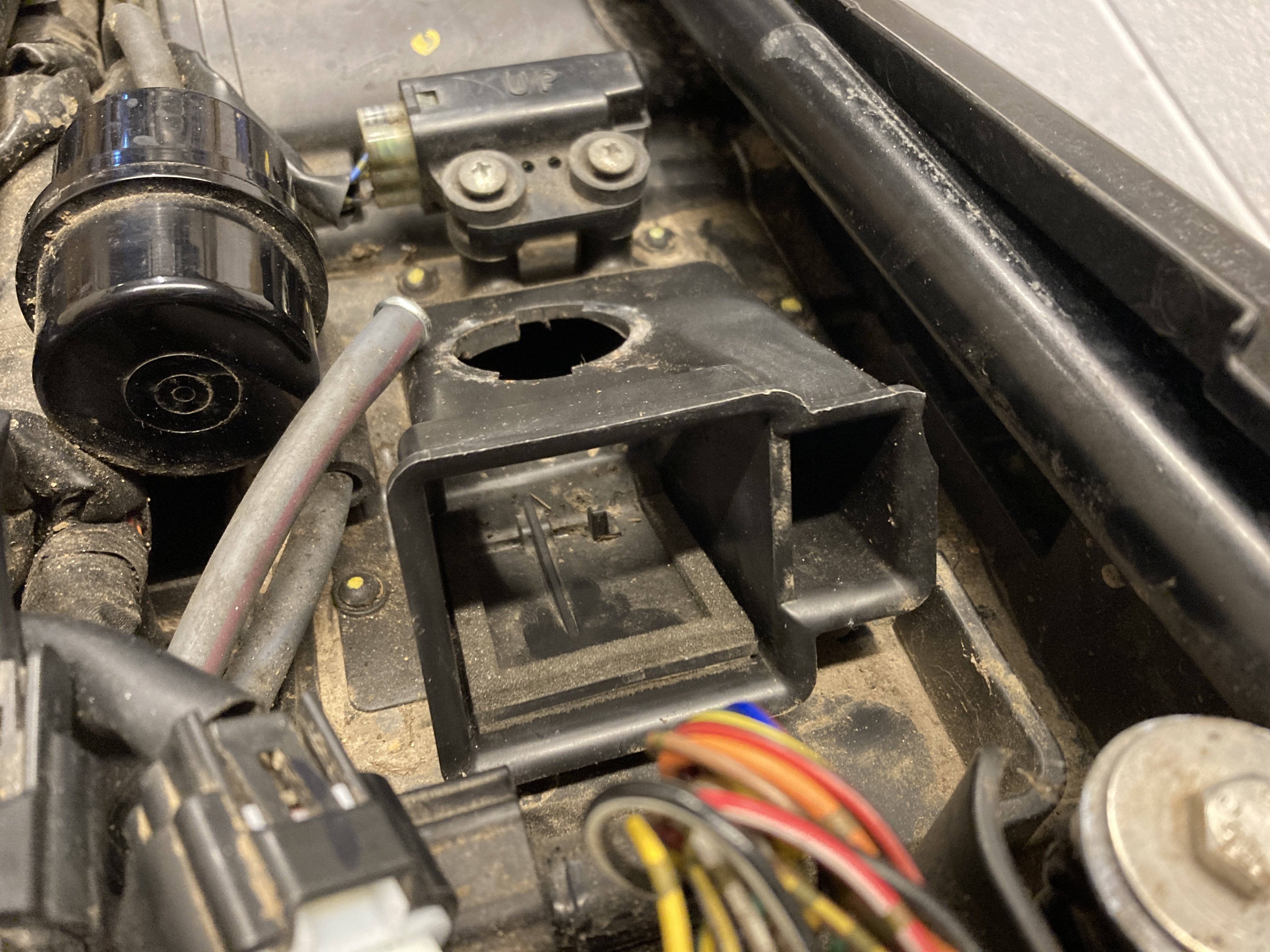

This morning I did the airbox 'flapper' mod.  So the airbox has a flap inside it which is vacuum controlled by a unit sat on top of the box , the unit has a hook on the end which pulls the flap up to let more air in when needed.
Here I have taken it out and blanked off the hose with a screw...............
Then I put some double-sided tape under the flap and secured it so it is fully open all the time.................
and that's it , job done.  The bike should breathe better now with the new silencer and servo motor removed.  The next job will be the removal of the AIS (air induction system).

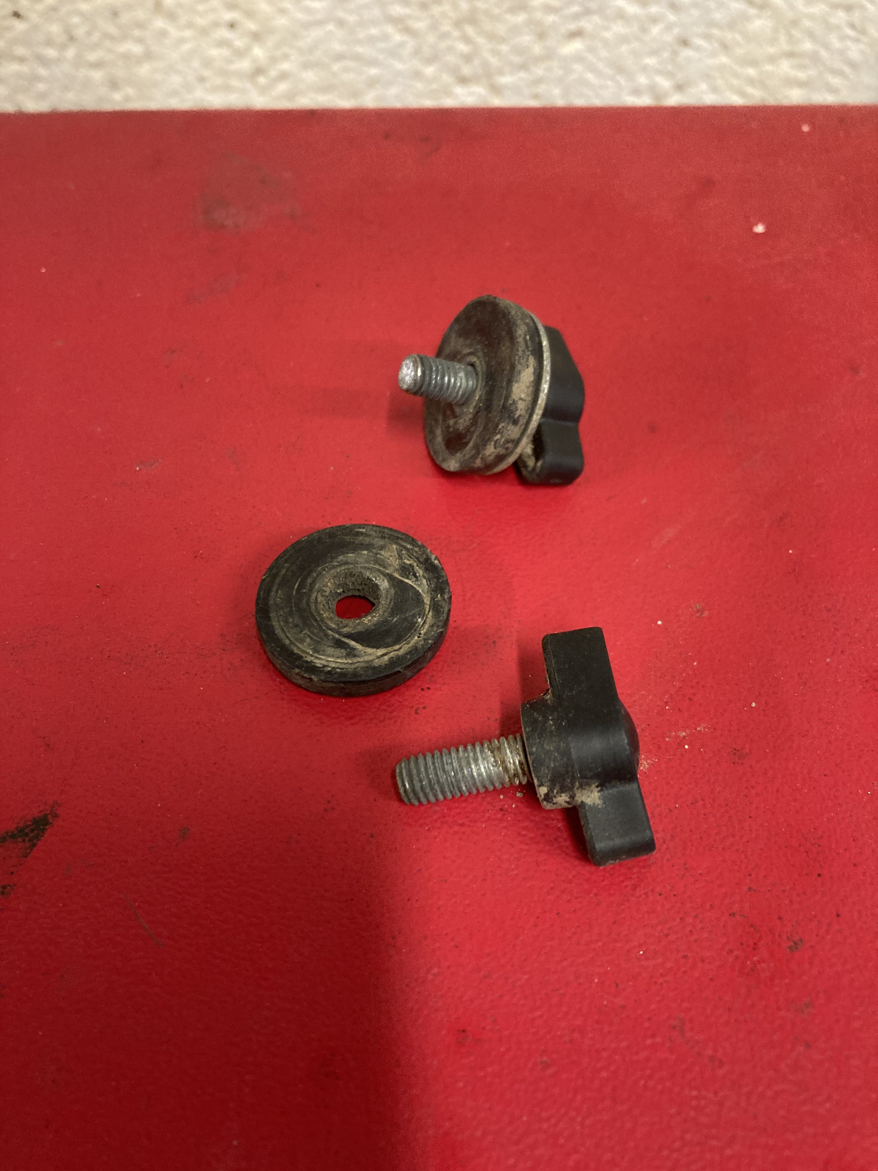

Just a little tip here, if you have a bike where the seat is secured by bolts underneath the mudguard get yourself some of these neat wingnuts.  It makes the job of removing the seat so much easier .
Will that affect cold weather starting?
41 minutes ago, XTreme said:
Much noisier?
No, the last thing I want is a loud bike.  The silencer has a bit more of a bark than standard but it's not excessive like FMF pipes are.
It'll be interesting to see , that was in the back of my mind but it's easy to reverse the procedure .
Same mod used for the TDM900s, made no difference starting but did help some with the low rev stutter.
As for noise I can't remember and now I have the top of the box removed on mine and loving the induction noise.
