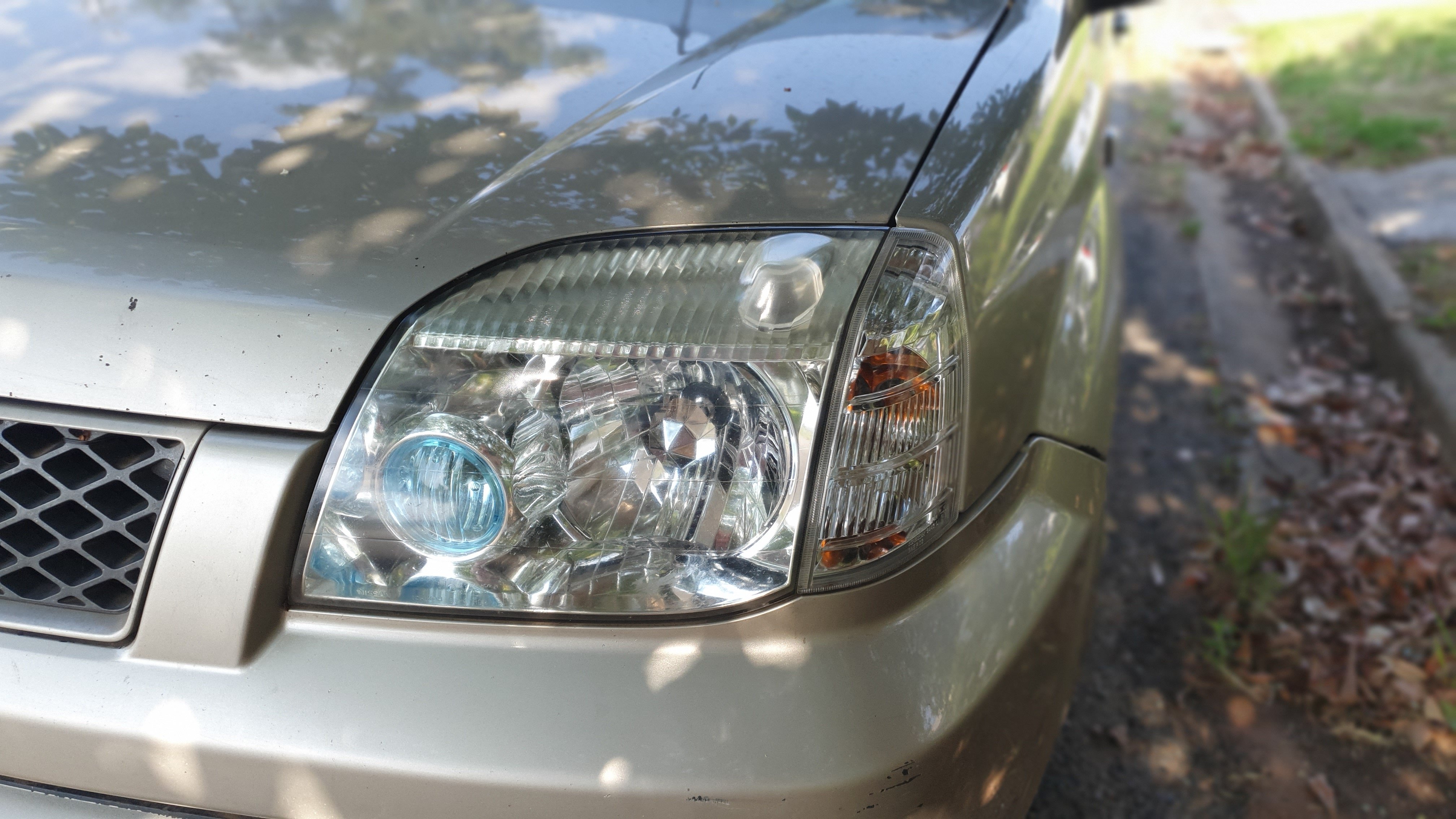

Hows this for a result ?
different sides ,show us a before and after of same headlight.

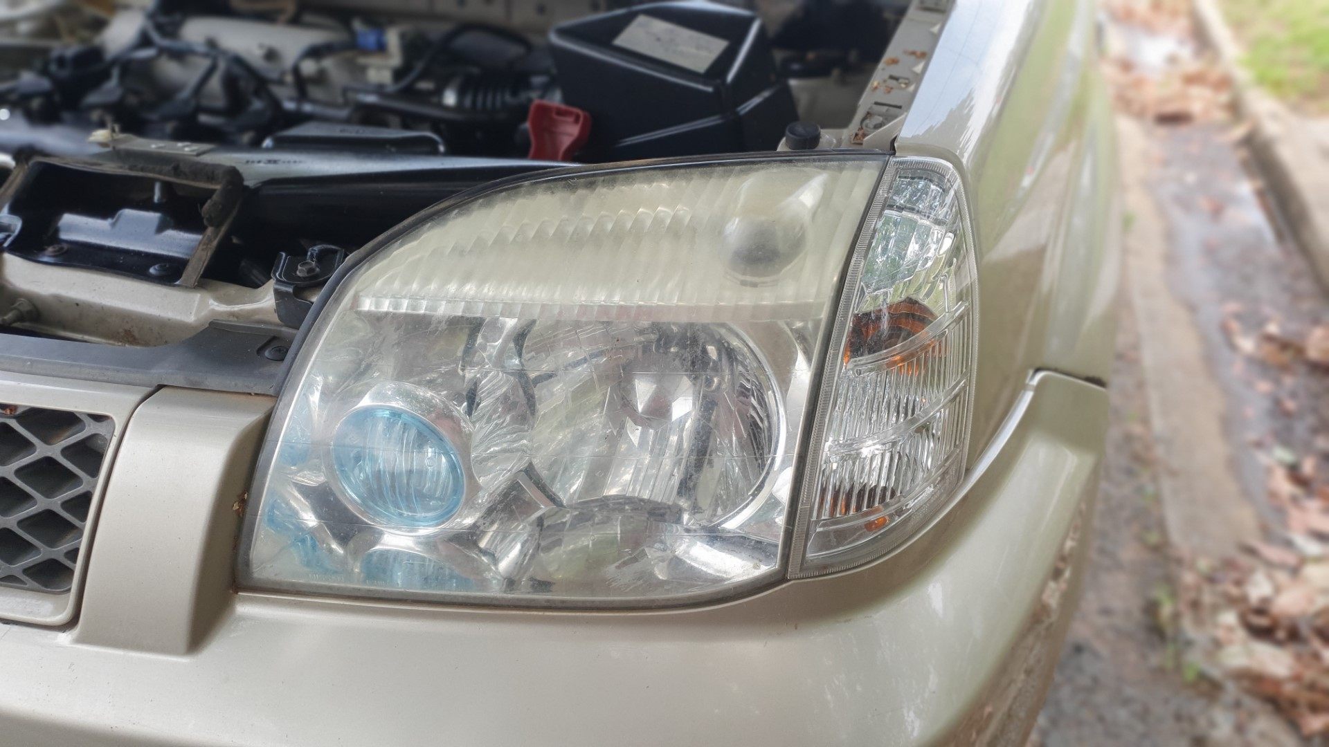

I can get the yellow off no problem but my headlights have deeper crazing from 20 years of use so I am sanding them, done it before, I start with 800, then 1500 then 3000 then an abrasive polish and finally a clear polish and lacquer to protect them.

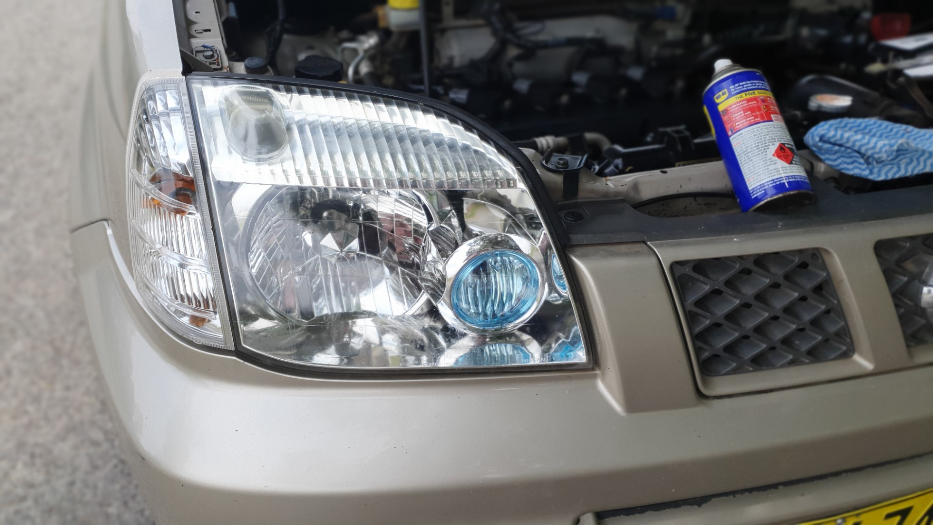

They were unsurprisingly identical but just for you here's a pic of the untreated one after treatment, what on Earth do you think that I did ?
14 hours ago, XTreme said:
Just WD40? I've heard that toothpaste is actually pretty good on them as well.
Cos that's something I've got to do on mine!
I imagine that you have a can of WD, a cloth and about 20 seconds of free time so just do it, it works.
