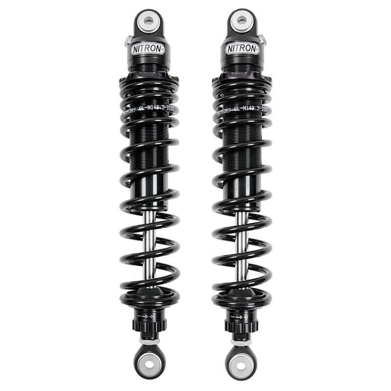

Buckster Posted April 18, 2024 Author Share Posted April 18, 2024 So there are basically two types of shocks available readily, emulsion where the oil and gas mix, or gas shock where the oil and gas are separate. With emulsion shocks they may have nitrogen mixed with the oil or they may be air assist as my standard shocks are, with air assist the preload is altered by adding air which also alters the compression and rebound. This drastically reduces shock travel as well and generally this type of shock will have a smaller piston. Emulsion shocks with pre charged nitrogen are better but still have limitations, the general rule is that you can alter the rebound damping but the compression is fixed, spring preload is kept separate which is better. Then you have single bodied shocks where the nitrogen and oil are kept separate, with this type you generally alter the rebound and compression damping together. The only way to separate everything is with piggy back shocks or other layouts that use a completely separate gas chamber. The other thing to consider is piston diameter, a larger piston diameter will generally mean a shorter piston chamber which allows a longer shock travel, it sounds counter intuitive but it is because it occupies less space inside the spring. 4 Link to comment Share on other sites More sharing options...

Buckster Posted April 18, 2024 Author Share Posted April 18, 2024 So continuing, remote reservoir or piggyback shocks are overkill in most road bikes, they give the widest range of adjustment but need to be adjusted more often. The sweet spot is a single body gas shock, a good emulsion shock is generally better than stock but still has limitations. As far as piston diameter is concerned for a 12 to 13 inch shock the sweet spot for shock travel and good damping is 35 to 36mm. This will allow just under 4 inches of travel. 3 Link to comment Share on other sites More sharing options...

Buckster Posted April 18, 2024 Author Share Posted April 18, 2024 At this point I had narrowed things down to a few preferred shocks, 2win are very good on price but the specs are hard to get, Ohlins are well reviewed but at a price, YSS do what is probably the best emulsion type shock and then the wild card is the Nitron twin shock R1. I decided against the YSS as I do not want another emulsion set up. I had pretty much settled on the 2win but two factors put me off, I found it only has a 26mm piston and the resellers are twats, I never trust anyone that needs to slag off their competitors. I spoke to Brook suspension a few times, I was getting very interested in the expensive but highly rated Ohlins, they were very helpful and very honest, they even suggested having another look at the YSS which are £400 less than the Ohlins. Then I brought up the subject of Nitron, we had a long discussion on the difference between Nitron and Ohlins. The Nitrons use machined components throughout as opposed to a mix between machined and cast. It seemed that Nitron are about the best made shocks currently available and they offered the adjustability I wanted, I could also specify a 12.5 inch shock so I was very interested. After doing some additional research to verify what I had been told I have ordered Nitron shocks. 7 Link to comment Share on other sites More sharing options...

boboneleg Posted April 18, 2024 Share Posted April 18, 2024 I bought a Nitron for my previous DR650, they are very well made 1 Link to comment Share on other sites More sharing options...
Buckster Posted April 18, 2024 Author Share Posted April 18, 2024 19 minutes ago, boboneleg said: I bought a Nitron for my previous DR650, they are very well made They better be, I spent £800 on these bad boys. 3 Link to comment Share on other sites More sharing options...
