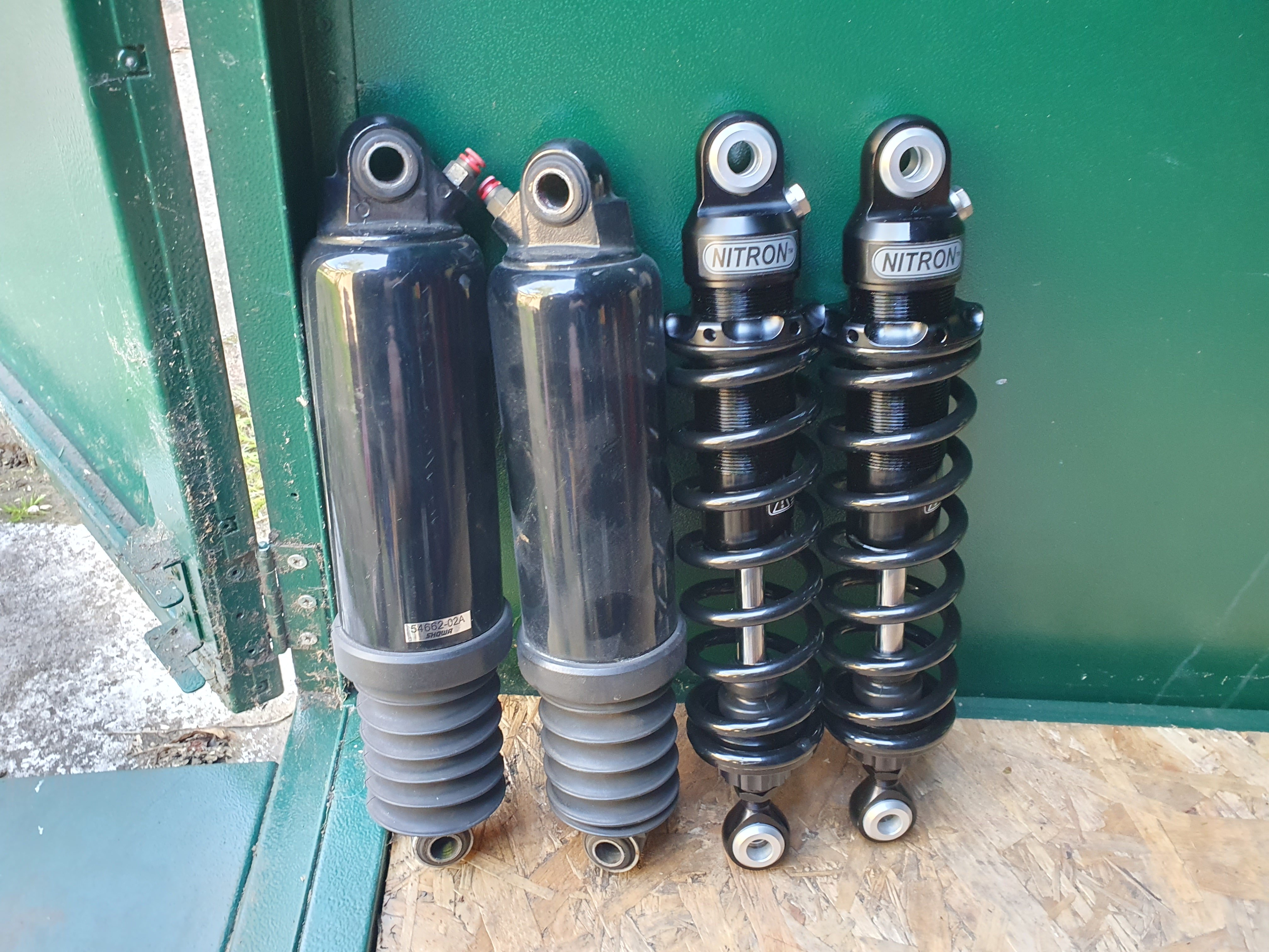

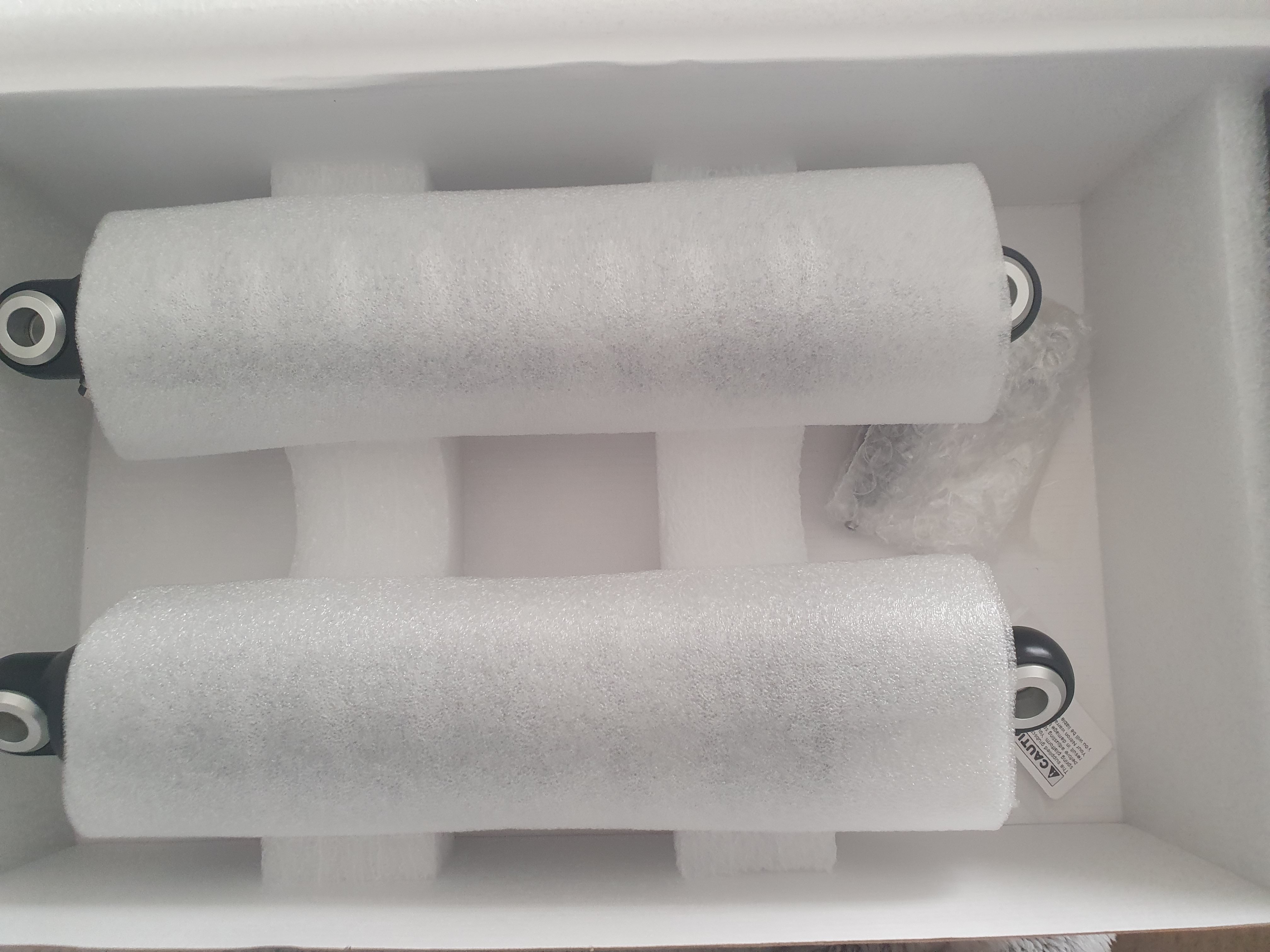

Buckster Posted May 13, 2024 Author Share Posted May 13, 2024 5 Link to comment Share on other sites More sharing options...
Pedro Posted May 13, 2024 Share Posted May 13, 2024 Nitron is nice stuff! I have never met a person that switched for them (in track cars) that had anything bad to say about quality. They were my first choice for the GS, I feel like I should have tried harder to get them. 2 Link to comment Share on other sites More sharing options...

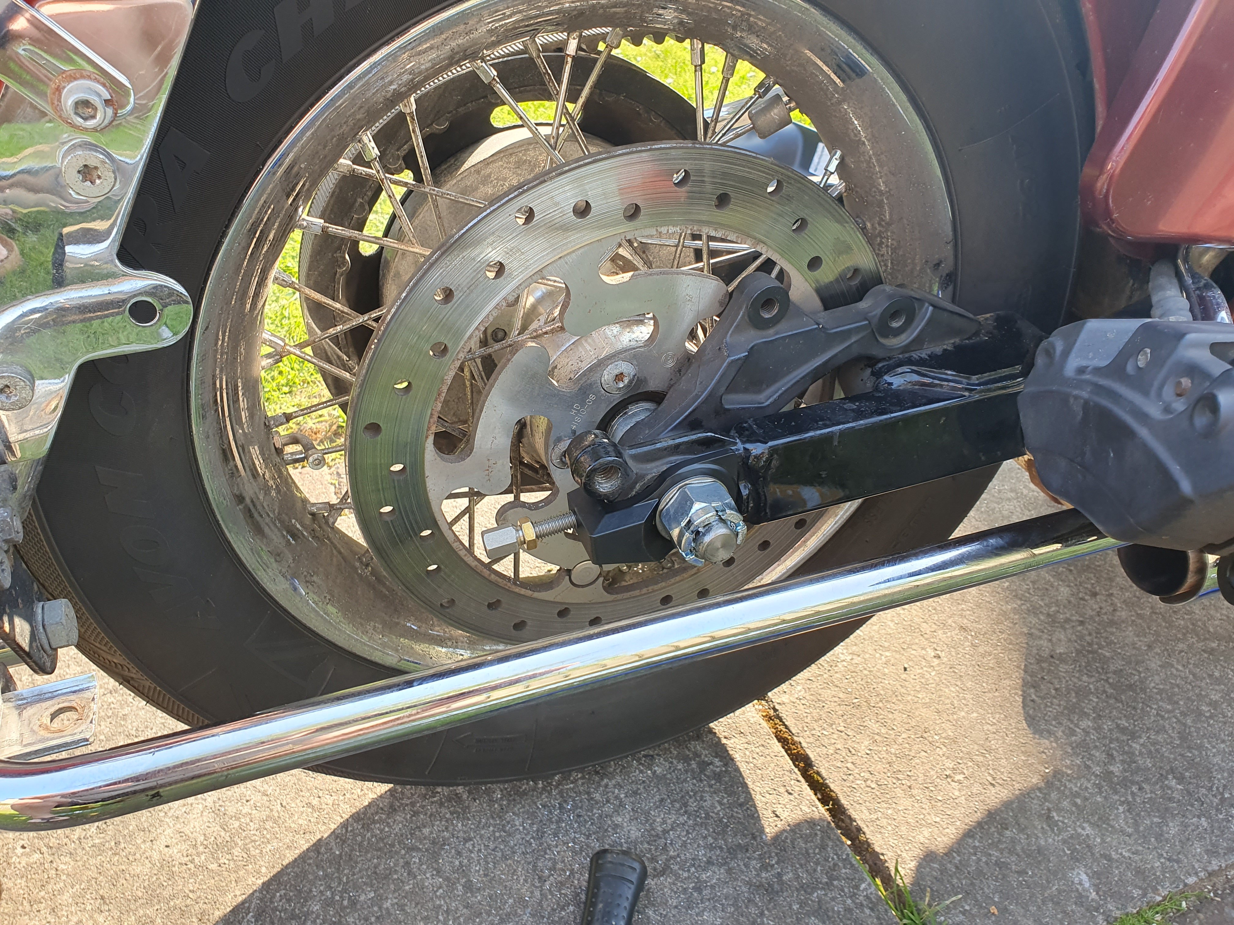

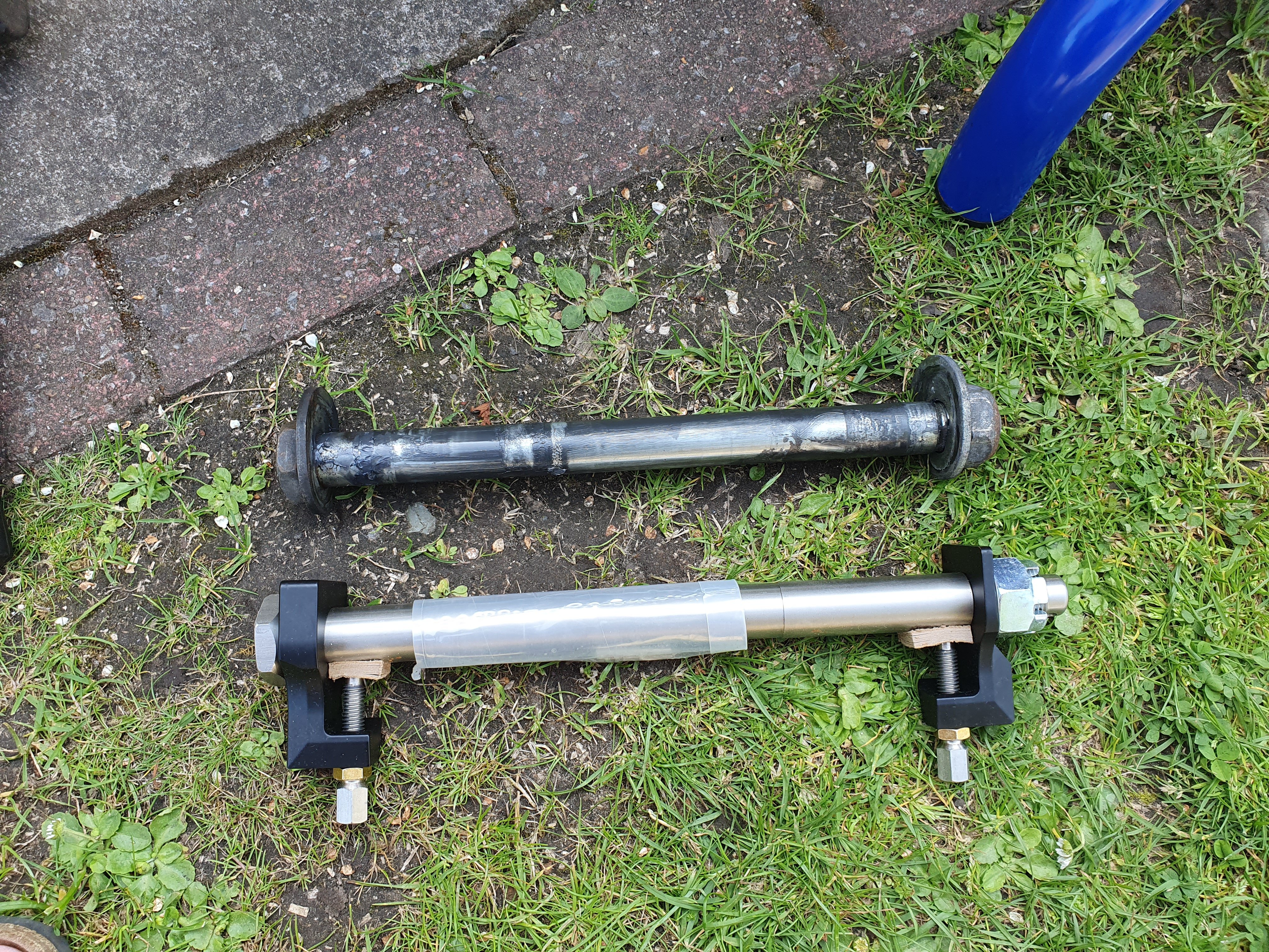

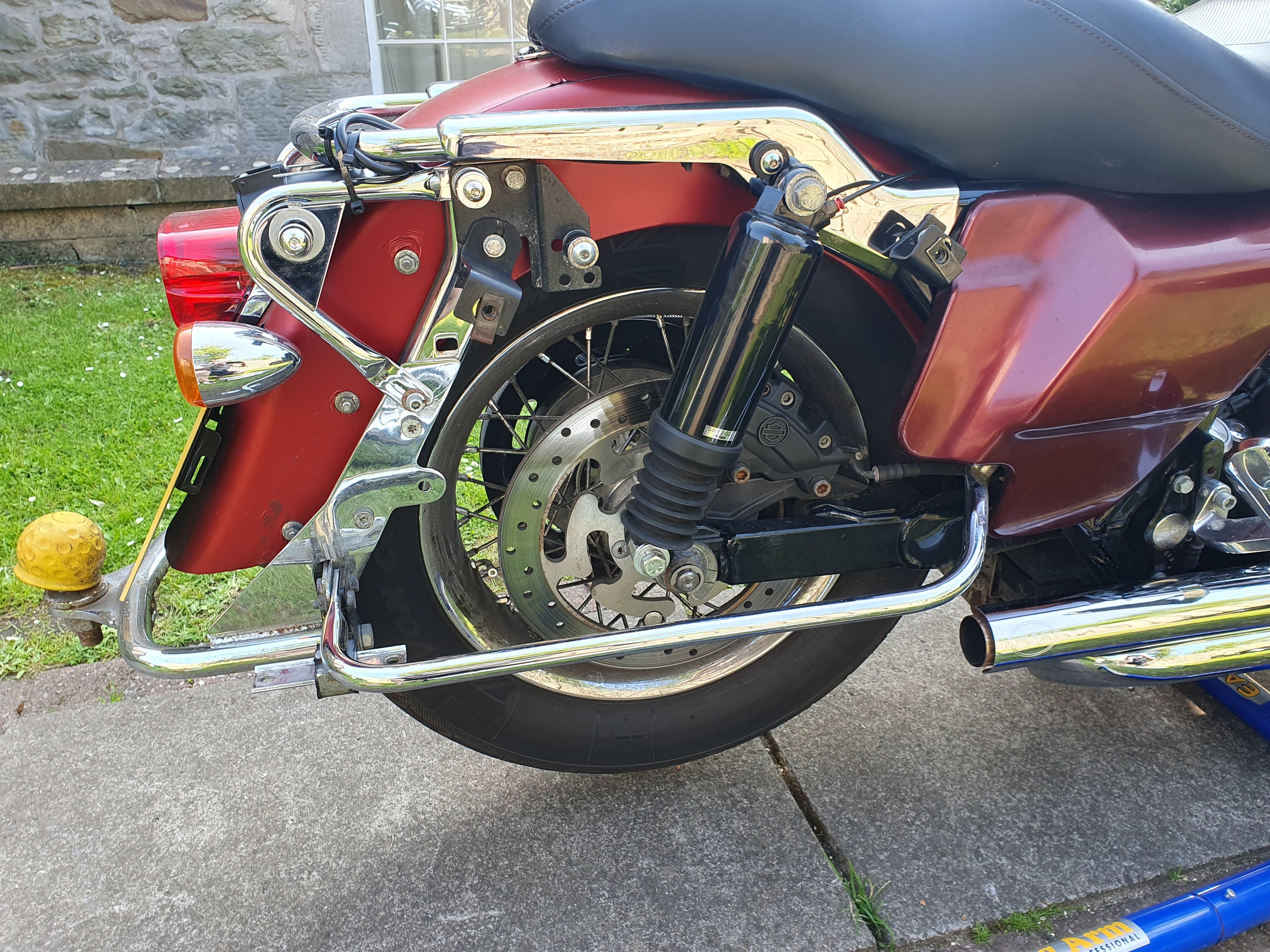

Buckster Posted May 17, 2024 Author Share Posted May 17, 2024 Beautiful evening so thought I would sit outside and do the bike. Strip down complete. This is the old and new axles. 5 Link to comment Share on other sites More sharing options...

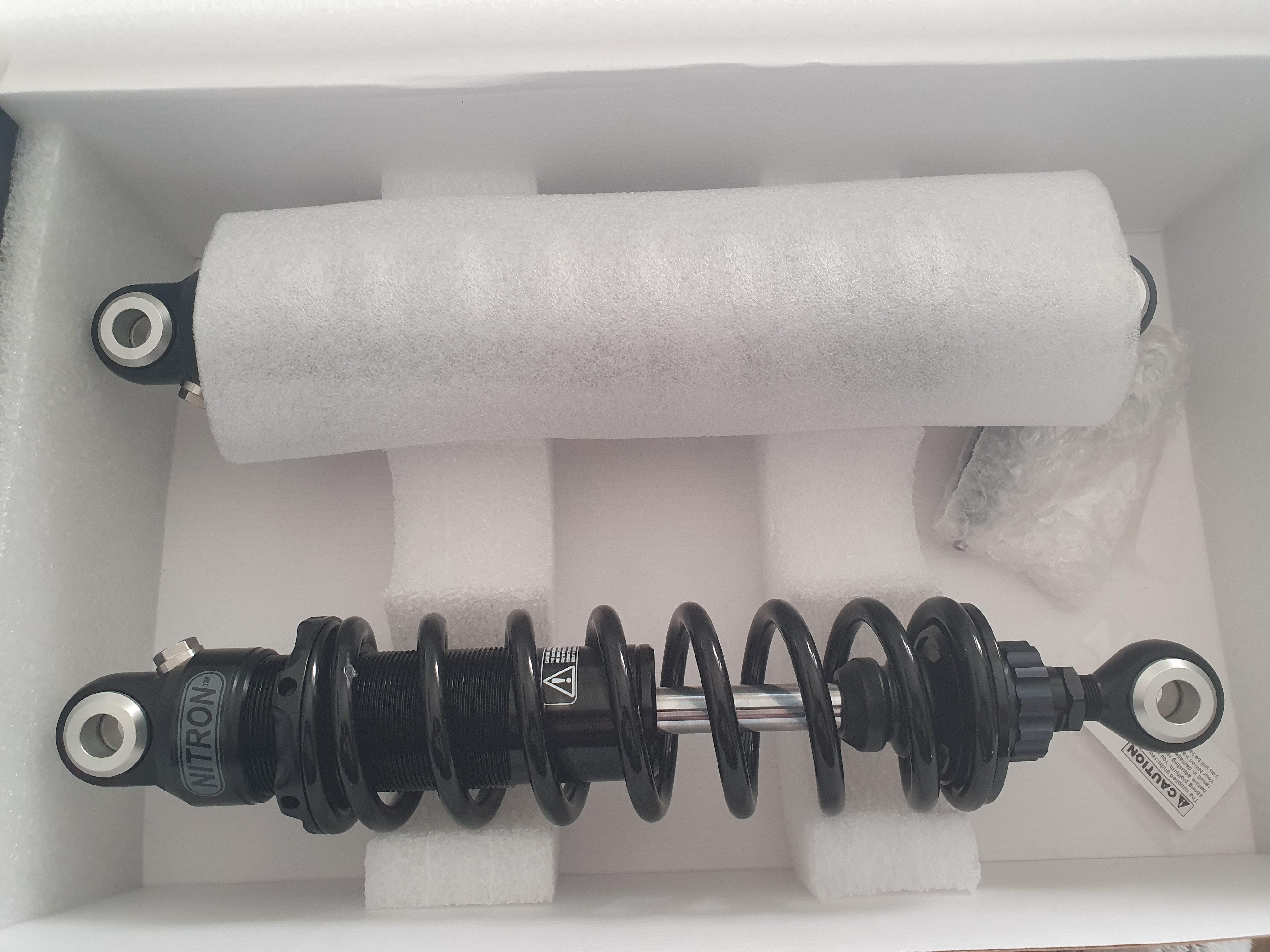

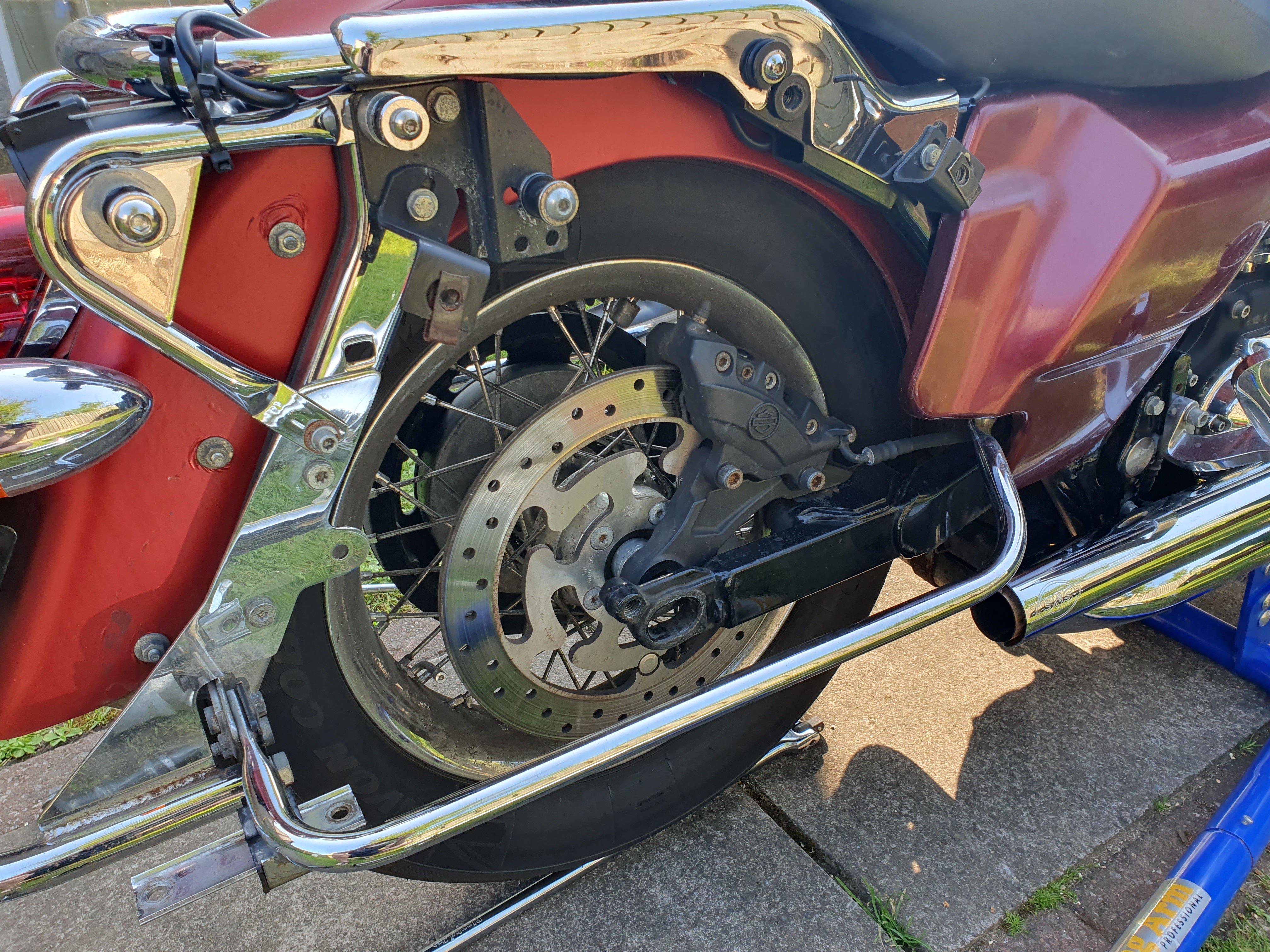

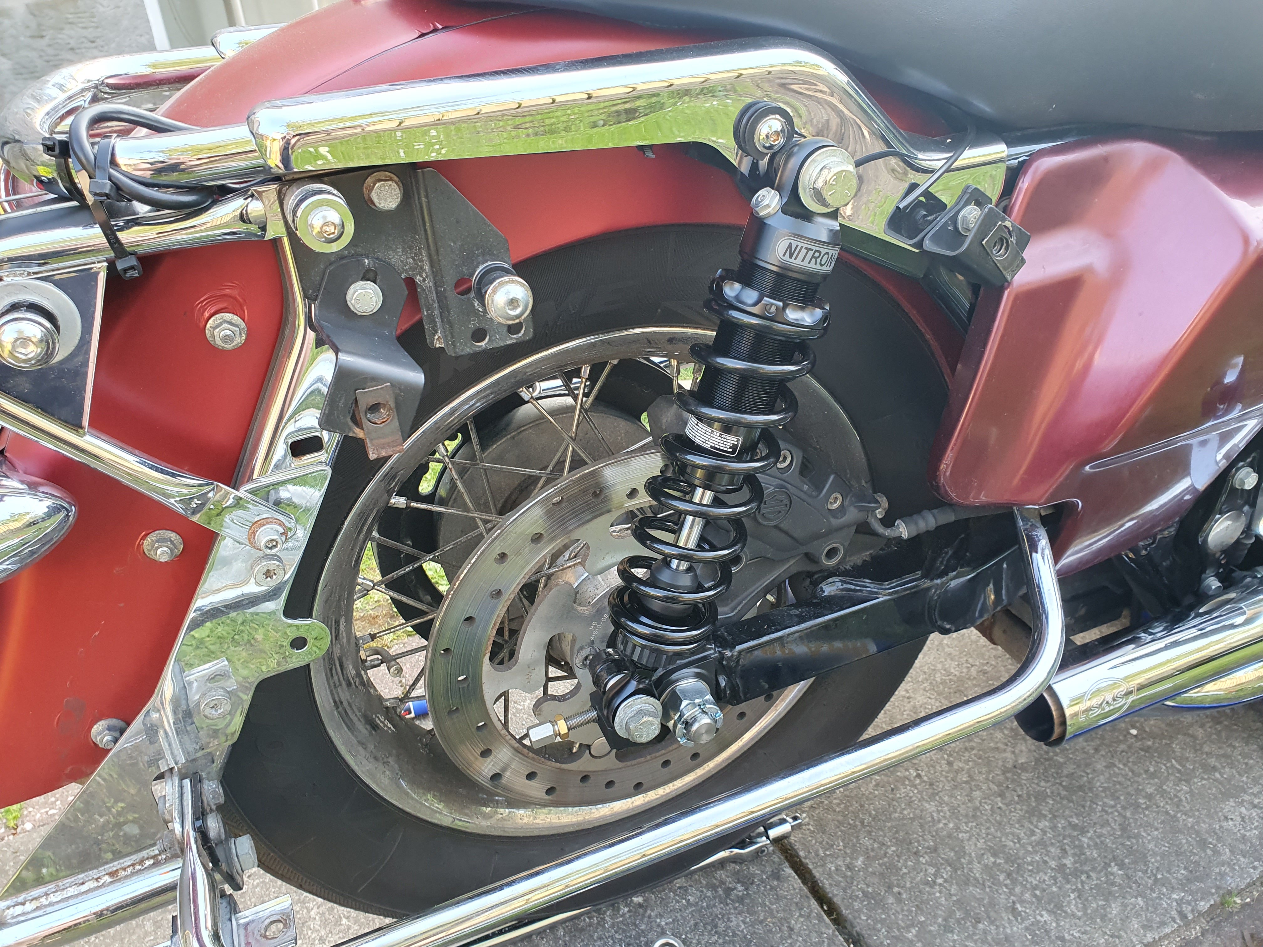

Buckster Posted May 17, 2024 Author Share Posted May 17, 2024 New axle fitted. New shocks, half inch longer than the originals. Fitted. Just have to tension the belt with the new much better axle adjusters that will no longer concern me unlike the kak half moon set up on the original and everything can go back together. 5 Link to comment Share on other sites More sharing options...
Sir Fallsalot Posted May 17, 2024 Share Posted May 17, 2024 11 minutes ago, Buckster said: New axle fitted. New shocks, half inch longer than the originals. Fitted. Just have to tension the belt with the new much better axle adjusters that will no longer concern me unlike the kak half moon set up on the original and everything can go back together. Did the shocks come all set up for you or do have a bit of tuning to do Link to comment Share on other sites More sharing options...
Pedro Posted May 17, 2024 Share Posted May 17, 2024 12 minutes ago, Buckster said: New axle fitted. New shocks, half inch longer than the originals. Fitted. Just have to tension the belt with the new much better axle adjusters that will no longer concern me unlike the kak half moon set up on the original and everything can go back together. Did you resist taking it for a spin? Link to comment Share on other sites More sharing options...
Buckster Posted May 17, 2024 Author Share Posted May 17, 2024 6 minutes ago, Pedro said: Did you resist taking it for a spin? Still putting it back together. Link to comment Share on other sites More sharing options...
Buckster Posted May 17, 2024 Author Share Posted May 17, 2024 Looks like I will have to finish it tomorrow, I need a 1 5/16 socket or 33mm to torque up the axle. The original is 36mm but the people who make the after market have obviously changed it, pretty sure I don’t have one, have just about everything else. 1 Link to comment Share on other sites More sharing options...
Buckster Posted May 17, 2024 Author Share Posted May 17, 2024 1 hour ago, Sir Fallsalot said: Did the shocks come all set up for you or do have a bit of tuning to do They have set them but I can fiddle with them, they have the spring rate and valving for my weight less a bit I guess as there is a little bit of preload on, I will try them as is and fiddle with them later if need be. Come with a nice little tool for setting preload. 3 Link to comment Share on other sites More sharing options...
Pedro Posted May 17, 2024 Share Posted May 17, 2024 2 hours ago, Buckster said: half inch longer than the originals It’s like I can see the future! All good choices in this thread! Looking forward to hear about the result in handling. Link to comment Share on other sites More sharing options...

Buckster Posted May 19, 2024 Author Share Posted May 19, 2024 Well I took a run out to test the shocks on some roads that upset the bike usually, at first I thought the bike was a bit fidgety until I realised how fast I was going, I was cornering 10 to 20mph faster than I normally do along that route, the bike turns in easier and responds to body English easier. It is easier to change line mid corner as well and it tracks road imperfections less. In town it does not jar over potholes anymore. The only bad part is it has shown up the limits of the front end, I definitely need to soften the front a touch but even then I suspect I would benefit from more complex fork damping so am already thinking of Nitron fork cartridges. I will play with the damping on the shocks a little, I think it may benefit from a slight increase. Braking is also better and it seems more planted under acceleration when passing traffic. Going across Gullane golf course there are some uneven off camber corners that I normally take at 40mph, I glanced at the clock through there and I was doing 55 to 60mph. So first impressions are night and day. 5 Link to comment Share on other sites More sharing options...
Pedro Posted May 19, 2024 Share Posted May 19, 2024 53 minutes ago, Buckster said: Well I took a run out to test the shocks on some roads that upset the bike usually, at first I thought the bike was a bit fidgety until I realised how fast I was going, I was cornering 10 to 20mph faster than I normally do along that route, the bike turns in easier and responds to body English easier. It is easier to change line mid corner as well and it tracks road imperfections less. In town it does not jar over potholes anymore. The only bad part is it has shown up the limits of the front end, I definitely need to soften the front a touch but even then I suspect I would benefit from more complex fork damping so am already thinking of Nitron fork cartridges. I will play with the damping on the shocks a little, I think it may benefit from a slight increase. Braking is also better and it seems more planted under acceleration when passing traffic. Going across Gullane golf course there are some uneven off camber corners that I normally take at 40mph, I glanced at the clock through there and I was doing 55 to 60mph. So first impressions are night and day. How much of that better balance do you think might come from just having it a little higher in the back than before? 1 Link to comment Share on other sites More sharing options...
