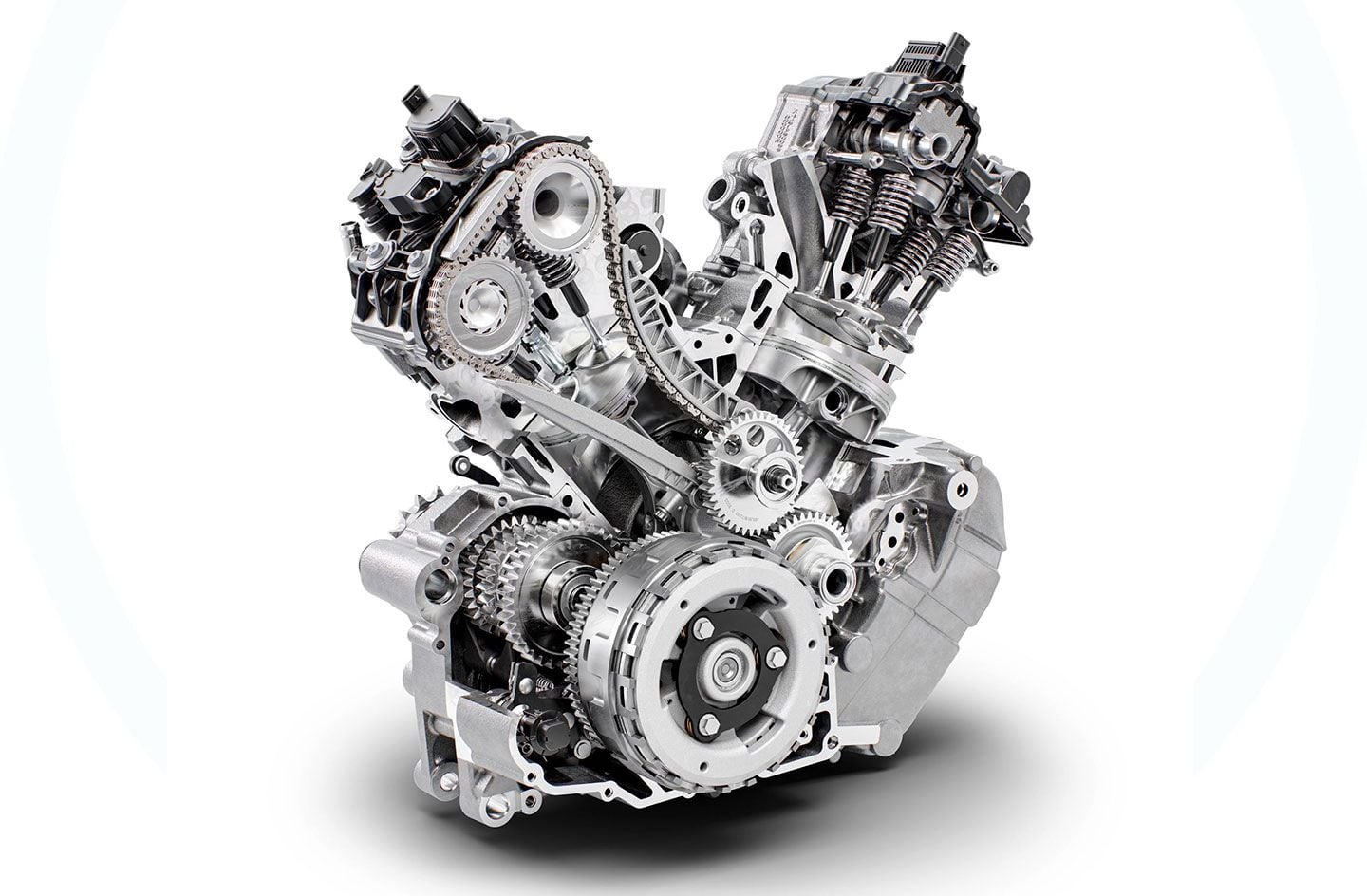

The 1390′s shift in personality starts with the 1,350cc V-twin, which has a 2mm larger bore than the 1290′s mill (108mm versus 110mm) for an added 49cc. KTM claims 190 hp at 10,000 rpm and 107 lb.-ft. of torque at 8,000 rpm—a healthy bump over the 1290′s claimed 177 hp and 103 lb.-ft. of torque.
The 1,350cc V-twin might not match up with the 1390 name, but it does make more power than the 1,301cc LC8 used in the 1290. KTM claims 13 more horsepower and an additional 4 lb.-ft. of torque.
The 1,350cc V-twin might not match up with the 1390 name, but it does make more power than the 1,301cc LC8 used in the 1290. KTM claims 13 more horsepower and an additional 4 lb.-ft. of torque. (KTM/)

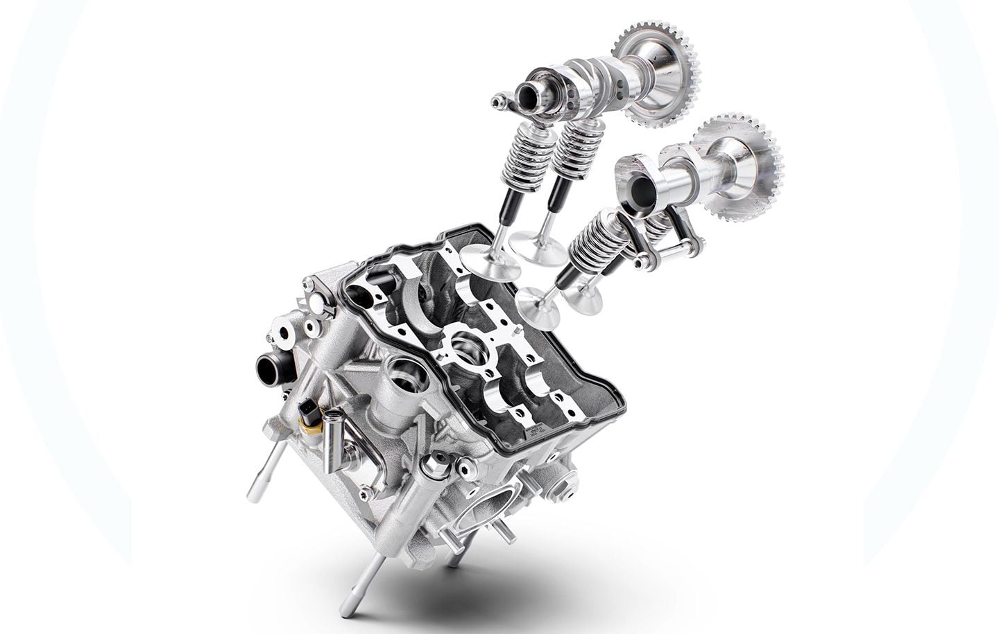

KTM’s camshaft technology works on the intake side. The electronically actuated system switches from a mild cam lobe to a more aggressive lobe just below 6,000 rpm.
KTM’s camshaft technology works on the intake side. The electronically actuated system switches from a mild cam lobe to a more aggressive lobe just below 6,000 rpm. (KTM/)
There’s more to the story though, as the 1390 is equipped with an electronically actuated cam-shift technology that adjusts intake valve timing (duration and lift) between 5,750 and 6,000 rpm. A similar solution to what BMW uses across various engine platforms, the system consists of an electronic actuator atop each cylinder, pins, and a sliding sleeve on the intake cam. Dropping the pin engages a switching gate on the sliding piece, engaging different cam profiles.
KTM’s variable valve timing technology enables the engine to have good low-rpm torque and throttle response without sacrificing top-end performance. It also allows KTM to meet strict Euro 5+ emissions standards without losing the thing that has always made the Duke, a Duke—personality.
Power is further manipulated through shorter, but larger-diameter throttle bodies (60mm versus 56mm on the 1290 Super Duke R) and repositioned injectors. The airbox is shorter to accommodate the 1390′s larger tank, but has more volume. A redesigned ram-air system allows for more direct airflow too.

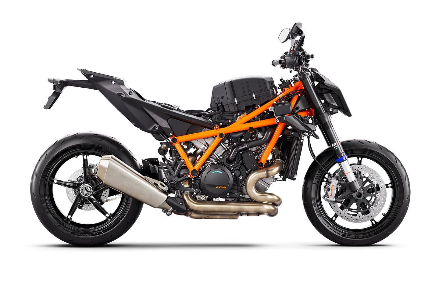

The 1390’s larger-volume air box is wider and longer, but shorter to accommodate the 1390’s larger fuel tank.
The 1390’s larger-volume air box is wider and longer, but shorter to accommodate the 1390’s larger fuel tank. (KTM/)
The chassis is the same as it was in 2023, with small revisions made to accommodate the reshaped airbox. When asked the reason for not making any changes, McWilliams said that KTM made necessary chassis changes during the previous Super Duke update.

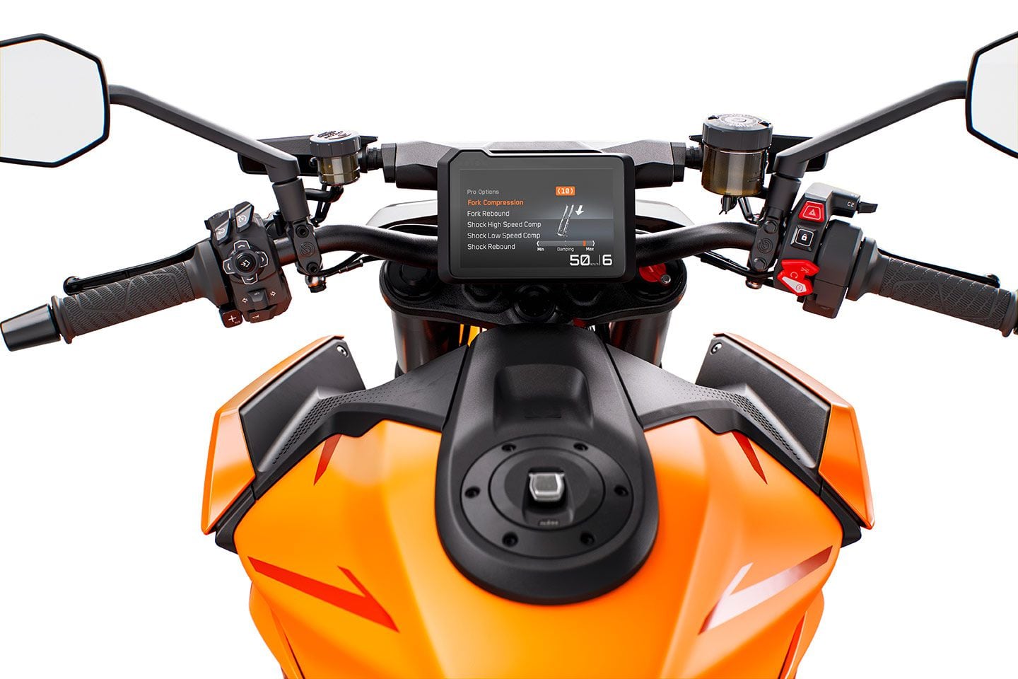

The 5-inch TFT display is crystal clear, easy to navigate, and has illustrations to better understand the difference in options. Notice the expansive options within the new WP Apex electronic suspension, as well as the older switch cube on the left side of the handlebar, which is used to scroll through those options.
The 5-inch TFT display is crystal clear, easy to navigate, and has illustrations to better understand the difference in options. Notice the expansive options within the new WP Apex electronic suspension, as well as the older switch cube on the left side of the handlebar, which is used to scroll through those options. (KTM/)

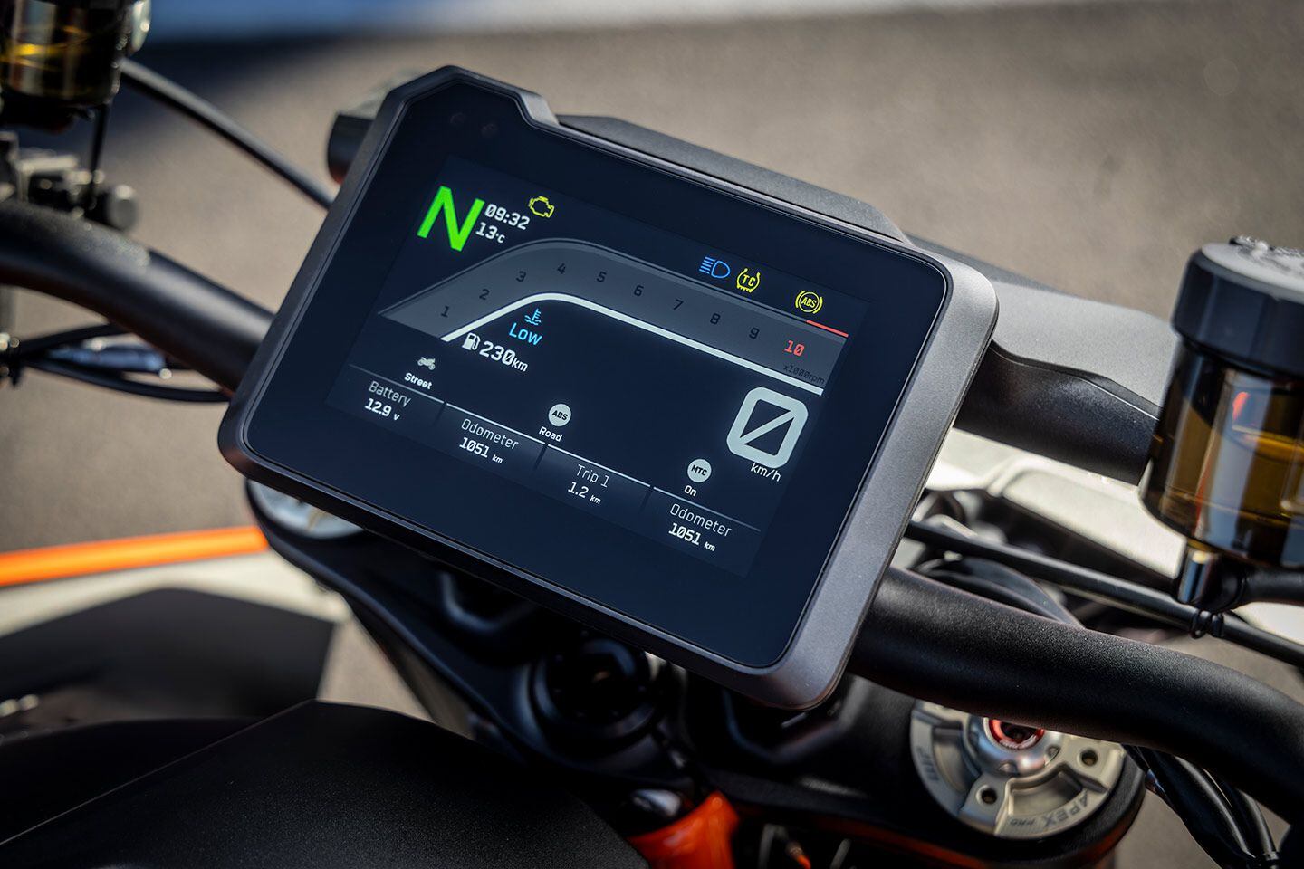

Closer look at the Super Duke’s display.
Closer look at the Super Duke’s display. (KTM/)

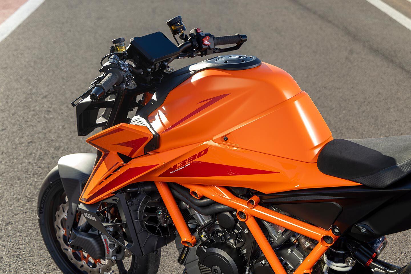

The 2024 Super Duke has a 0.4-gallon-larger fuel tank and a few new styling touches, like winglets (just below the tank spoiler). Yes, this is a bike made for wheelies, but with winglets that are intended to keep the front down. You could say the same thing about traction control too.
The 2024 Super Duke has a 0.4-gallon-larger fuel tank and a few new styling touches, like winglets (just below the tank spoiler). Yes, this is a bike made for wheelies, but with winglets that are intended to keep the front down. You could say the same thing about traction control too. (KTM/)
Electronic settings (and other important information) are relayed via a 5-inch TFT display with crisp, clear image and user-friendly layout. Unfortunately, the switch gear found on KTM’s new 990 Duke hasn’t been carried over—a shame considering how well we liked the button layout on the new 990.

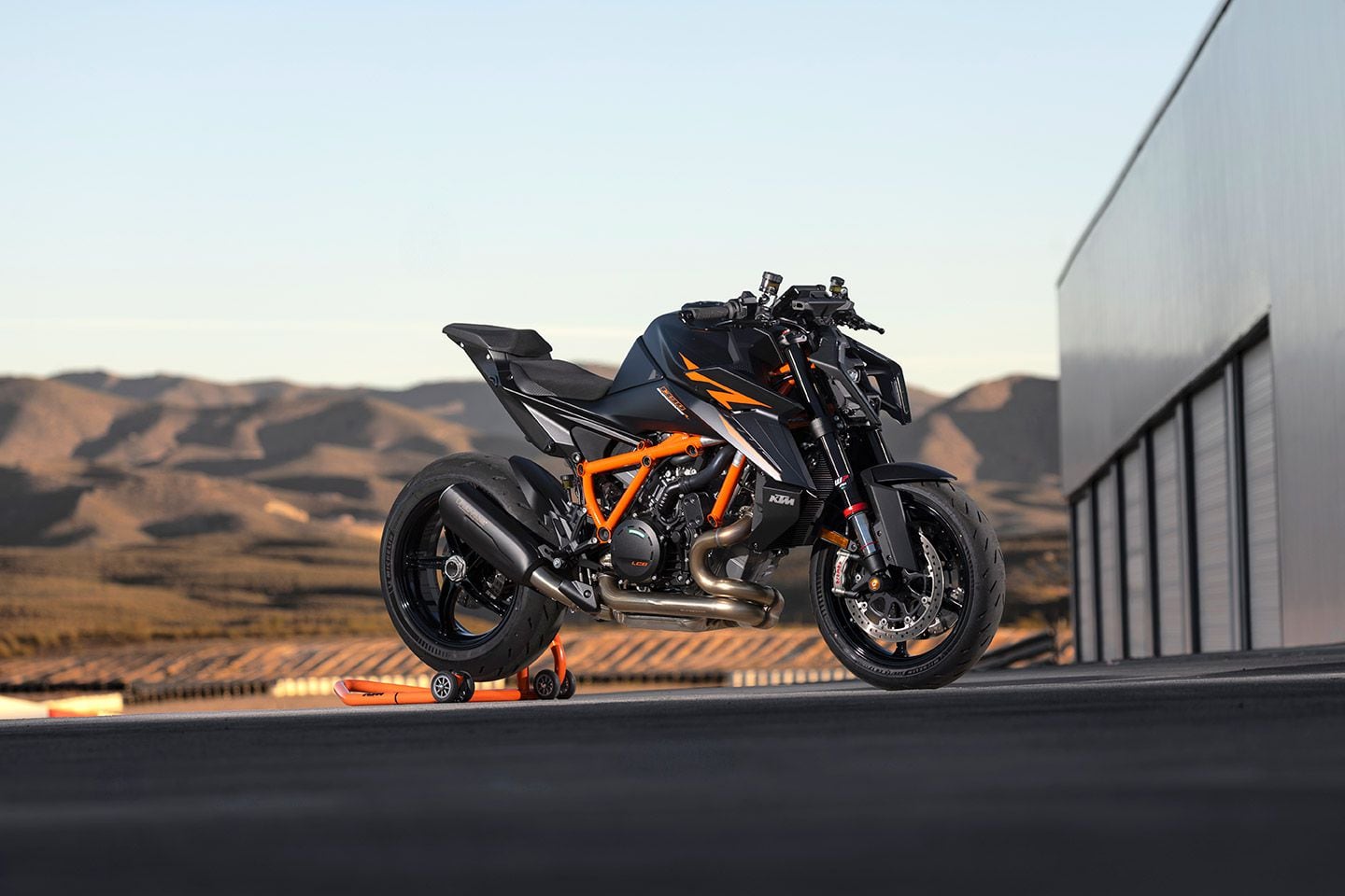

Despite all the talk of this being a streetbike, it has to be said that the Super Duke R still looks decidedly racy sitting with its mirrors off, prepped for track duty. There might be a few less fairings, and ergos that are more street-focused, but don’t write this bike off as a commuter.
KTM doesn’t have a full-fairing sportbike in its lineup, making the 1390 Super Duke R the go-to option if you want to experience that big LC8 twin at the track. Lots of testing, with legendary rider Jeremy McWilliams, has led to a bike that doesn’t feel out of place banked into a corner.
KTM doesn’t have a full-fairing sportbike in its lineup, making the 1390 Super Duke R the go-to option if you want to experience that big LC8 twin at the track. Lots of testing, with legendary rider Jeremy McWilliams, has led to a bike that doesn’t feel out of place banked into a corner. (KTM/)

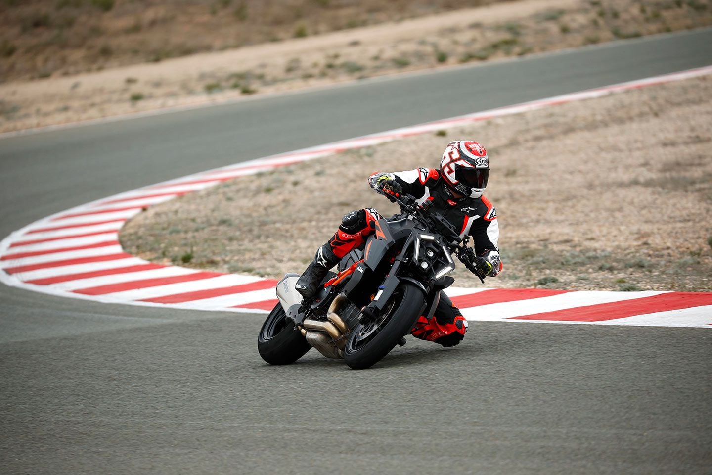

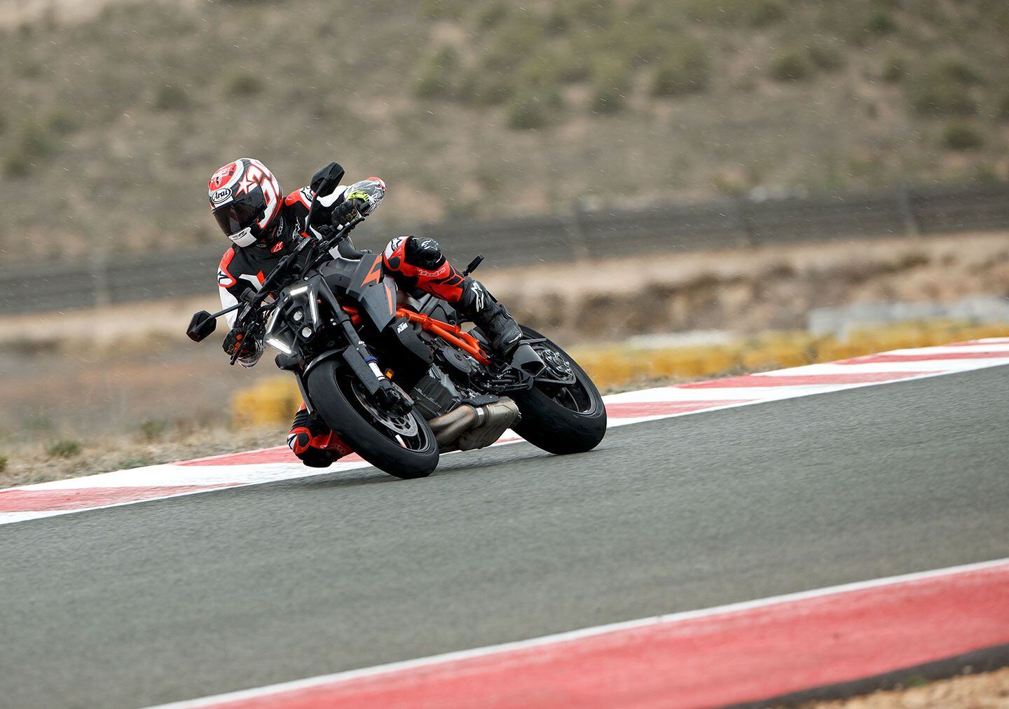

The Super Duke steers quite quickly when ridden at a track pace, making it easy to flick into a corner or even change your line, midcorner.
The Super Duke steers quite quickly when ridden at a track pace, making it easy to flick into a corner or even change your line, midcorner. (KTM/)

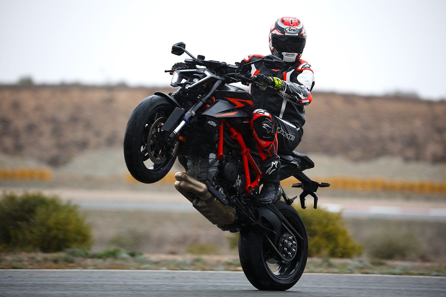

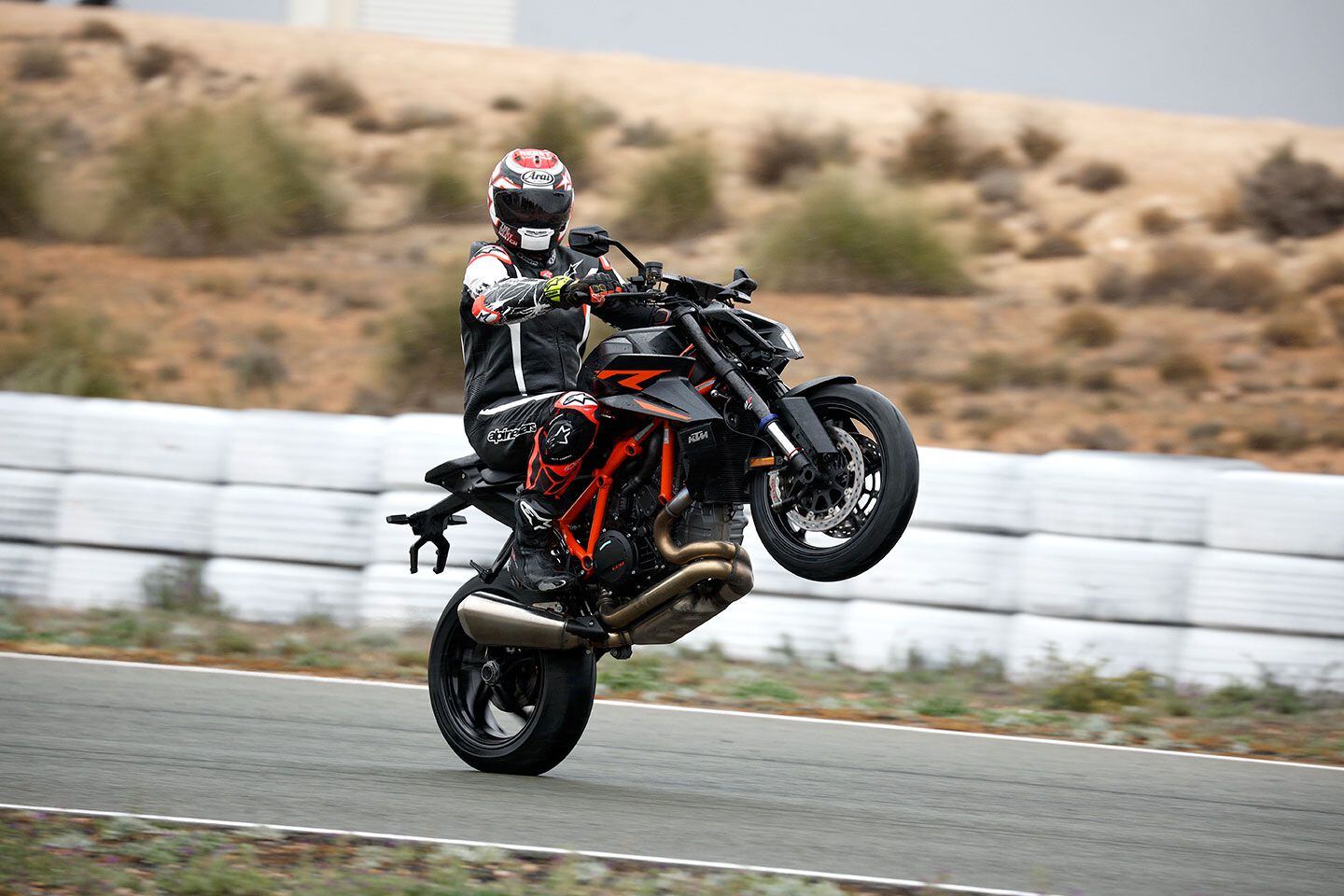

This is what the 1390 Super Duke R Evo is all about—wheelies! Not used here is a new anti-wheelie system that can be adjusted when the optional electronics package is added. Given the performance of the bike and how it’ll be used a majority of the time, we wish that package came standard. It’s hard to picture riding the Duke without being able to fine-tune settings.
This is what the 1390 Super Duke R Evo is all about—wheelies! Not used here is a new anti-wheelie system that can be adjusted when the optional electronics package is added. Given the performance of the bike and how it’ll be used a majority of the time, we wish that package came standard. It’s hard to picture riding the Duke without being able to fine-tune settings. (KTM/)

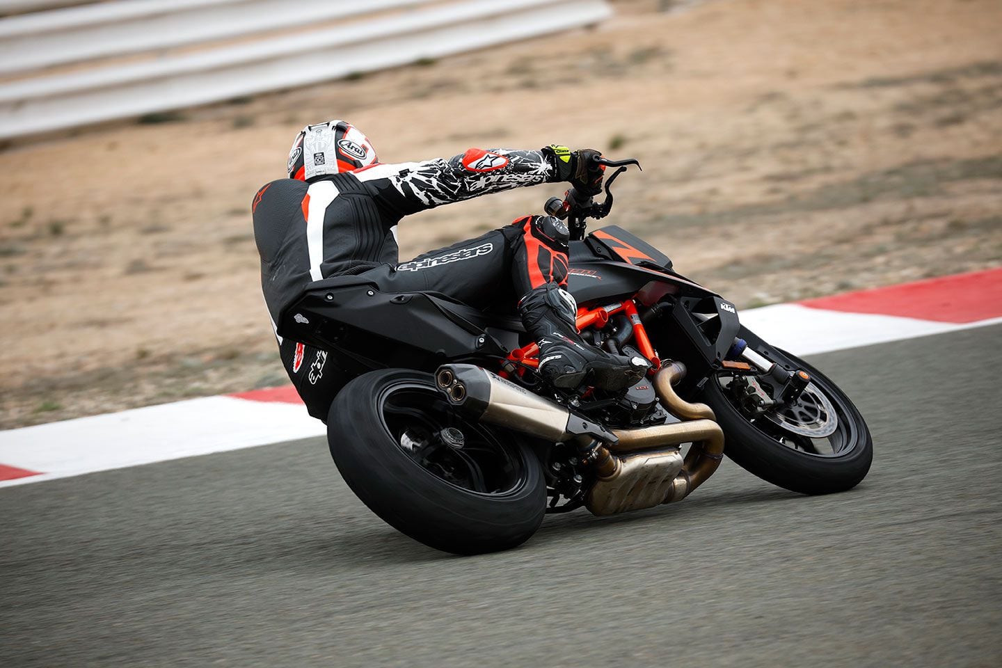

Despite the addition of variable valve timing, the Super Duke is still quite rowdy. Credit the massive amounts of torque that KTM continues to dump into this package.
Despite the addition of variable valve timing, the Super Duke is still quite rowdy. Credit the massive amounts of torque that KTM continues to dump into this package. (KTM/)

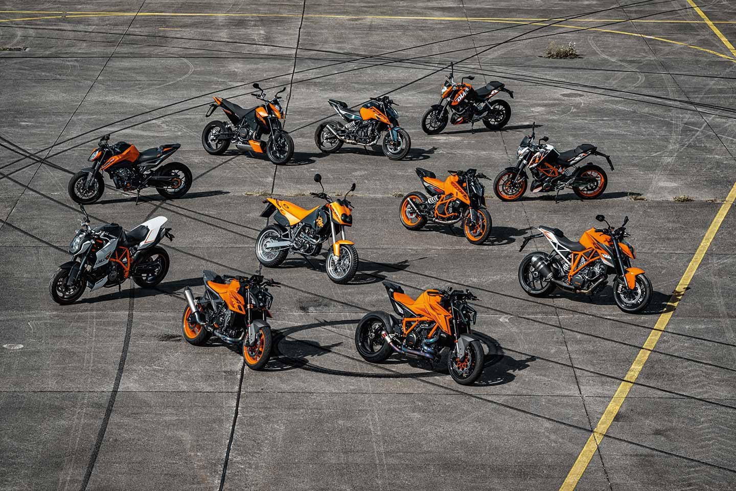

The 2024 Super Duke was launched as part of KTM’s “30 Years of Duke” celebration. The first Duke was built in 1994.
The 2024 Super Duke was launched as part of KTM’s “30 Years of Duke” celebration. The first Duke was built in 1994. (KTM/)
