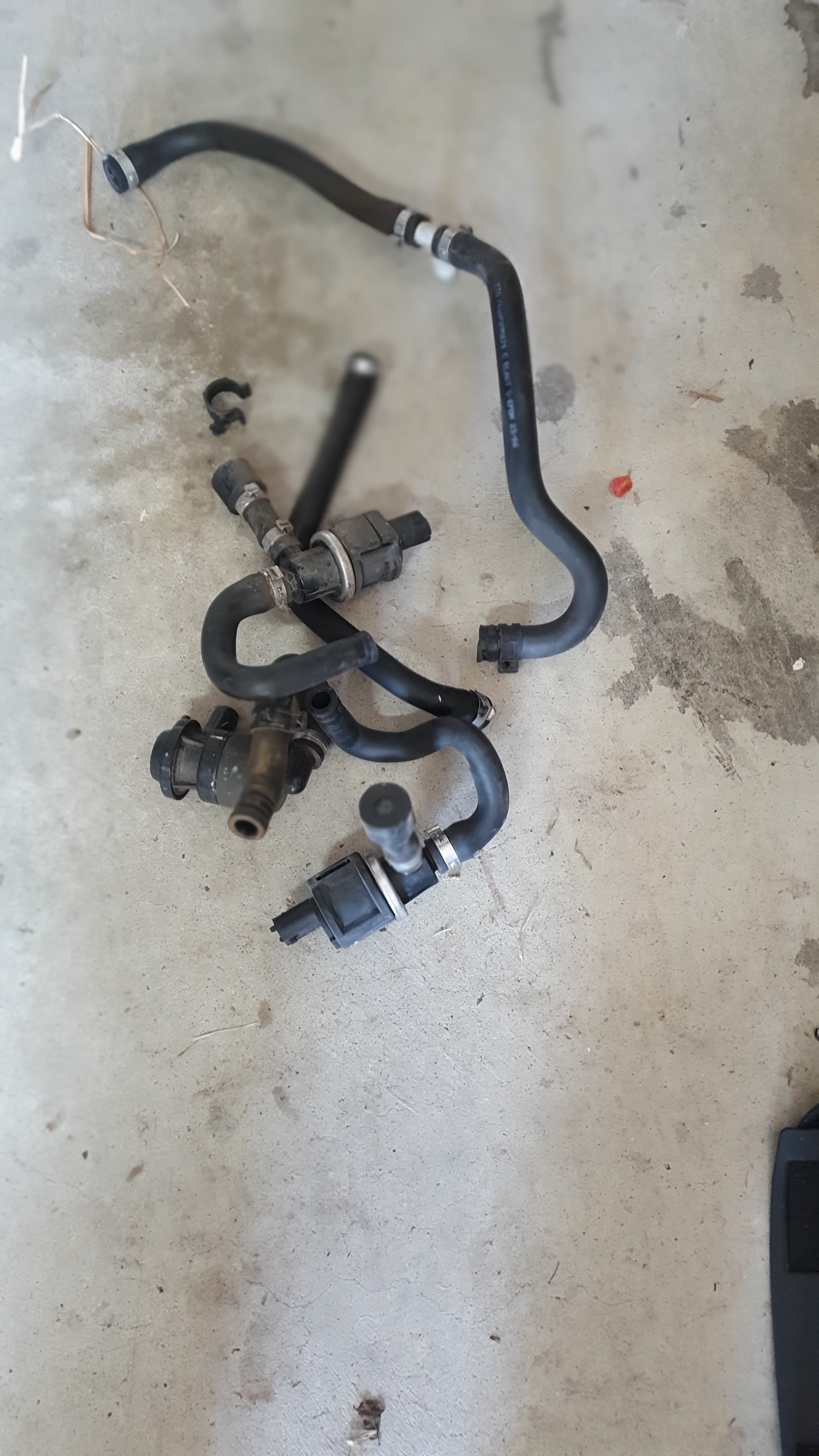

zzzak Posted April 25, 2024 Author Share Posted April 25, 2024 While waiting for someone with a compressor to be available I removed the SAS and the EPC fittings from the bike, cleans up the look without all those hoses going everywhere and doing nothing, was very satisfying, tell you what though, its rather cool on the garage, bloody 17C, I am writing a stern letter to the Prime Minister about it. Found a pic of the garage before I tidied it up, looks much better now. And a bonus moose of a size that Marcel can probably handle withoput to much assistance from Billy Bob. Why would I disable the EPC system? The EPC system reduces engine performance in 2nd/3rd gear and is only there to meet emissions requirements. Why would I disable the SAS? The SAS works together with the catalytic converter in the exhaust cans, also to reduce emissions. If you have aftermarket cans it is pointless and can cause problems. Removing the SAS is not recommended with standard cans. Why would I remove all of this stuff rather than just disable it? Because it is unnecessary, ugly, messy, restricts access to the engine, and because it is something else to go wrong, something else you won't have to consider if you do have problems. The repair manual actually warns that the EPC valves will malfunction if they are exposed to vibration. 3 1 Link to comment Share on other sites More sharing options...

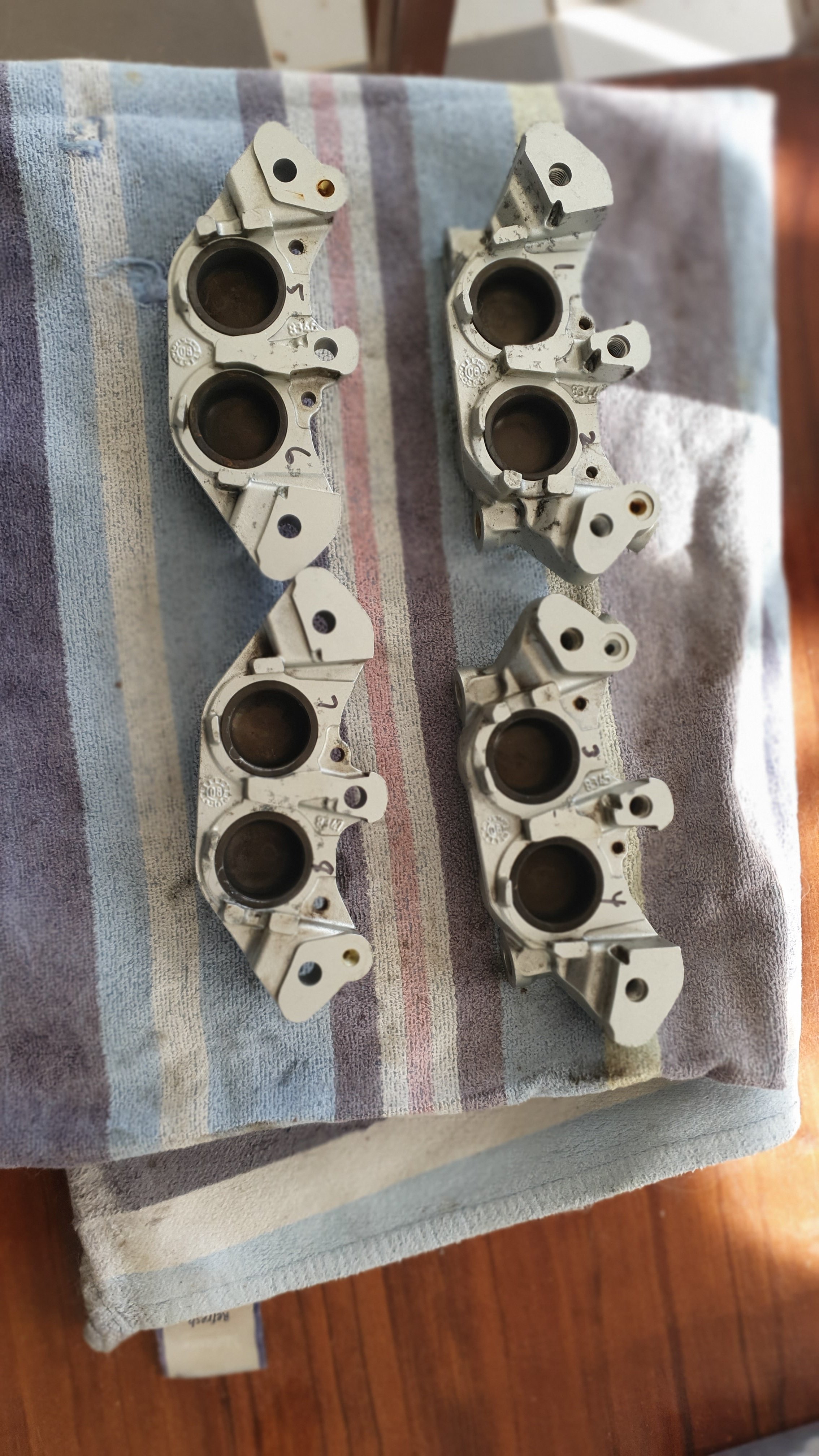

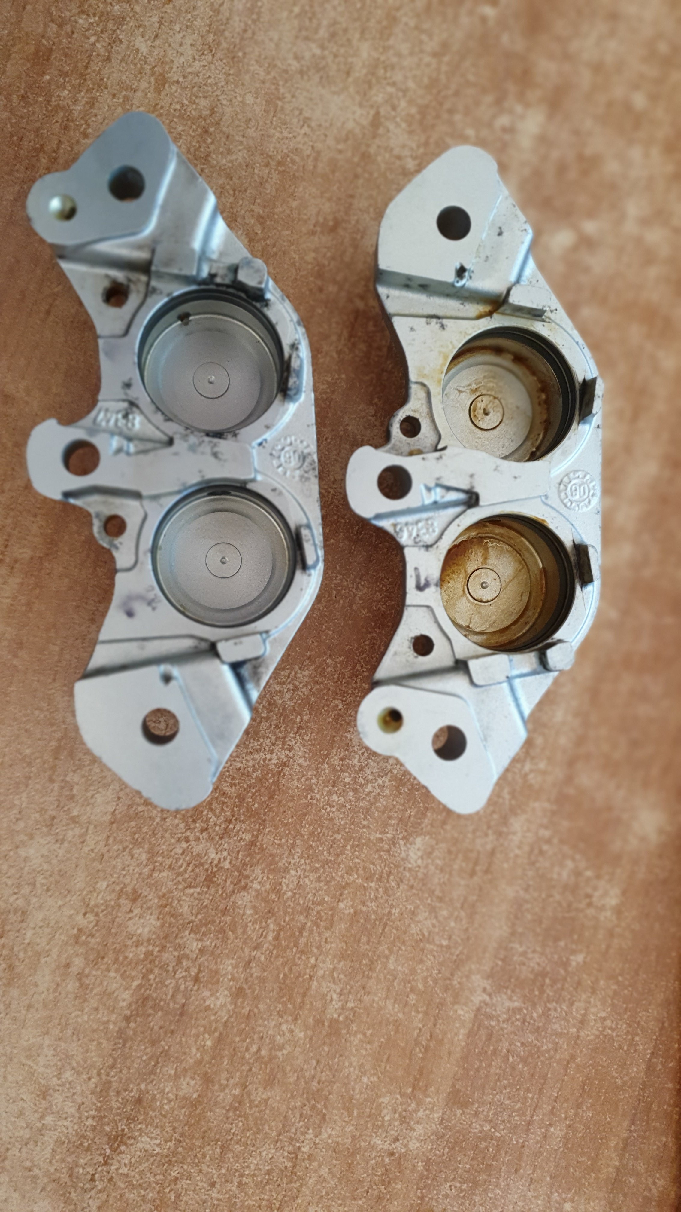

Tango Posted April 26, 2024 Share Posted April 26, 2024 On 22/04/2024 at 02:13, zzzak said: More on the brakes, here are the calipers that are ready for piston removal, the pistons are numbered but you can't see that, after much searching I have found the method of getting them out with compressed air, put a G Clamp on one piston and wrap an old rag around the other, pop one out and then reverse the procedure, sounds easy on paper but should work without damage or injury. I have found a bearing supply company in the area (100k's away) that has seals so I hope that they can match up the ones in the calipers, the KTM parts fiche says no stock so here's hoping that they are not a special size. Expand What make are those calipers? There's a possibility that they're used by other bike manufacturers on their bikes? I found that the front calipers on an old CB750F2N that I had were exactly the same as used on the early model Triumph Street Triple 675! Ones from the Honda were as rare as rocking horse shit, but there were plenty of the Triumph ones around! 2 1 Link to comment Share on other sites More sharing options...
zzzak Posted April 26, 2024 Author Share Posted April 26, 2024 On 26/04/2024 at 15:22, Tango said: What make are those calipers? There's a possibility that they're used by other bike manufacturers on their bikes? I found that the front calipers on an old CB750F2N that I had were exactly the same as used on the early model Triumph Street Triple 675! Ones from the Honda were as rare as rocking horse shit, but there were plenty of the Triumph ones around! Expand Brembos. Link to comment Share on other sites More sharing options...
Tango Posted April 26, 2024 Share Posted April 26, 2024 On 26/04/2024 at 20:18, zzzak said: Brembos. Expand So, there's a good chance that they're used on other bikes, just a case of working out which ones and then seeing if rebuild kits are available for them if you can't get them from KTM. Link to comment Share on other sites More sharing options...
zzzak Posted April 26, 2024 Author Share Posted April 26, 2024 On 26/04/2024 at 21:12, Tango said: So, there's a good chance that they're used on other bikes, just a case of working out which ones and then seeing if rebuild kits are available for them if you can't get them from KTM. Expand You're not just a pretty face are you, here's the YouTube of the exact one being rebuilt but sadly its on an MV so I don't think that I'll like the prices. Link to comment Share on other sites More sharing options...
Tango Posted April 26, 2024 Share Posted April 26, 2024 On 26/04/2024 at 21:18, zzzak said: You're not just a pretty face are you, here's the YouTube of the exact one being rebuilt but sadly its on an MV so I don't think that I'll like the prices. Expand Obviously Brembo's are top-end brakes, but you never know, those ones may have been used on a more mainstream bike? Have they got a model type or number? If so, a search on eBay may throw up some possibilities. 1 Link to comment Share on other sites More sharing options...
zzzak Posted April 26, 2024 Author Share Posted April 26, 2024 On 26/04/2024 at 21:24, Tango said: Obviously Brembo's are top-end brakes, but you never know, those ones may have been used on a more mainstream bike? Have they got a model type or number? If so, a search on eBay may throw up some possibilities. Expand I've just been searching for the model number of them, do you know how many calipers they make, effing hundreds and they all have tiny differences, nevertheless I have managed to get four of the pistons out from the passive side of the units and will be updating my tale soon. Cheers. 2 Link to comment Share on other sites More sharing options...

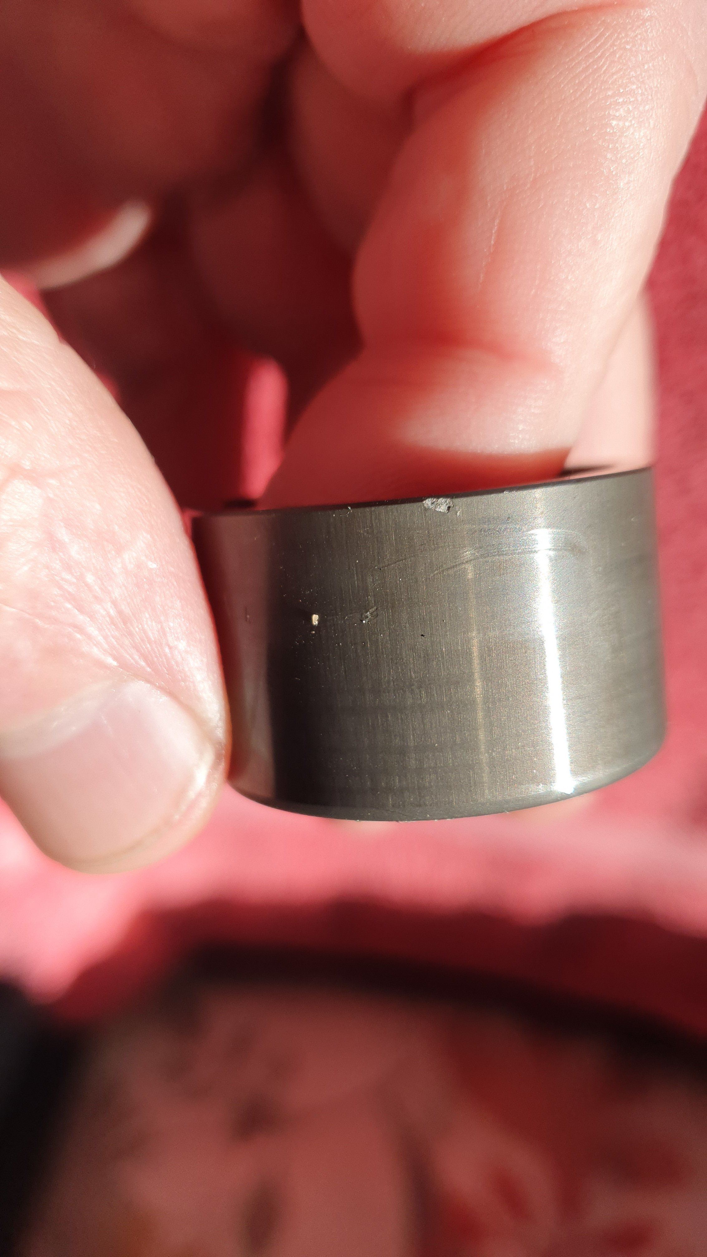

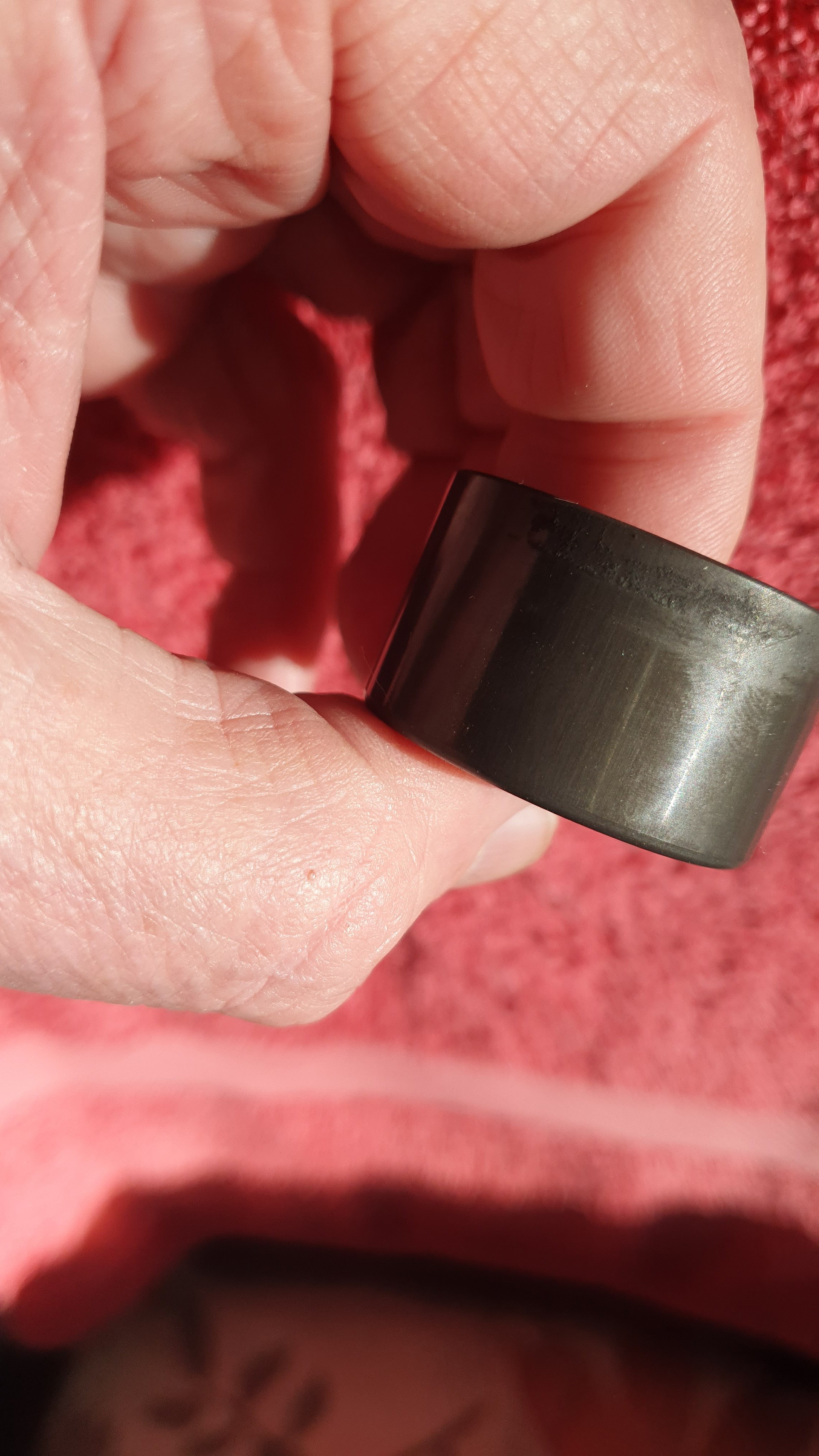

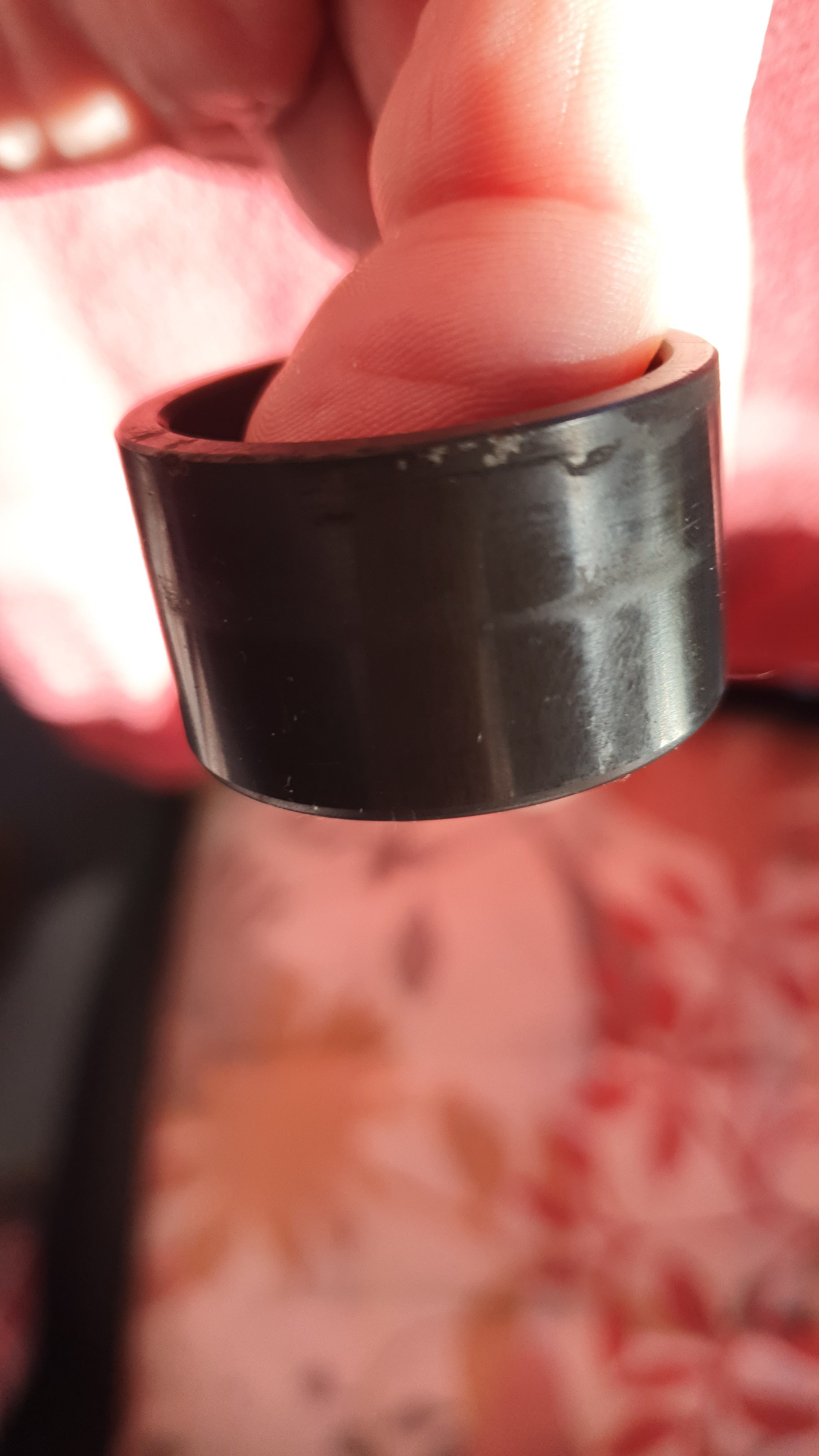

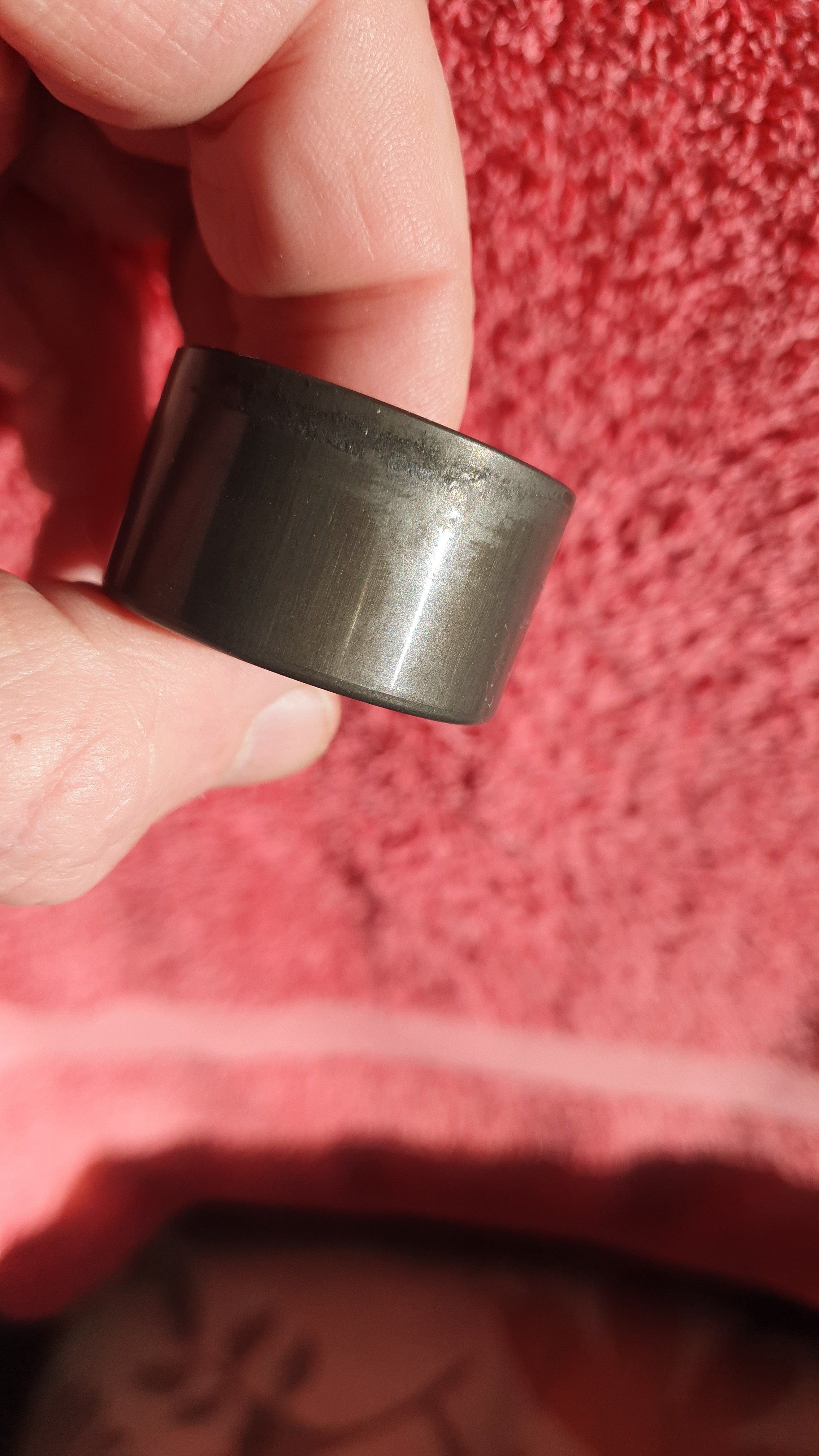

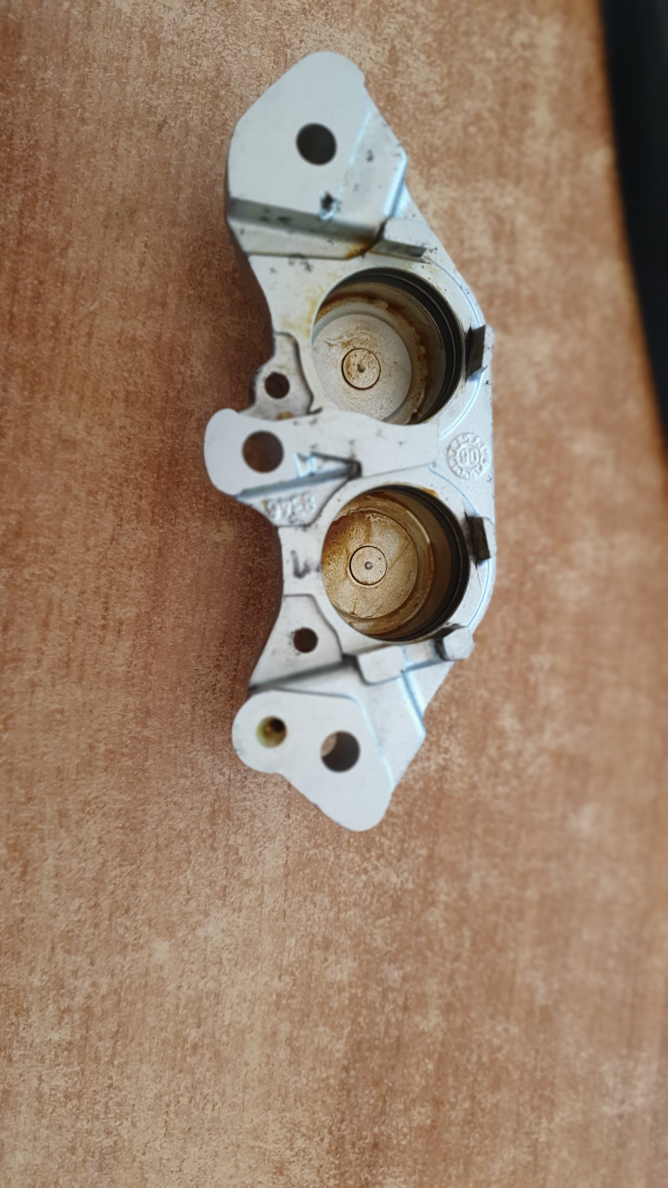

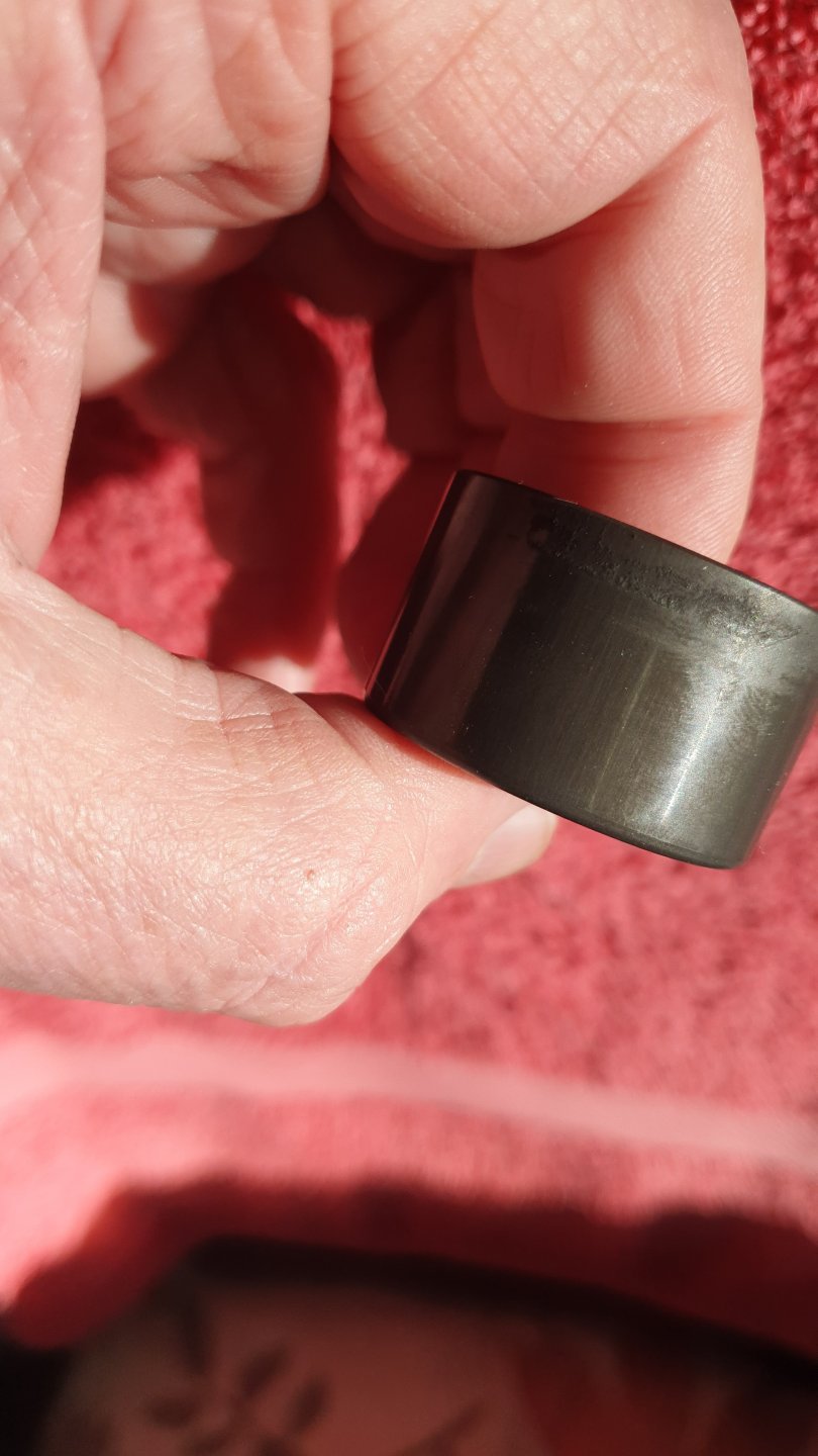

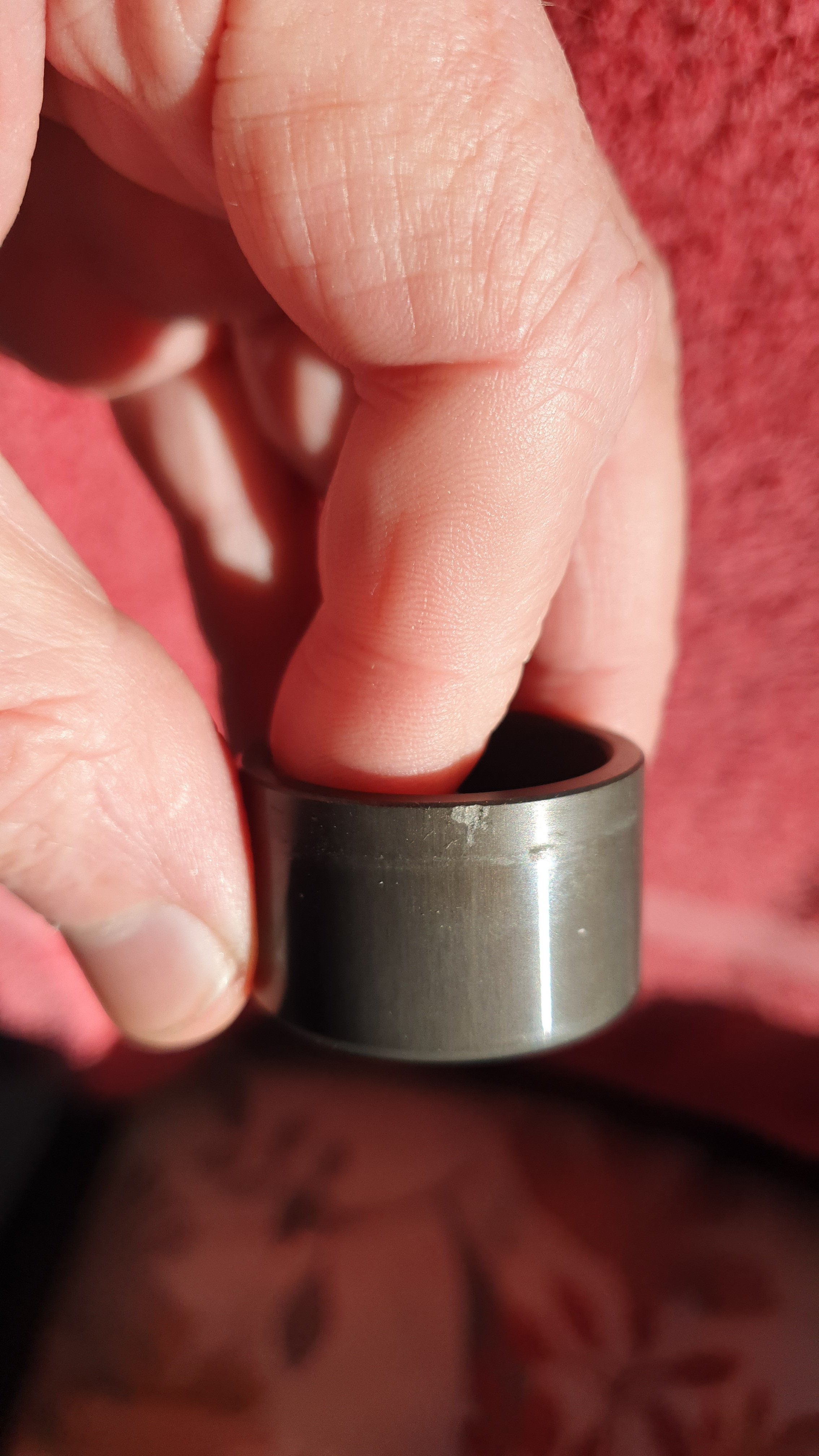

zzzak Posted April 26, 2024 Author Share Posted April 26, 2024 So here are the photos of the pistons and calipers, the little marks are baffling me as they have never been out before and they weren't dropped when I removed them. You can see a build up of matter around the pad ends but that scrapes off with a fingernail, maybe a light sand will sort them out, they aren't at a crititcal spot and the seals look OK so I think I'll reassemble them and see if they leak. I'll be doing the other side ones soon, the air gun I used didn't have a rubber sealing tip so I may try and use a rubber glove with a pinhole in it or something, until I get to see the condition of those pistons I'll bide my time. 1 Link to comment Share on other sites More sharing options...
zzzak Posted April 27, 2024 Author Share Posted April 27, 2024 I have come to the conclusion that those marks and the ring of dirt have come from the piston being extended under braking, that being the case they will only affect the dust seal and not the main brake fluid seal so they should be good to use. The local Brembo site only has bits for KTM fittings back to 2009 so mine aren't there. 1 Link to comment Share on other sites More sharing options...
Catteeclan Posted April 27, 2024 Share Posted April 27, 2024 On 26/04/2024 at 22:55, zzzak said: So here are the photos of the pistons and calipers, the little marks are baffling me as they have never been out before and they weren't dropped when I removed them. You can see a build up of matter around the pad ends but that scrapes off with a fingernail, maybe a light sand will sort them out, they aren't at a crititcal spot and the seals look OK so I think I'll reassemble them and see if they leak. I'll be doing the other side ones soon, the air gun I used didn't have a rubber sealing tip so I may try and use a rubber glove with a pinhole in it or something, until I get to see the condition of those pistons I'll bide my time. Expand Are those that crap composite pistons, throw them away and get someone to turn you out some stainless. Seeing them on cars going out of shape and sticking up causing over heating. 2 Link to comment Share on other sites More sharing options...
zzzak Posted April 27, 2024 Author Share Posted April 27, 2024 On 27/04/2024 at 06:53, Catteeclan said: Are those that crap composite pistons, throw them away and get someone to turn you out some stainless. Seeing them on cars going out of shape and sticking up causing over heating. Expand They've done 43,000 k so far so they're staying, for the cost of getting S/S turned out here I could probably buy a new bike. 1 Link to comment Share on other sites More sharing options...

Buckster Posted April 27, 2024 Share Posted April 27, 2024 On 27/04/2024 at 04:35, zzzak said: I have come to the conclusion that those marks and the ring of dirt have come from the piston being extended under braking, that being the case they will only affect the dust seal and not the main brake fluid seal so they should be good to use. The local Brembo site only has bits for KTM fittings back to 2009 so mine aren't there. Expand They used the same pistons from 2005 to 2020. 1 Link to comment Share on other sites More sharing options...
zzzak Posted April 28, 2024 Author Share Posted April 28, 2024 On 27/04/2024 at 23:03, Buckster said: They used the same pistons from 2005 to 2020. Expand Thanks for the input, my pistons measure 34 but the Brembo site only mentions 40's, anyway it doesn't matter because these ones are going back in, cheers. Link to comment Share on other sites More sharing options...

Buckster Posted April 28, 2024 Share Posted April 28, 2024 On 28/04/2024 at 00:17, zzzak said: Thanks for the input, my pistons measure 34 but the Brembo site only mentions 40's, anyway it doesn't matter because these ones are going back in, cheers. Expand 34mm pistons are readily available. Link to comment Share on other sites More sharing options...

Catteeclan Posted April 28, 2024 Share Posted April 28, 2024 On 28/04/2024 at 07:29, Buckster said: 34mm pistons are readily available. Expand Plenty on eBay too. Link to comment Share on other sites More sharing options...
zzzak Posted April 28, 2024 Author Share Posted April 28, 2024 On 28/04/2024 at 15:35, boboneleg said: 43 K before you bothered to change the air filter Expand Remove the tank shrouds and the plastic covers that are either side of the radiator, and unscrew the large tank bolt at the rear of the tank (I'm sure your already there). Underneath the left hand rad plastic cover there is the horn, and a couple of plastic electrical connectors. The horn and one of the electrical connectors (can't remember which one) needs to be disconnected. Shut off the fuel tap valves that are at the front lower part of the tank, both sides, they look like small (10mm dia) silver valves. Disconnect the fuel lines from both sides. The fuel pump is attached to the left hand side inner surface of the tank. You could either disconnect the lines that run to and from the pump (=faff!) or pull the fuel pump from the tank (easy). You need to pull it towards the right hand side of the bike. The pump is mounted in a large rubber block, which has 2 slots in it. These 2 slots fit over 2 metal tongs. Its quite a tight fit and takes a bit of effort to remove, helps to have one person lift the tank and the other work at uncoupling the fuel pump, but you can lift the tank and rest it in a lifted position to give you more room to work on the pump. Once the pump is disco'd the tank should lift off. Its a bastard of a job and the bike seemed to be running just fine, due to the age of the rubbers I think it took two of us about 30 minutes to get it off, anyway it doesn't matter now and I look forward to the enhanced performance from the new filter and cans. 1 Link to comment Share on other sites More sharing options...
zzzak Posted April 28, 2024 Author Share Posted April 28, 2024 On 28/04/2024 at 18:59, Catteeclan said: Plenty on eBay too. Expand None that would fit my bike, there are Kwaka, Honda etc but no actual KTM ones and the prices are outrageous when you include postage, anyway the ones that I have are going back in so we are trying to find a solution for a problem that doesn't exist. Link to comment Share on other sites More sharing options...
