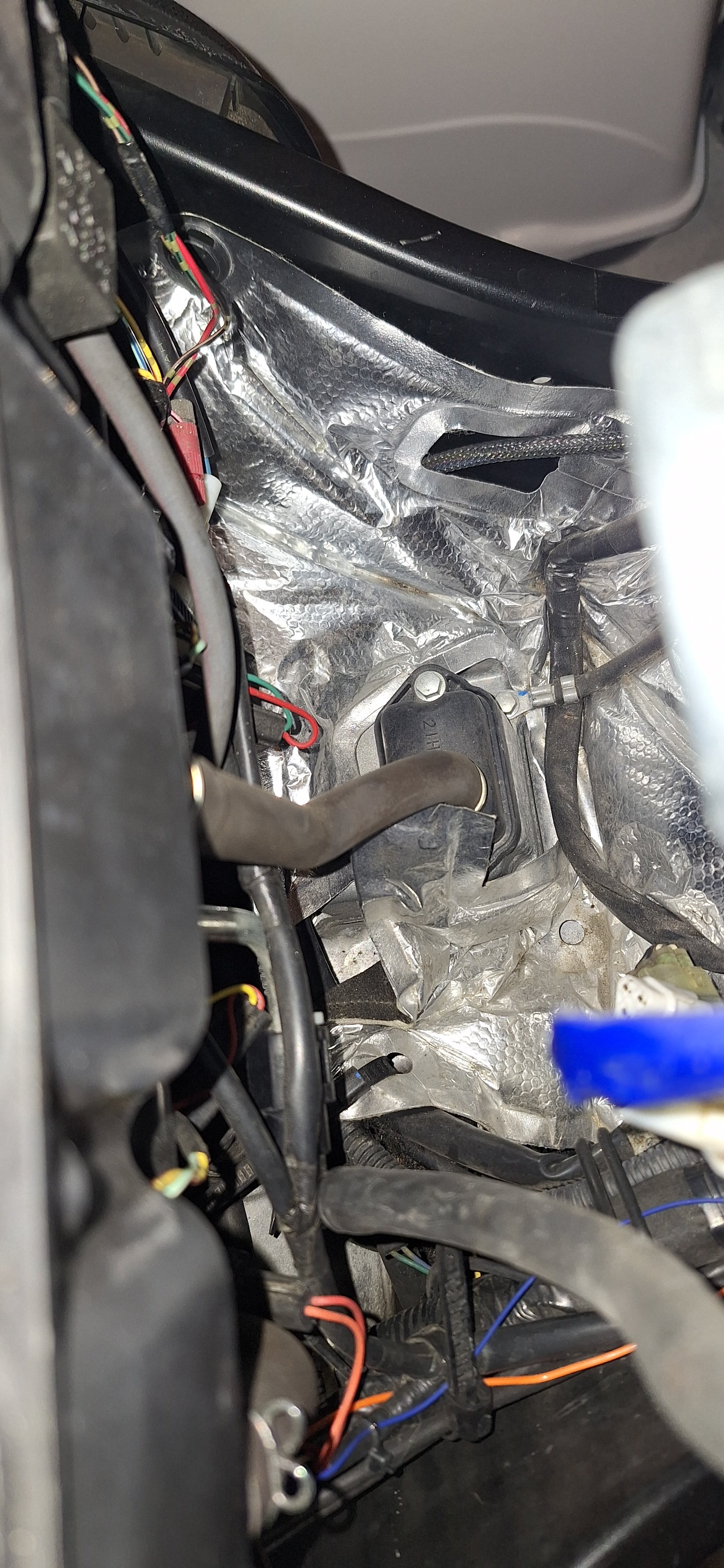

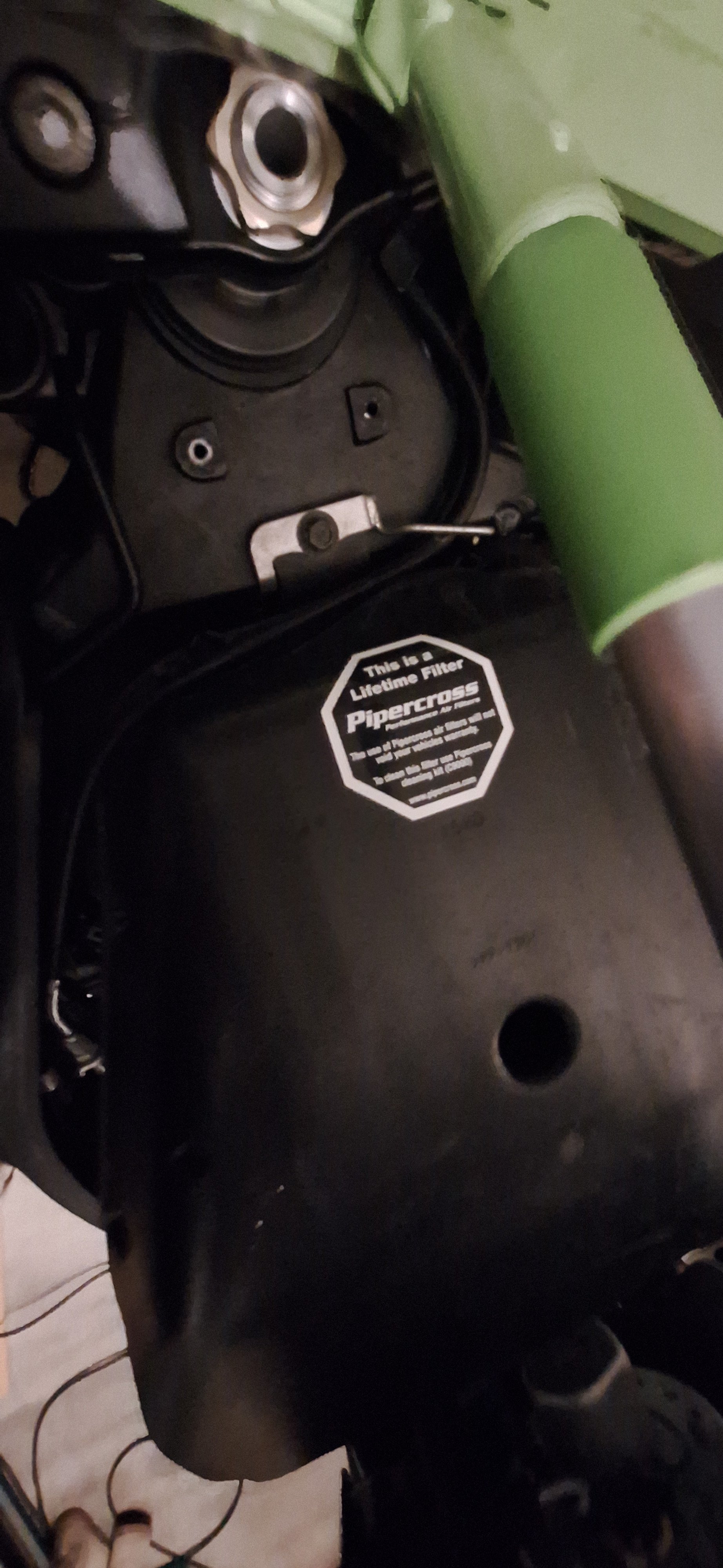

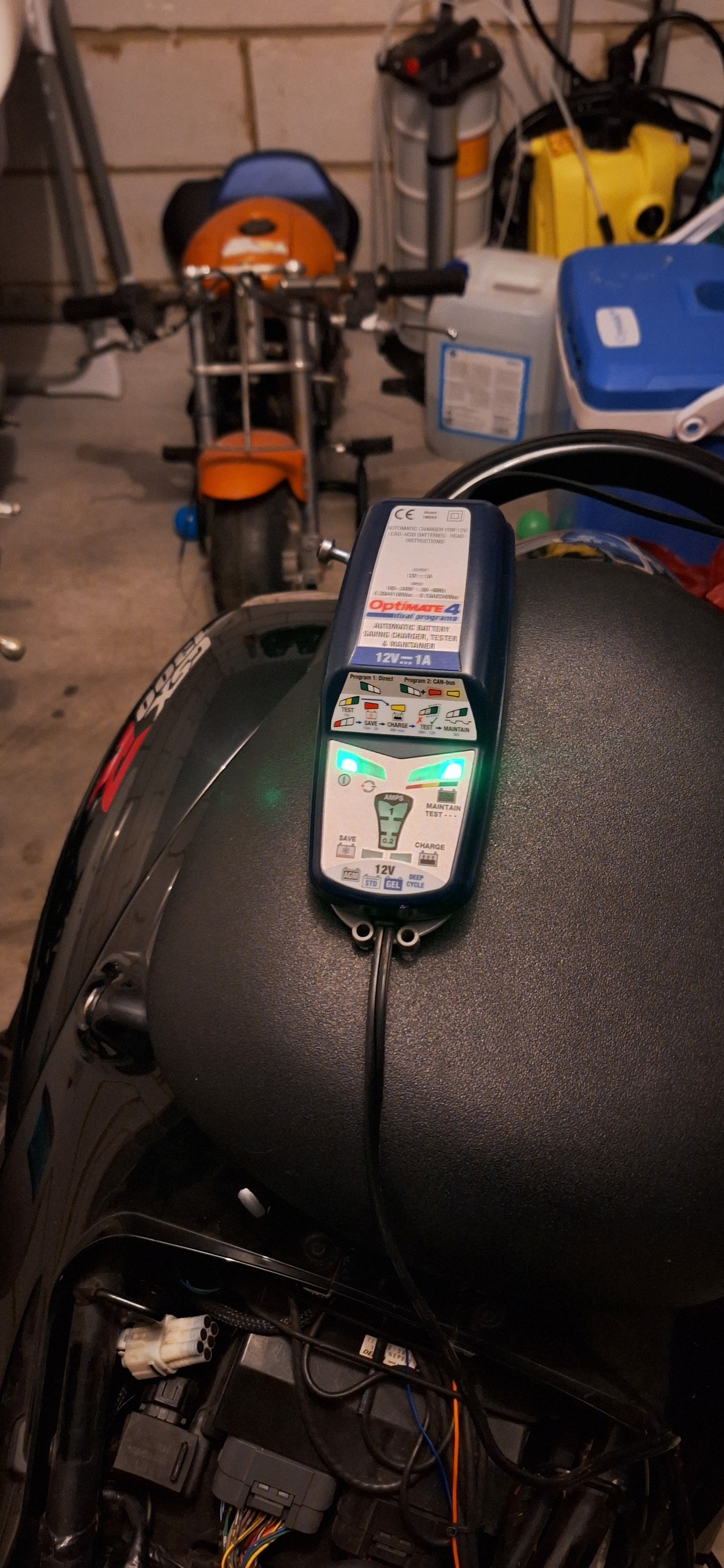

busabeast Posted March 31, 2024 Author Share Posted March 31, 2024 Let's get to investigating oh and before you say owt no i cant see a fucking thing with this shit single light in here, id be better off using a candle... What I can tell you is it appears by the sticker at least to be running a pipercross airfilter and the optimate says the battery is good too 2 Link to comment Share on other sites More sharing options...

Buckster Posted March 31, 2024 Share Posted March 31, 2024 8 minutes ago, busabeast said: Let's get to investigating oh and before you say owt no i cant see a fucking thing with this shit single light in here, id be better off using a candle... What I can tell you is it appears by the sticker at least to be running a pipercross airfilter and the optimate says the battery is good too There could be a bit of corrosion on the terminals from standing. 1 Link to comment Share on other sites More sharing options...

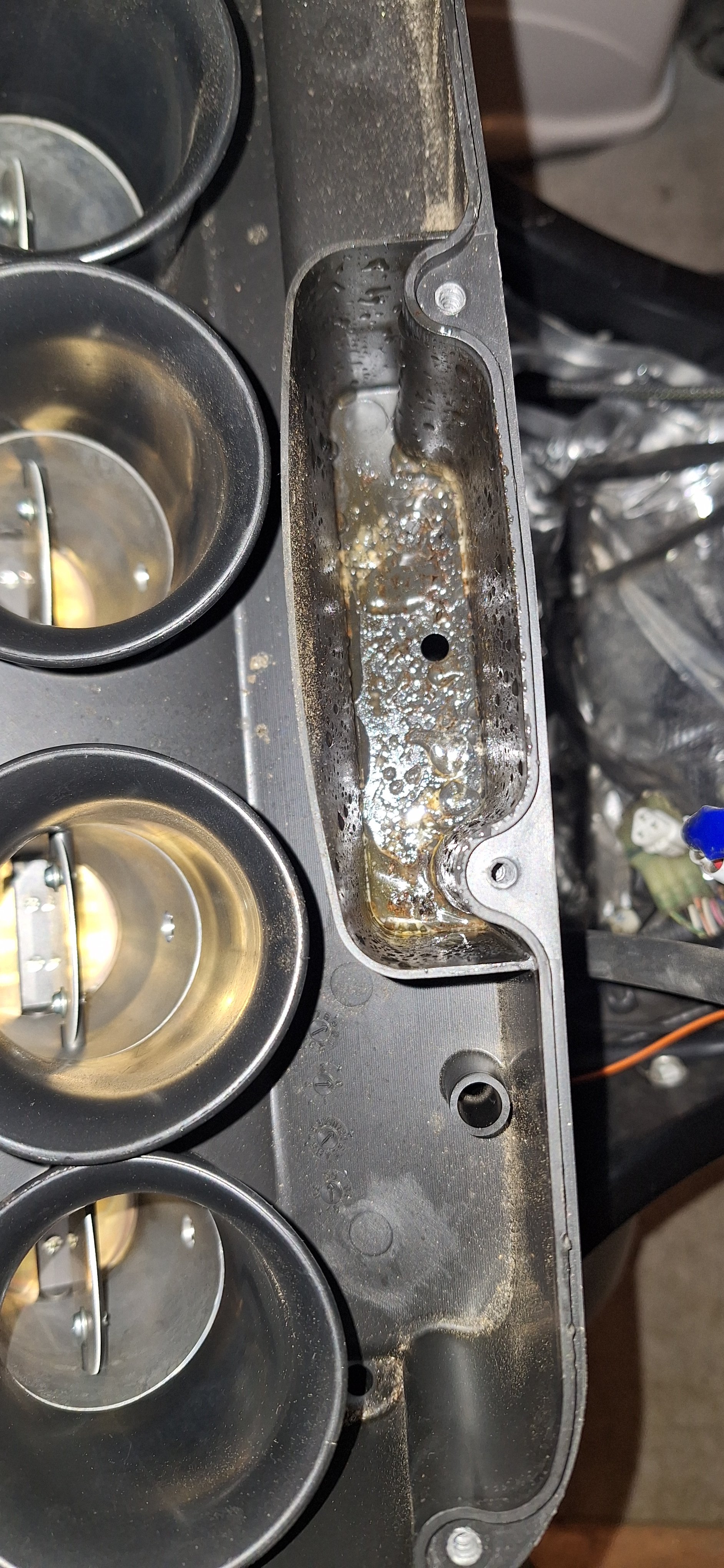

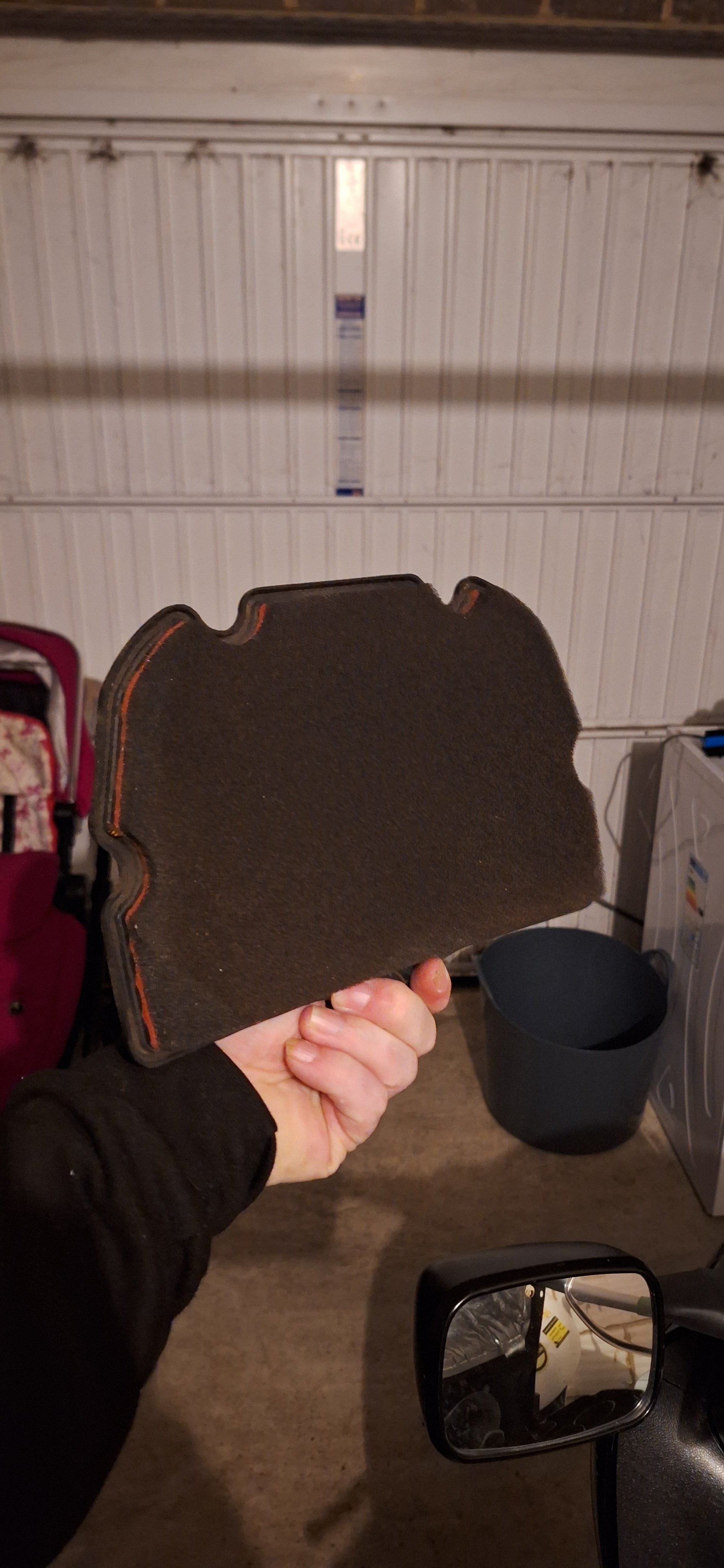

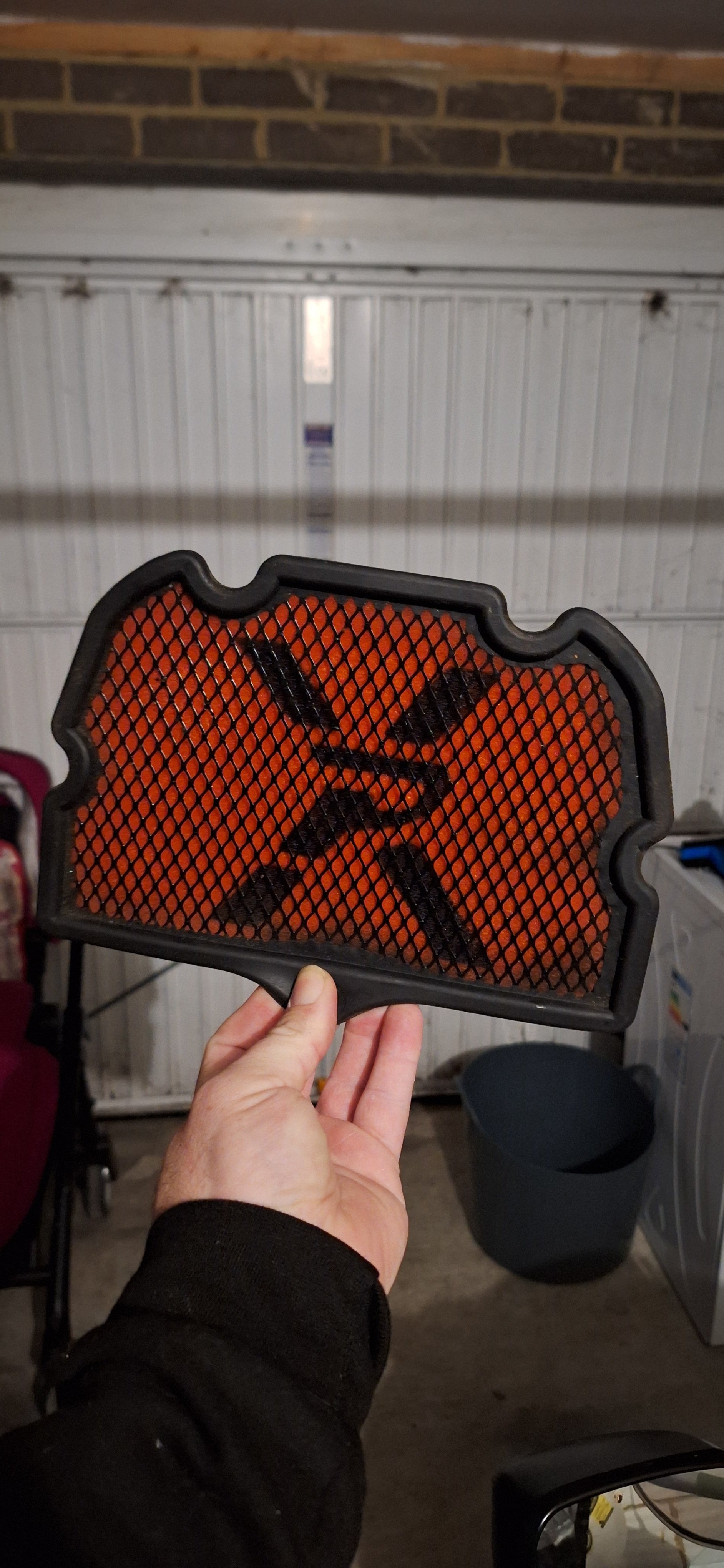

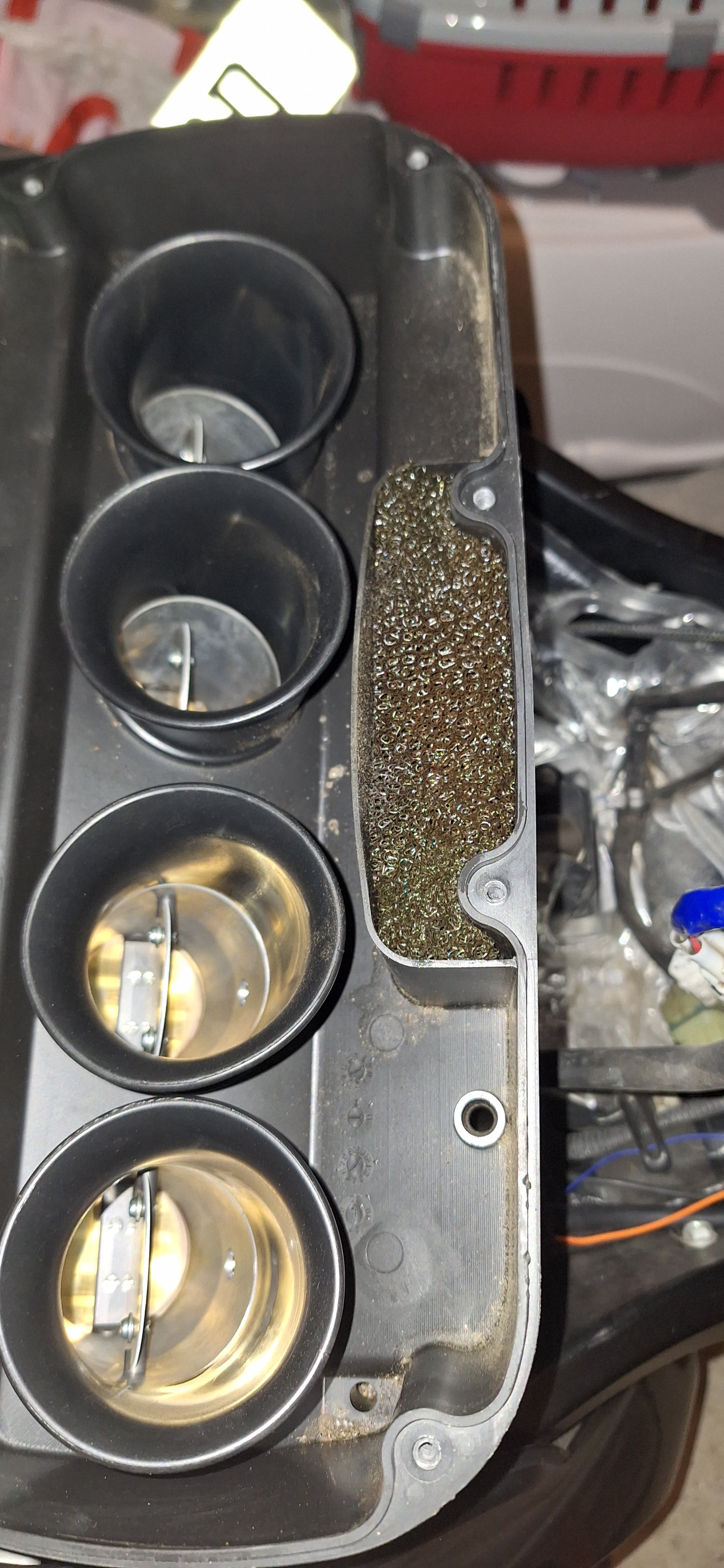

busabeast Posted March 31, 2024 Author Share Posted March 31, 2024 Well im not sure why it would be damp in that recess but it sits over the top of that wadding and it is soaked but with what feels like water instead of fuel so unsure what thats all about it does indeed have a pippercross air filter fitter and the airflow facing side just needed a quick brush off and it's as good as new I've had a good look over the trumpets and there's no visible cracking and they feel as I'd expect them too and opening the throttle there's no visible hindrance in the bores and everything appears tight. I don't think I like the idea that there seems to be no inline fuel filter fitted though 4 Link to comment Share on other sites More sharing options...

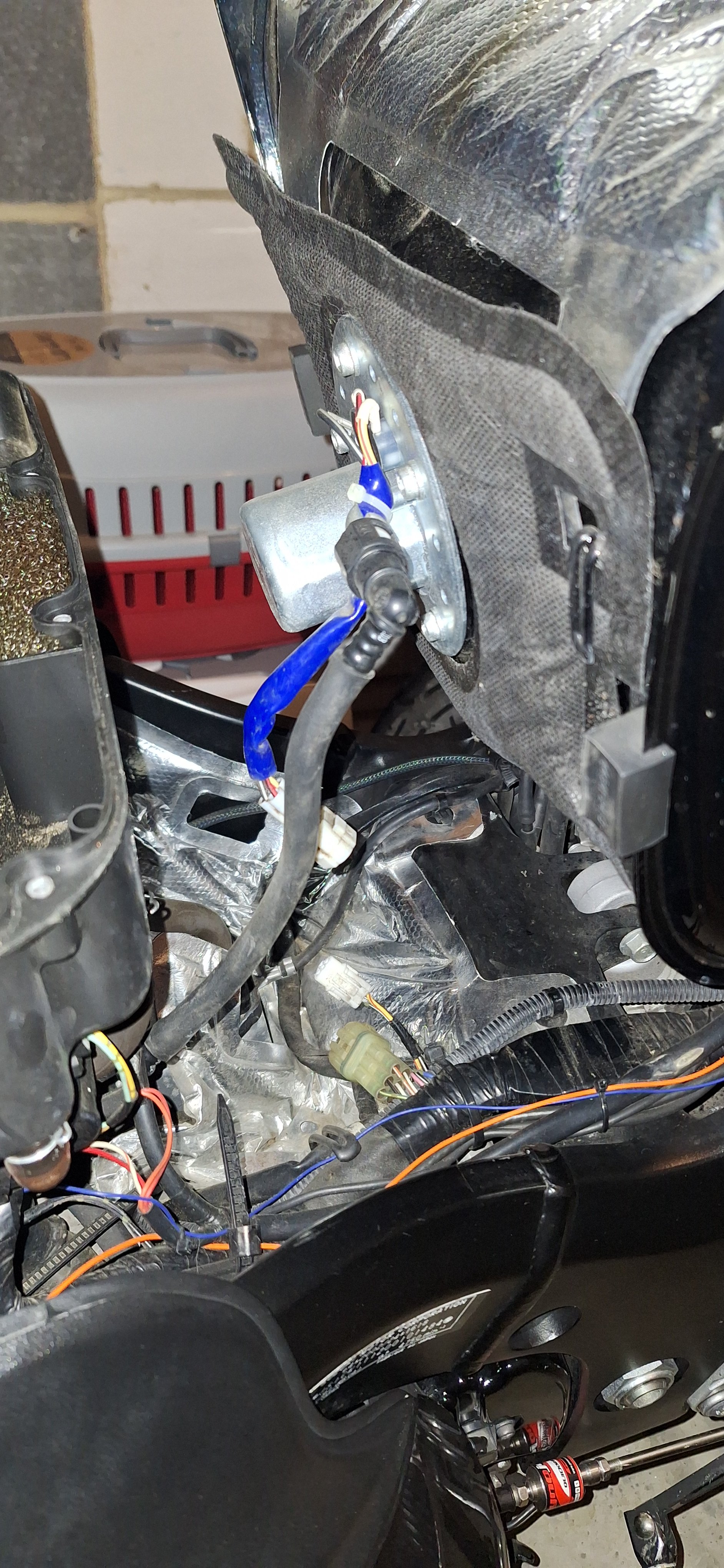

busabeast Posted March 31, 2024 Author Share Posted March 31, 2024 8 minutes ago, Buckster said: There could be a bit of corrosion on the terminals from standing. On the battery you mean or on the connector blocks and the like under the tank? Link to comment Share on other sites More sharing options...

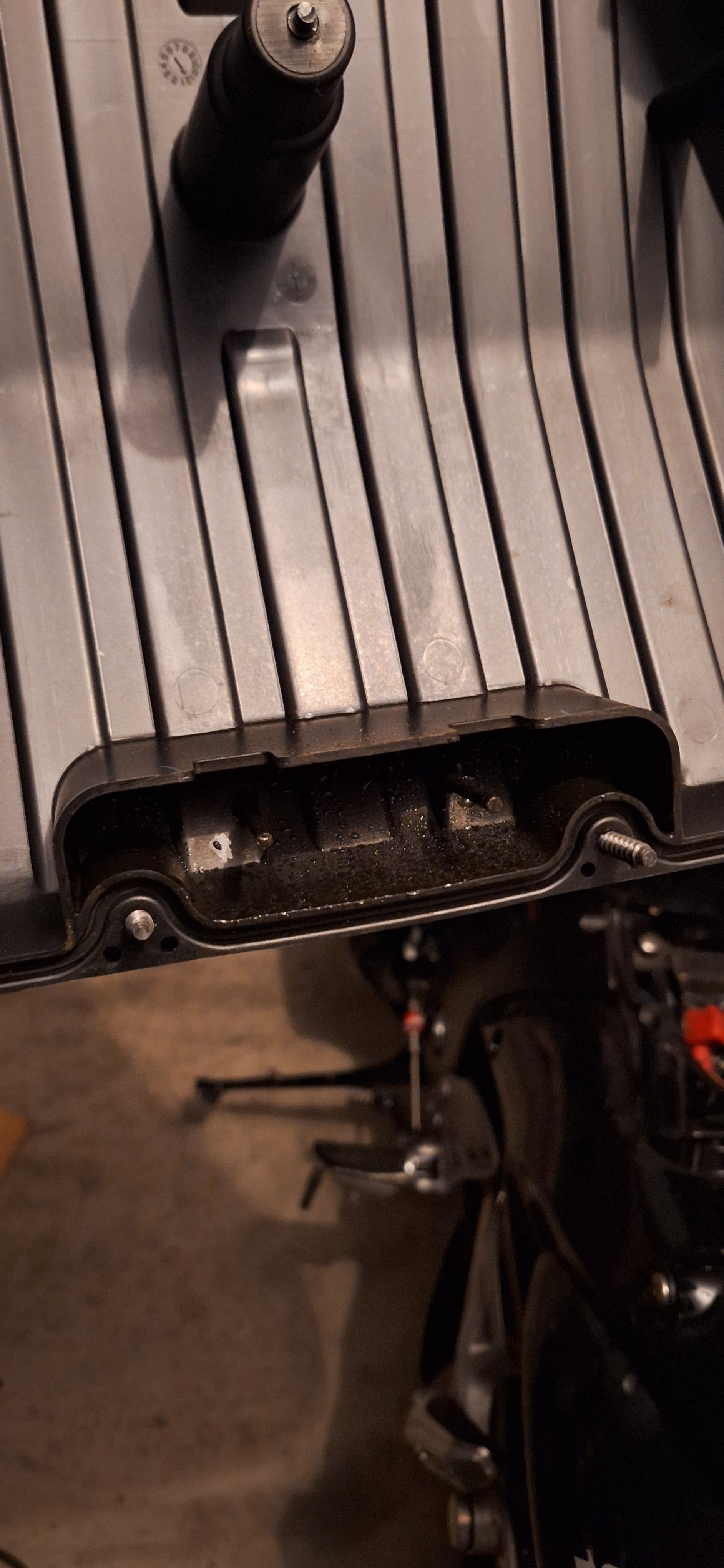

busabeast Posted March 31, 2024 Author Share Posted March 31, 2024 Well that's some horrible looking cruddy shite, not so sure it's meant to look like that looks to be from the crankcase breather 1 Link to comment Share on other sites More sharing options...
Buckster Posted March 31, 2024 Share Posted March 31, 2024 28 minutes ago, busabeast said: On the battery you mean or on the connector blocks and the like under the tank? Battery terminals. 1 Link to comment Share on other sites More sharing options...
busabeast Posted March 31, 2024 Author Share Posted March 31, 2024 1 minute ago, Buckster said: Battery terminals. Just checked the battery terminals and they are tight and appear to be sound, I've just started it now and there was no hesitation at all so I'm thinking the optimate must have done it's thing and recovered it. I only ran it for a couple of seconds mind you given its getting late and it echoes in here so I'll have another ganders at it tomorrow morning and see how the idle is, if its steady away then the bike must be very sensitive to a slightly wonky battery Link to comment Share on other sites More sharing options...
boboneleg Posted March 31, 2024 Share Posted March 31, 2024 26 minutes ago, busabeast said: Well that's some horrible looking cruddy shite, not so sure it's meant to look like that looks to be from the crankcase breather Just clean it and lightly re-oil it 2 Link to comment Share on other sites More sharing options...
boboneleg Posted March 31, 2024 Share Posted March 31, 2024 3 minutes ago, busabeast said: Just checked the battery terminals and they are tight and appear to be sound, I've just started it now and there was no hesitation at all so I'm thinking the optimate must have done it's thing and recovered it. I only ran it for a couple of seconds mind you given its getting late and it echoes in here so I'll have another ganders at it tomorrow morning and see how the idle is, if its steady away then the bike must be very sensitive to a slightly wonky battery Check where your battery negative terminal goes to earth as well , also check the connector on the rectifier for corrosion and cover them in dialectric grease. If you haven't got any pinch some of your wife's vaseline 1 Link to comment Share on other sites More sharing options...
busabeast Posted March 31, 2024 Author Share Posted March 31, 2024 9 minutes ago, boboneleg said: Check where your battery negative terminal goes to earth as well , also check the connector on the rectifier for corrosion and cover them in dialectric grease. If you haven't got any pinch some of your wife's vaseline I shall have a check over them tomorrow I've shut up shop for the night now 1 Link to comment Share on other sites More sharing options...
Buckster Posted March 31, 2024 Share Posted March 31, 2024 It is worth cleaning the terminals anyway. 1 Link to comment Share on other sites More sharing options...
busabeast Posted March 31, 2024 Author Share Posted March 31, 2024 6 minutes ago, Buckster said: It is worth cleaning the terminals anyway. I'll take them off tomorrow and give them a quick brush up and as Bob said check out the earth and reg/rec and see what happens after Link to comment Share on other sites More sharing options...
Buckster Posted March 31, 2024 Share Posted March 31, 2024 1 minute ago, busabeast said: I'll take them off tomorrow and give them a quick brush up and as Bob said check out the earth and reg/rec and see what happens after Starter terminal as well. 1 Link to comment Share on other sites More sharing options...
busabeast Posted March 31, 2024 Author Share Posted March 31, 2024 17 minutes ago, Buckster said: Starter terminal as well. Not a bad shout I'll add it to the list of things to check Link to comment Share on other sites More sharing options...
busabeast Posted April 1, 2024 Author Share Posted April 1, 2024 10 hours ago, Marcel said: Have you got any cranking power...I haven't read the hole thing..? Yeah I put the optimate on it for a few hours and it recovered the battery no problem, when I fired it up last night after cleaning the air filter and other bits it didn't struggle at all so it must be sensitive to a low battery. I'll get it out today and run it up to temp to see if the idle has returned to normal 1 Link to comment Share on other sites More sharing options...

Six30 Posted April 1, 2024 Share Posted April 1, 2024 14 hours ago, busabeast said: Well that's some horrible looking cruddy shite, not so sure it's meant to look like that looks to be from the crankcase breather thats when you shit yourself when you open it up 2 Link to comment Share on other sites More sharing options...
busabeast Posted April 1, 2024 Author Share Posted April 1, 2024 29 minutes ago, Six30 said: thats when you shit yourself when you open it up To be fair I opened it up a few times yesterday and I didn't shit myself, could well have been from the first ride of the year though Link to comment Share on other sites More sharing options...
