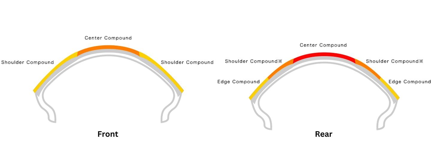

As with the S22, the S23 front benefits from a 3 Layer Compound (3LC) and the S23 rear from Bridgestone’s 5 Layer Compound (5LC) technology. This means the front tire has different rubber compounds on the center and shoulders, whereas the rear has different compounds on the center, shoulders, and edges. For the S23, Bridgestone has reworked the front tire’s shoulder compound and the rear tire’s edge compound with grip improvers and modified polymers that help the tire conform to the road better and maintain grip.

As with the S22, the S23 front has three zones and the rear five zones. The front tire’s shoulder compound is updated, as is the rear tire’s edge compound, for better road holding.
As with the S22, the S23 front has three zones and the rear five zones. The front tire’s shoulder compound is updated, as is the rear tire’s edge compound, for better road holding. (Bridgestone/)

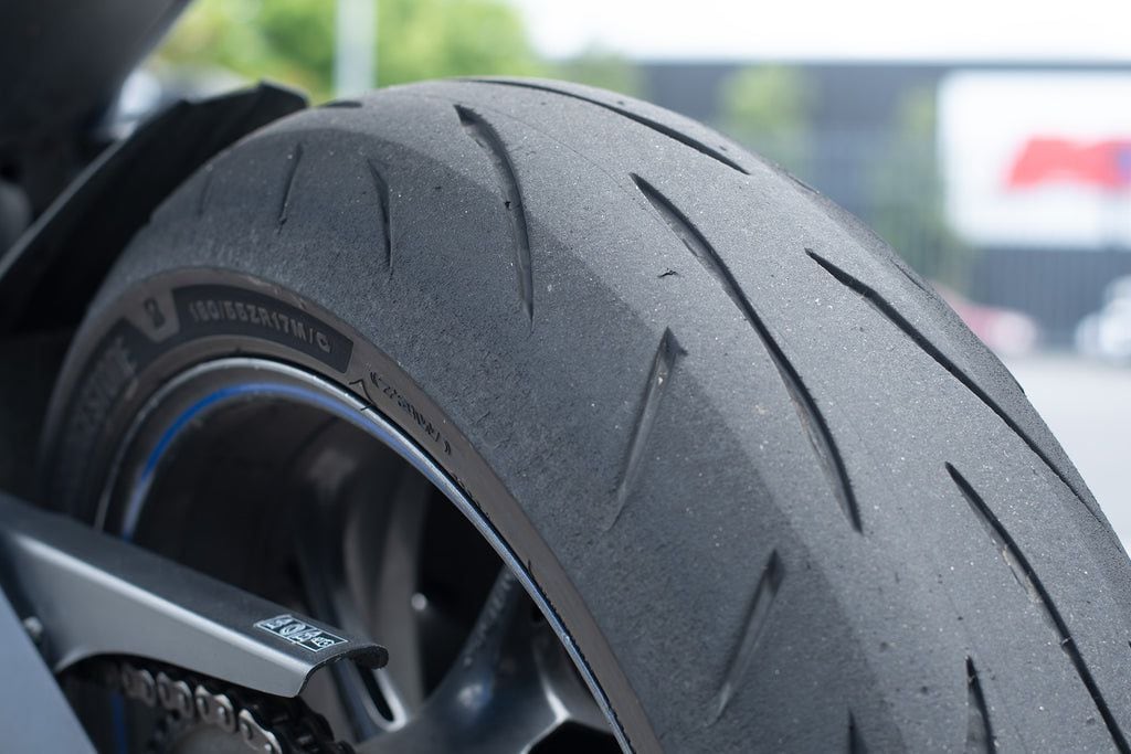

Bridgestone claims that rear tire wear has been improved by 8 percent.
Bridgestone claims that rear tire wear has been improved by 8 percent. (Bridgestone/)

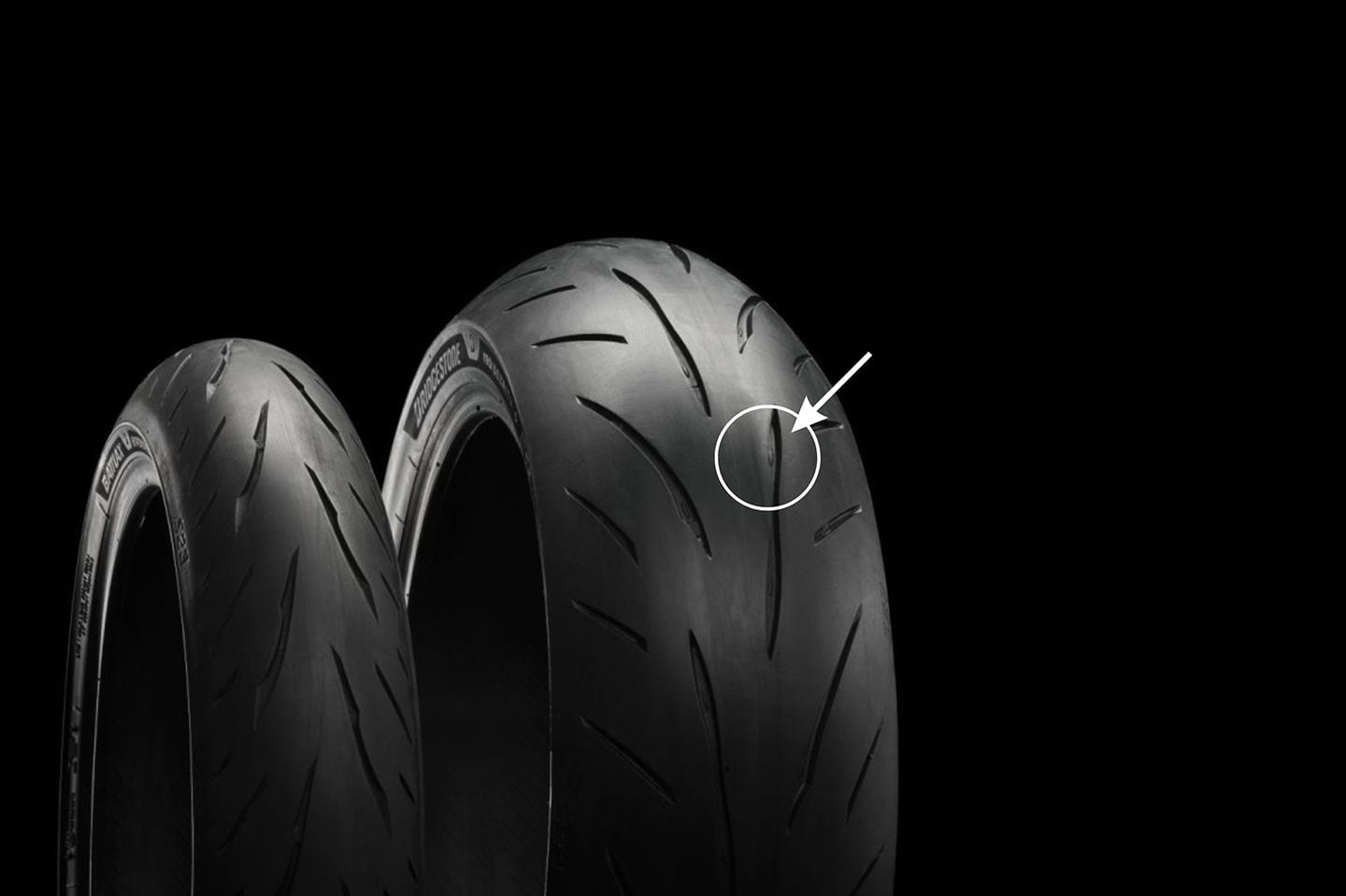

Wet-weather performance is improved thanks to the addition of Bridgestone’s Pulse Groove technology on the rear tire. The reshaped groove with center deflector (circled) accelerates water through the footprint better compared to a traditional groove.
Wet-weather performance is improved thanks to the addition of Bridgestone’s Pulse Groove technology on the rear tire. The reshaped groove with center deflector (circled) accelerates water through the footprint better compared to a traditional groove. (Bridgestone/)
