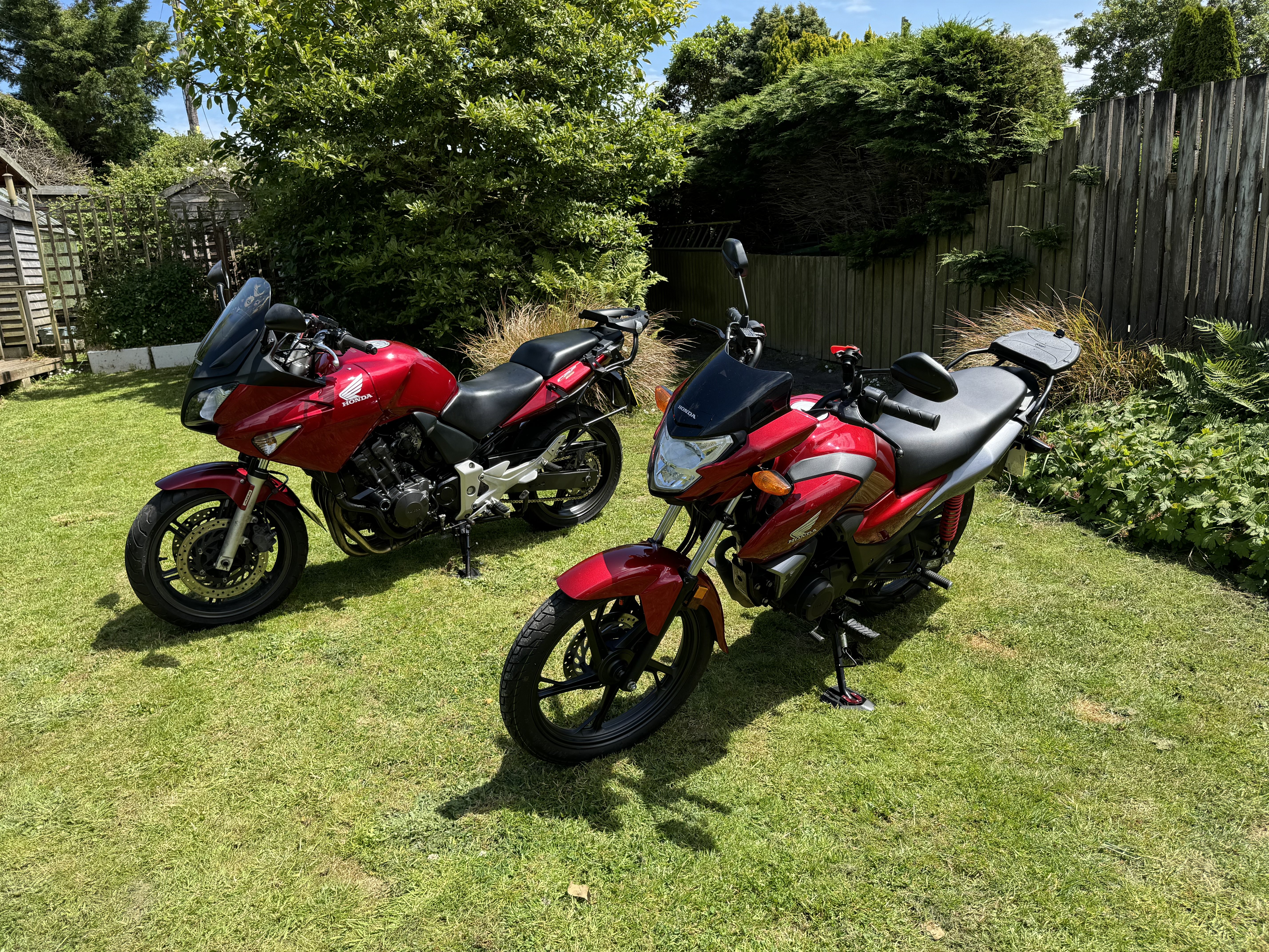

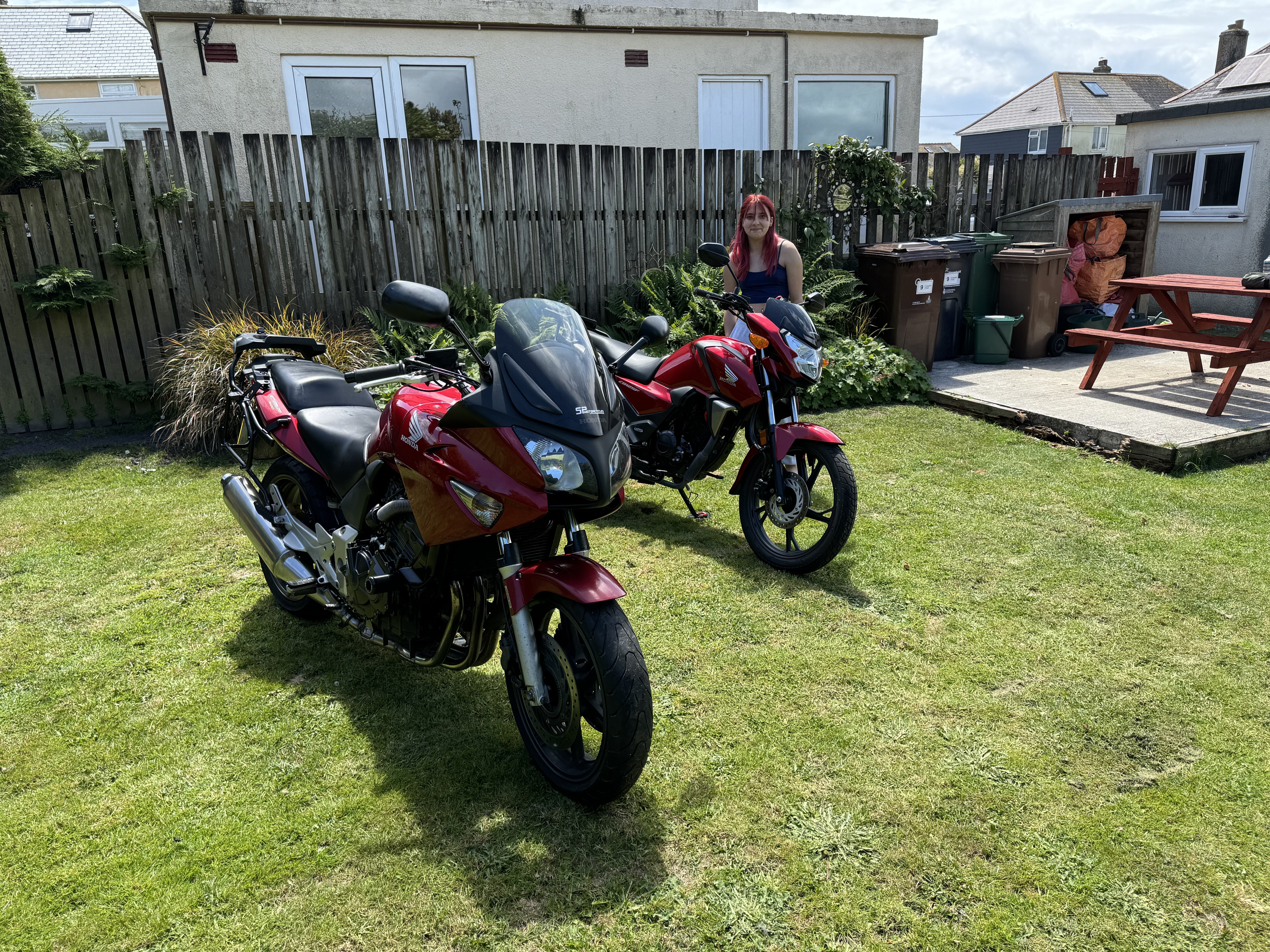

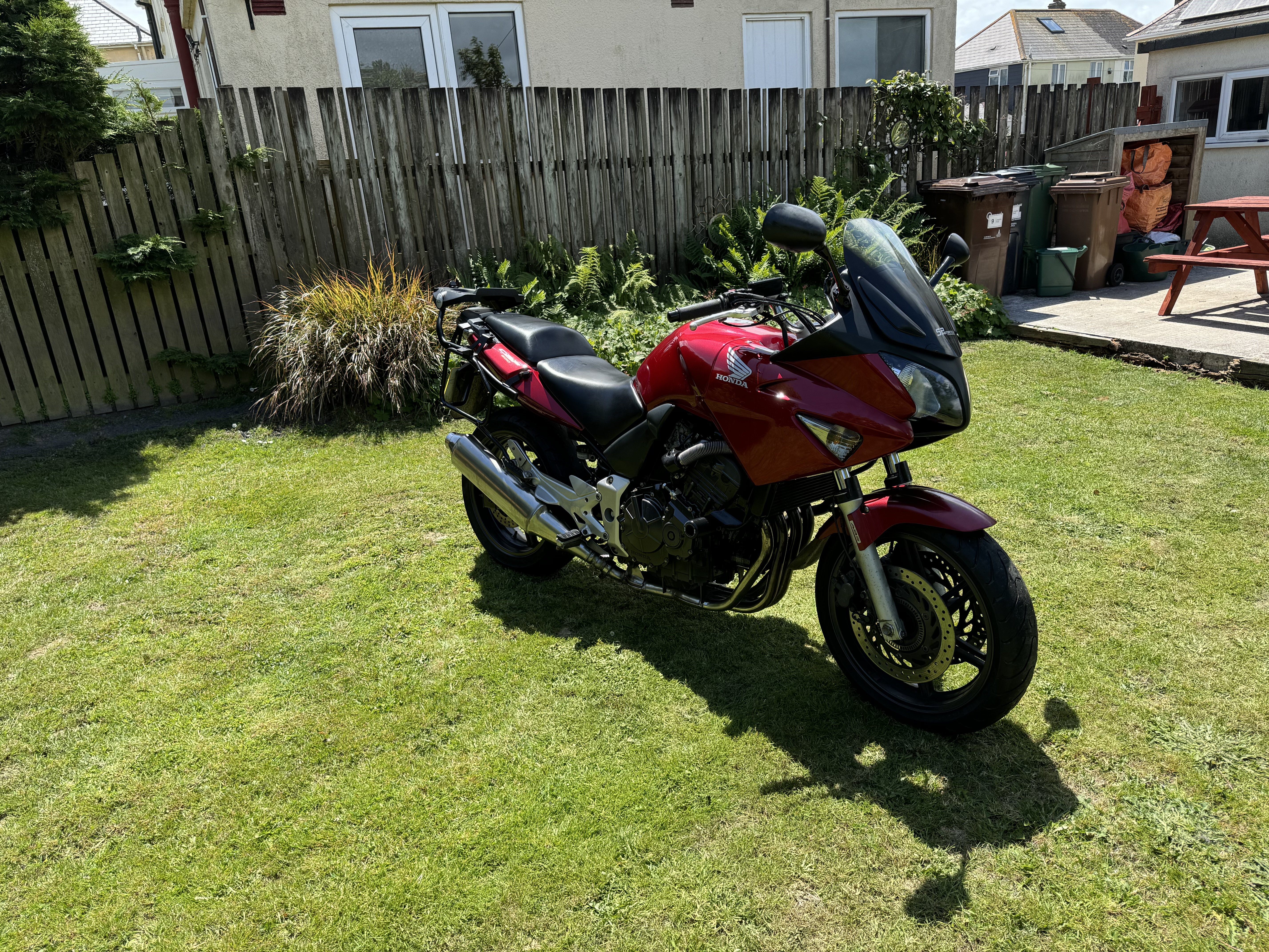

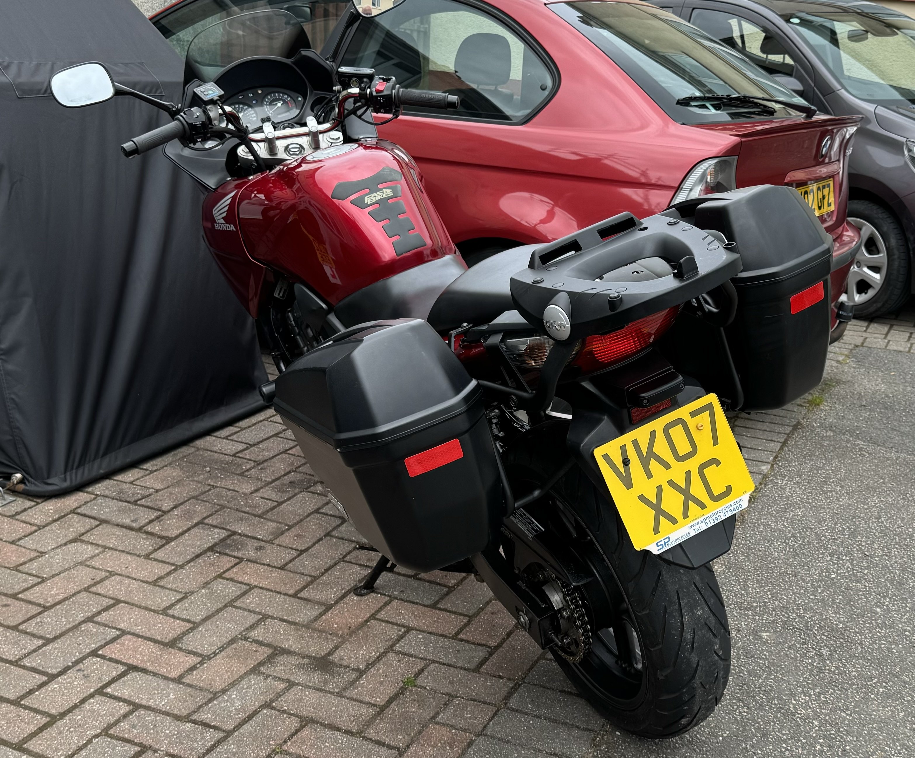

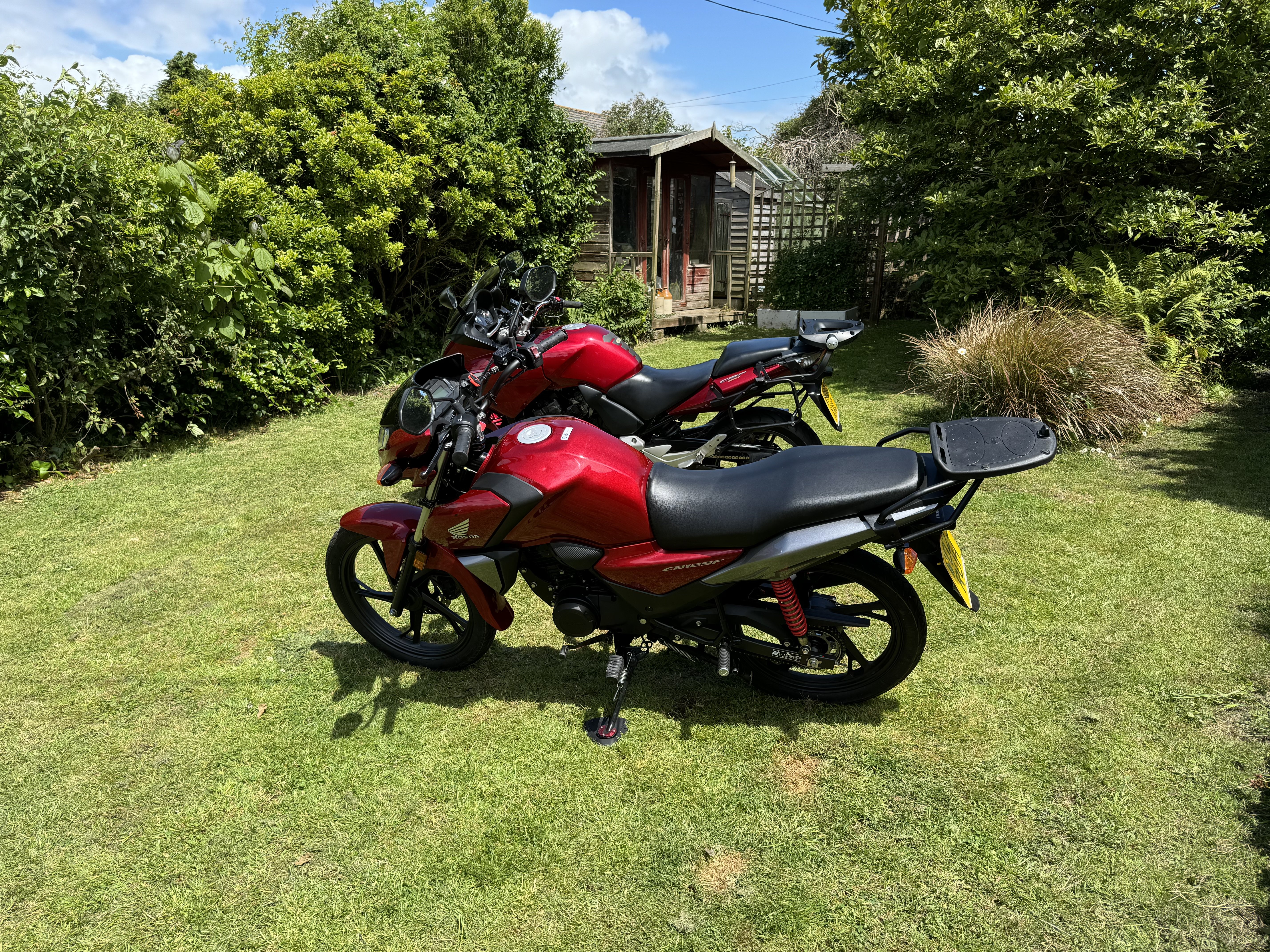

Saul Posted June 14, 2024 Share Posted June 14, 2024 Had my first attempt at cleaning the CBF600, still plenty to do but it is looking passable from a few feet. Just going for tidy as it has done 30k so has a few battle scars and I am not concerned with that but there is some dirty shit that has to go. EG the glue from old wheel balancing weights and such. I spent yesterday cleaning up the panniers and getting the old stickers off. Of course there is no show without punch as Shadow wanted her bike in the photos so she can show her mates what she is supposedly getting. Notice the red hair to match, not obsessed much Anyway she’s wasn’t on receive when I told her about tests and such. Be some time yet. 8 Link to comment Share on other sites More sharing options...
Buckster Posted June 14, 2024 Share Posted June 14, 2024 That's nice, a picture of both her bikes together. 3 Link to comment Share on other sites More sharing options...
Six30 Posted June 14, 2024 Share Posted June 14, 2024 looks a clean bike @Saul 1 1 Link to comment Share on other sites More sharing options...

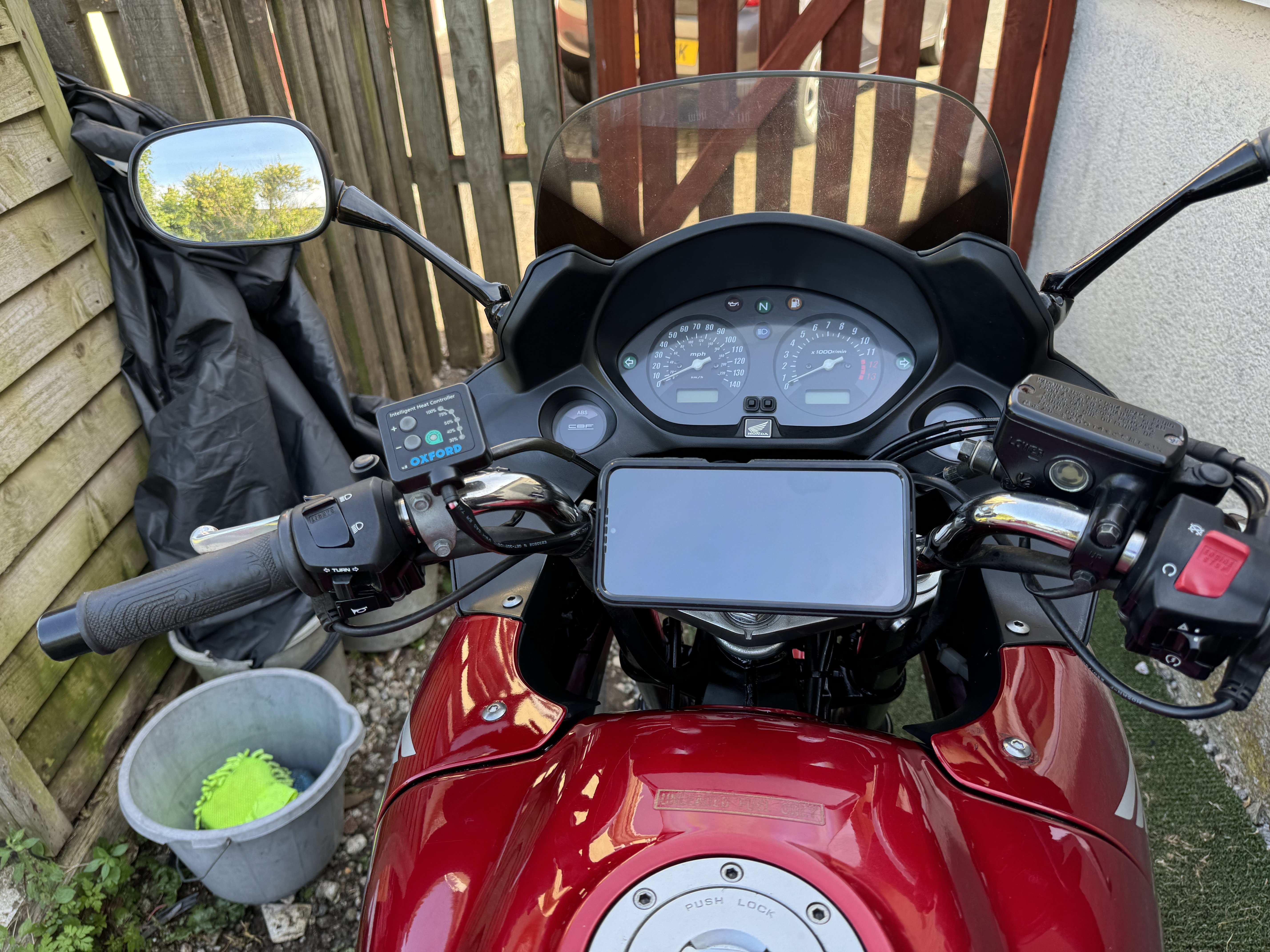

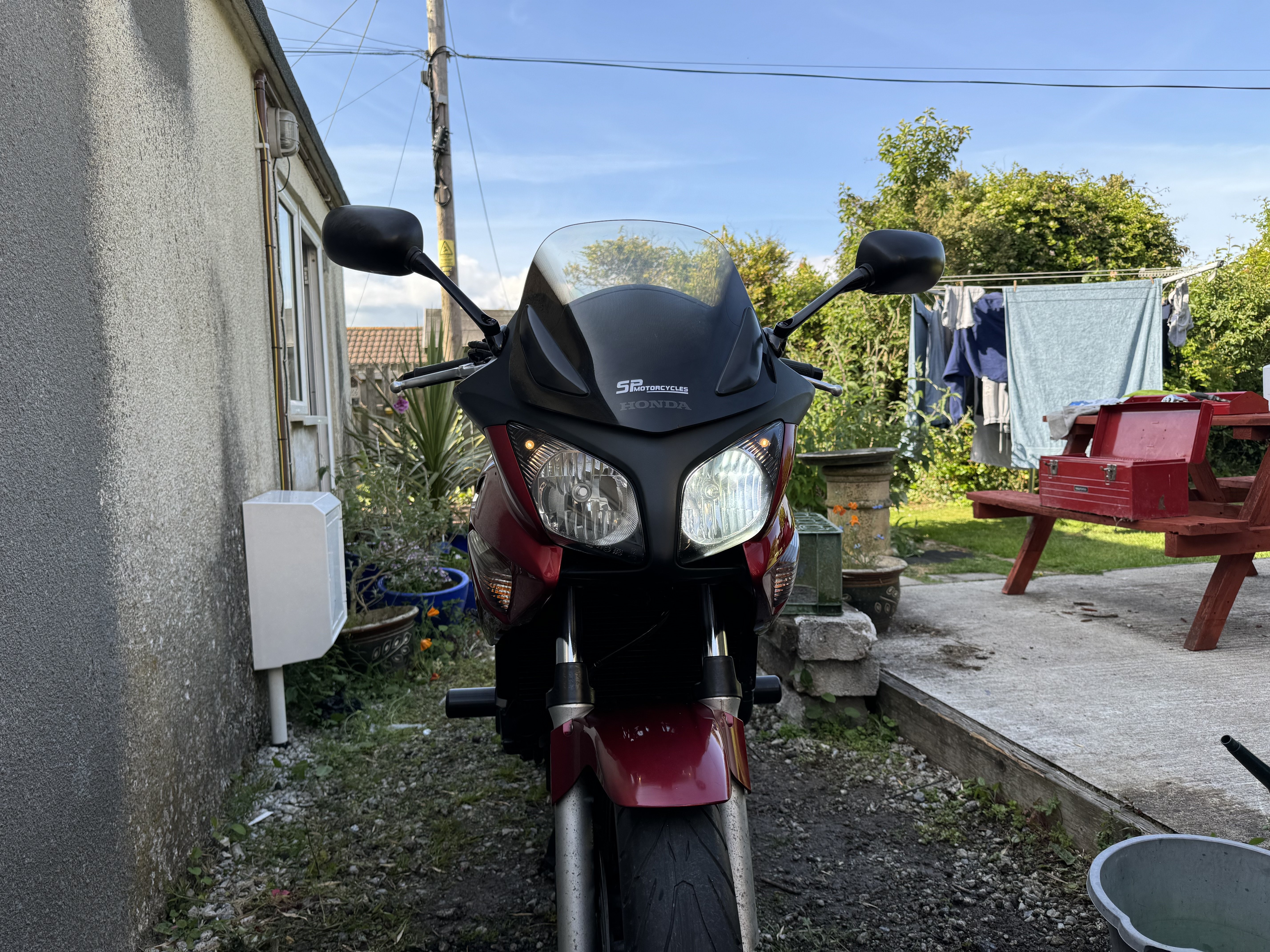

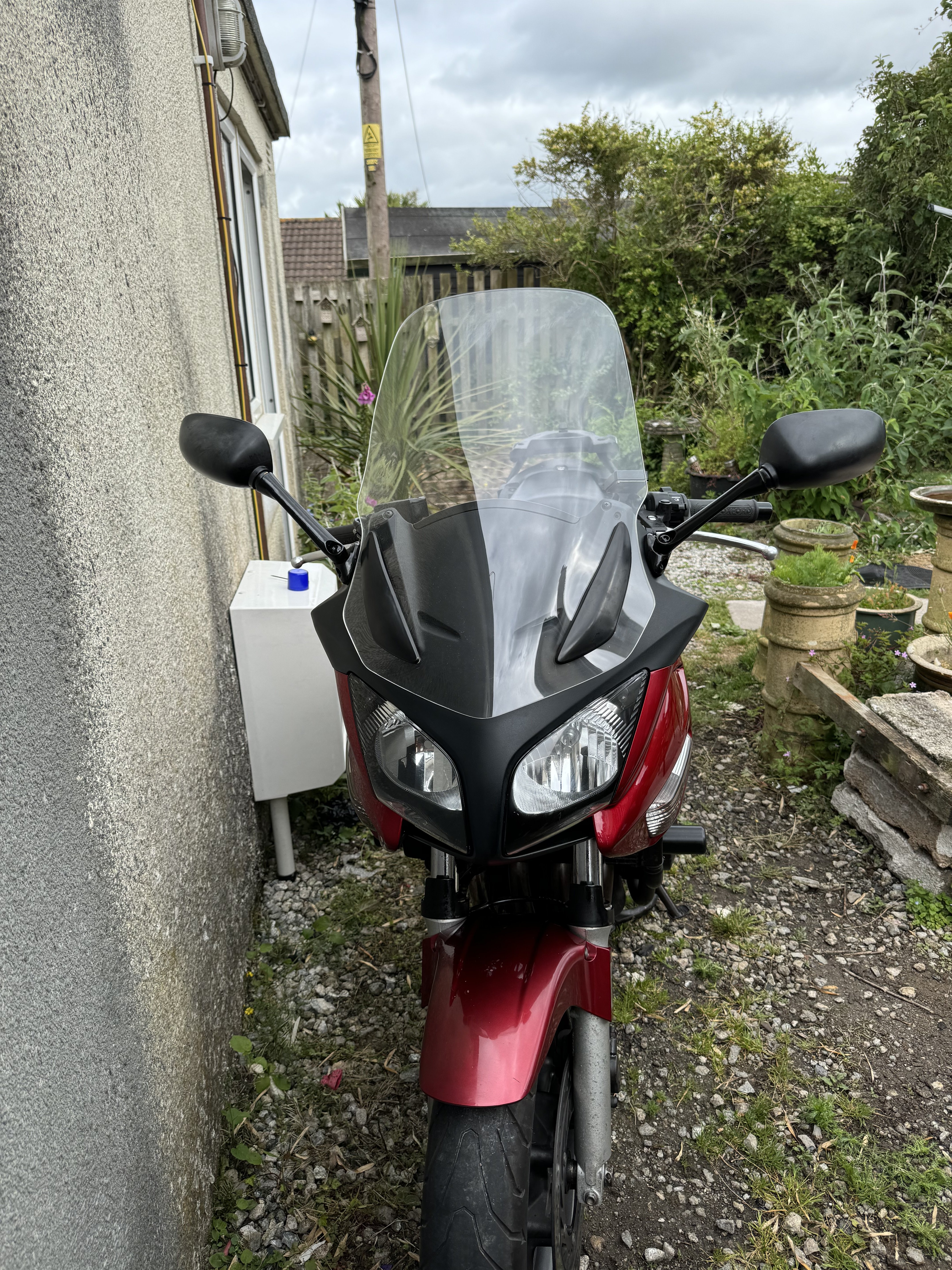

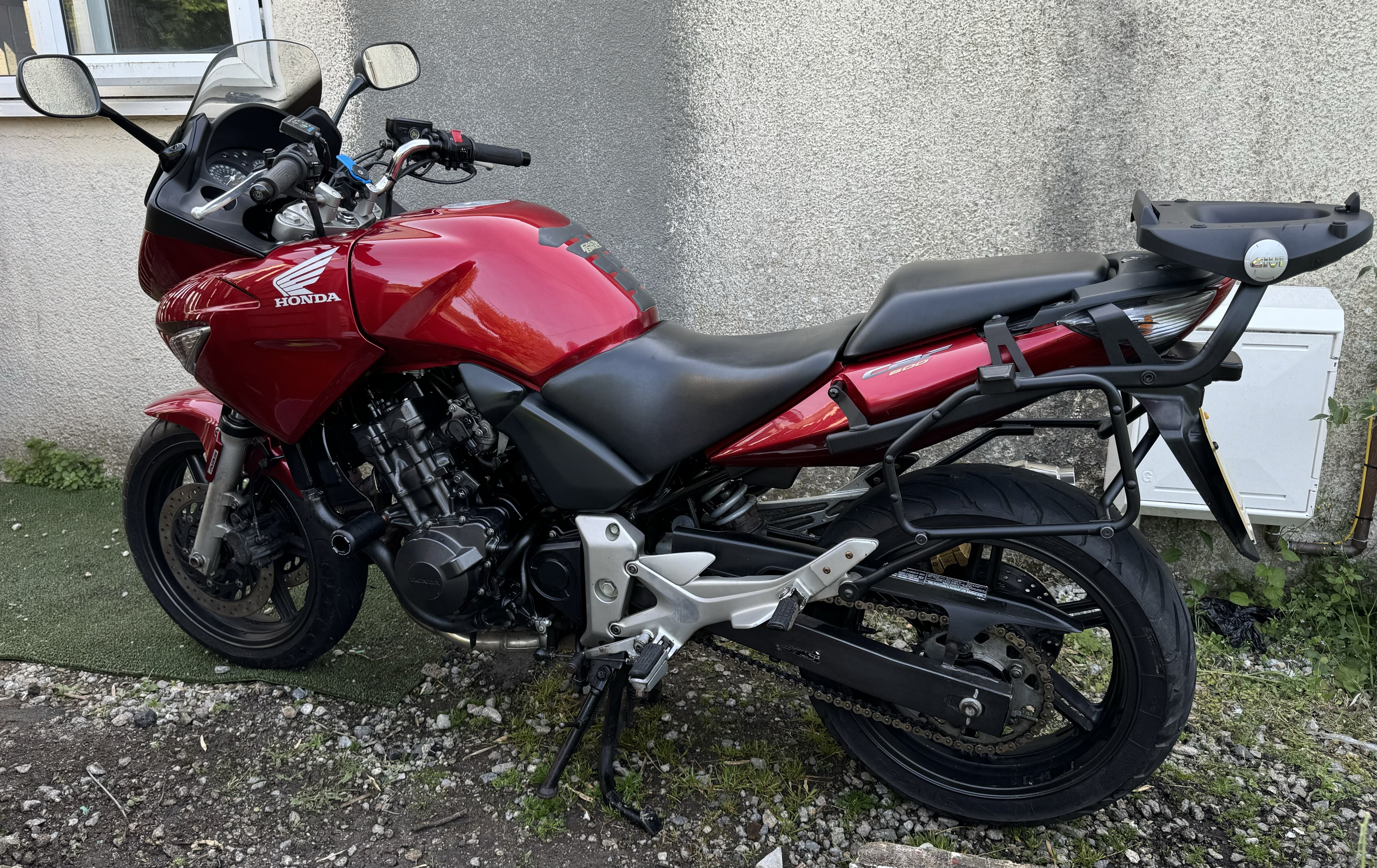

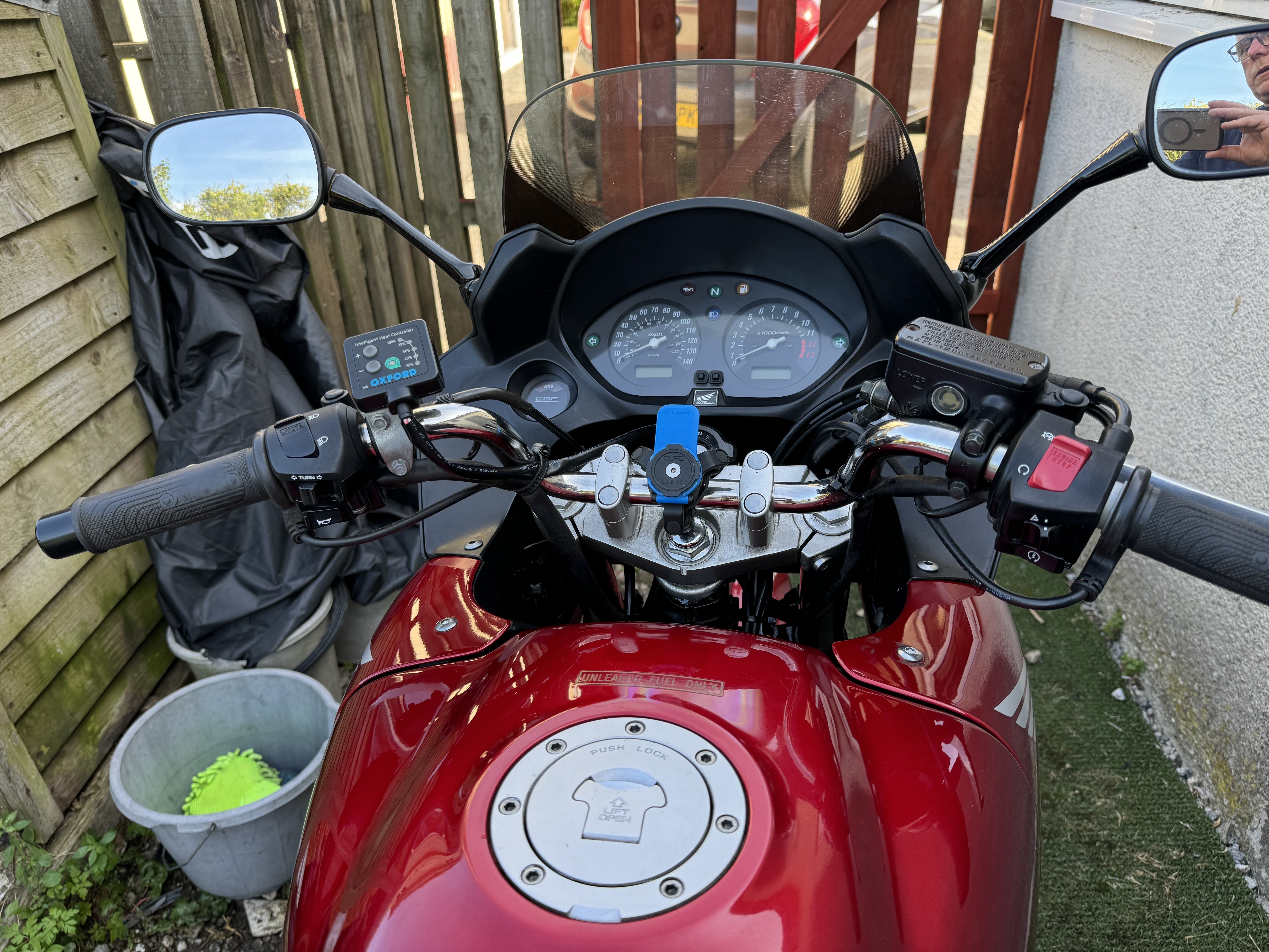

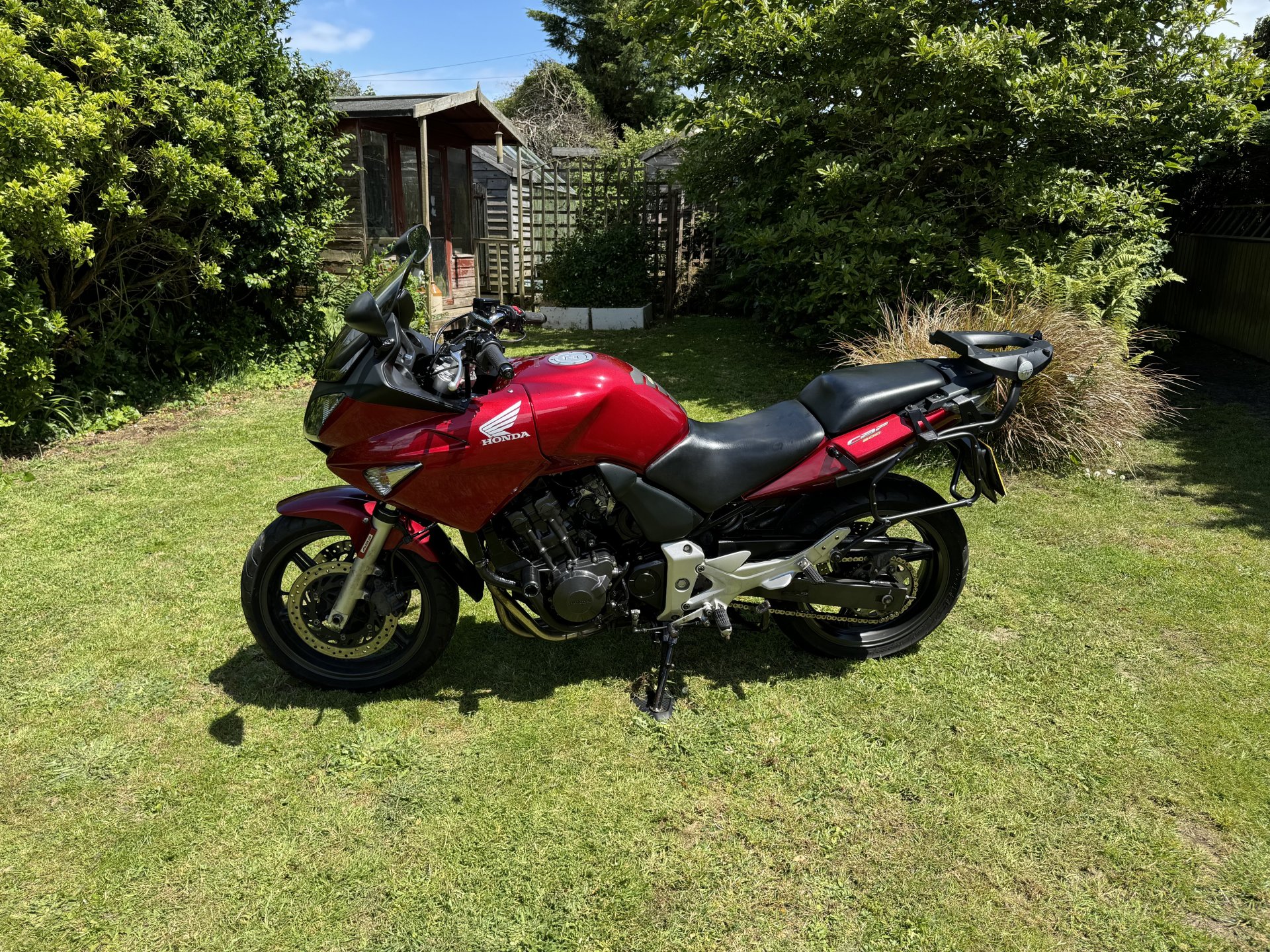

Saul Posted June 17, 2024 Author Share Posted June 17, 2024 After my night shift Kip I set about playing bikes for the afternoon. Nothing fancy really just put in some LED headlights and fitted my Quadlock along with some obsessive cleaning especially under the front fairings. I need to get some LED bulbs for the marker lights but all in good time. I am really enjoying getting this bike back to presentable, I don’t think it has been thoroughly cleaned in years just serviced and ridden. But there is something about polishing a turd and bringing it back that is quite fulfilling. It rode without fault for my work commutes over the weekend. Even used the heated grips this morning coming home. Just gotta do something about those ditch finder tyres. This side on shot shows there is still plenty to do to tidy up. This thread would have been perfect for Pete what with Hondas and obsessive cleaning 5 Link to comment Share on other sites More sharing options...
boboneleg Posted June 17, 2024 Share Posted June 17, 2024 Typical Honda fork lowers. What you could do with those is rub them down with fine wet & dry paper , spray silver and then lacquer . The alternative method is to ship them off to SIX30 wheel painting services Ltd , although I wouldn't guarantee the work 7 Link to comment Share on other sites More sharing options...
Saul Posted June 17, 2024 Author Share Posted June 17, 2024 16 minutes ago, boboneleg said: Typical Honda fork lowers. What you could do with those is rub them down with fine wet & dry paper , spray silver and then lacquer . The alternative methos is to ship them off to SIX30 wheel painting services Ltd , although I wouldn't guarantee the work It's already on the to do list, along with taking the rear swing arm out and repainting that . I had a nice surprise when I took the front side fairings off as I had a clear shot at the fork tubes that I thought were rusty and pitted, turns out that it was mummified flies. Some WD and a cloth and off they came. The tubes look pretty bloody good. Obviously been regularly sprayed with something to prevent pitting. 4 Link to comment Share on other sites More sharing options...
Saul Posted June 17, 2024 Author Share Posted June 17, 2024 6 minutes ago, Marcel le Moose Fondler said: Is this cosmetic damage from winter use or just being kept outside Saul ? I am guessing all year use. I think there was plenty of preventive maintenance over time as its not at all bad underneath the grime. I am only playing really, it's a £1100 winter hack I just like making it a bit nicer. 2 Link to comment Share on other sites More sharing options...

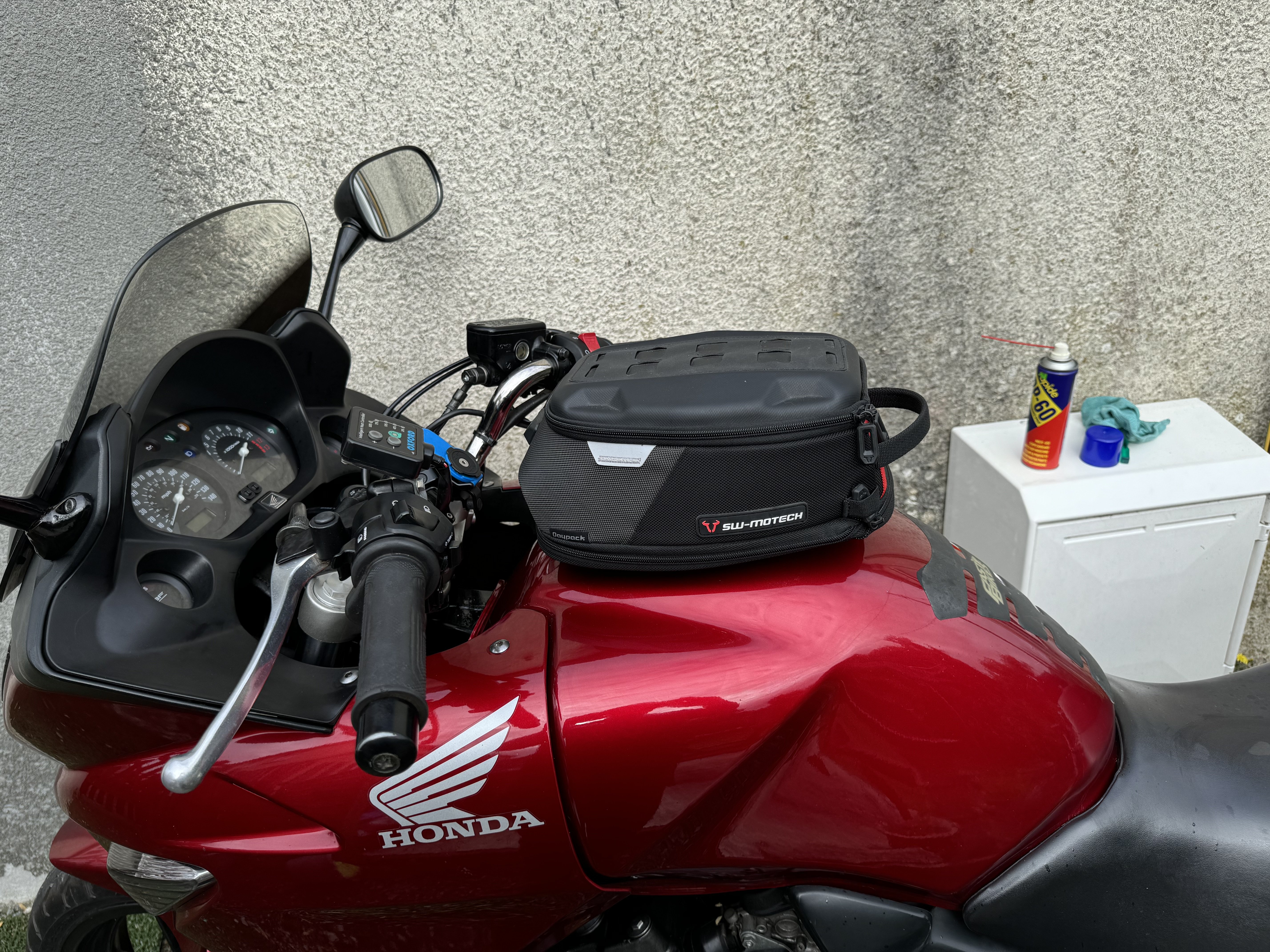

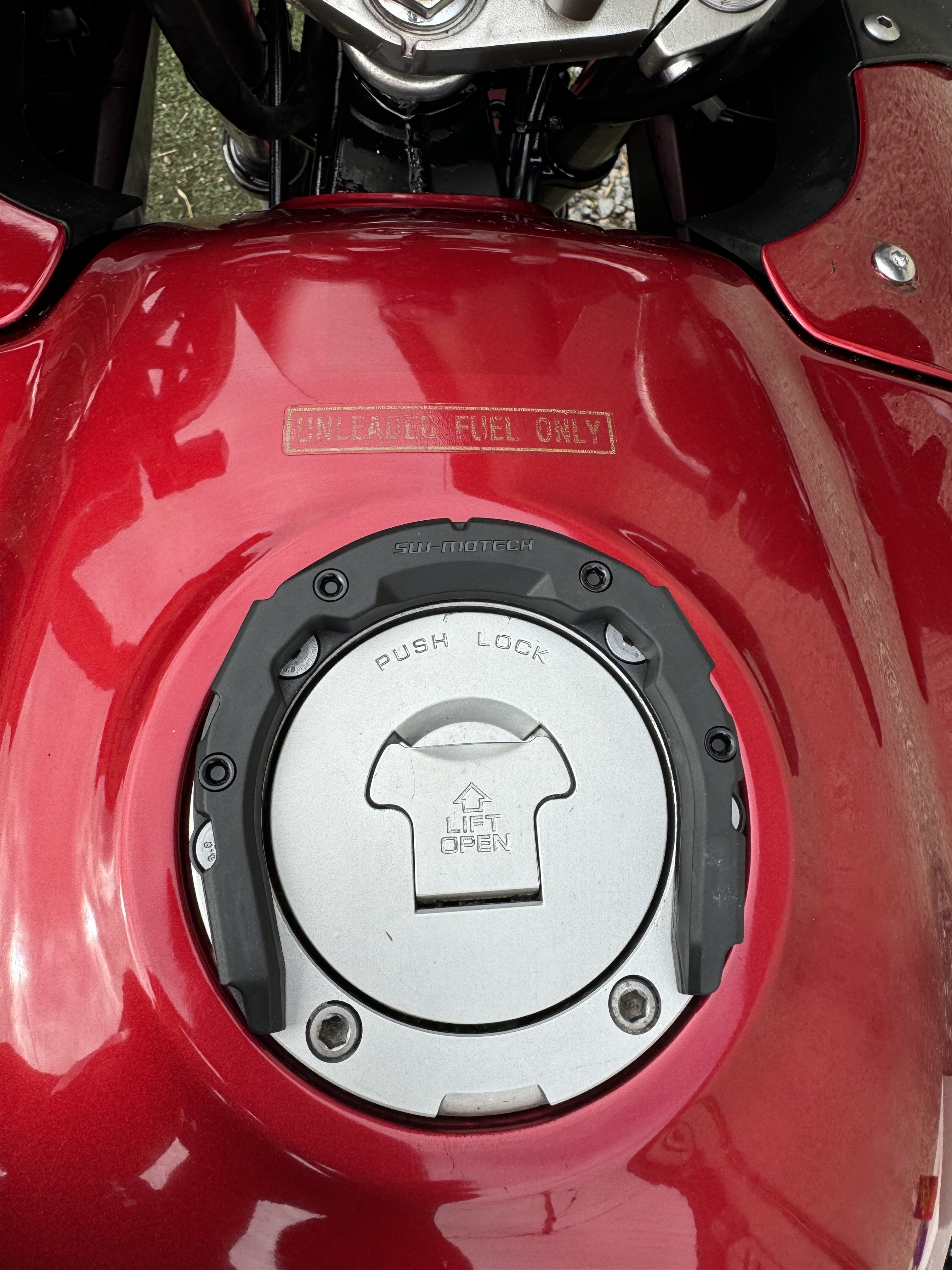

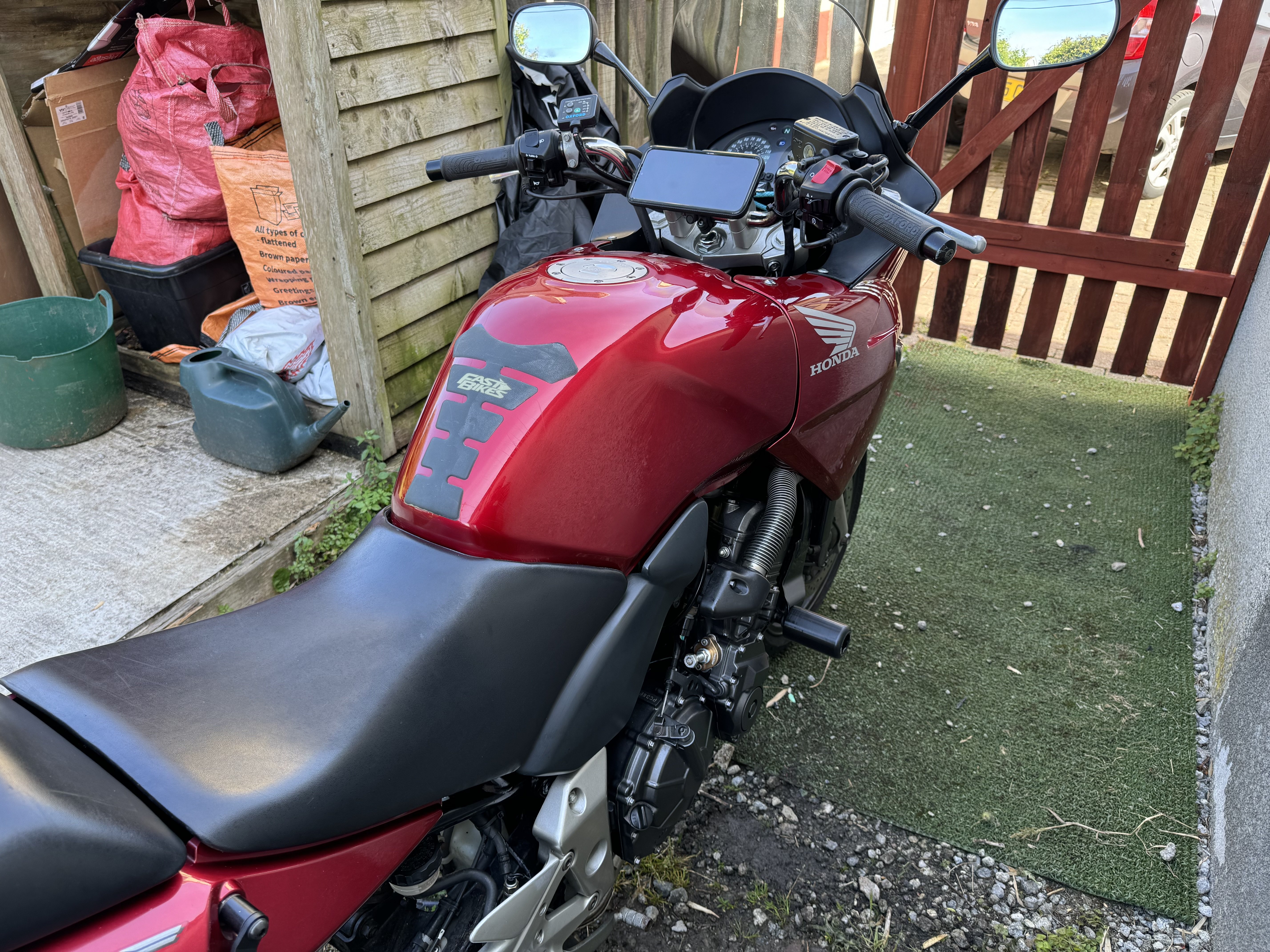

Saul Posted June 22, 2024 Author Share Posted June 22, 2024 Some goodies turned up yesterday so had a play this morning. I had the tank bag already but had to get a second ring so that I can use it on this bike. Also getting a lot of buffeting and turbulent air off the standard screen so got a taller one to see how that goes. 4 Link to comment Share on other sites More sharing options...

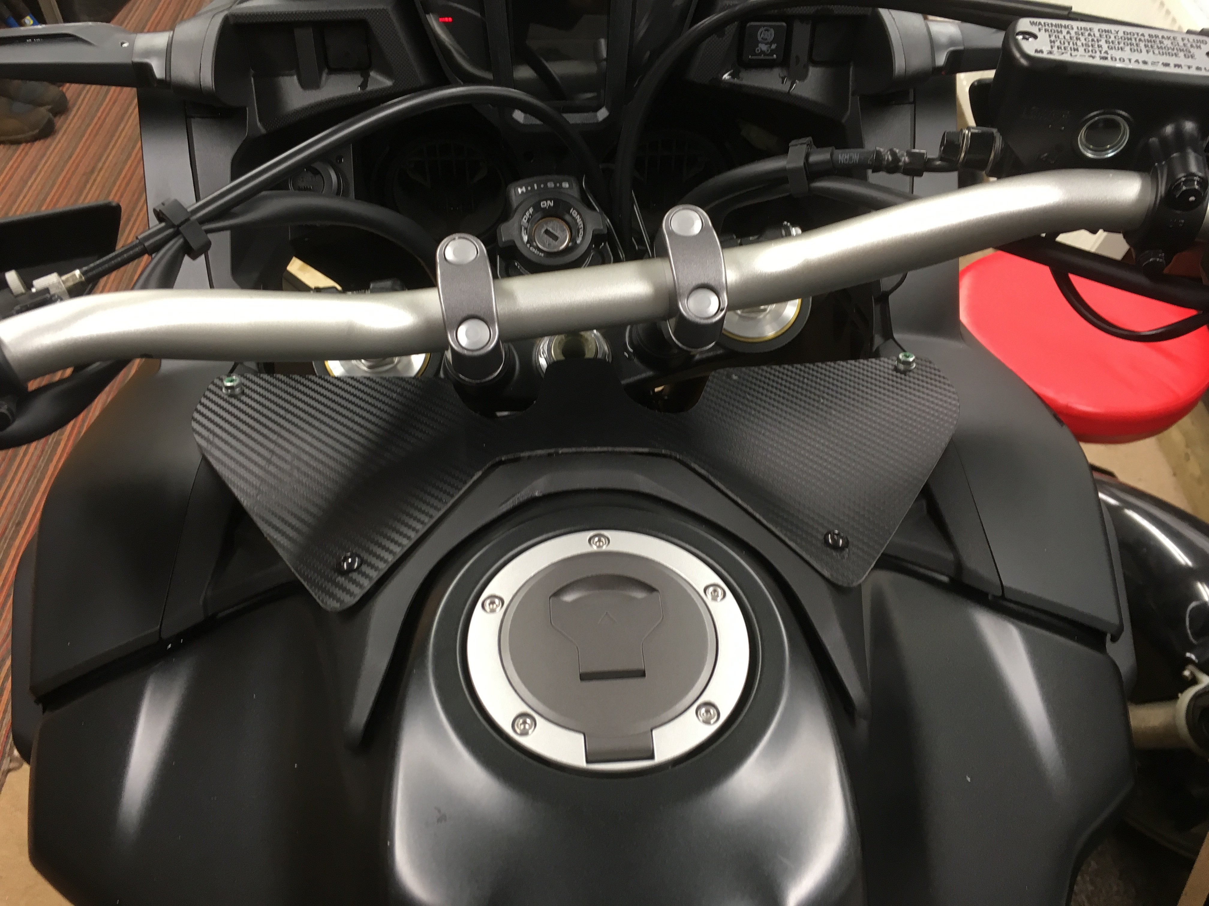

Sir Fallsalot Posted June 22, 2024 Share Posted June 22, 2024 45 minutes ago, Saul said: Also getting a lot of buffeting and turbulent air off the standard screen so got a taller one to see how that goes. If your still getting buffeting and turbulent air try blocking the space between the forks and fuel tank my Africa Twin would have the peak on my helmet vibrating like hell and found it to be air coming up through there although your tank bag looks like it may stop that I made this to stop it on my bike, they are available to buy now for the Africa twin 2 Link to comment Share on other sites More sharing options...
Saul Posted June 22, 2024 Author Share Posted June 22, 2024 I will get back to you to see how I get on with and without the tank bag and the new screen. Sure I could make something similar if need be. I remember my old BMW R100RS had bellows type gaiters between the fairing and fork tubes and I always thought that was just about water but looking back it obviously blocked air as well. That RS fairing was bloody good, very quiet and dry place to be even in the pissing rain as long as you were moving. 2 Link to comment Share on other sites More sharing options...

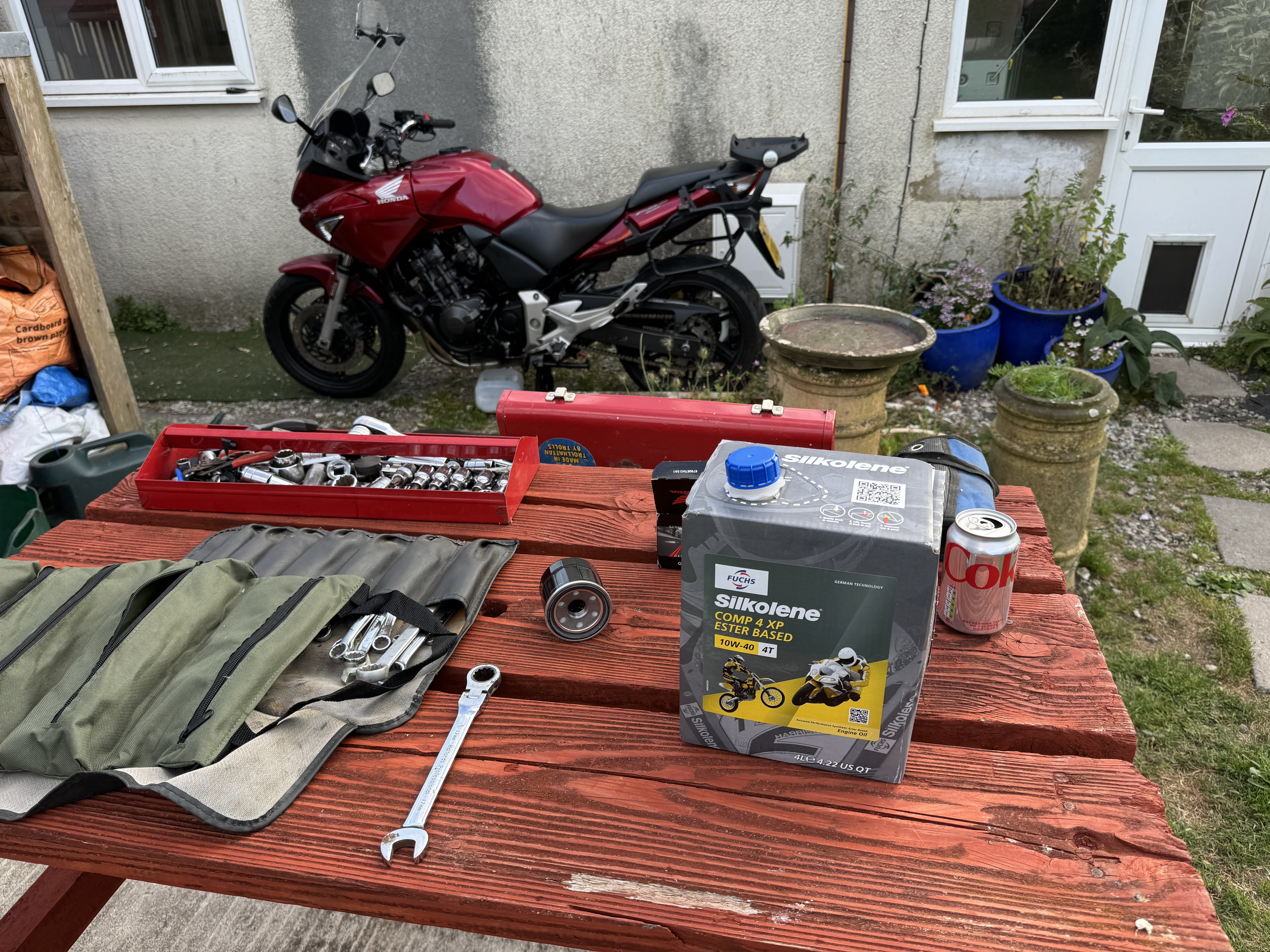

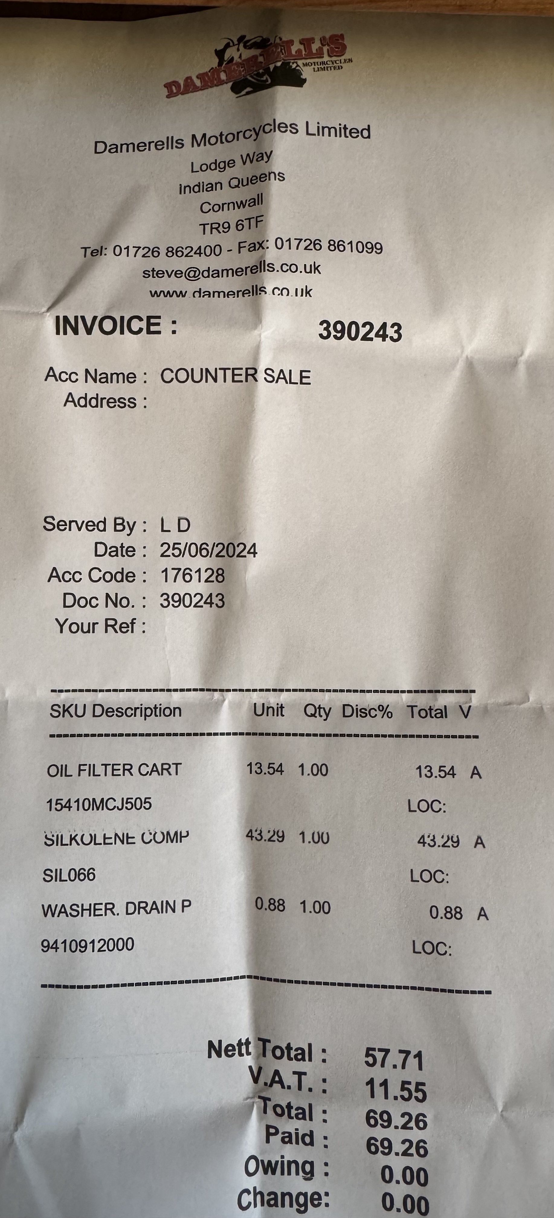

Saul Posted June 25, 2024 Author Share Posted June 25, 2024 Blood transfusion day. I was checking back through the CBF’s service history and its last oil change was at 28k and it’s now cracked 32k. Shouldn’t be a problem as the service intervals are 8k I thought until I checked and the last service in the book was done in 2019. Anyway I dropped into Dameralls today so picked up a filter, oil and crush washer. It was £69 fucking quid. Every fibre in my being wanted to say stick it up your pipe but I think more in shock than anything I just paid up and left. Won’t be buying it there again. Anyway did the deed tonight when the sun went in. Why are the sump plug and filter always done up with fucking gorilla strength FFS. It’s lucky I have the proper Honda filter tool as I genuinely don’t think I could have gotten the old filter off without it. 4 Link to comment Share on other sites More sharing options...
Sir Fallsalot Posted June 25, 2024 Share Posted June 25, 2024 1 hour ago, Saul said: Blood transfusion day. I was checking back through the CBF’s service history and its last oil change was at 28k and it’s now cracked 32k. Shouldn’t be a problem as the service intervals are 8k I thought until I checked and the last service in the book was done in 2019. Anyway I dropped into Dameralls today so picked up a filter, oil and crush washer. It was £69 fucking quid. Every fibre in my being wanted to say stick it up your pipe but I think more in shock than anything I just paid up and left. Won’t be buying it there again. Anyway did the deed tonight when the sun went in. Why are the sump plug and filter always done up with fucking gorilla strength FFS. It’s lucky I have the proper Honda filter tool as I genuinely don’t think I could have gotten the old filter off without it. I had one filter so tight i snapped the nut off the Honda filter tool, i had to fully weld it back on instead of the spot welding they come with to get it to undo the filter 2 Link to comment Share on other sites More sharing options...
Sir Fallsalot Posted June 25, 2024 Share Posted June 25, 2024 2 minutes ago, Marcel le Moose Fondler said: I find the oil is at a fair price ...compared to what I'm paying for the indian...the kit comes with 5 L. But you actually need almost 6 to bring it to the full mark... That converts to about £87 here but our tractor oil is a lot cheaper 3 Link to comment Share on other sites More sharing options...
