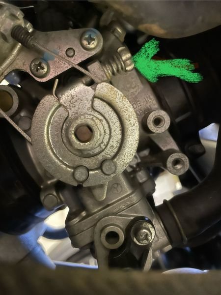

Six30 Posted June 29, 2024 Share Posted June 29, 2024 Xt keeps cutting out when slowing down at junctions etc... does not do it every time .... bumps and starts straight back up and on starter if going to slow to bump. put new air filter and spark plug in it , still doing it , tick over is fine and runs spot on .... any thoughts on the cause , i have read it is a common thing on the xt but cant find any answers really. Link to comment Share on other sites More sharing options...
boboneleg Posted June 29, 2024 Share Posted June 29, 2024 31 minutes ago, Six30 said: Xt keeps cutting out when slowing down at junctions etc... does not do it every time .... bumps and starts straight back up and on starter if going to slow to bump. put new air filter and spark plug in it , still doing it , tick over is fine and runs spot on .... any thoughts on the cause , i have read it is a common thing on the xt but cant find any answers really. Is it carbed or injection ? Link to comment Share on other sites More sharing options...
Six30 Posted June 29, 2024 Author Share Posted June 29, 2024 10 minutes ago, boboneleg said: Is it carbed or injection ? injection Link to comment Share on other sites More sharing options...
Pedro Posted June 29, 2024 Share Posted June 29, 2024 Remap it to suit that silly exhaust. Link to comment Share on other sites More sharing options...
boboneleg Posted June 29, 2024 Share Posted June 29, 2024 58 minutes ago, Six30 said: injection On the side of the throttle body you should see a screw, you can turn this to adjust your tickover. Big singles need a slightly higher tickover than most bikes or they are prone to a cough/stall especially when coming to a stop . 4 Link to comment Share on other sites More sharing options...
Six30 Posted June 29, 2024 Author Share Posted June 29, 2024 17 minutes ago, boboneleg said: On the side of the throttle body you should see a screw, you can turn this to adjust your tickover. Big singles need a slightly higher tickover than most bikes or they are prone to a cough/stall especially when coming to a stop . i'll go try it , cheers bob 2 Link to comment Share on other sites More sharing options...
Six30 Posted June 29, 2024 Author Share Posted June 29, 2024 23 minutes ago, boboneleg said: On the side of the throttle body you should see a screw, you can turn this to adjust your tickover. Big singles need a slightly higher tickover than most bikes or they are prone to a cough/stall especially when coming to a stop . wouldn't t it cut out all the time bob if tick over was not high enough... tick over is ok when bike is ticking over Link to comment Share on other sites More sharing options...
boboneleg Posted June 29, 2024 Share Posted June 29, 2024 1 minute ago, Six30 said: wouldn't t it cut out all the time bob if tick over was not high enough... tick over is ok when bike is ticking over Generally if you run the tickover a bit higher than normal it was stop the stalling . 2 Link to comment Share on other sites More sharing options...
Sir Fallsalot Posted June 29, 2024 Share Posted June 29, 2024 Welcome to the big single club 3 Link to comment Share on other sites More sharing options...
Six30 Posted June 29, 2024 Author Share Posted June 29, 2024 37 minutes ago, boboneleg said: Generally if you run the tickover a bit higher than normal it was stop the stalling . found the screw and turned up tickover , was going to go out on bmw tomorrow but xt now see if its cured it 4 Link to comment Share on other sites More sharing options...
boboneleg Posted June 29, 2024 Share Posted June 29, 2024 17 minutes ago, Six30 said: found the screw and turned up tickover , was going to go out on bmw tomorrow but xt now see if its cured it Let us know how you get on , take the screwdriver with you incase you have to make any adjustments. 3 Link to comment Share on other sites More sharing options...
Six30 Posted June 29, 2024 Author Share Posted June 29, 2024 13 minutes ago, boboneleg said: Let us know how you get on , take the screwdriver with you incase you have to make any adjustments. .... could do it by hand ... 2 Link to comment Share on other sites More sharing options...
boboneleg Posted June 29, 2024 Share Posted June 29, 2024 3 minutes ago, Six30 said: .... could do it by hand ... Ok, completely different set up to my WR250 where the adjuster screw is on the throttle body 2 Link to comment Share on other sites More sharing options...
