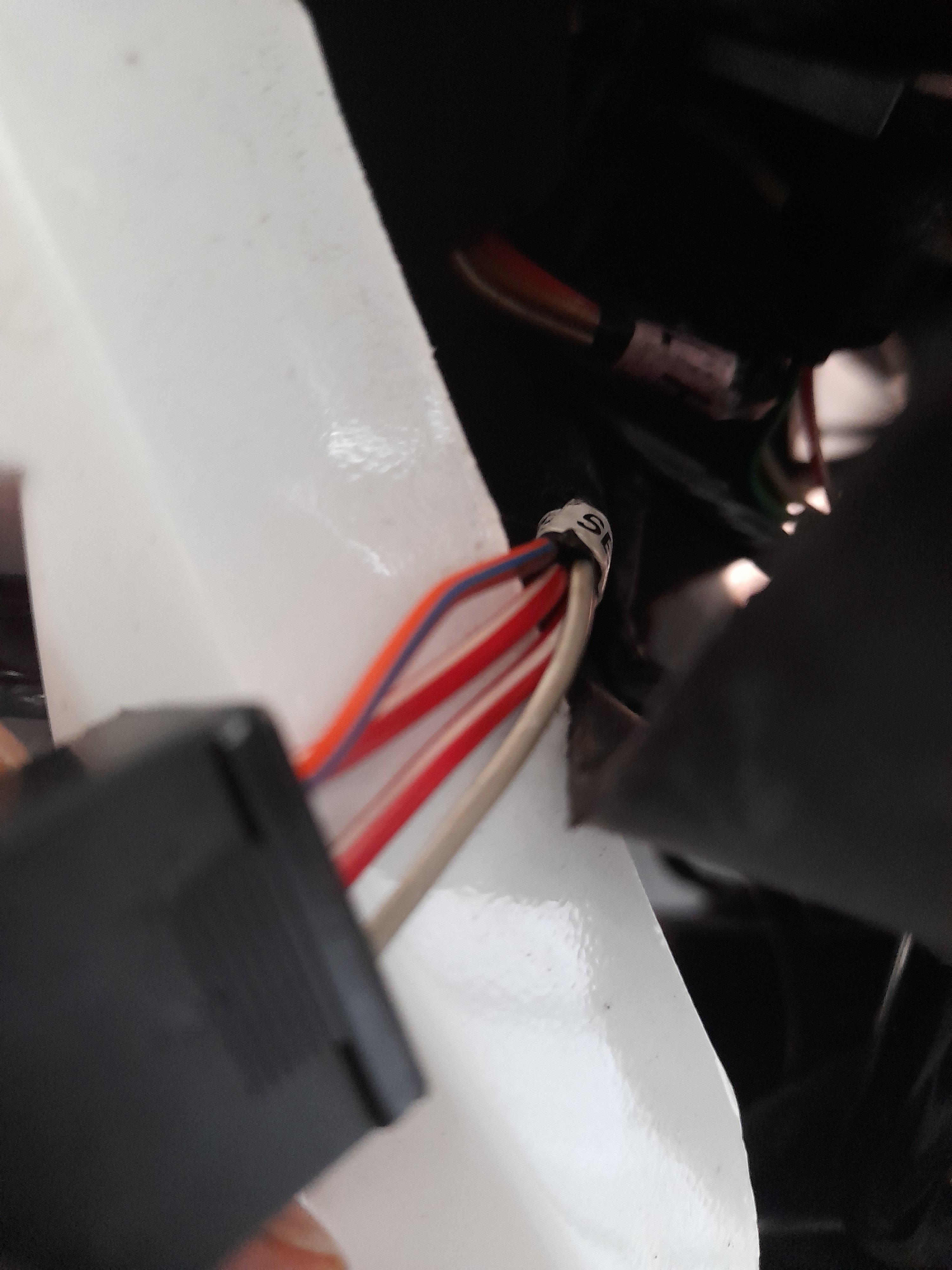

Clive Posted August 10, 2024 Author Share Posted August 10, 2024 A bit better one. 1 Link to comment Share on other sites More sharing options...
Sir Fallsalot Posted August 10, 2024 Share Posted August 10, 2024 9 minutes ago, Clive said: A bit better one. You could have just told me the colours Clive a photo is fine though lol Are the two red with a white stripe wires the ones with 12v on them 1 Link to comment Share on other sites More sharing options...
Clive Posted August 10, 2024 Author Share Posted August 10, 2024 Just now, Sir Fallsalot said: You could have just told me the colours Clive a photo is fine though lol Are the two red with a white stripe wires the ones with 12v on them Yep., but as soon as I connected either of the other wires the fuse blew. 1 Link to comment Share on other sites More sharing options...
Sir Fallsalot Posted August 10, 2024 Share Posted August 10, 2024 5 minutes ago, Clive said: Yep., but as soon as I connected either of the other wires the fuse blew. Can you see what colour wires go to the seat actuator or whatever releases the seat 1 Link to comment Share on other sites More sharing options...

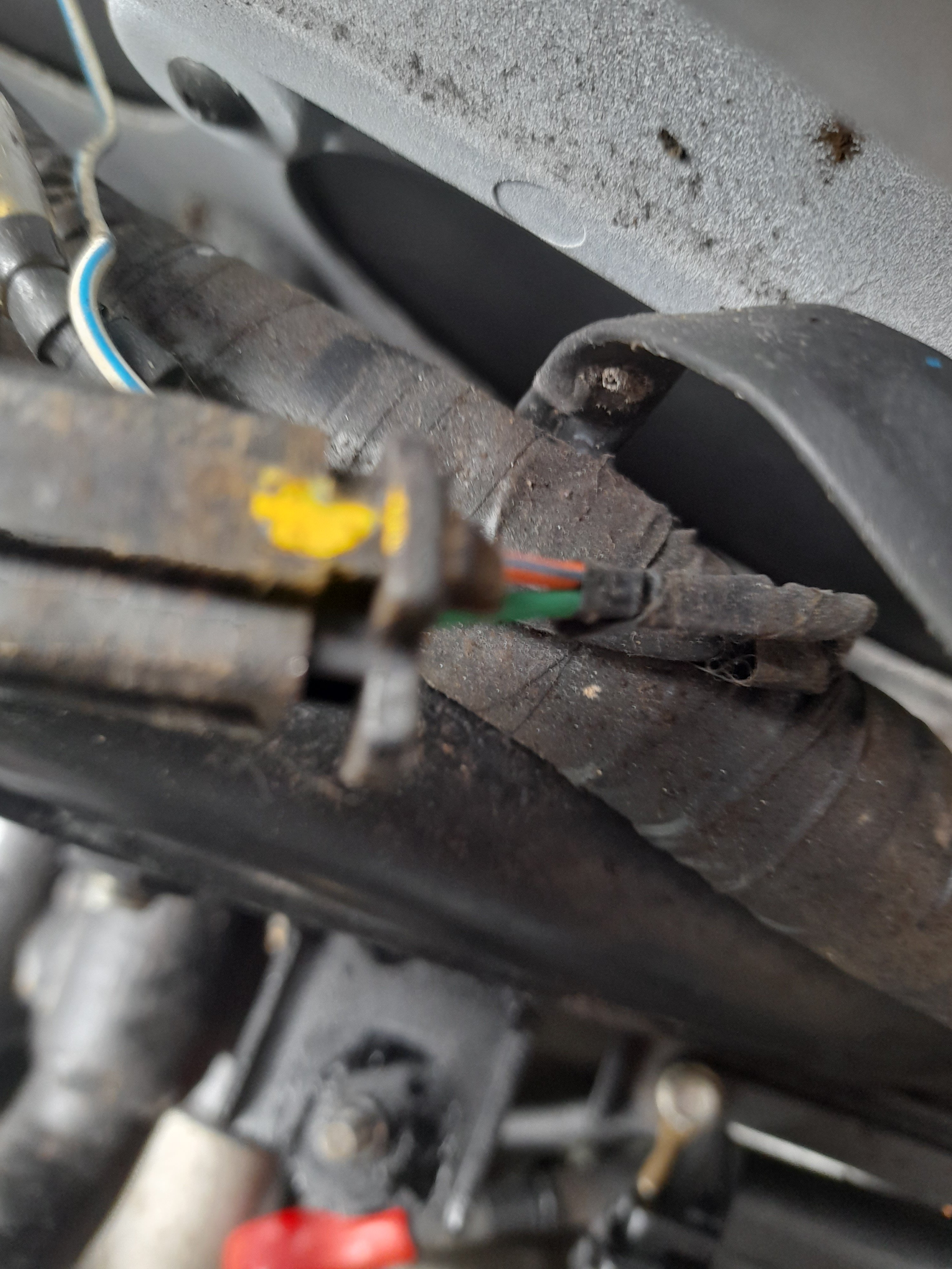

Clive Posted August 10, 2024 Author Share Posted August 10, 2024 6 minutes ago, Sir Fallsalot said: Can you see what colour wires go to the seat actuator or whatever releases the seat I would have to remove the seat tub, because the solenoid is hiding under there, let you know later. Thanks for the help. Now where is that fire extinguisher 1 Link to comment Share on other sites More sharing options...
Sir Fallsalot Posted August 10, 2024 Share Posted August 10, 2024 24 minutes ago, Clive said: I would have to remove the seat tub, because the solenoid is hiding under there, let you know later. Thanks for the help. Now where is that fire extinguisher Just a thought Clive are any of the other relays the same as the seat one. if yes you could swap them to try. the problem might be the solenoid not the relay Link to comment Share on other sites More sharing options...

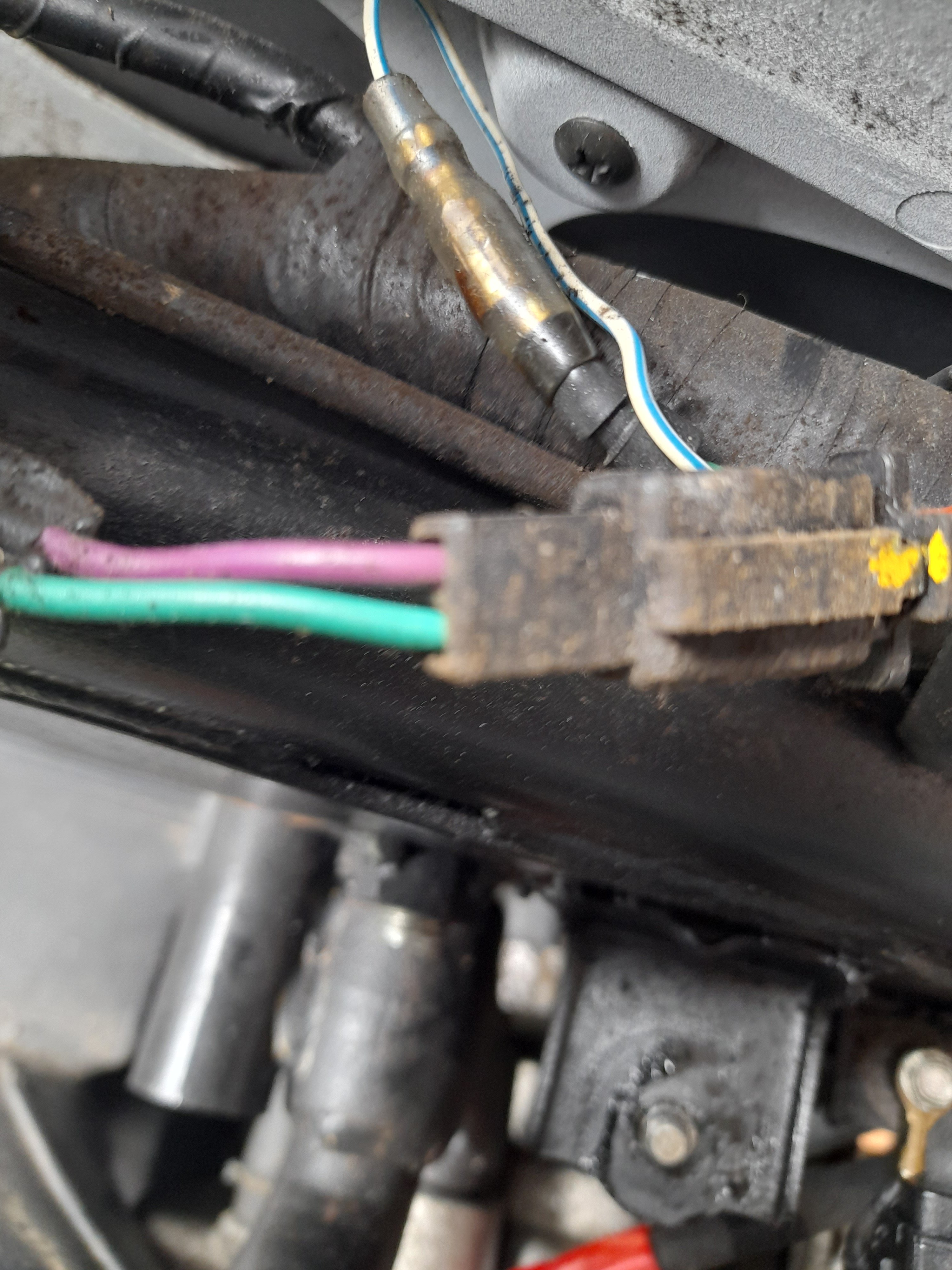

Clive Posted August 10, 2024 Author Share Posted August 10, 2024 5 minutes ago, Sir Fallsalot said: Just a thought Clive are any of the other relays the same as the seat one. if yes you could swap them to try. the problem might be the solenoid not the relay I did swap one of the relays, and yes the solenoid works, but it does not say on any of the relays as to what they are rated at. .... 1 is for the for the seat...another for the FI, the others are lights, starter and cooling fan and hazard lights.... apart from the starter relay they all look identical. These are the wire colours to the solenoid. Link to comment Share on other sites More sharing options...
Sir Fallsalot Posted August 10, 2024 Share Posted August 10, 2024 4 hours ago, Clive said: I did swap one of the relays, and yes the solenoid works, but it does not say on any of the relays as to what they are rated at. .... 1 is for the for the seat...another for the FI, the others are lights, starter and cooling fan and hazard lights.... apart from the starter relay they all look identical. These are the wire colours to the solenoid. If that's Orange with a blue stripe looks sort of grey in the photo then i would wire the relay like this. I'm presuming the button you press to unlock the seat grounds the coil of the relay not power it up that's why there are two wires with 12v on them i think 2 Link to comment Share on other sites More sharing options...
