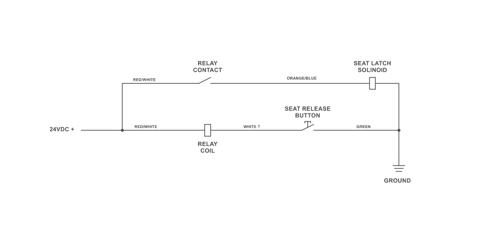

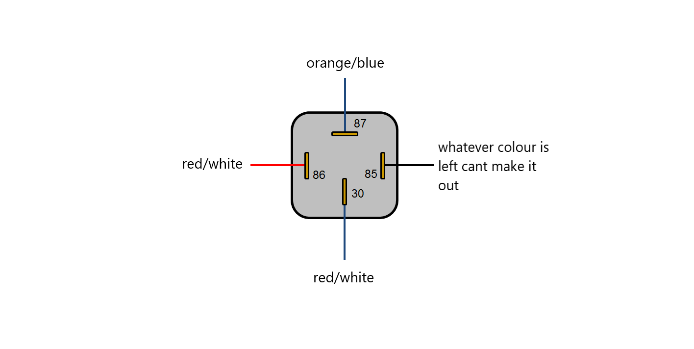

Clive Posted August 10, 2024 Author Share Posted August 10, 2024 10 minutes ago, Sir Fallsalot said: If that's Orange with a blue stripe looks sort of grey in the photo then i would wire the relay like this. I'm presuming the button you press to unlock the seat grounds the coil of the solenoid not power it up that's why there are two wires with 12v on them i think Thanks.....I will give a try after I have had some food.....let you know how I get on then 2 Link to comment Share on other sites More sharing options...
Sir Fallsalot Posted August 10, 2024 Share Posted August 10, 2024 9 minutes ago, Clive said: Thanks.....I will give a try after I have had some food.....let you know how I get on then This is how i see it wired in my head could be wrong though Link to comment Share on other sites More sharing options...
Clive Posted August 10, 2024 Author Share Posted August 10, 2024 11 minutes ago, Sir Fallsalot said: This is how i see it wired in my head could be wrong though That seems logical, looks quite straightforward in your diagram 1 Link to comment Share on other sites More sharing options...

Clive Posted August 10, 2024 Author Share Posted August 10, 2024 1 hour ago, Clive said: That seems logical, looks quite straightforward in your diagram Roughly wired it up, stood back...pressed the seat button!....and it worked! Will get some spade connectors tomorrow and make up a lead to connect the mismatched plugs. Cheers Fred.......have a virtual pint for your troubles. 6 Link to comment Share on other sites More sharing options...

Sir Fallsalot Posted August 10, 2024 Share Posted August 10, 2024 1 hour ago, Clive said: Roughly wired it up, stood back...pressed the seat button!....and it worked! Will get some spade connectors tomorrow and make up a lead to connect the mismatched plugs. Cheers Fred.......have a virtual pint for your troubles. Cool glad i done something useful today 1 2 Link to comment Share on other sites More sharing options...
