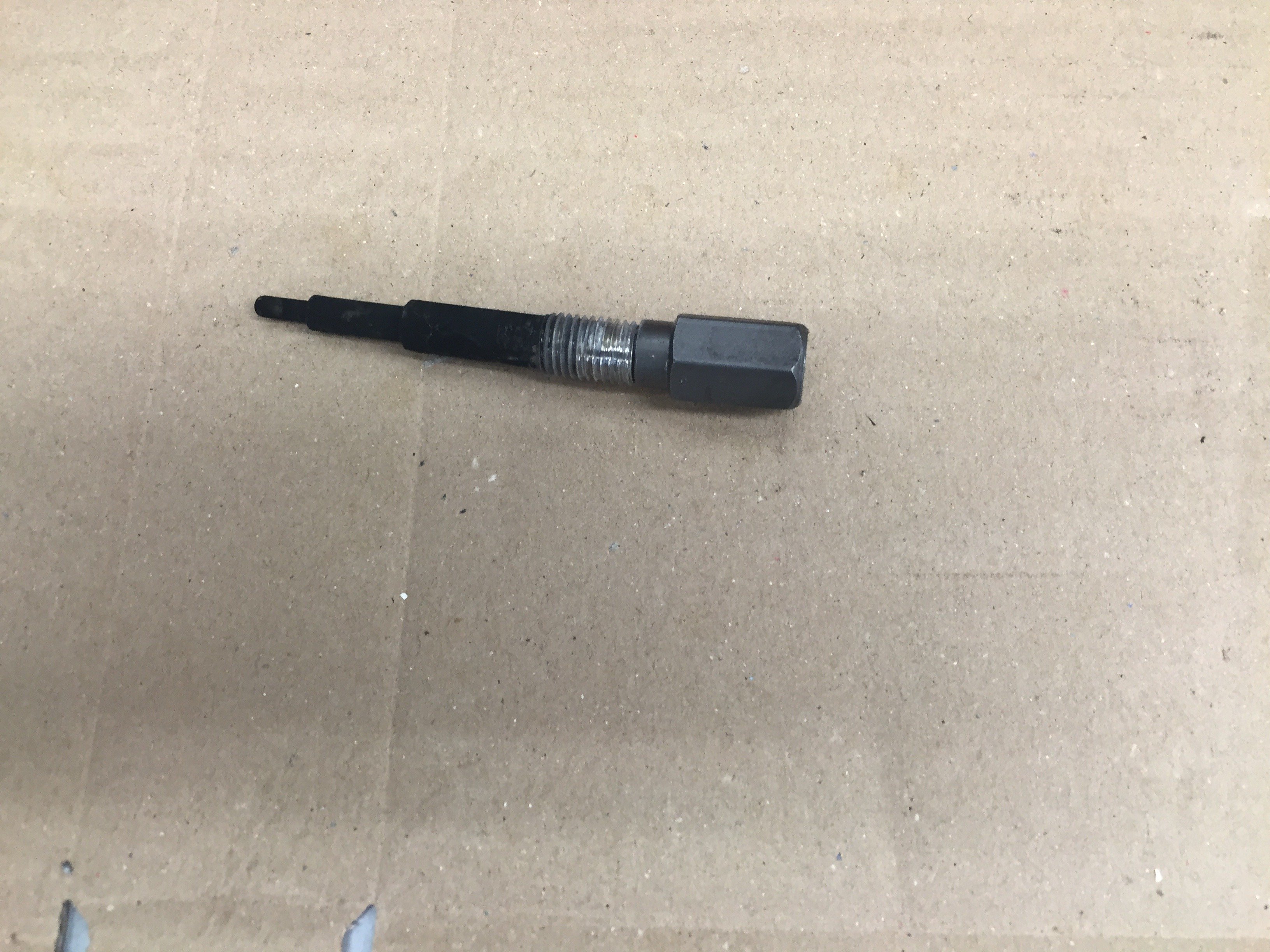

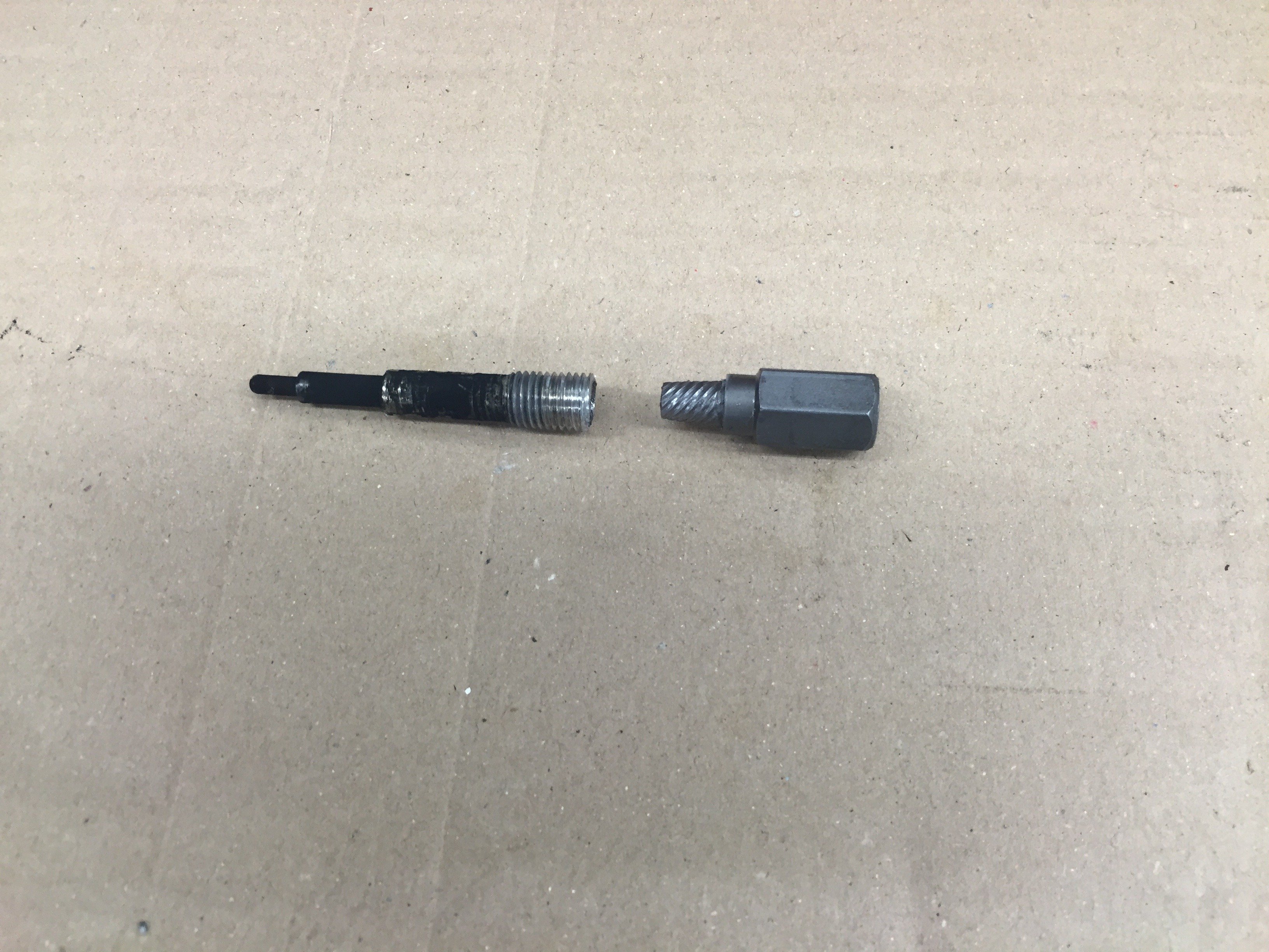

Sir Fallsalot Posted January 5 Share Posted January 5 I got a seized glow plug out of my old Toyota Surf with one of these years ago never thought they would ever work especially when i felt and heard the snap but luckily it was the glow plug breaking free and not the easy out snapping https://www.ebay.co.uk/itm/134983754614?chn=ps&_ul=GB&_trkparms=ispr%3D1&amdata=enc%3A1Dfzkyt6XQFu5r8csGgYDJg28&norover=1&mkevt=1&mkrid=710-134428-41853-0&mkcid=2&mkscid=101&itemid=134983754614&targetid=2425733423477&device=c&mktype=pla&googleloc=1007453&poi=&campaignid=21697391927&mkgroupid=162558106770&rlsatarget=pla-2425733423477&abcId=10027104&merchantid=101727036&gad_source=1&gclid=CjwKCAiA-Oi7BhA1EiwA2rIu24ESh5w93lNQAJY4FAnXdb6gmbxai4lWC9HFkghMuXYHAddI2yLz-BoCjIkQAvD_BwE I tried them again a few years later this time using the smallest one in the kit but the end twisted off like it was made of cheese I also have a set of these for removing rounded nuts which i have had good results when using them https://www.amazon.co.uk/Thinkwork-Extractor-Removal-Stripped-Stubborn/dp/B085ZLSXG4/ref=sr_1_5?dib=eyJ2IjoiMSJ9.Ua8OlXngSvyrX3IsQKRuM6CadJTsTmiOaLk0eaxWvZup63wX-Hk0iUNrEA6ueEGlD6MEX8KLsoPGbSIDmeBUoMrUbuv1hQJ9IHCBmIcYns9Y2uau6zBmmKzxlWAjSzkdPaUigSUDvaGdYG46S1IQ4g94GE2k-3mlTxisCSl6AGp-OFi1HVZwjhIxOHTYpLk1QWQPd7n8XPywQEJX0bczxiCnkM1KqlW9zQsqMejiFAwUVgas8hbKVOt91DCUCW0z8YQfVjLj5Mc3hPKa2269X8pml0pdqo2VF-HcEKzMp4QG6i60i-97h1Q73vsfYrowMBhur3V8jlen8Jpz7zLE3vNUtBATG3psIv0kqumkbpnutb1YauSeRUOFJQhQAbMocZ7VPgIHKLijq9L1BwoJUpej3OpcVPYisEFUXq9HZK6cjEhO0idpz1wGPO1WqR_M.YeYe6MwsQB4NXymFR2pJjC9109ER88GhEZ-6WeE8ZyU&dib_tag=se&keywords=nut+remover&qid=1736111726&sr=8-5 2 Link to comment Share on other sites More sharing options...
